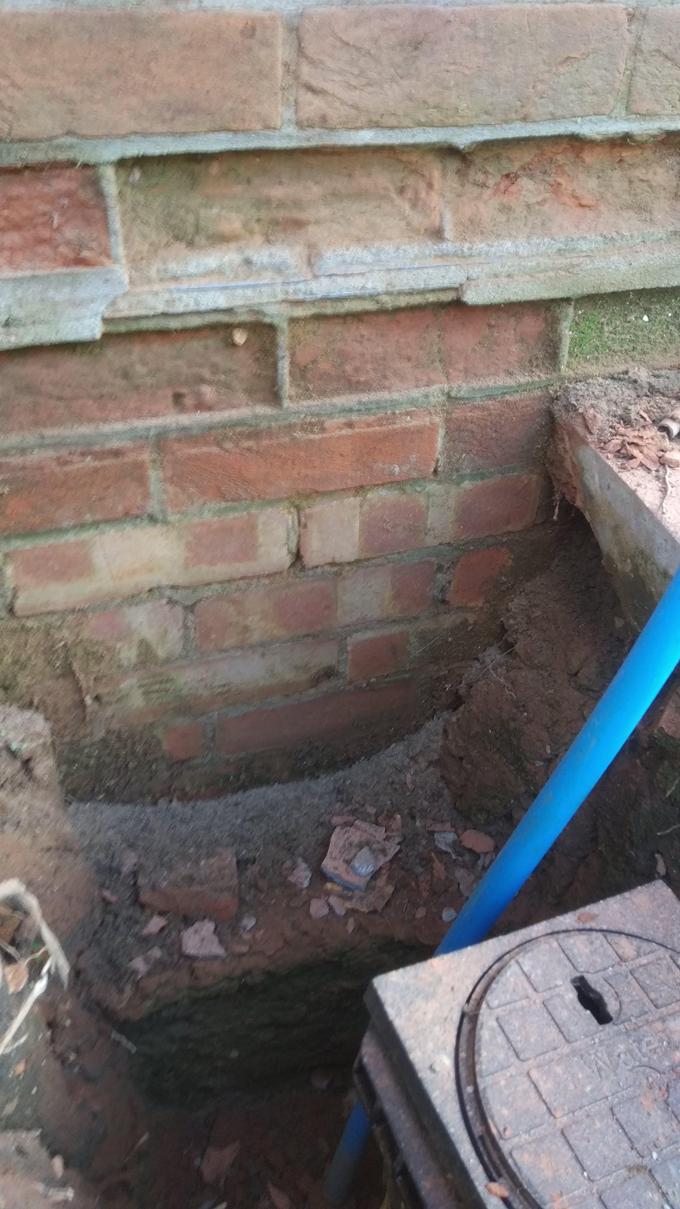

@Nickfromwales @Mr Punter That standing water was actually caused by a blocked sewer, after I read these messages I lifted the man hole and the level was only a few inches below the cover. Ive had it unblocked now and the water is gone, it was just an elbow. Ive now started the process of installing the french drain and digging out the old pipes.

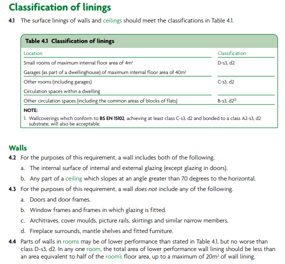

I asked the same question to my building control inspector recently about my small utility room / pantry and he sent me the attached page in reply, and said "Your plywood will meet D-s3, d2, but any standard higher than that will require expensive paint treatments, or overcladding with plasterboard. Looking at the table above, if your utility room has a floor area under 4m2, plywood will be fine, but if your utility floor area is more than that you will only be able to untreated ply cladding up to an area equivalent to half the floor area. So as an example, if your utility room has a floor area of say 10m2 then only a maximum 5m2 area of untreated ply would be allowed." Hopefully that will be the same for you. -
Thank you for the links to documents and the advice @Conor @crispy_wafer. I will check with my building control guy whether he would like the new joint encased in concrete or not. I have to cut the concrete against the wall back and put in a french drain so I will also cut around the connection and see what I find when I dig down. 🤞
I am struggling to find the right key words to find the bit I need to connect my new soil stack to the existing vitreous clay soil pipe in the ground. I assume an adaptor would be best here to ensure a good seal. I have attached some photos of the existing pipe and a rough sketch for the new soil stack that I am planning to build. Any help on this would be much appreciated.

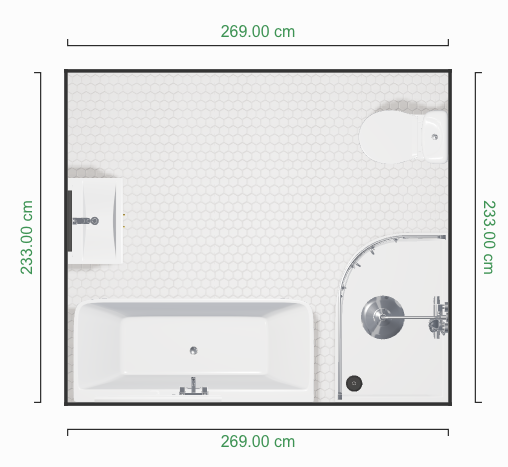

Great thank you @Olf will the stepping up from 32 - 40 - 50 mm pipes help to stop any pressure buildups causing water movements in the other units when one is draining?

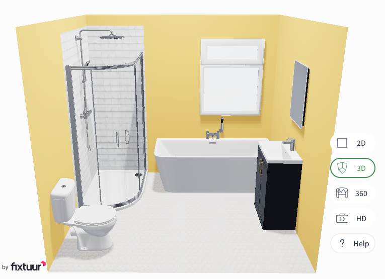

Hello, I am looking for some advice on the best way to route the waste water for my bathroom. I have attached my planned bathroom layout. This bathroom is on the first floor, with the kitchen below and a small utility room below the shower / toilet end. The short wall that the toilet is on is the external wall with the drains connection below it. The floor joists run north/south across the room so I do not think I can drill through them all that close to the wall to allow me to run all the waste water under the floor, but I could be wrong. I am happy to have the toilet waste going straight through the wall. I want to connect up the shower bath and sink to a common waste outlet through a separate hole but avoid any back pressure causing waste to flow up into the bath when others are in use (as happened in the last house I rented!) I do not mind if I have to drop down through the ceiling of the utility room in the corner below the shower, I am also happy to build a stud wall off the bathroom if this makes it easier to route the waste water, nothing is ordered yet so all sizes can change, measurements are to the existing walls. Thank you

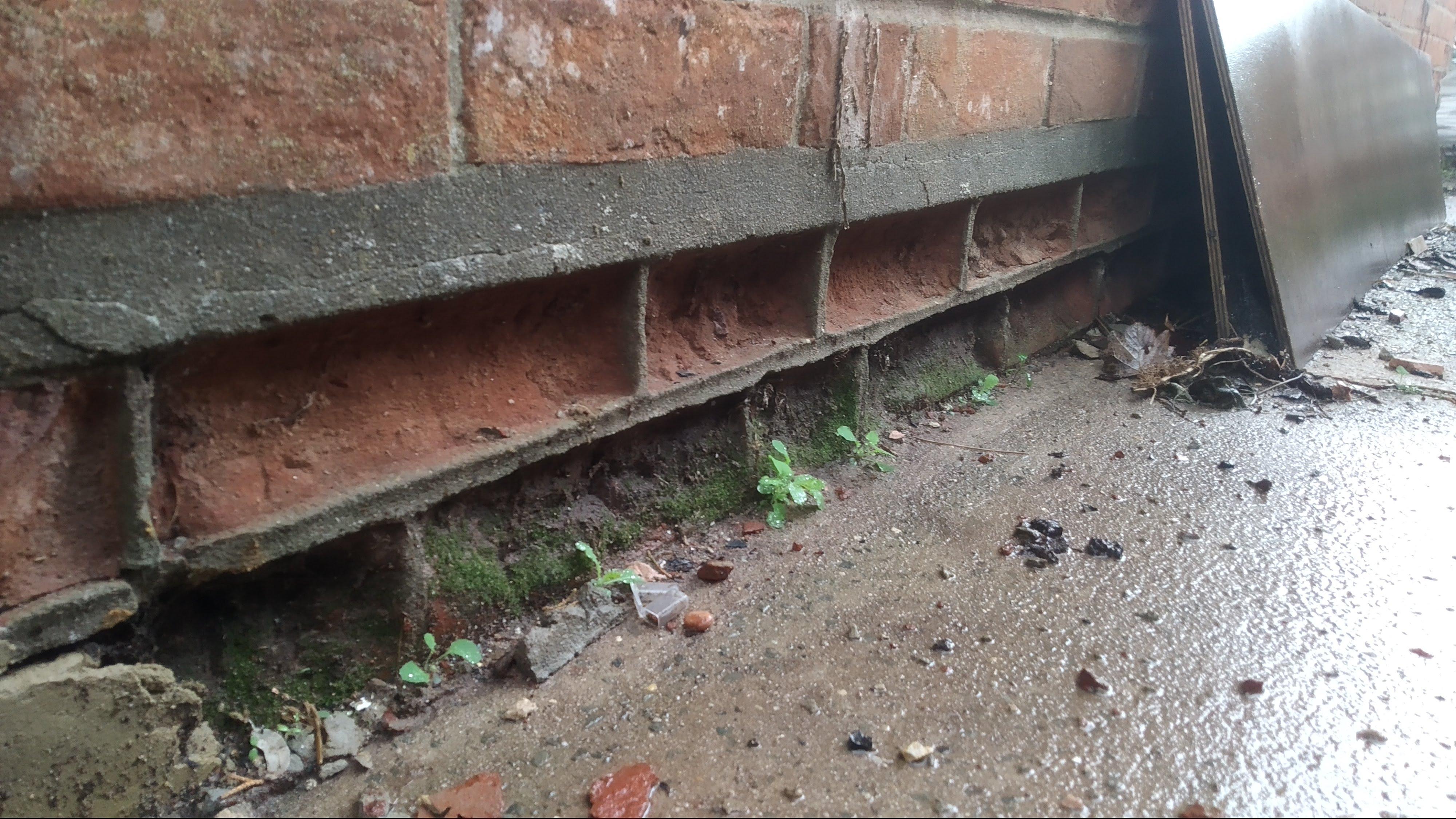

Heres another picture where I have excavated down to the footings. weirdly you can see that they had tougher bricks on the footings then switched to softer bricks 2 courses below the DPC, the course of bricks below ground level havent blown jut the ones above ground that have been eaten by the frost. Any good ideas for the best way for me to fix this?
Ohh I know the answer to this one!! link 1 is designed to clip over the joint with the legs so that you can clip it on and pull the pipes apart, so you can do it one handed. link 2 you have to press the tool against the joint while pulling the pipe out so need 2 hands! not used the fancy metal ones!
Neighbours house is not as bad, but does have some frost damage. my neighbours are not sure what was done to their house but it looks like it's been painted below the dpc. Chimney stack is fine, no signs of frost damage, it's built with a different type of brick. The inside skin of the house is harder engineering bricks This is a 1930s semi all the others in the street use a darker red brick not the softer orange brick used on this pair. Part of the problem with my half is that it was left abandoned for 25 years and was over grown with vegetation which would have trapped the moisture against the wall. I can cut the concrete path back 100mm that's not a problem.
Hello, I have quite a lot of frost damaged / Blown bricks below the damp proof level on the outside of my house, I am hoping to just render up to the damp proof level to protect the wall. I was wondering if anyone has some advice they can share on the best process / type of rendering product for doing this with? It is a semi detached house with an extension going on the rear and a porch on the front so not many meters of rendering required luckily, this side wall will have my heat pump against it and will not be seen very much so the aesthetics are not a priority! Thanks
