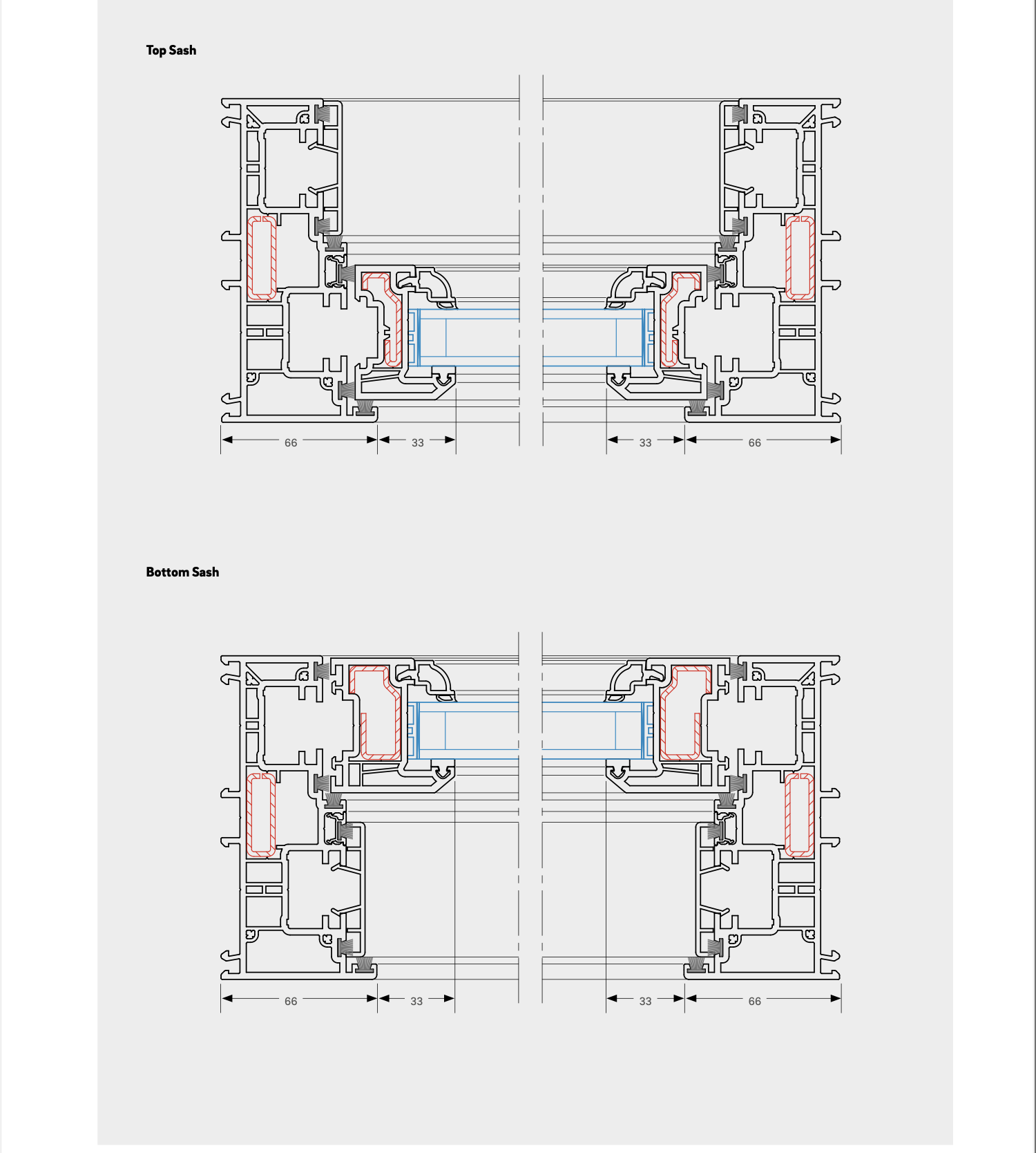

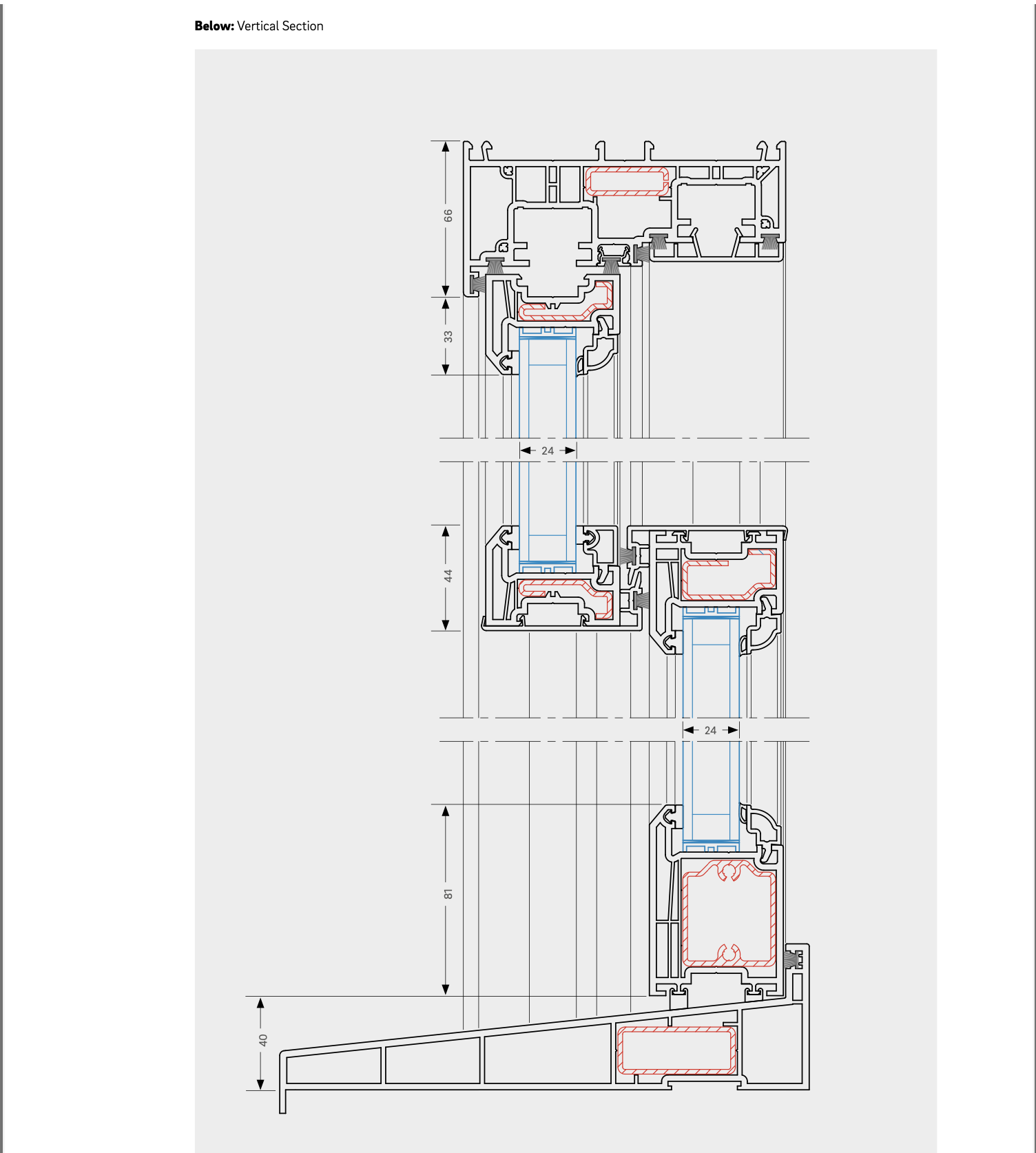

  11. These were taken from - https://www.rehau.com/downloads/616194/rehau-specifier-guide-brochure.pdf
  12. I'm considering Sliding Sash windows for part of our house (I appreciate they aren't the best for airtightness. I'm juggling cost, sympathetic renovation and efficiency). My local Rehau fabricator states the Sliding Sash frames can't be attached using Rehau fixing brackets and require screws through the frames. From the technical drawings I can't see a difference between the sliding sash and the TOTAL70 frames which can be fixed using brackets. I'm hoping the fabricator is mistaken, as they didn't even know what fixing brackets were when I first asked. Do we have any Rehau experts on here who might be able to advise?
