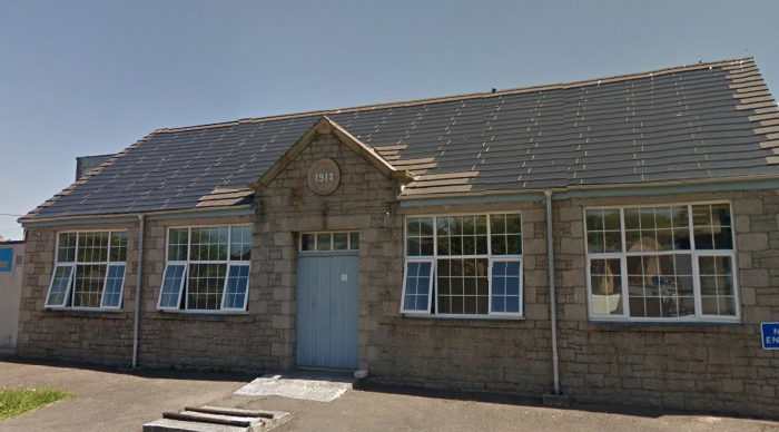

Roof integrated them, would hardly be noticeable to a passerby. Maybe a few pictures of solar slates as an example, put point out that there may be a difference. I drove past this place a lot and never realised it had PV, and on closer inspection, it could have been a much better installation.

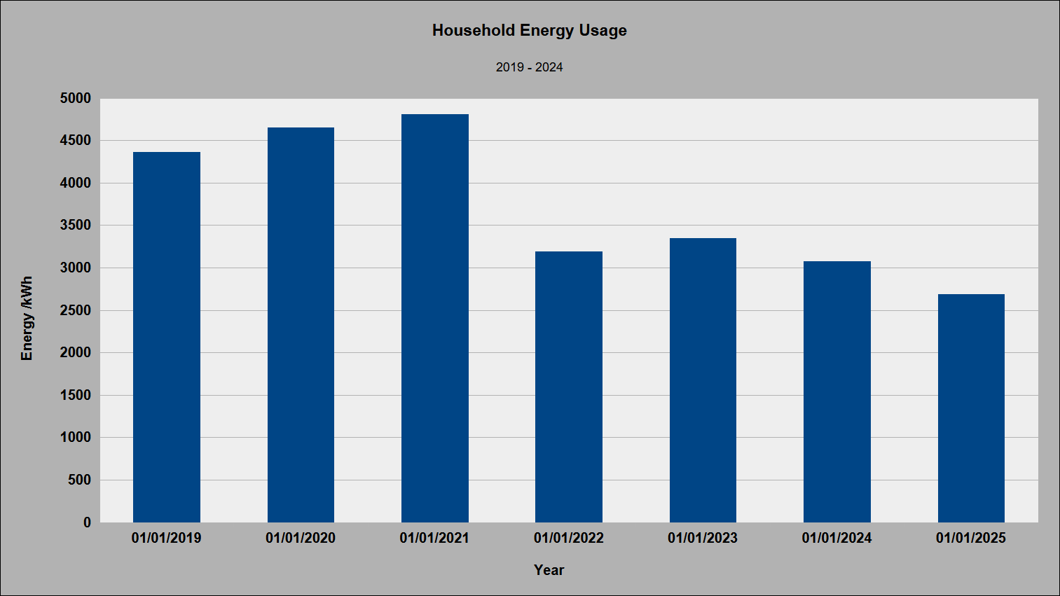

Mainly the challenge and CO2. The grid intensity CO2 is outside of my control, but then I started it was around 0.7kg.kWh-1. Initially I saved 30% by just managing my usage better. That was a no cost option. Changed to LED lighting (less than £30). I then started by spending some money, mainly £60 on some digital timers to limit my E7 window better (heat up in the last 4 hours rather than the first 4 hour). Then extra loft insulation (still got some more to add). Then I started the miserable job of draughtproofing, cheap to do, but time consuming. Then the secondary glazing (less than £200 for all but 2 windows, so 12 windows in all. Left 2 windows for escape routes). I also reduced parasite loads. This really involved making sure any standby loads were very low. Getting rid of a desktop PC and using laptops has made the biggest difference. There were setbacks, mainly my lodger who, until I beat her with a pointy stick, would stand under the shower till the water went cold. Eventually she learnt her lesson. If it was not more the orientation and the small roof, and having to spend my spare cash on bi-monthly visits to see my Mother, I would put some PV on the roof. As my DHW usage is about 4 kWh.day-1, I could probably get 80% of my DHW for nothing (I could also reduce usage, but I love my morning baths). To celebrate, I heated up the room I am in to 24°C this morning. Hansom it was.
Take me 20 years, but very little cash to to reduce my household energy use to below 3MWh.year-1. When I first moved in, it was around 11 MWh. This last year, I used 2,780 kWh. That is 335 kg of CO2. Feeling pretty chuffed about that as I have been warm, but never too hot, fed and bathed. If you are wondering why there was a big drop from 2022, that is because I fitted my home made secondary glazing (making my windows triple glazed).

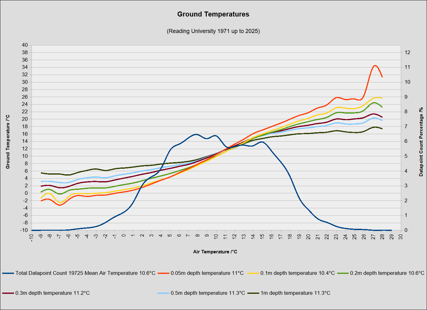

By the new mean yearly temperature. Ground at a metre depth is generally about the mean yearly air temperature. But as I mentioned earlier, it is more complicated than that. -

No, just a dT of 20K. Somewhere I have a spreadsheet of ground temperatures, they are not as warm as people think and not very stable sub 1m deep. -

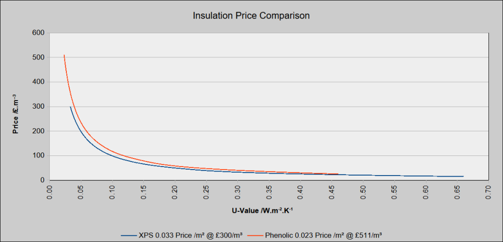

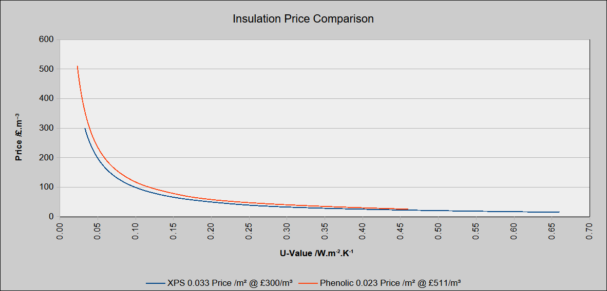

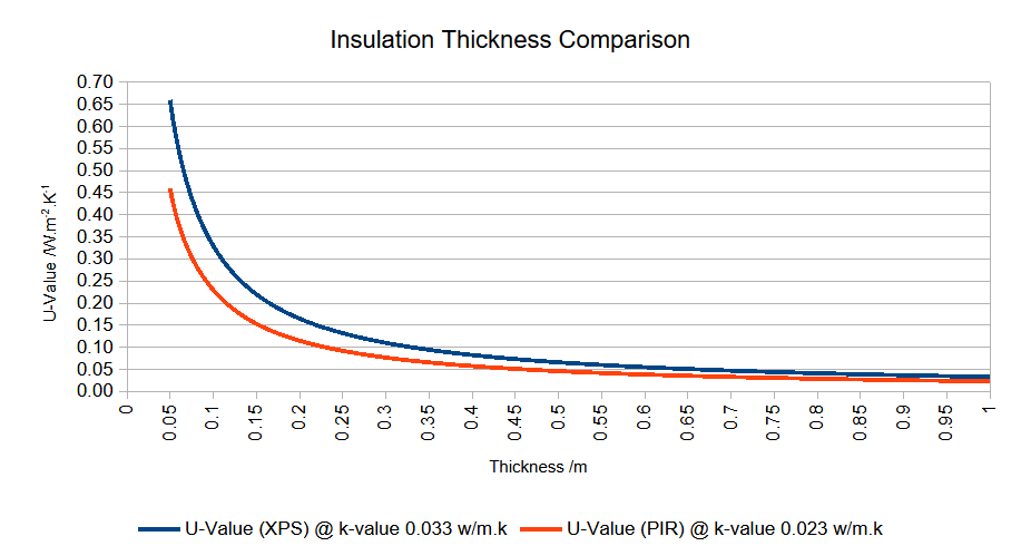

I must be bored. Here is a chart showing price comparison between insulation types. I have only got the prices from 1 site, and have used median k-Values. To get better results, do your own research. There is little difference between XPS and Phenolic at the 0.1 W.m-2.K-1 level, about £10.m-2. There is a 0.1m thickness difference though, which may or may not be important depending on how you excavate and dispose of the dirt. (as usual, there may be errors as I am tired) -

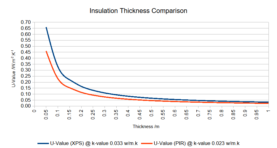

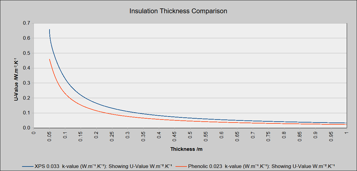

I just knocked it up from assumed k-values. It is a 1D model, so edges, which can have greater losses, would need to be added on. I think that is caused by the charting software, see below for a different curve algorithm (changed to a B-Spline from a Cubic Hermite Spline). This is where it gets difficult. It depends, primarily, on energy prices and installation prices. UFH would cause greater losses than just heating the air in the building, the building form factor would make a difference as well. This is why individual buildings need to have heat loss calculations and not have the heating system sized by a rules of thumb i.e. just floor area or number of windows (I have heard a plumber assess the heat loss that way). Losses though the slab are uneven as they can be affected by the room temperature above, the ground type below and if there is any ground water movement nearby. So probably safer to pop a bit extra in, rather than too little. -

You are still comparing overall thickness though (I know you had a (expletive deleted) up are limited on thickness). What you need to do is pick a U-Value (i.e. 1.2 W/m².K) and compare the prices to achieve that, not compare prices to fill the gap up. Not if you had made that decision in 2015, 6 years before our energy prices doubled.
