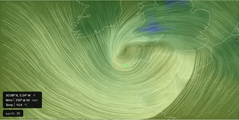

  5. Quite a good thought. As it is a new discovery, maybe someone will work out the optimum trunk radius to timber mass, which should help identify the best species to plant and at the ideal density, for different regions. Would also be interesting how it affect other types of plant bark/skin. Totally unrelated, but maybe not, I noticed that the main types of trees that got blown down last night were conifers, which are not indigenous to this area at all. In fact, trees are not indigenous.

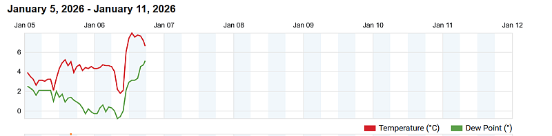

  13. No. I am busy at work. But is short, even with relatively high temperature, the high RH will cause an ASHP to freeze up.

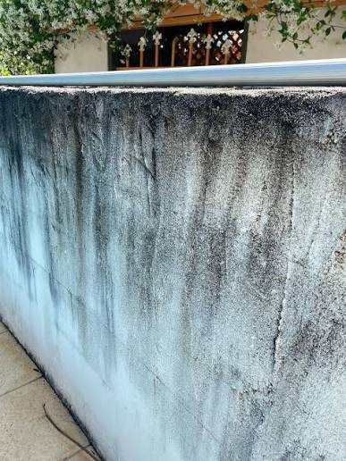

  23. Think it is a myth. If it worked, all rendered walls would have it.
