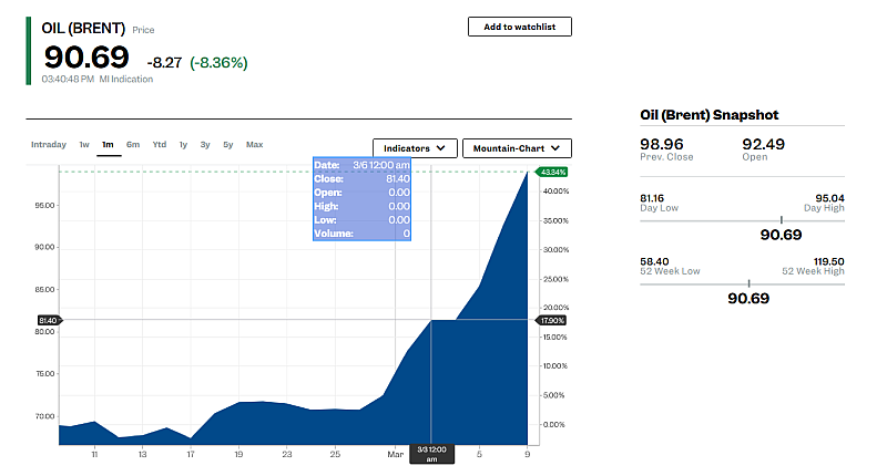

You have not seen the price of cod recently, we stopped selling it a while back. Now this is oil prices, let us see how far the go and for how long. Data is up to March 1st Two charts, nominal price and inflation adjusted for WTI crude. Data from here
Iran has large oil reserves (as does Venesuala), but it's production is not that great, and it used half of that domestically. https://www.worldometers.info/oil/iran-oil/ The biggest problem is shipping in the Straits of Hormuz. Once those ships, that can get through (why their navy has been obliterated first) have been reassigned to pick up in other places (probably the USA), thing will calm down a bit. Brent Crude is at 92 USD at the moment. Higher than it has been, but not exceptionally high.
