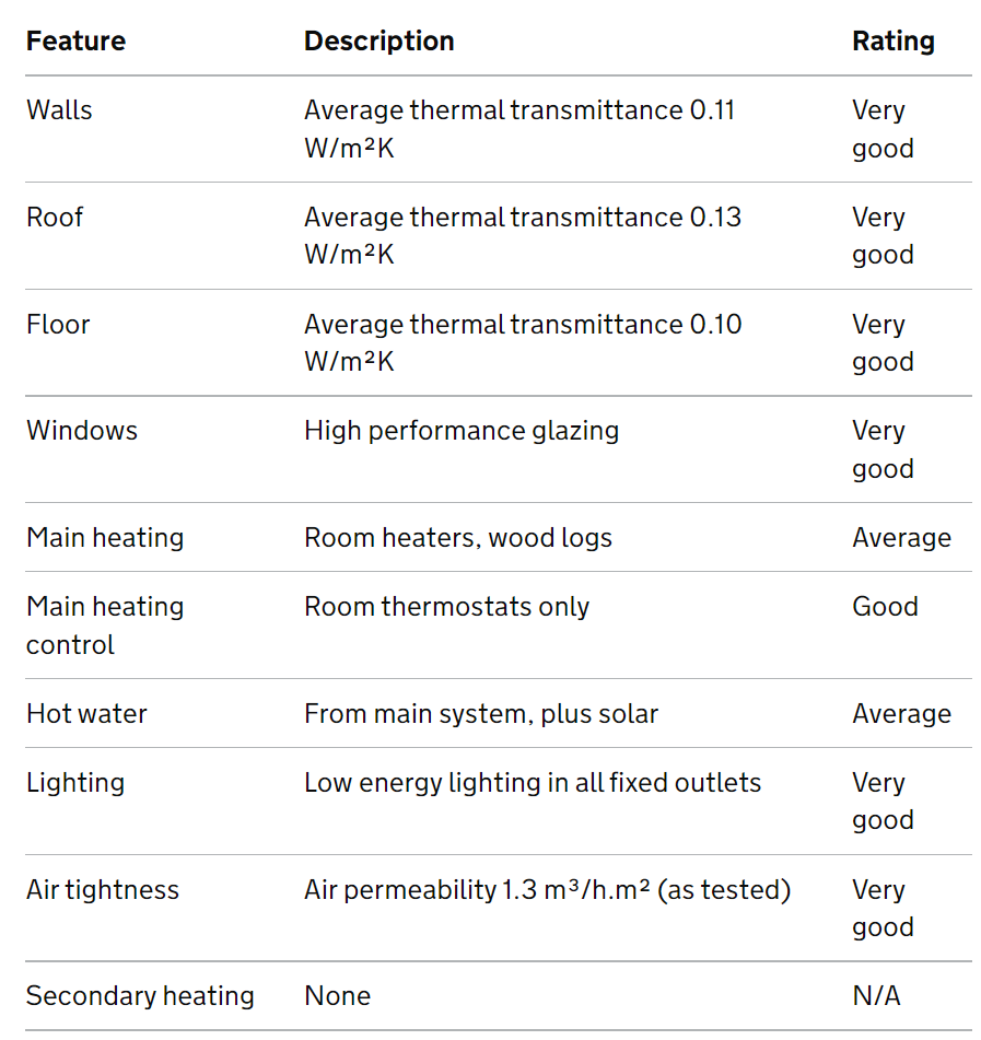

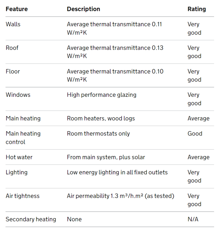

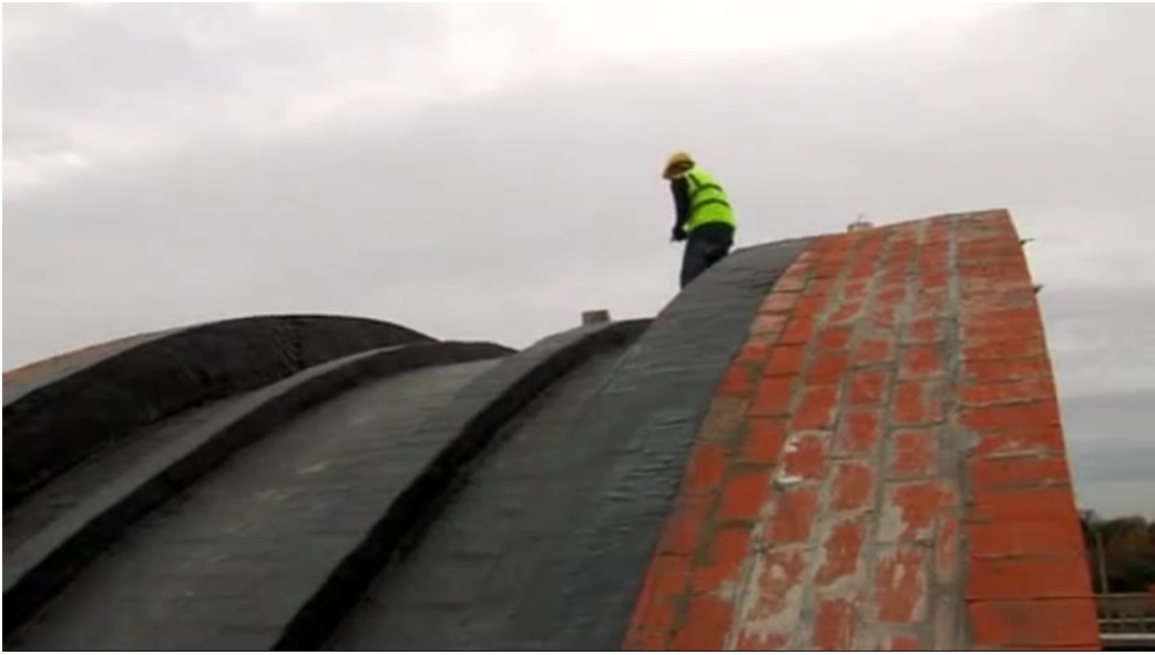

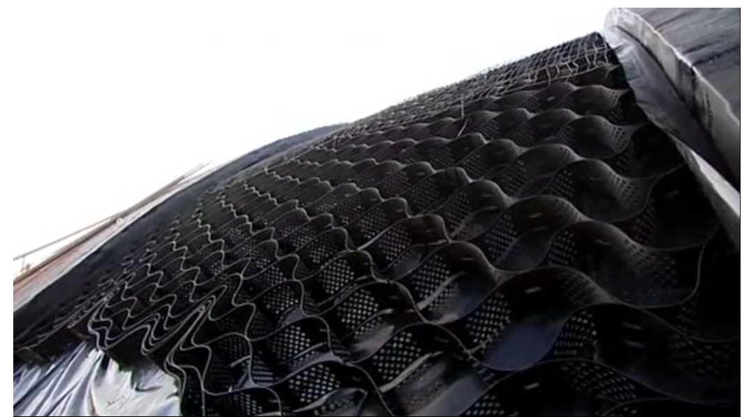

On 14/12/2022 at 12:46, jack said:
To be fair, even if you'd had the required airtightness, it's extremely unlikely you'd have managed to get certification after the house was built. It's technically possible to start the PH certification process after building, but there's a huge amount of record-keeping required to prove that what was designed was actually built. For example, every junction would need to be thermally modelled at design stage, which you can do/show after the fact, but then a full photographic record of every junction is needed to show that what was designed was actually built.
The only building I've heard of managing this feat in the UK was that amazing arched house that was on Grand Designs:
https://images.squarespace-cdn.com/content/531e5ec2e4b02c4ce263c44c/1456106421390-RYSUKC6L8BHZ75UJJ1BY/uk-passive-house?content-type=image%2Fjpeg
I really don't know how they managed it tbh. The arch is exposed internally along most of its length, and I can't see how they managed to insulate it at all, let alone to the sort of value that would been needed to meet the Passivhaus energy consumption standard.
Had a little dig into this, and rewatched the episode. As it happens they also redid their EPC this summer.
The episode discusses that the design is passive. And the epsiode includes an air test @ 33 minutes below.
His "High Five" accent reveals a Borat fan, I'd say !
Basically, the roof u-value is 0.13 (EPC = 92), and the arch is insulated on the outside under the green roof. It overhangs at the sides and that is where the uninsulated bits are - must be an interesting joining detail there.
Timber frame box walls are 300mm of newspaper clippings.
One point I did not remember is that the outside 2 layers of tiles (from 3) are laid in cement, whilst the inside layer is in plaster of Paris.
