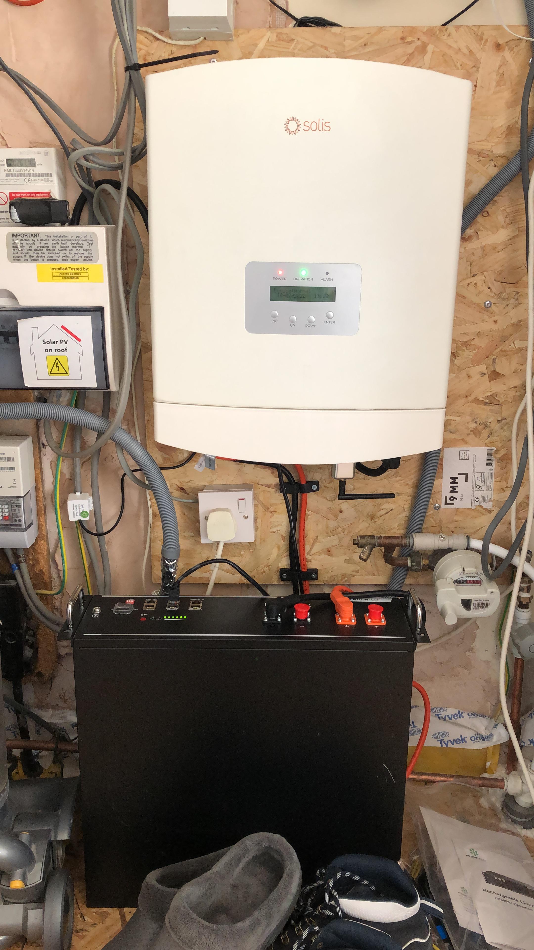

After pondering battery storage for many years, and then the energy prices rocketing this last year, i finally decided to give energy storage a shot, working out how it would sit financially was extremely difficult, and a little bit of a finger in the wind, but as the batteries have a designed lifetime of 15years now, and energy prices rarely go down, I figured it would pay for itself with some profit over the long term, whilst also reducing my carbon emissions and reliance on the grid.

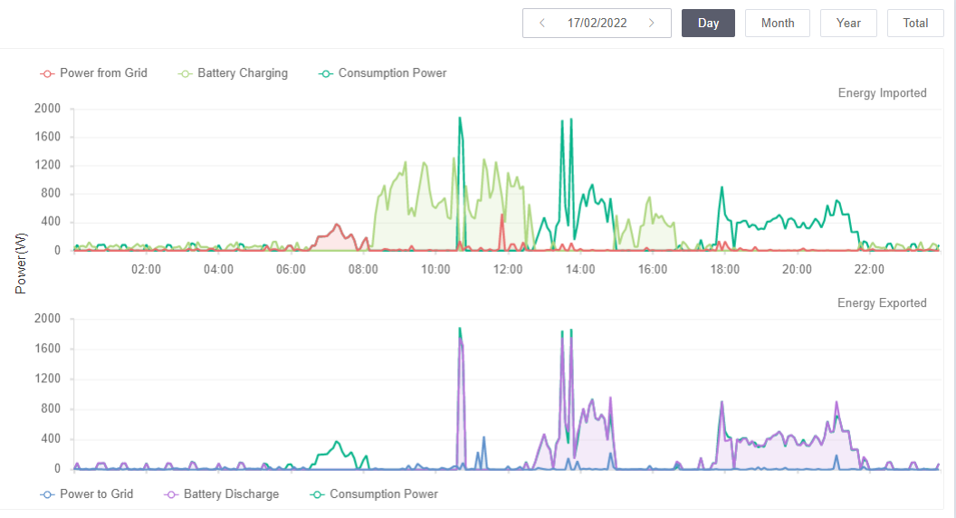

As i'm just dipping my toe in, i've decided to just get a single US3000C Pylontech Battery for now, meaning that the max discharge W is around 1.8kW. I will see how this fits in, which will cover most of my loads, and if I see fit I can add a US2000C later on to give the full 3kW discharge. Went for a Solis AC Coupled 5th Generation Inverter, the graphs it produces are really informative.
Will get round to taking the rackmount bits off at some point.

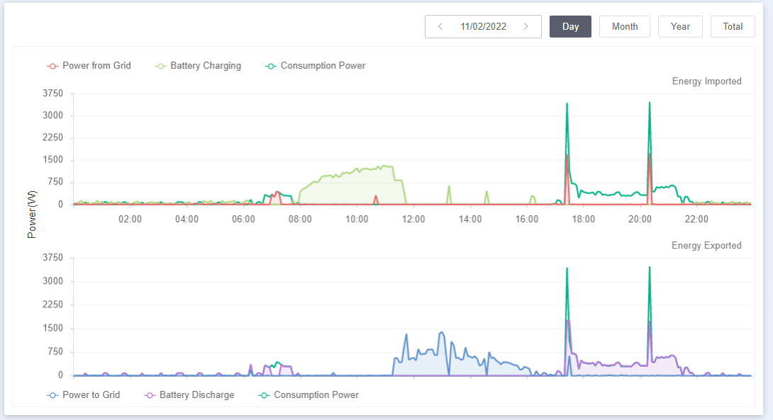

Example of the graphs available:
I will add bits to this thread over time about electric consumption. My annual consumption at the moment is looking to be around 1200-1300kWh before the battery, Export sitting around 2400kWh as excess from the solar farm, so be interesting to see what these figures do over the next 12 months.

Yesterday had the washer on, dryer afterwards and cooking my dinner and tea, and used very little from the grid. Export has now dropped to zero, haven't exported anything since it got installed, and also have managed a full charge yet, just not been sunny enough. Worth noting that because i'm on a deemed export tariff for the Solar FiT, I'm still being paid for 50% of what i generate as a deemed export, even though nothing is going out at the moment.
One thing I did notice last night when cooking (around 18:00) was that the battery storage inverter couldn't react quickly enough to cover the induction hob, which pulses, so it drew around 800W from the battery, but it was still importing around 100W from the grid, so worth taking into account, wasn't something i'd even thought about.
At present the battery is drained before I head to bed, this will alter as the days get longer, and this led to another discovery. So the inverter is set to not discharge below 10% SOC, however the battery does still discharge very slowly, but what i've seen is that it tops up a little from the grid through the night, and then discharges that to loads, the little and often bump on the graph through the night is the fridge freezer.
Cost per kWh - £2450 / 3.3 (usable) = £742
Very happy with the 3.5kWh Battery at the moment, thinking what I would gain from another 2.4 may be minimal, but will see how this evolves.
