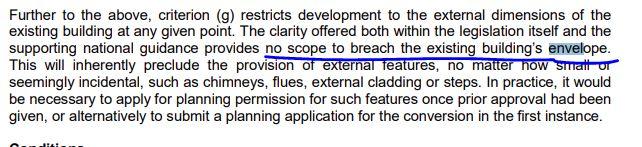

The OP says its part Q and he has to keep the existing walls and then says he can add new walls outside ?
Something doesn't add up here. If its part Q approved then it SPECIFICALLY excludes building outside the original envelope so that's the additional wall out of the equation.
https://www.herefordshire.gov.uk/downloads/file/8236/class_q_guidance_note_–_conversion_of_agricultural_buildings_to_residential_use
Could you post your drawing of the build structure you will be sending to building control for regs or dont you have them done yet ?
Not trying to rain on your parade OP but you seem to be missing all of very first step ? You don't want to crack on and spend a lot of money only for planning to make you pull it down.

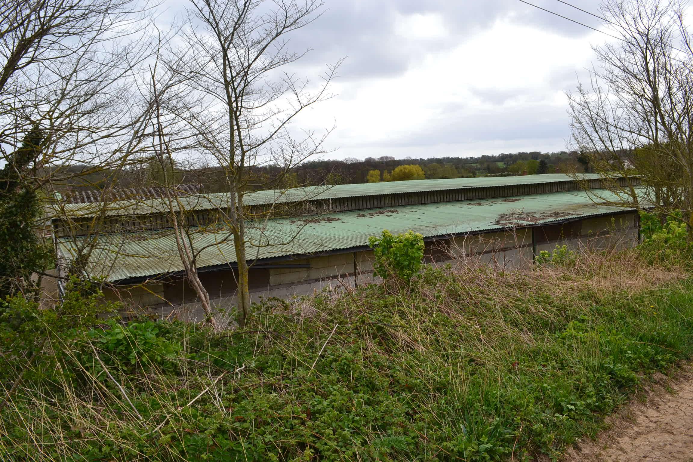

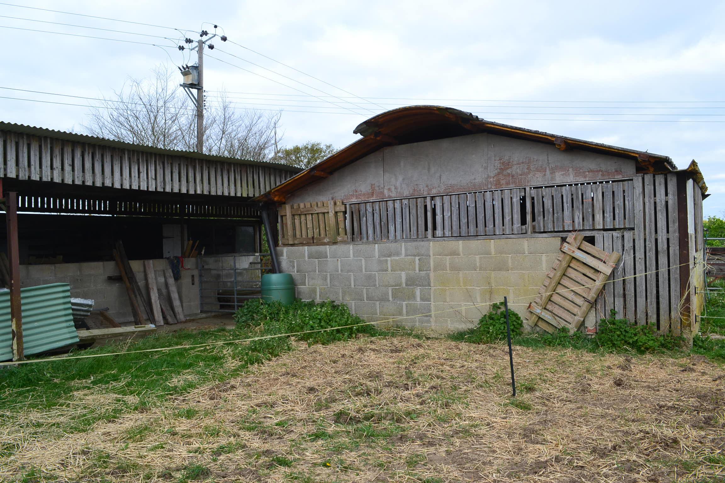

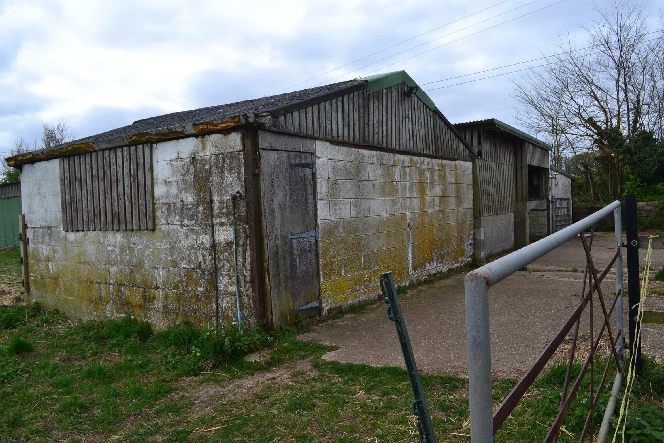

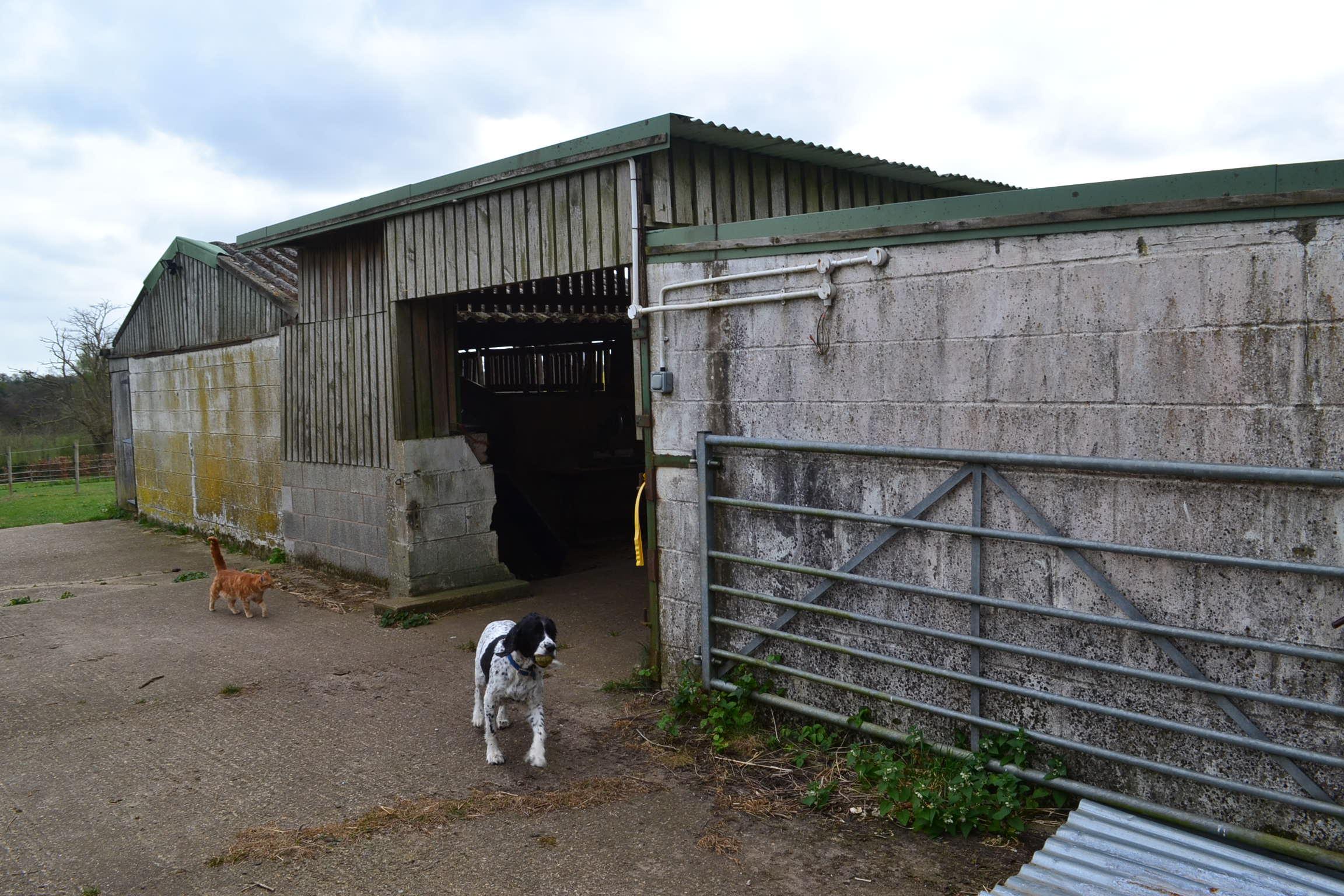

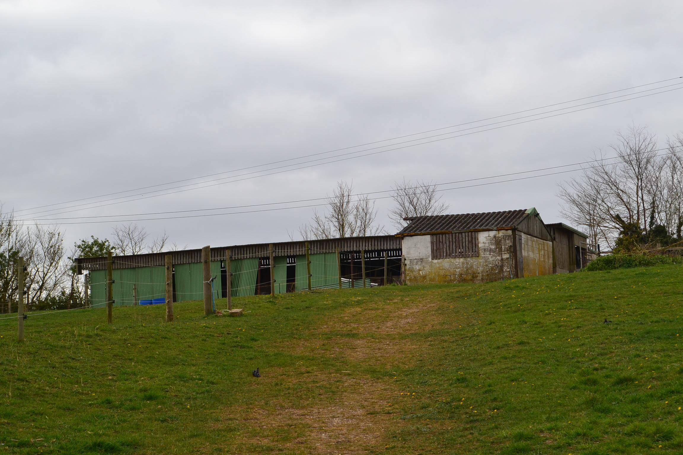

Although we are building the 2nd skin outside the original it is because there is currently a large overhang ranging from 0.2 to 1m which is included in the footprint, but is outside the walls.  You are right, we are not allowed to extend the dimensions, but we also have to keep the walls.
See picture here showing largest overhang.
I don't have the BC or structural drawings yet, I'm just trying to work out cost and what to use first.

I am confused.  Before we have done renovations and extensions, but no conversions
I would be perfectly happy to build from scratch, it's all these restrictions that are getting me.
I spoke to the LPA re knock down and start again and they said absolutely no chance as it counts as building in the countryside.

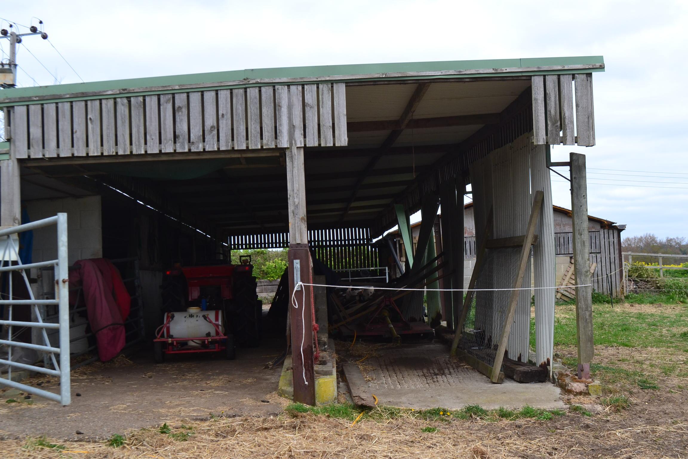

Here are a few pictures, out planning drawings by the architect are just lines on a page and don't specify any materials.
Our planning approval says that we must use the walls, floor, roof etc to ensure it is a conversion not a new build.
We are already being a bit risky by replacing the roof.  The current one is roofing sheets and leeks, the floor is 4 different levels with concrete on concrete on concrete.  It was for breeding pigs and I've no idea why they had to do this, most of the floors are younger than the walls so they a floating and have a 5m gap between the edge and the wall.
Here are a few pictures.  Originally we were going to do some external cavity walls and some internal, but then when I realised how much space that would take up inside and how many blocks were involved we started looking at other ideas.
On the long North side there is no wall at all so that ones easy, but the rest are currently driving me mad.
Link to comment

Some one else said about putting the insulation and cladding / rendering directly on the outside of the existing walls.
Is that possible?
Link to comment
