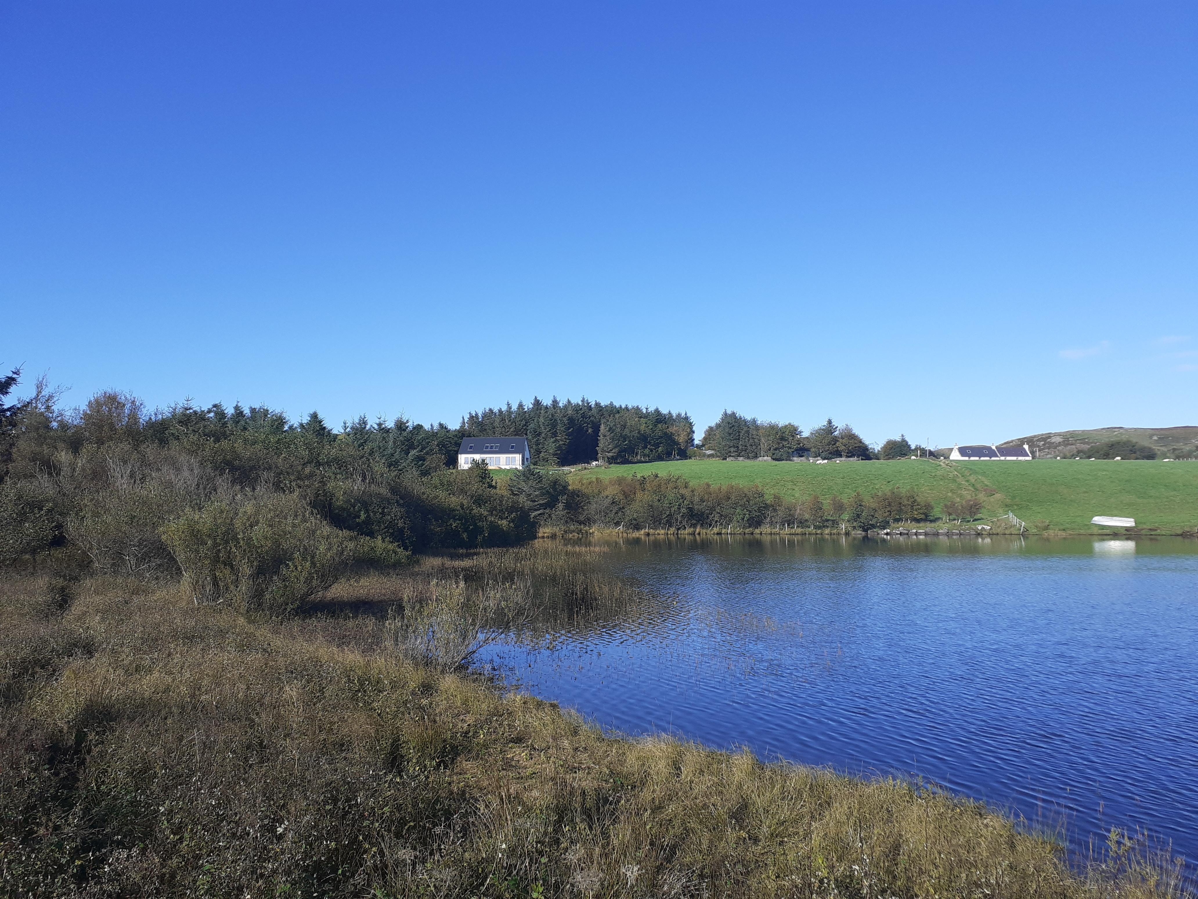

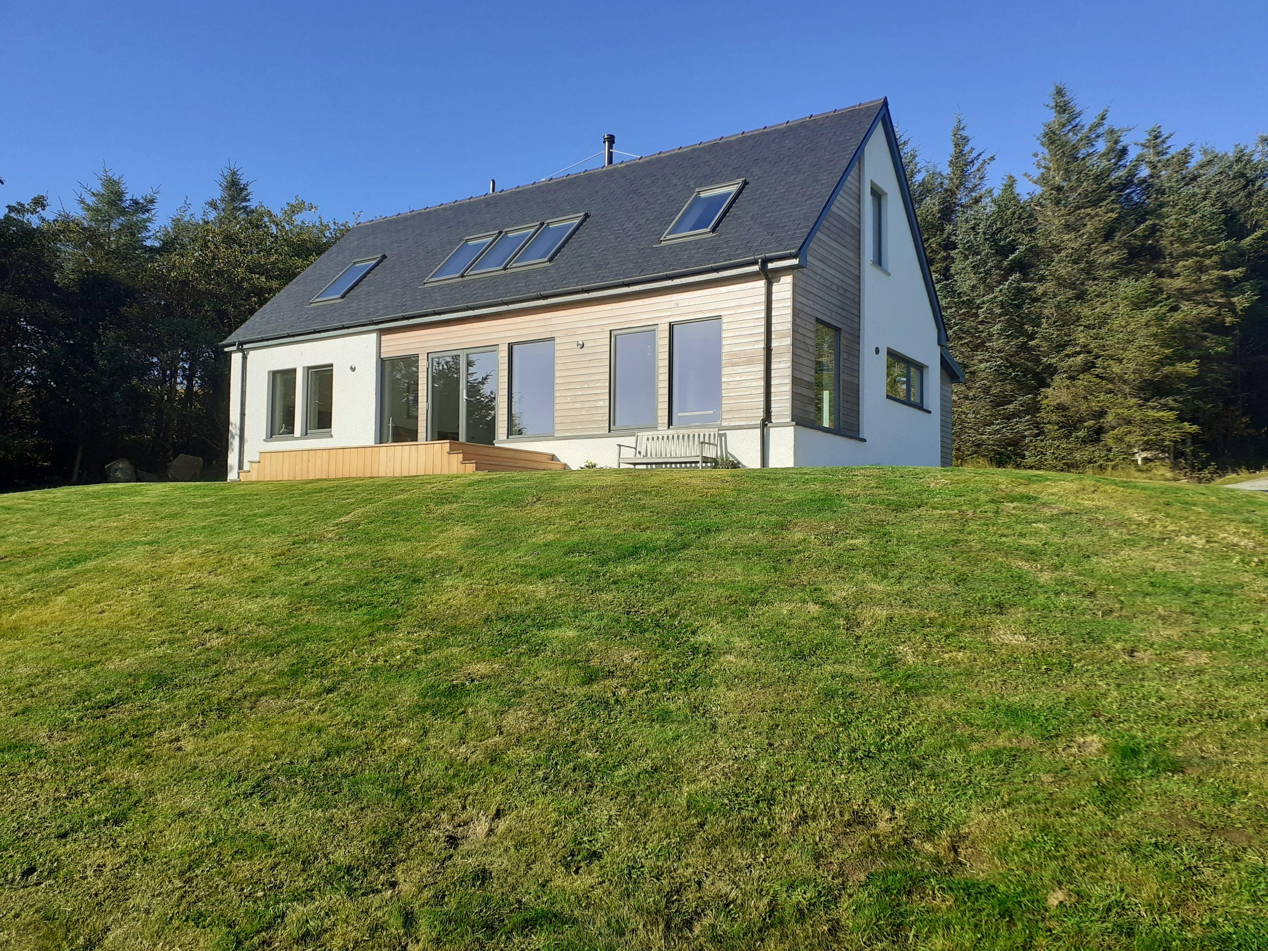

Following on from the last entry we had our final inspection and were on the cusp of getting our completion certificate. A few final documents were uploaded and a certificate was received from building control.
We had built a house.
A few final jobs were completed following the last blog entry.
I order 20 tonnes of gravel from a quarry on Skye and then barrowed it down the access and spread it around the house.
I also had enough to put some at the top of the access as well and fill a couple of bulk bags.

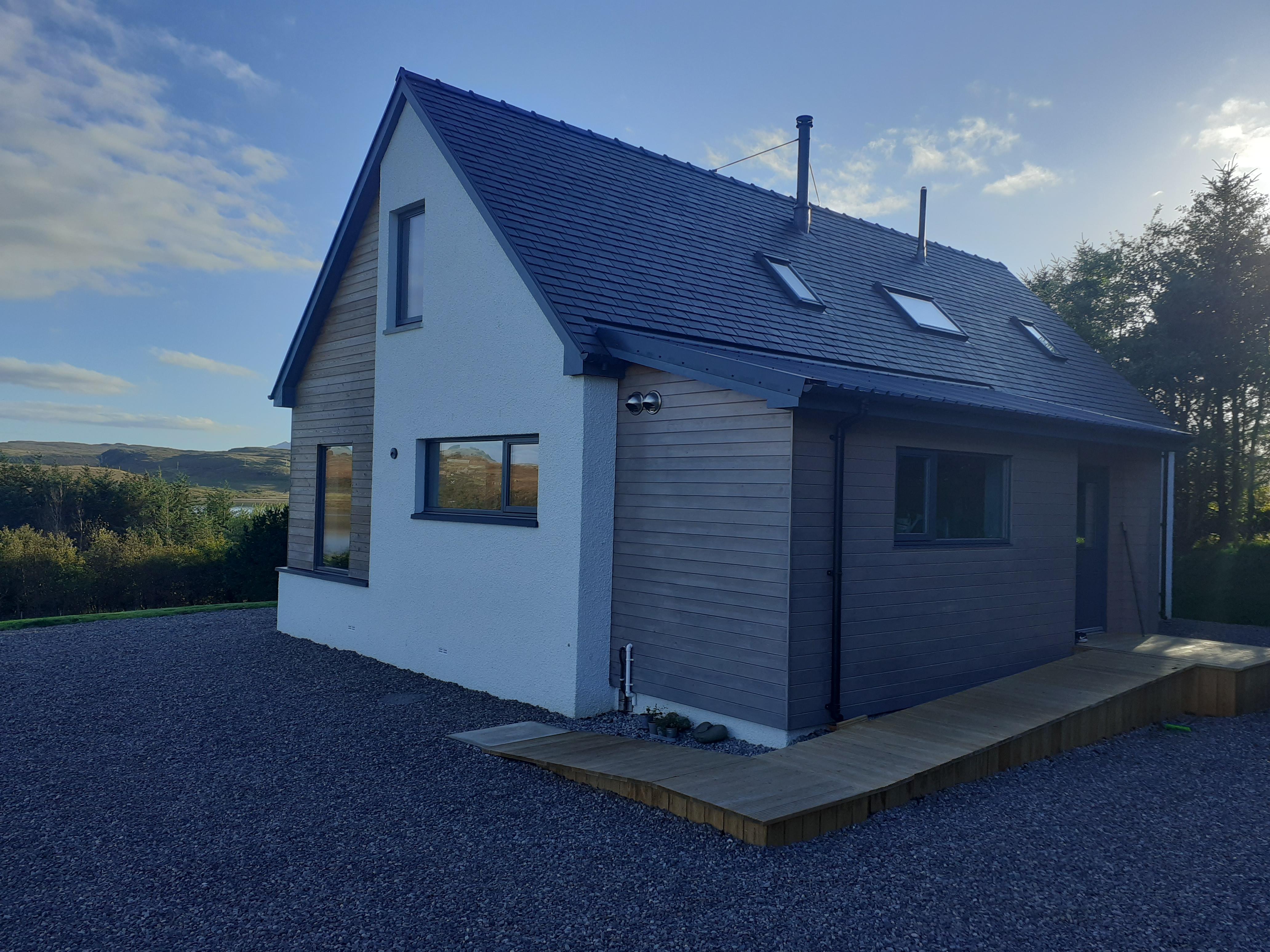

The last job for the joiner was fitting the downpipes. We used the cast iron effect ones as these provide a bit more of a decorative look compared to the standard glossy pipes.
We seeded the ground at the start of lockdown and now after a summer of growing the grass is coming on nicely. The grass seed cost very little money. It cost us around £15 to do all around the house.
We are pleased with how the house fits into its surroundings.

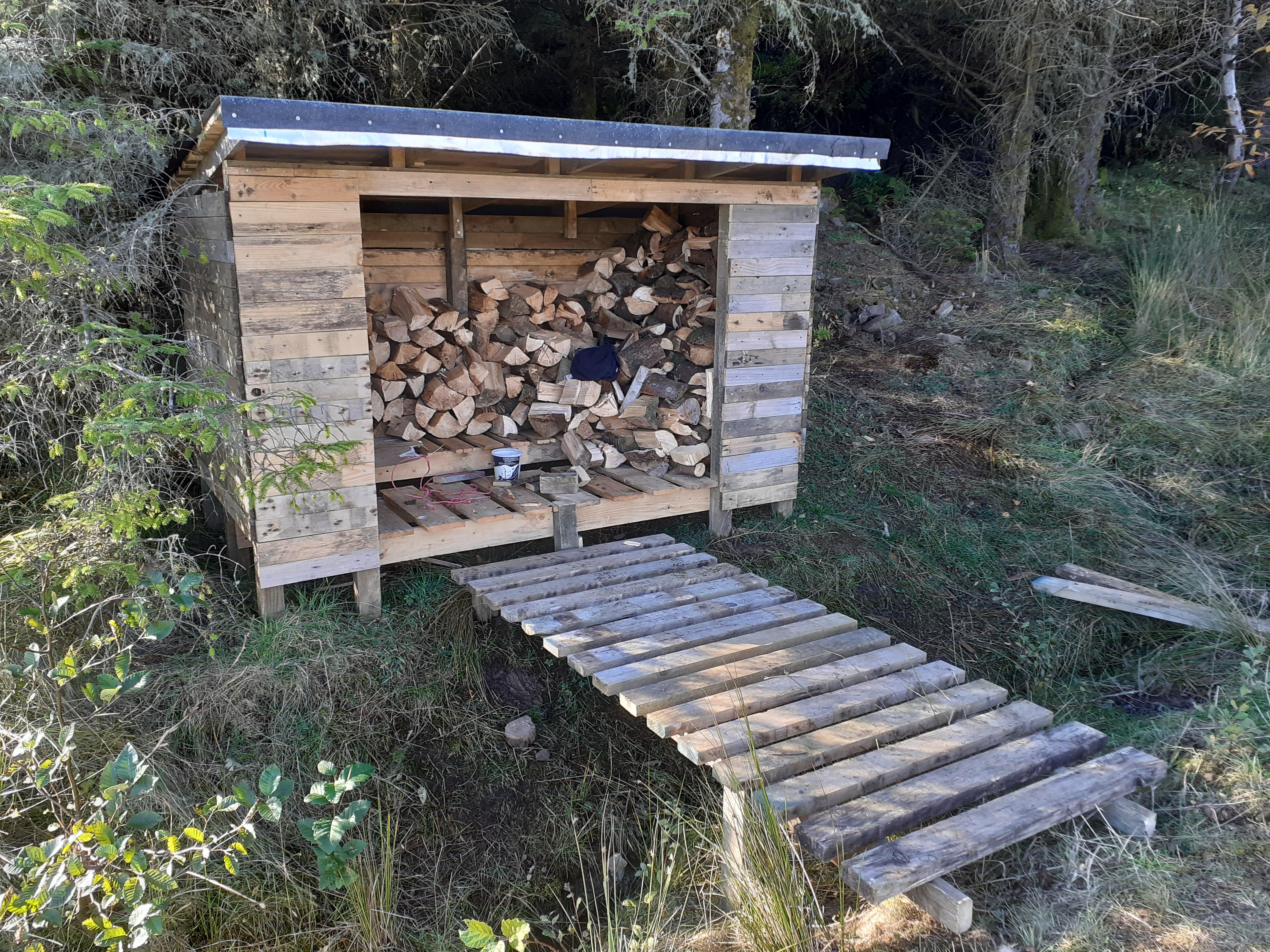

Our pallet wood shelter was finished and I’m currently building up the wood stocks.

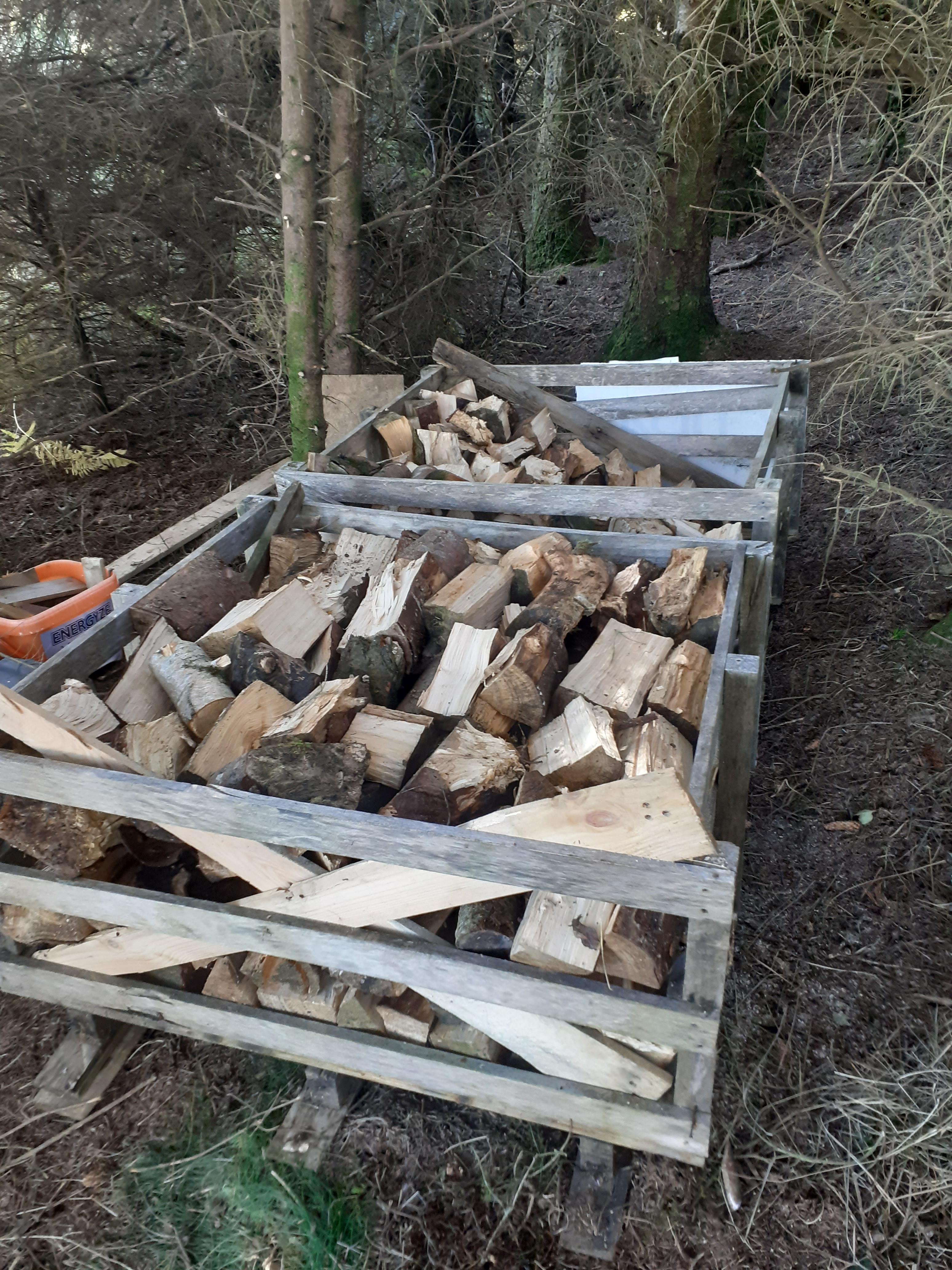

I am also storing fresh cut wood for the future years. These old CUPA slates crates are useful for this.

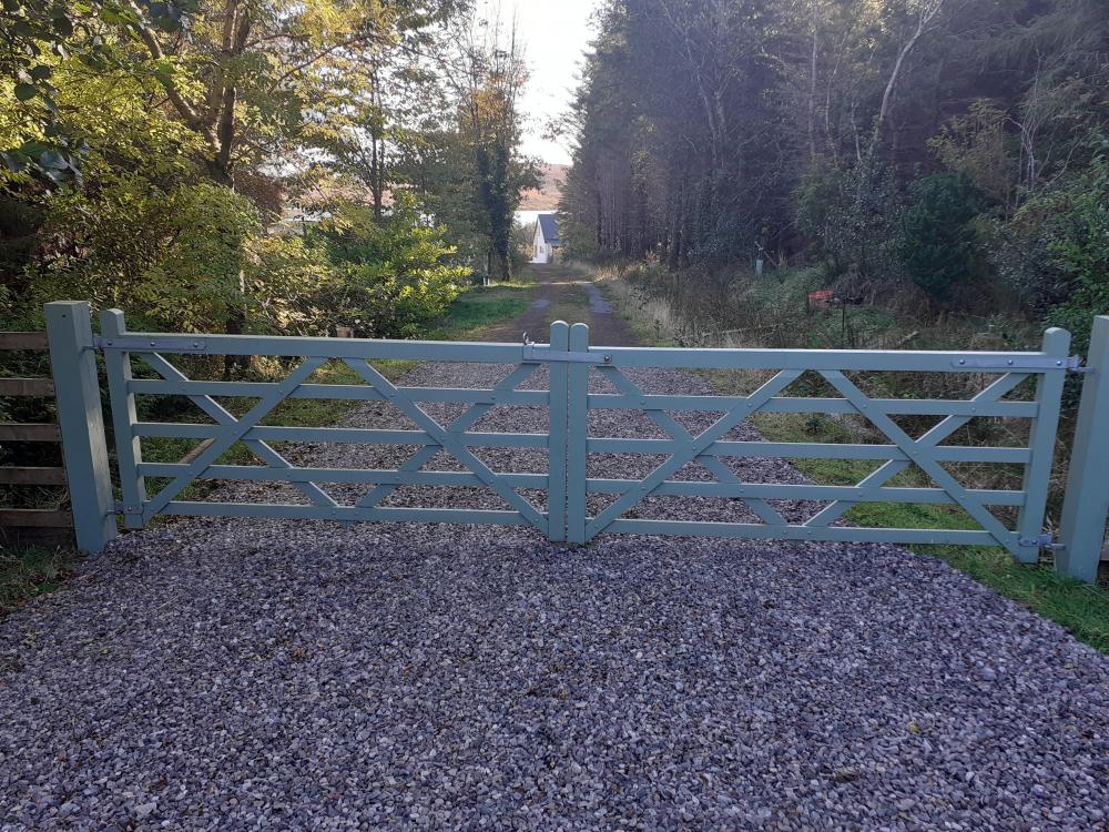

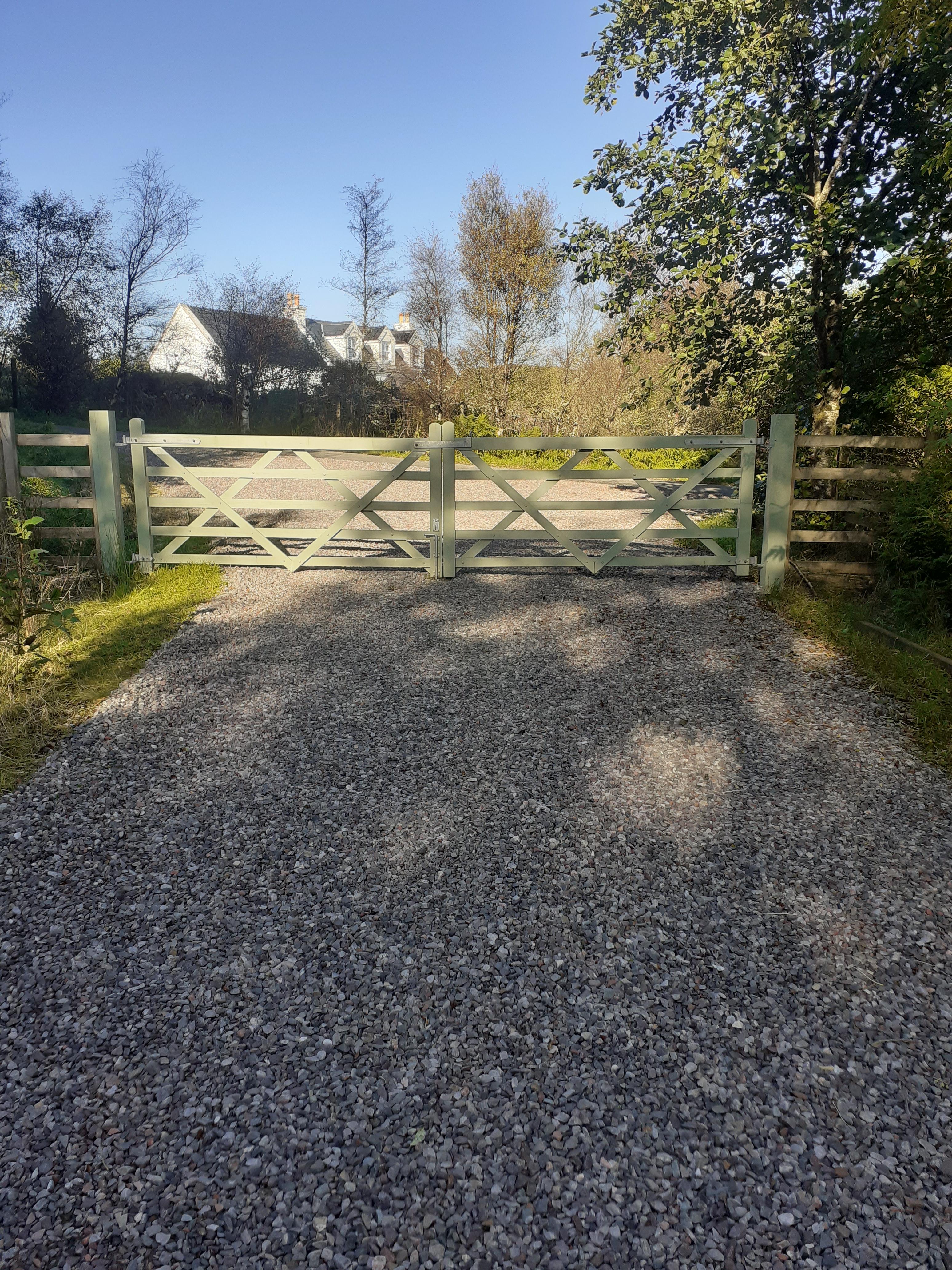

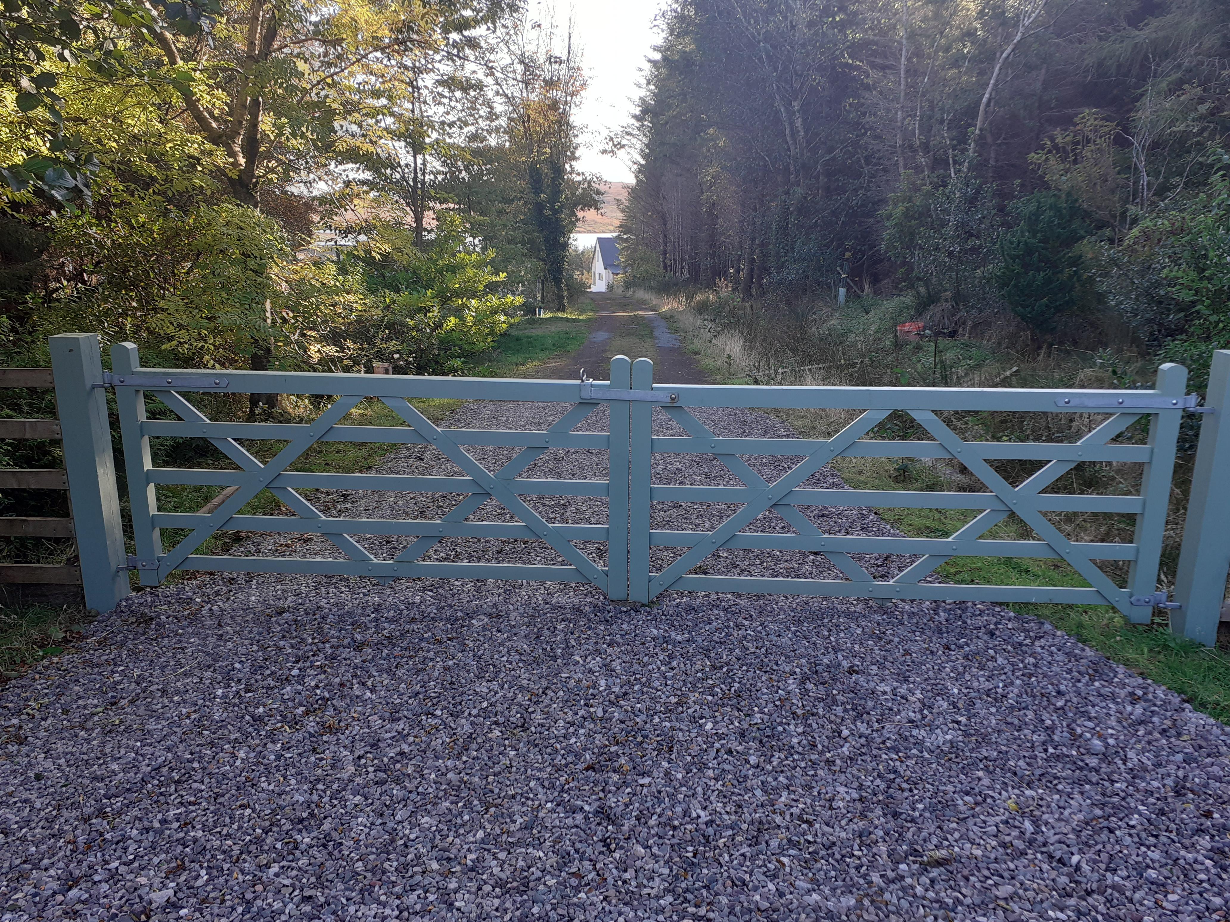

13 hours ago, Bozza said:
Great job. House sits lovely in the area.   Were your gates handmade or bought ?
Hi Bozza,
Thanks
We bought these and then added a lick curprinol willow in the summer.
I can get my car through just one of the gates which is handy.
Link to comment
4 hours ago, Thedreamer said:
Hi Bozza,
Thanks
Nice.  Where did you get them from, I was thinking about gates.
Link to comment
This gate came from agricultural distributor called Harbro. Not sure who makes them.
The gate and fencing were partly covered by an agricultural grant.

House looks fantastic!  I am really interested to hear the construction method that you employ for the cladding which is set back from the render.  Is that section simply made using a SIP panel and cladded?
