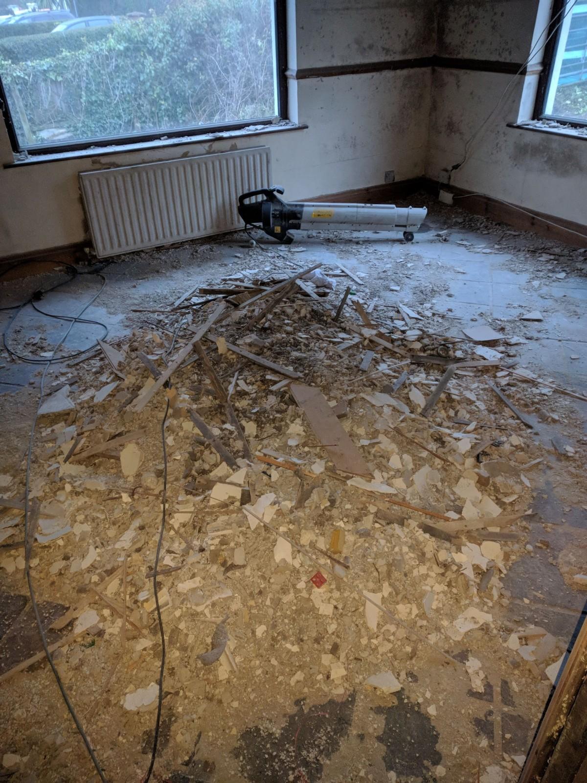

So, I started the laborious process of demolishing the house in September 2019. As it was a single story bungalow, it seemed like a doable job, esp as the walls were red brick with weak lime mortar. Wall render, radiators, floor boards, insulation, kitchen, plumbing, ceilings. The biggest challenge and worst job was the loft insulation. Somebody in their wisdom chose to use 100s of bags of loose EPS balls. Absolutely nightmare. Couldn't sweep them up, couldn't vacuum, couldn't let them mix with the rest of the materials. In the end, we ended up punching through ceilings, and using a leaf blower to pile all the beads up, then stuff in to numerous 90l wheelie bin bags, and off to the dump. Horrible job!
Ceiling down, beads separated using leaf blower.

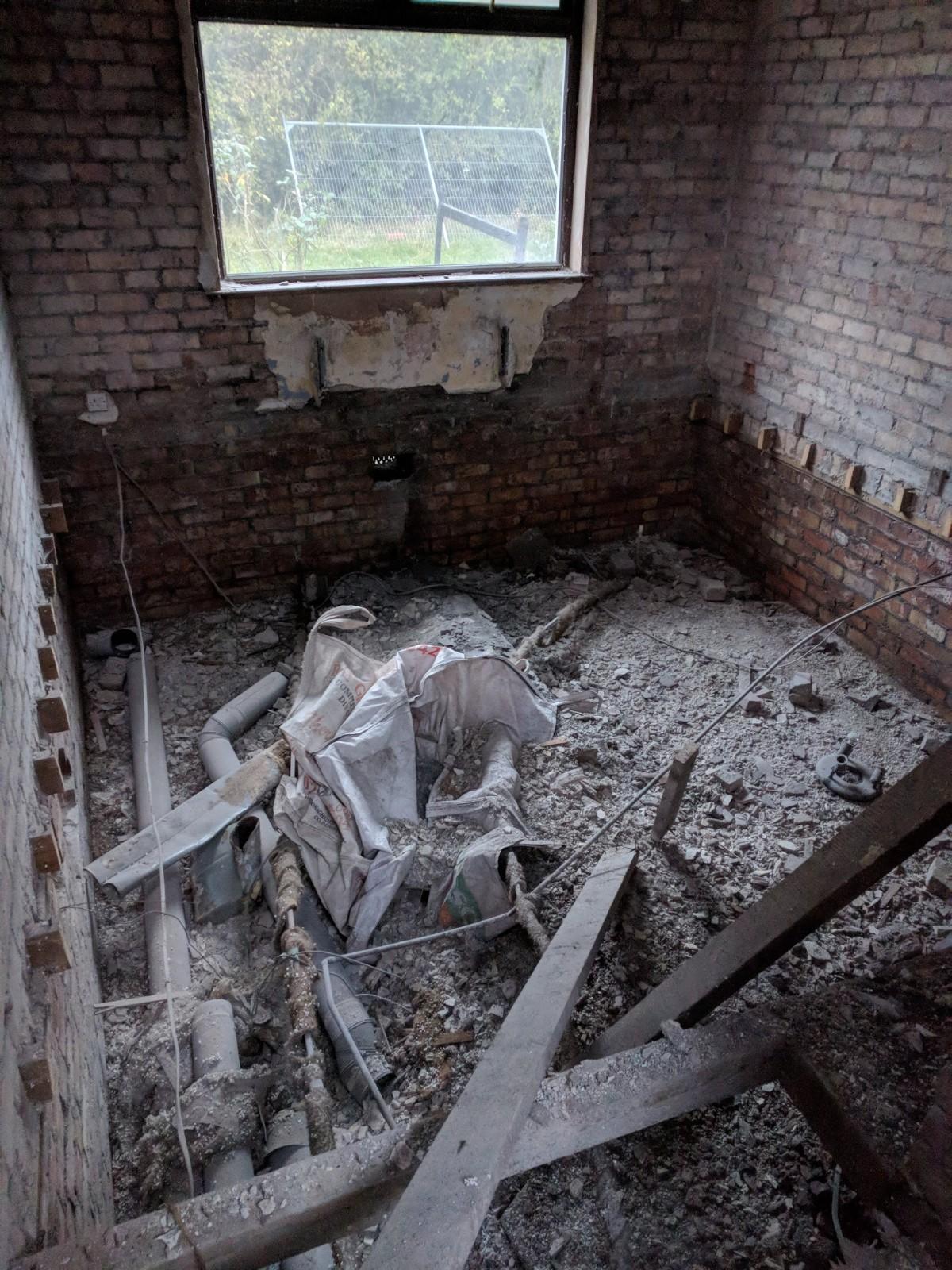

Walls stripped, floors lifted. Joists and floor boards being kept for future use on outbuldings, furniture etc.

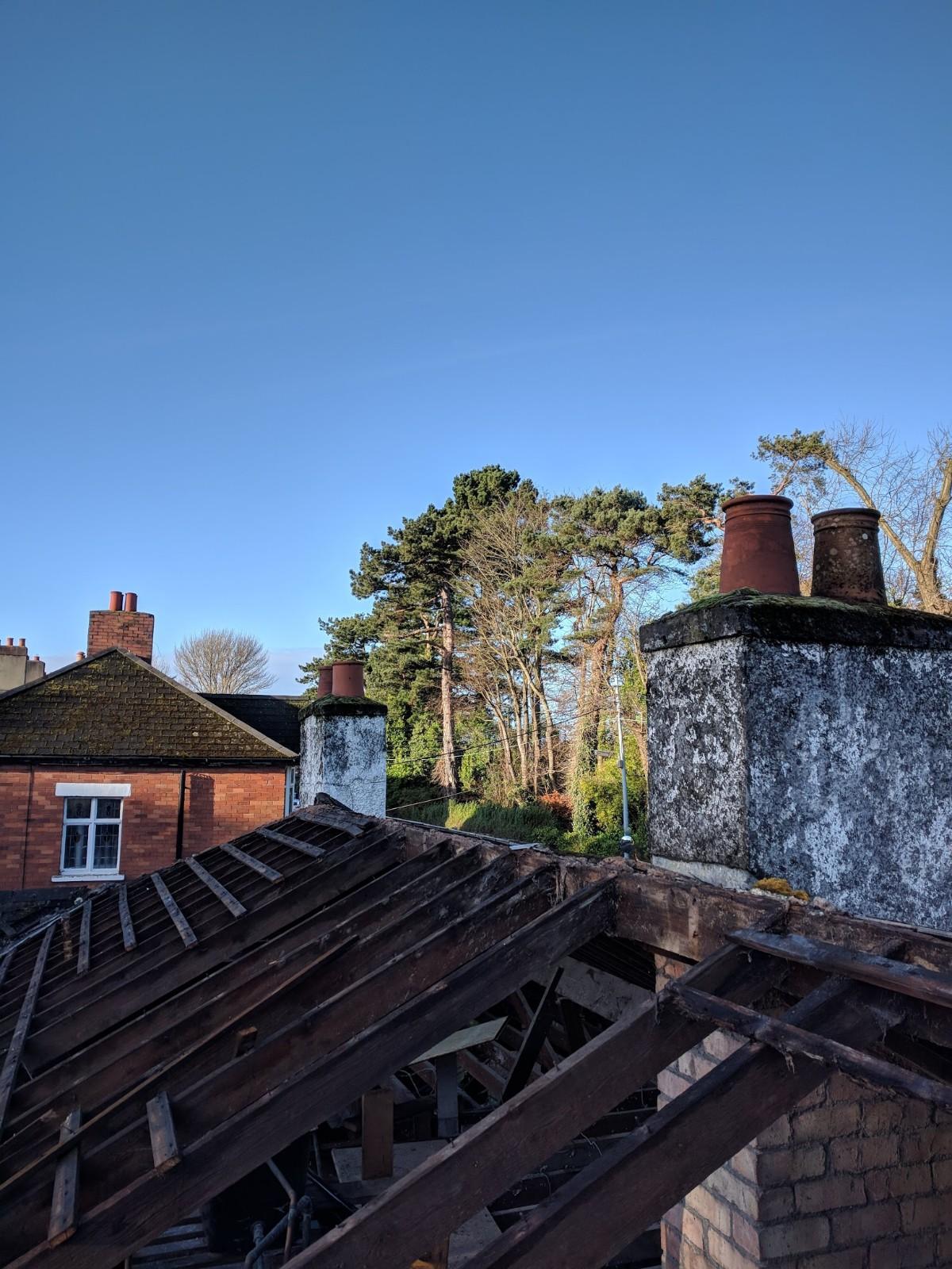

Roof stripped of natural slate tiles. Mostly done from inside the attic, with slates lowered down on pallets on a telehandler.

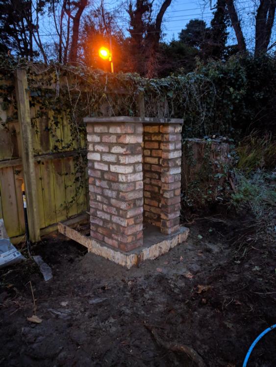

It did mean I was able to build my electric kiosk for cheap.
Now that's a good idea. I don't have a house to demolition but I do have some old bricks on site that would otherwise go in to a skip. I could keep some for an electrical kiosk and perhaps even some planters.
