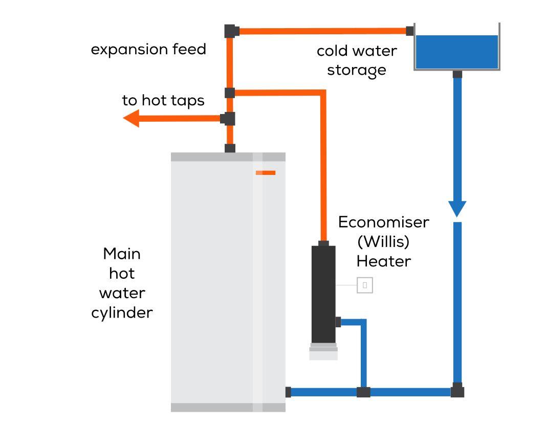

Willis Heater approach

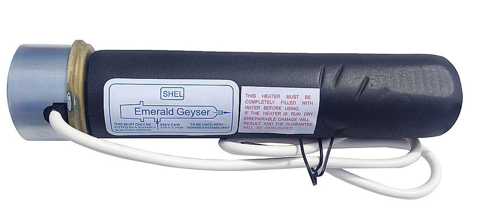

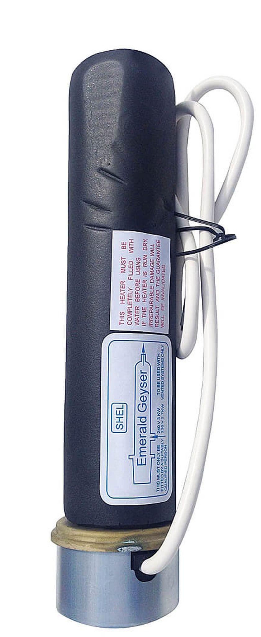

So therefore looking to heat the UFH with 2x 3Kw willis heaters in order to progress with the internal house work. Thought I'd add some info on here as a lot of people like myself aren't familiar what they are. They originated out of Ireland and still much in use over there. They're essentially external immersion coils and instead of sitting inside a tank are simple external electric units - AKA "Willis jacket", "standard sleeved immersion heater"," inline electric heater". Googling should get you something like this:
Willis Immersion Heater | Shell & 3kW Element
Item Weight 1.15 Kg
Product Dimensions
30 x 9 x 9 cm
I have tried to get plumbers interested in rigging this up, but they're either not interested or have told me it's not possible/don;t know what a willis heater is. I've managed to plumb in all the Hep2o in the house, so hopefully this won't be too much of a bodge.
@TerryE has kindly discussed his set up which is pretty impressive with his DS18B20s set into the walls etc. I'm no programmer and my javscript is mainly simple web stuff and wanting to get heat into the place ASAP, I just want a KISS approach for now. Perhaps later I will think about having some of it programmed using Terry's Node Red option which makes for interesting possibilities. Get a feel for Terry's approach here:
But as I've said, I'm after a bog standard dummies approach to this - seriously KISS:
So rather than wiring up room thermostats to the wiring centre, I will for now simply use the Willis inbuilt thermostat and set that to gradual increasing temps from 10oC up to a max of 25oC. A gradual heat increase seems safer in my mind. My only concern is if the Willis thermostat fails and carries on beyond 25oC - up to max temp. Obviously I will have the manifold mixing/blending valve that should restrict temp flow into the UFH also, but is there a further failsafe to consider?
Dummies layout.
Eventual Sunamp units (for DHW) will be located on left of manifold so having to locate Willis heaters to right  and expansion vessel top right:
FYI: The immersions need to be turned the other way (so colder water enters the side)
Parts list:
  • 15mm copper pipe. The Willis heaters are 15mm so I presume plumbing them into the manifold with 15mm would be okay?
  • 15mm plastic pipe for cold return should suffice I presume?
  • Bottle vents - automatically release any trapped air (like this one). Do I need any and if so where do I place them?
  • Willis heater (ebay has the cheapest)
  • Expansion vessel - 8litres sufficient for total UFH volume of 130L? (like this one
  • 20A DP switch outlet (for each willis) from a 16A MCB (like this one)  . Probably one for each willis
  • Immersion timer (like this one) to be added possibly when I change over to E7 low tarriff rates
Will get an electrician to wire it all in for me!
Be grateful for comments, suggestions and any answers to above questions!

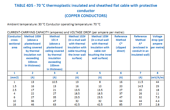

  On 26/02/2020 at 12:34, oranjeboom said:
So next question is what cable to bring in from the fuse cupboard to the willis heaters bearing in mind I will have two of them?
Expand
This is one for your electrician.  This is 240V stuff and needs to be Part P compliant.  I switch all of my power circuits using Crydom SSRs (sourced from RS Components).  IMO you should be wary about most IoT style switches; whilst many are nominally rated at 16A 220V, you will be driving ~12A for many hours per night.

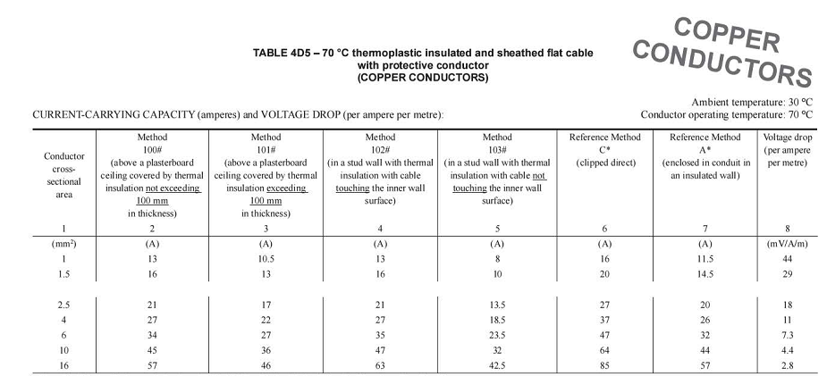

Jeremy Harris
Posted
For a single cable, nominally 10m long, running through some insulation in the ceiling, you could just about get away with using 4mm² T&E to supply both heaters.  4mm² run like this through ceiling acoustic/thermal insulation would be downrated to 27 A, and 6 kW at 230 VAC is about 26.1 A.  In terms of voltage drop, 4mm² is more than adequate over 10m, though, and would be OK for a run twice as long with no problem.
Onoff
Posted
Expand
Ref Method 101# in Table 4D5 applies assuming his insulation is thicker than 100mm. Then 4mm is rated at only 22A. Would need to up to a 6mm.
Jeremy Harris
Posted
Expand
Standard for acoustic inter-floor insulation is 100mm though, plus I did make it clear by adding "you could just about get away with" as a qualifier.

Even applying a very conservative derating factor 6mm² is fine.  The cable could be buried deeply in any non-EPS insulation and not have a slightest issue with over-heating.  4mm² would be OK if only covered with 100mm of insulation, and if not covered with any insulation, but clipped direct, 2.5mm would be just about OK (not that I'd recommend going down to this small a section cable for this sort of application).
I well remember chatting to a chap from Batt during a break from an LV Directive Working Group meeting years ago, who was literally getting hot under the collar at the way cables were being very conservatively derated by the IET.  There's often a fairly big discrepancy between the ratings that the cable manufacturer's publish and those in the tables in the blue book.  I've never been sure why (and the Batt chap didn't know either).
For example, this is Table 4D5 from Batt:
Note that it gives a current carrying capacity of 27 A for 4mm² T&E when covered by more than 100mm of insulation above a plasterboard ceiling.
By contrast, this is Table 4D5 from the current edition of the blue book:
That gives the current carrying capacity of 4mm² T&E as being only 22 A when covered by more than 100mm of insulation above a plasterboard ceiling.
Given that, in general, MIs should over ride anything else, and as BS7671 isn't law, it's just guidance, there is an argument that supports the view that we should use the manufacturer's data, as they are the ones that have tested and certified their own products.
Onoff
Posted
I'm looking in the OSG, specifically Table F2.
If the cable is totally surrounded by thermal insulation, for example 500mm or more then you must derate by a factor of 0.5. It assumes the insulation has a thermal conductivity greater than 0.04 Wm-1K-1. (Sorry, can't do "to the power" of on this phone). Surrounded for only 50mm of its length it's still a factor of 0.88.
In layman's terms, passing through insulation creates a pinch point/hot spot for the cable.

Would two of these fit the bill? https://www.cef.co.uk/catalogue/products/4574801-24-hour-7-day-single-channel-1-module-digital-din-rail-timer
  On 27/02/2020 at 18:56, Onoff said:
Over what length will it pass through the "loft roll" and will it be totally surrounded by said thermal insulation? It's important as you may have to apply a derating factor.
Expand
A total of 300mm. All clipped against timber.
Onoff
Posted
Expand
That's good. Clipped direct against timber is not considered totally surrounded!
Jeremy Harris
Posted
Expand
It's much more subtle that that, as the manufacturer's higher ratings for a cable in insulation show (and it's not just Batt, other manufacturers have their own specs and ratings).
There has long been a debate about the way heat is dissipated from cables, and one factor that the rough and ready guidance in the OSG ignores is that most of the heat built up in a short insulated section of cable ends up getting conducted out of the insulated section, as the thermal resistance of the copper is massively lower than the thermal resistance of the insulation sheath and surrounding insulation.  The result is that short sections of cable within insulation don't run anywhere near as warm as might be expected.
The time factor is also very important, and the ratings assume continuous use at the rated current, whereas in a domestic installation it's rare for any circuit to be taking its rated current for more than a few hours, often a lot less.  It's one reason why, despite it being commonplace for loft insulation to be laid over cables years after they were installed, including cables feeding things like electric showers, it's not that common to find a cable that's overheated in the middle of a run.   Part of that is that the cable can safely operate at a fairly high temperature, usually higher than the stuff connected at either end (the classic being SWA, that is often rated by the manufacturer at 90°C, whereas switchgear etc is rarely rated above 70°C).
It's reasonable that the guidance in the OSG errs on the side of caution, but the OSG is not regulation, or law, it's just rough and ready guidance to how the blue book might be interpreted, in short form, as an easy to reference guide.  If someone chose to use, say, Table 4D5 from Batt, as they were installing Batt cable, then it would be perfectly legal to do so, as Batt have provided a clear specification for their their cable, showing that it complies with the requirements when used within their stated ratings.
