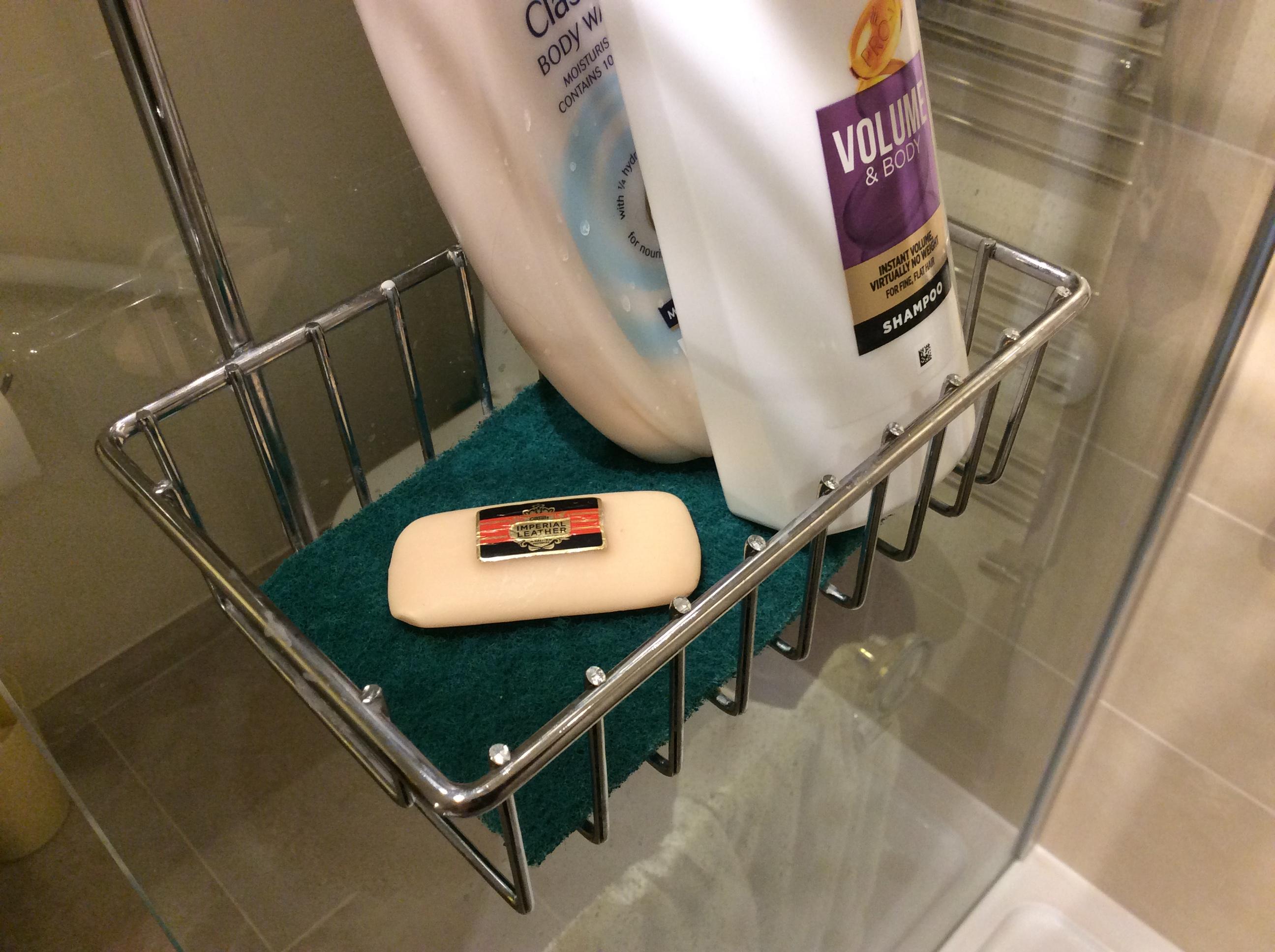

Ok Problem fix. Half used soap falls through wire hangover soap dish.
Solution is new kitchen scourer cut to size. if I were being posh, I would use one of the samples of walk on shower non slip matting I have.

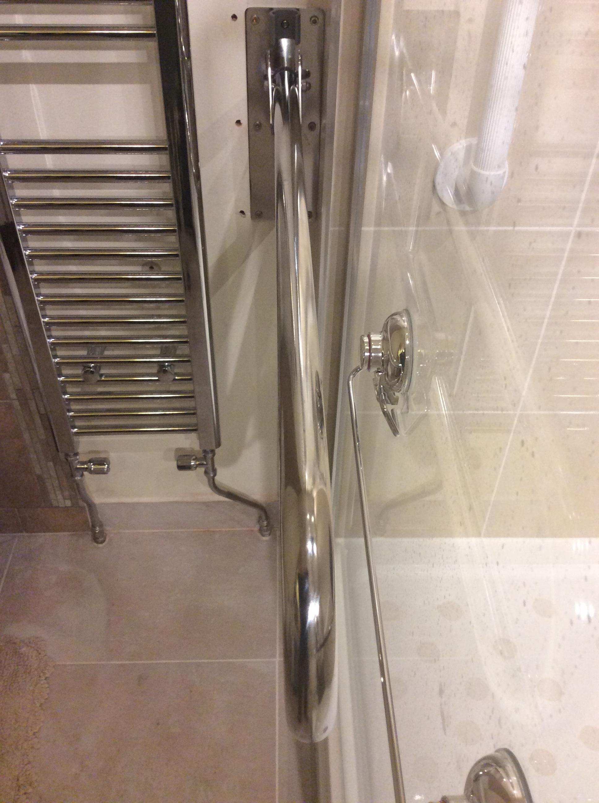

Notes of an update, which perhaps would benefit from an article of its own.

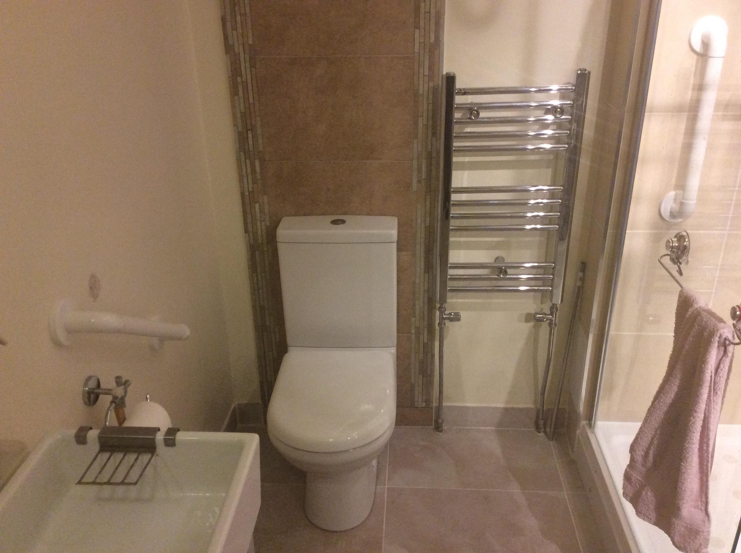

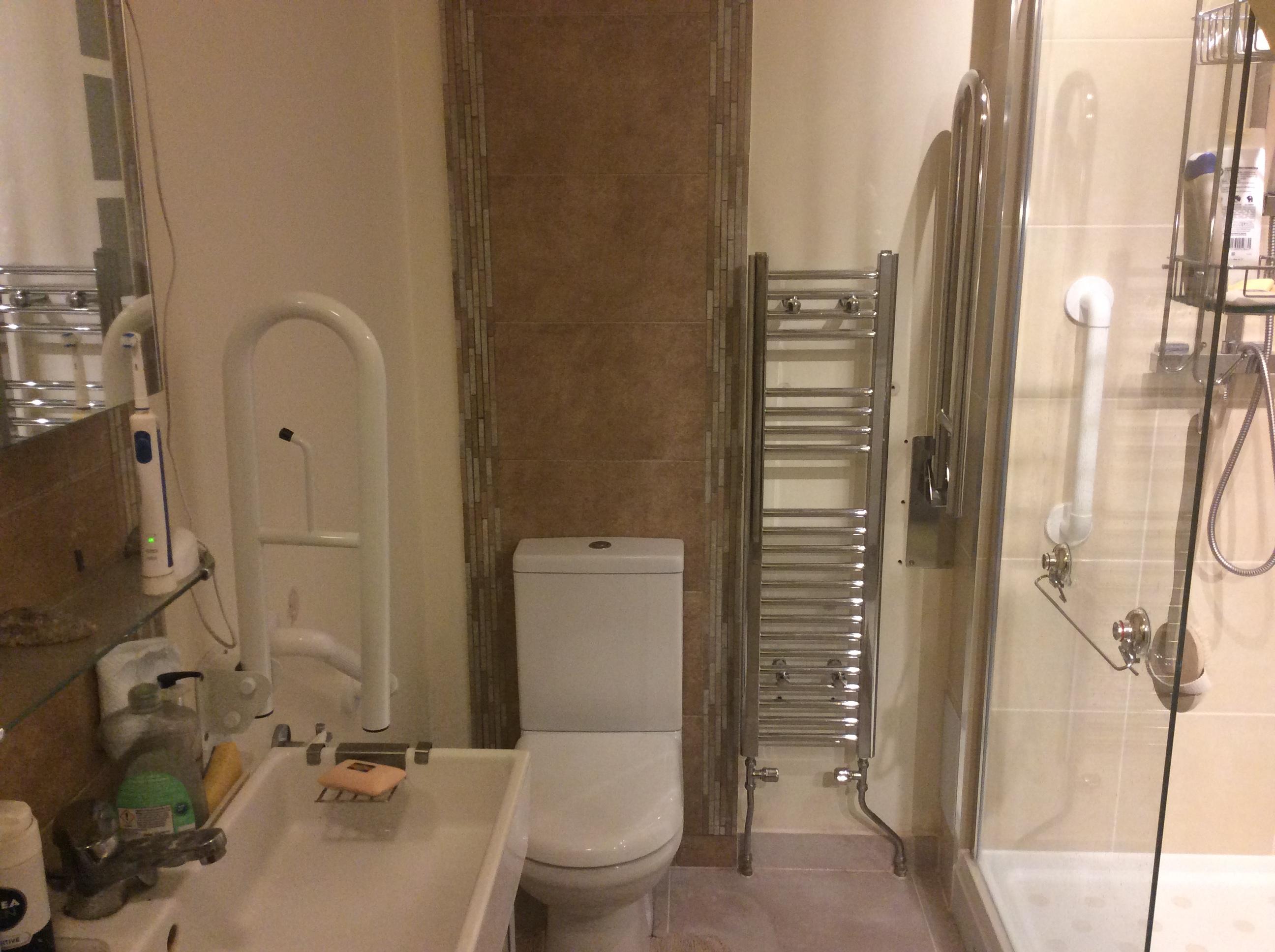

Before:
After:
1 - Grabrails

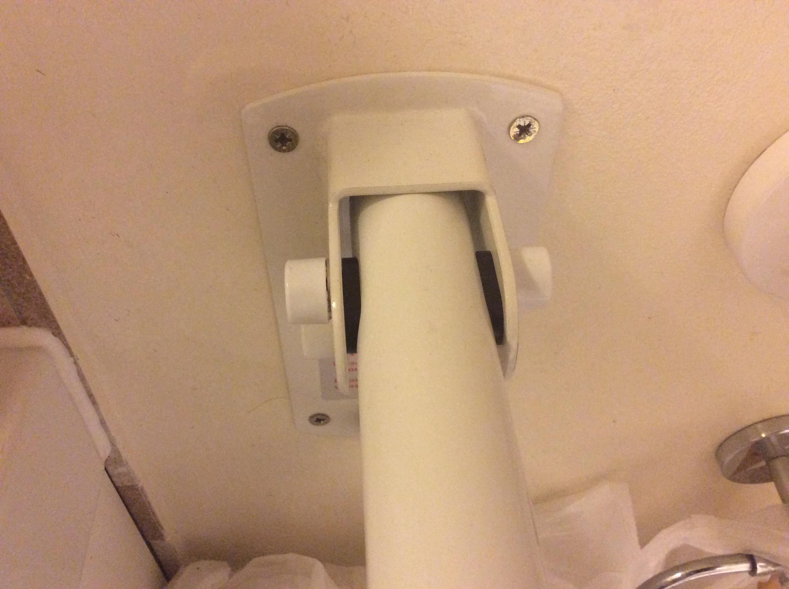

The older person for whom the room was adapted has spent a couple of weeks mainly in a wheelchair, following a slip off the settee (note to self: investigate a custom cushion with non slip fabric for the settee). This slip was caused by weakness following sickness for a small number of days, which caused some weightloss - only 2-3kg , but significant for someone weighing around 43-45kg. Recovering more normal energy intake will help that over several weeks.

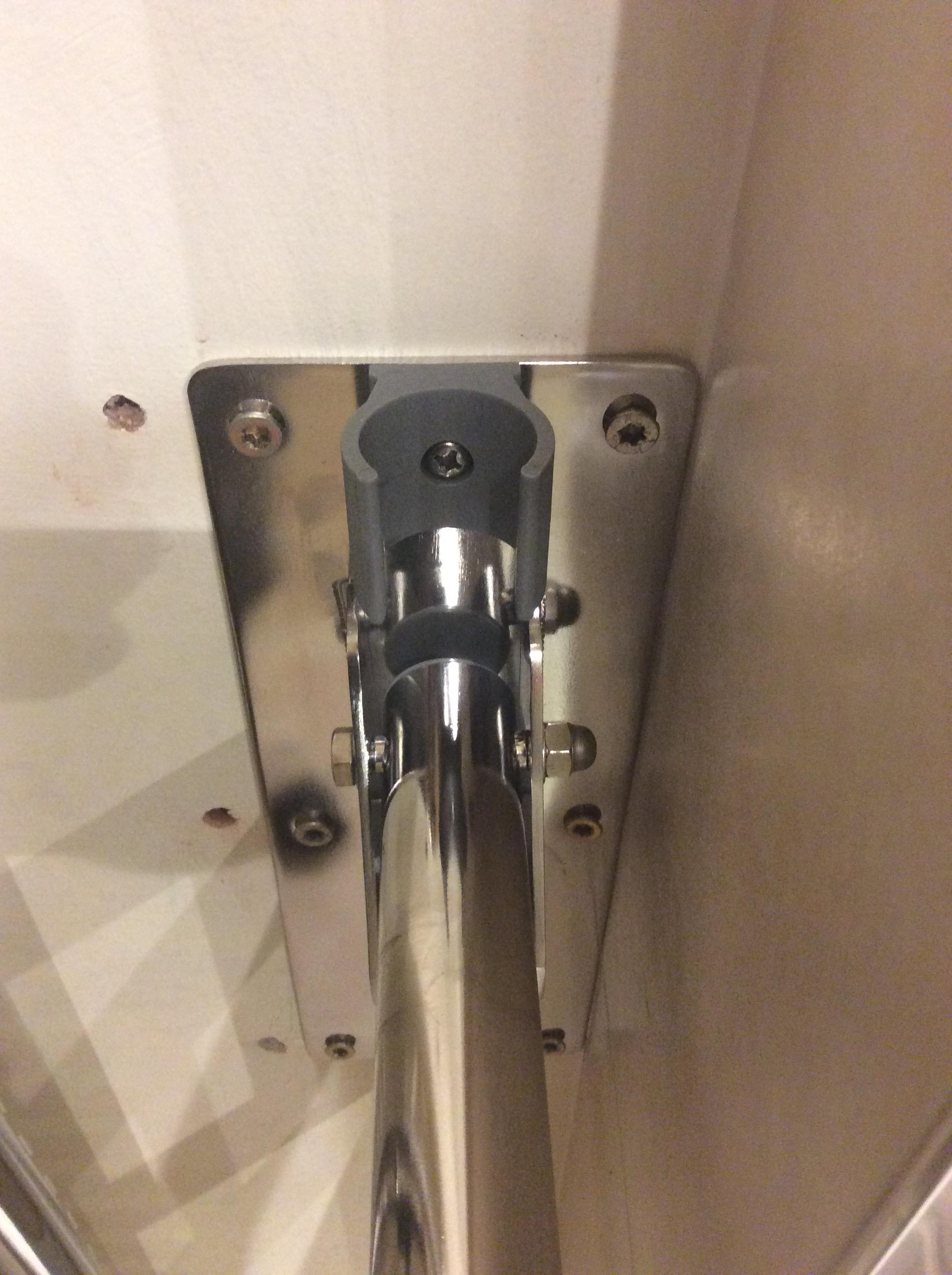

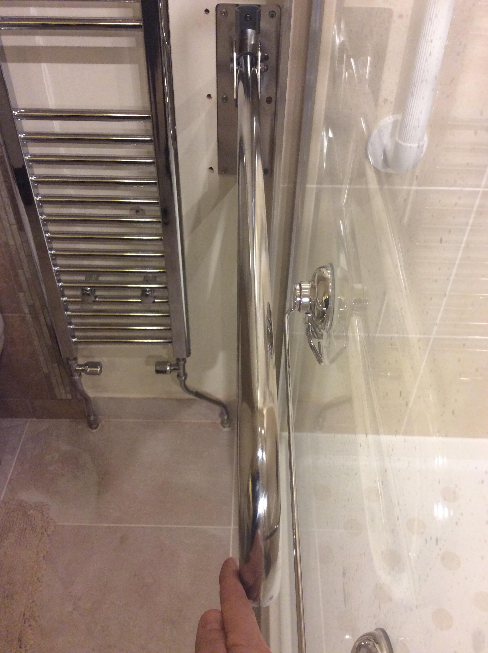

A couple of months in we have made adjustments to some elements that had been left in until we had decided what to do. We have fitted trombone-Hitler grabrails as per the photo below. I have no idea what the real name is of the piece of kit.
On these grabrails we have fitted 2 types bought from Screwfix, Croydex have not been very impressive in this situation, Nymex have been. Croydex have more play at the hinges, whilst Nymex have rubber bushes at the hinge to hold the rail steadier.
The extra row of holes is where we got it slightly wrong with the stainless steel grab rail.
( * The action is like a fascist salute, and it looks like a trombone; it seems highly appropriate to remember an evil Dictator in the name of a piece of kit to benefit people he wanted to kill, in the spirit of The Producers.)
2 - Radiator Width
We have also narrowed the radiator, as the previous one is exactly the same width as the wheelchair usually used in the shower room, which has the effect of preventing the wheelchair backing against the wall by about 50mm. That may seem like a detail, however gaining an extra inch makes the transfer if the user wishes to do it sideways (rather than face on) feel more comfortable.
That is an example of how tiny details can make a difference.
3 - Squeezable Wheelchair
Another detail is that the wheelchair used for this bathroom is a folding wheelchair, and the width can therefore "squeeze in" by about 2cm, which makes it just fit between the loo and the shower, and also slightly wedge itself in, which also helps. I admit that that was not planned.
4 - Turning Space
Remarkably there is also room to turn the wheelchair in the alcove by the shower, though this is miles from meeting regs for a turning spot.
None of these details would work for a larger or taller man, but in these circumstances they do - a strategy of "marginal gains".

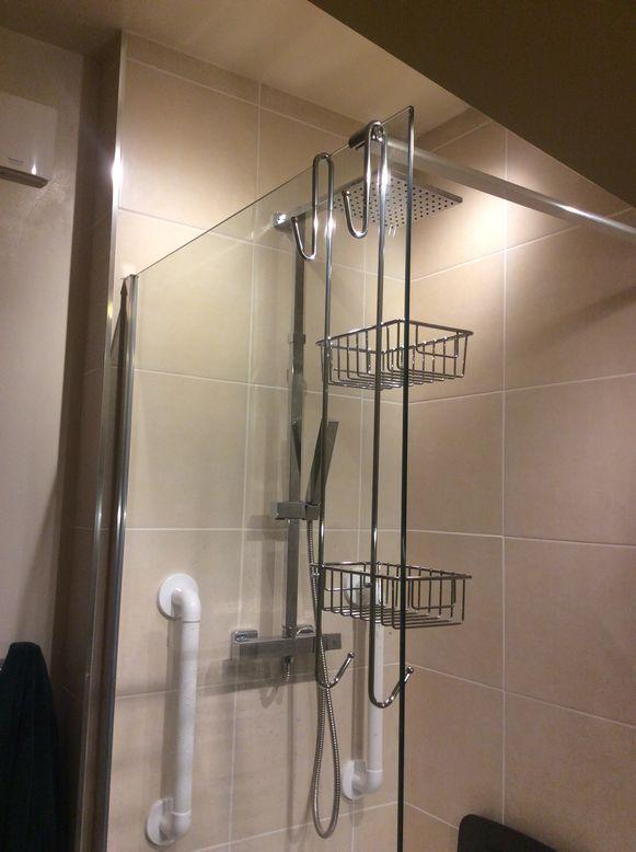

5 - Wheelchair Accessible Shower
I also have a plan for making the shower wheelchair accessible should that prove necessary, which simply involves removing the end screen (about 4 screws at the wall end, the block at the top, and a Stanley knife cut along the silicone bead at the bottom), plus raising the floor by 125mm with a tightly fitting but non screwed stud frame, and a ramp from the door, which would then be topped with ply and tiled or covered with vinyl. This can then be removed to do a full restoration later.
