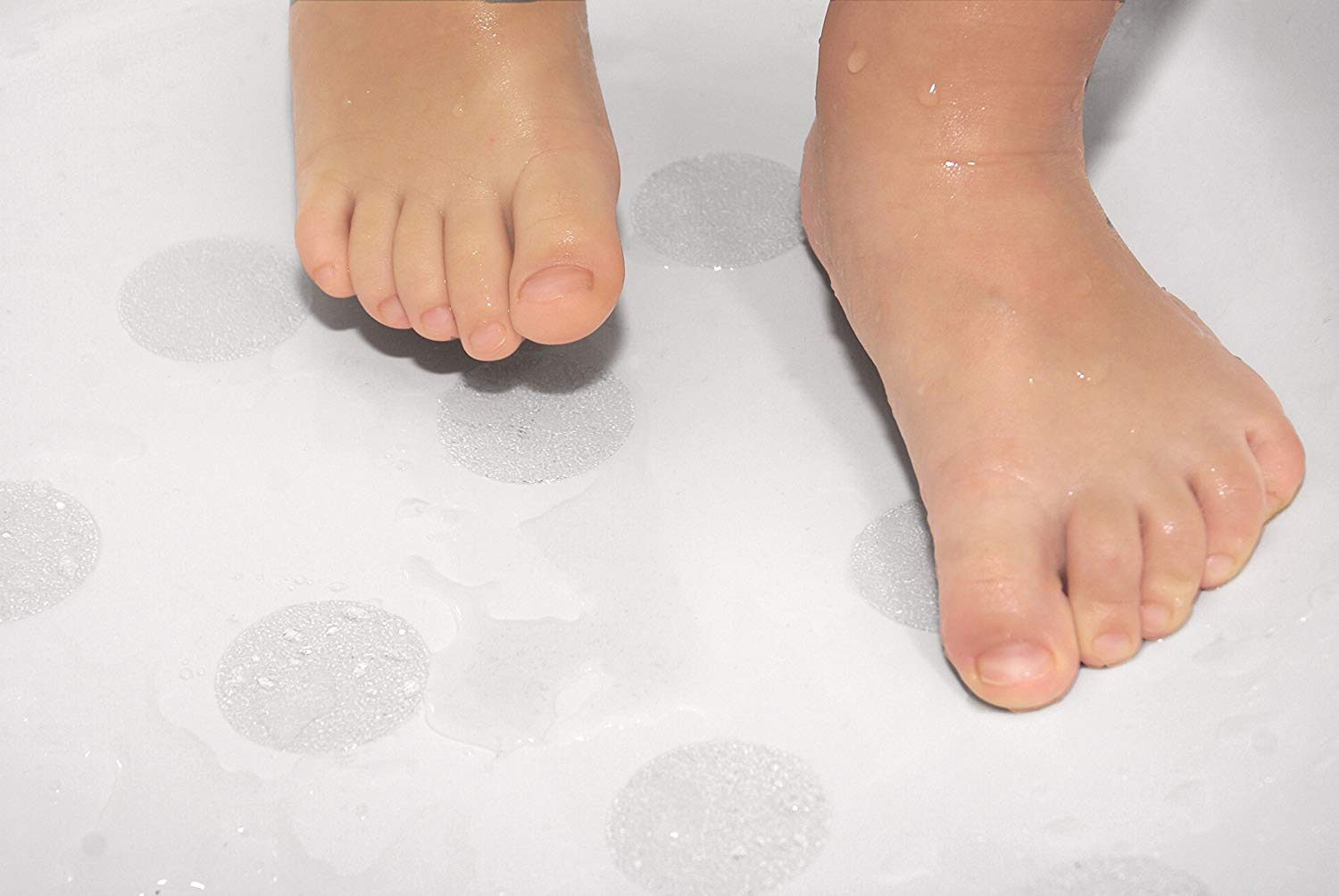

June 8, 20197 yr Author I am now looking for thoughts on non-slip mats for the walk-in shower. In a wet room environment the floor comes textured as a matter of course, unless somebody gets it badly wrong. My walk in shower has a smooth tray, properly textured trays being a little rare, and I now need to find a suitable mat for both new walk in showers. Might as well do both. I will need one that is about 600x1200mm and one that is about 750mm x 1500mm. I have seen these things about the size of a tea towel or a hand towel that the showerer needs to take care to stand on, and I would prefer something which makes the whole thing non-slippy .. perhaps more like the things you find around swimming pools. These look alright, but I would prefer the whole thing covered: https://www.amazon.co.uk/Bath-Shower-Safety-Durable-Bathtub/dp/B077RX8F2H/ I guess that in theory a piece of wet room liner cut to shape could be used if it is strong enough and weighty. I am also considering a product called Gripwalker and similar where you order a length off a roll, of width 122cm or 91cm. Need to make sure that is soft and comfy for delicate feet. Not chap, mind at about 50-60 per shower, though it should outlast mum. Any thoughts? Especially @AliG F Ferdinand Edited June 8, 20197 yr by Ferdinand
June 8, 20197 yr Well remembered @Ferdinand My dad was terrified to use the shower in my parent's new place and almost hurt himself it was so slippery. It was a steel tray and you could barely stand when it was wet. I ordered these from Amazon- https://www.amazon.co.uk/gp/product/B017O89SG2/ref=ppx_yo_dt_b_search_asin_title?ie=UTF8&psc=1 They are very pleased with them and have had no issues since we got them, I think I got 64 of them in the end and they spaced them out every few inches on a 1.4m wide shower tray so that anywhere you stand you will always be on one Less obtrusive than a mat and they can't slip. I'd get a picture from their shower but they are on a cruise, here is the picture from Amazon. Edited June 8, 20197 yr by AliG
June 8, 20197 yr I would go for stick down ones too. Anything that allows water underneath will either need to be lifted everytime or will get absolutely grotty underneath
June 9, 20197 yr Author I think i'll be trying the stick down ones initially, as I guess they will require some careful abrasive cleaning done later. Ferdinand

June 10, 20197 yr Author 19 hours ago, Ferdinand said: I think i'll be trying the stick down ones initially, as I guess they will require some careful abrasive cleaning done later. Ferdinand I have ordered some of these: https://www.amazon.co.uk/gp/product/B017O89SG2/ and a Mira Premium Shower seat: https://www.screwfix.com/p/mira-wall-mounted-premium-shower-seat-grey-chrome/8104g The shower seat feel extravagant but the user will be sitting on it, so it will be the thing that most affects comfort. Ferdinand
