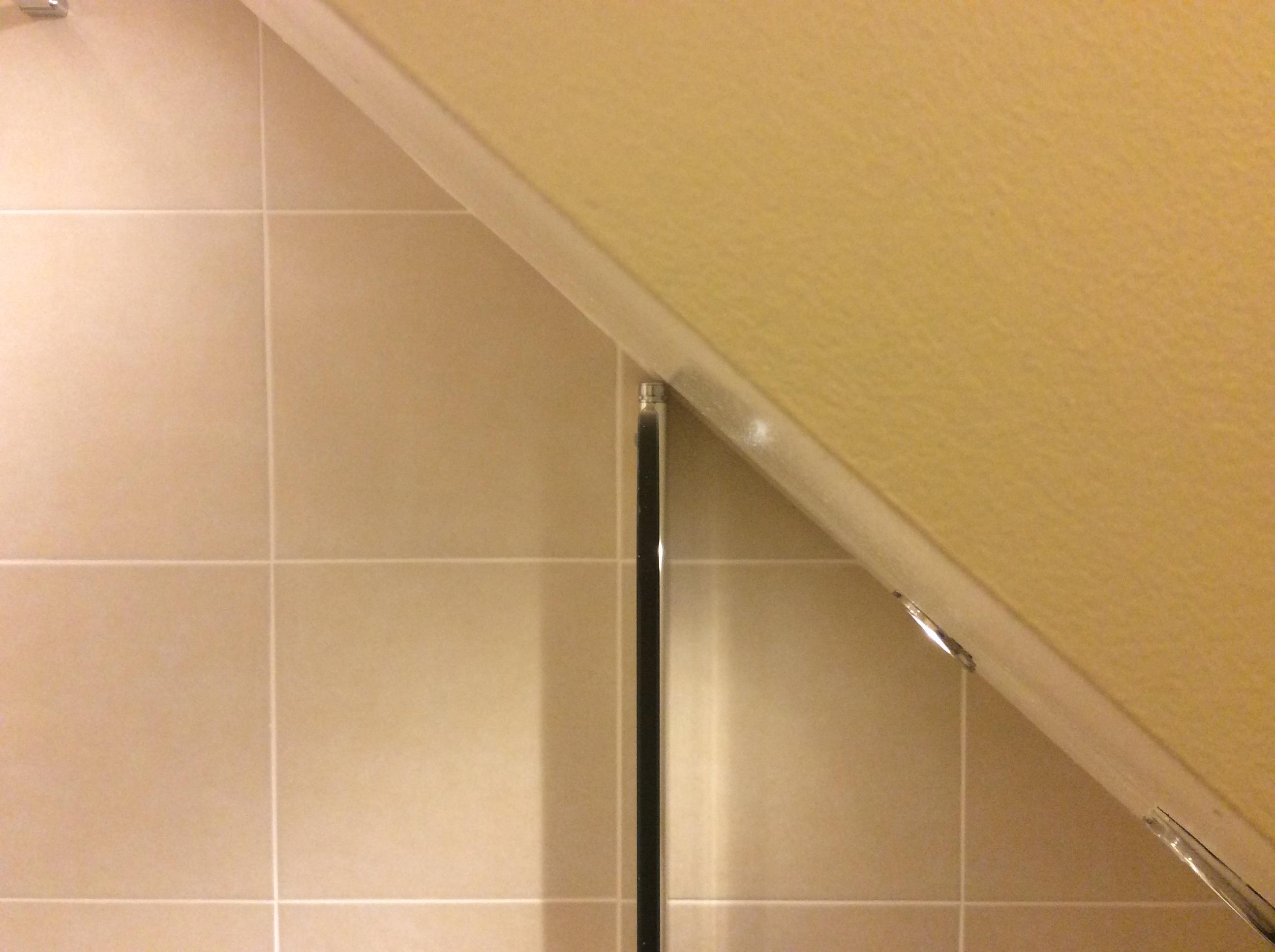

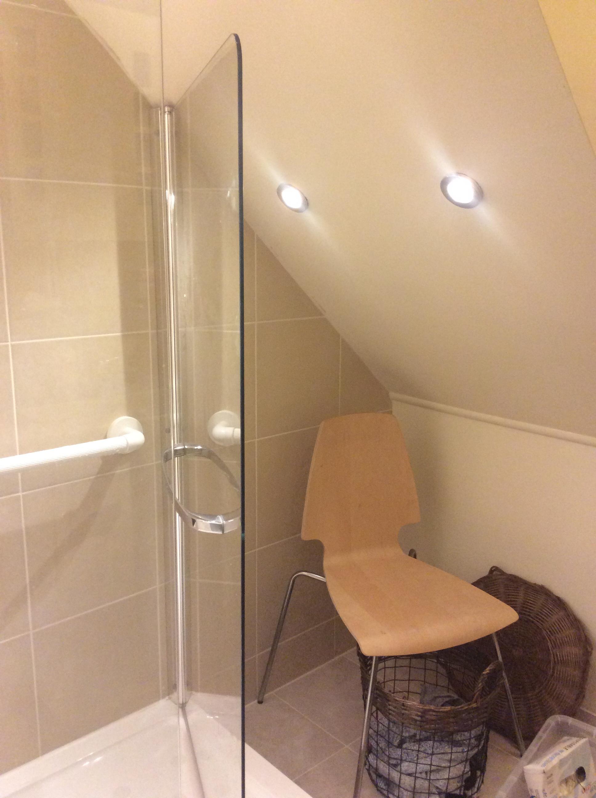

I have repurposed the former hinged bath shower screen as the end screen of my walk in shower, as it is under the stairs. A side benefit was to be that the narrow 450mm entrance gap would you be opened a little wider for horizontally more extensive people, or putting a shower seat inside more comfortably etc.

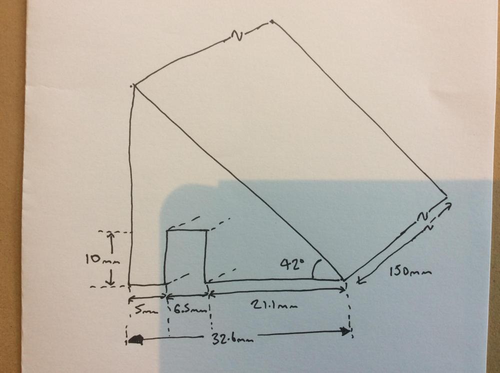

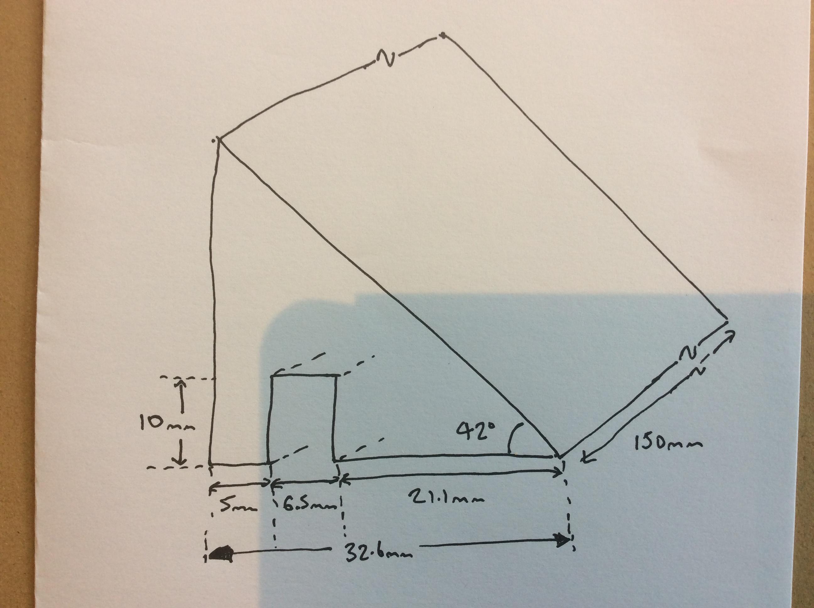

Due to a need to reposition the shower closer to the stairs, there is now such a minimal gap that I need to fix the screen in place, rather than let it move. So I need a part with a 42 degree upper surface and a slot to fit over the top of the 6mm hinged screen, which I can then glue or silicone in place.
Pics and a diagram are below

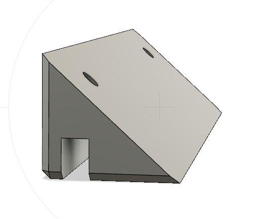

We came up with a design incorporating a toblerone shaped 3d-printed "thing", which could be glued to the top of the glass screen, and glued and screwed to the ceiling.
After creating a "prototype", which was nearly but not quite right due to a measurement inaccuracy, it works beautifully.
