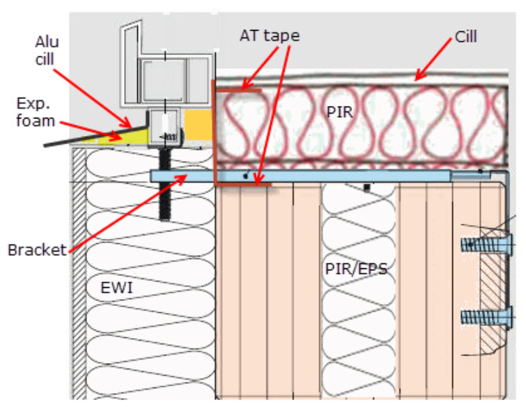

My next job is to get started with the internal plastering, so I'm looking at how to detail the internal reveals and cills. My plan is to insulate under the cill also. Cavity wall will most likely be filled with PIR where I can force it down or EPS beads (with a bit of PVA). I'll then fix 60mm PIR board to the now insulated cavity wall using PU adhesive. I'll have to channel out a bit of the PIR to accommodate the window brackets so the board sits flat:
I should have enough clearance then to fit a wooden cill on top of the PIR. Not sure how best to affix that to PIR. Maybe the plasterboard reveals will sit on top of the cill and help pin it down.
Probably overkill with the EWI, but my intention was to also insulate the reveals (see grey EPS example above) with 20-25mm PIR board and then plasterboard over the top. Just need to leave sufficient space to get at the internal beading in case the glass ever needs replacing (sons and footballs....).
The other consideration is to decide where to stick the air tightness tape. Initial thought was to stick that on face of window frame and onto brickwork before I stick down the PIR board. But how well does the stuff stick to clean brickwork? I could add a further layer of tape from window frame and stick to top of PIR board before the final cill goes down.
I'll try and post some drawings up here later on.
Not great, but some of the intended detail:

gravelld
Posted
Did you do the TB analysis for comparing the brackets with frame? Plywood's lambda is a lot lower than that metal's... Just wondering.
oranjeboom
Posted
Each window frame only has a few brackets (depending on weight/size etc), so no, I did not do any calcs, just figured that I would be needing more than plywood to keep some of my windows in place. All of the metal fixings would also be completely be surround by insulation so minimal bridging in these particular locations. The other advantages with the mechanical fixings is that you can alter the x,y,z positions in case of last minute adjustments with the window frame.

Wookey
Posted
It is indeed very rigid. It's essentially like a piece of timber. I've just used my first bit under the front door, and am planning to use some more for the EWI windows as in this thread
I've also just done the calculation comparing 100x75 compacfoam batten, 50x50 timber batten and 6 off 3mm thick stainless and galv brackets 80mm wide. This is fitting a U=0.92 PVC+ali frame into 160mm of pavatex woodfibre, so Wall U is 0.19. I used Therm for the sums (which is a very annoying piece of software!).
Psi values:
compacfoam: 0.008 W/mK
timber :     0.014
galv bracket: 0.041
Stainless bracket 0.036
However as the brackets are only 11% of the length the average psi is:
galv: 0.012
stainless: 0.011
So compacfoam is best, but metal brackets are fine too so long as the frames are well-lapped with insulation. Stainless brackets seem surprsignly expensive.
