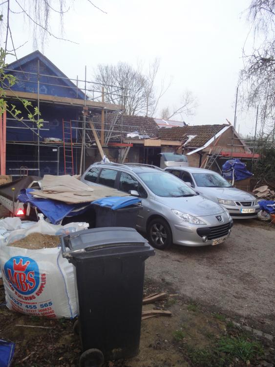

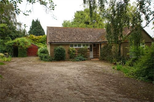

Having rented all my life, desperation set in after being gazumped, shafted and outbid in the so-called 'property game'. But it's no game if there's no fun! Finally, after getting lucky with an honest and reliable estate agent, I came across a place on the fringes of a small Kent village.The empty property was snapped up by us as soon as we laid eyes on it. Overgrown, but cared for, it dates from the early 1950s and was (is!) structurally sound.

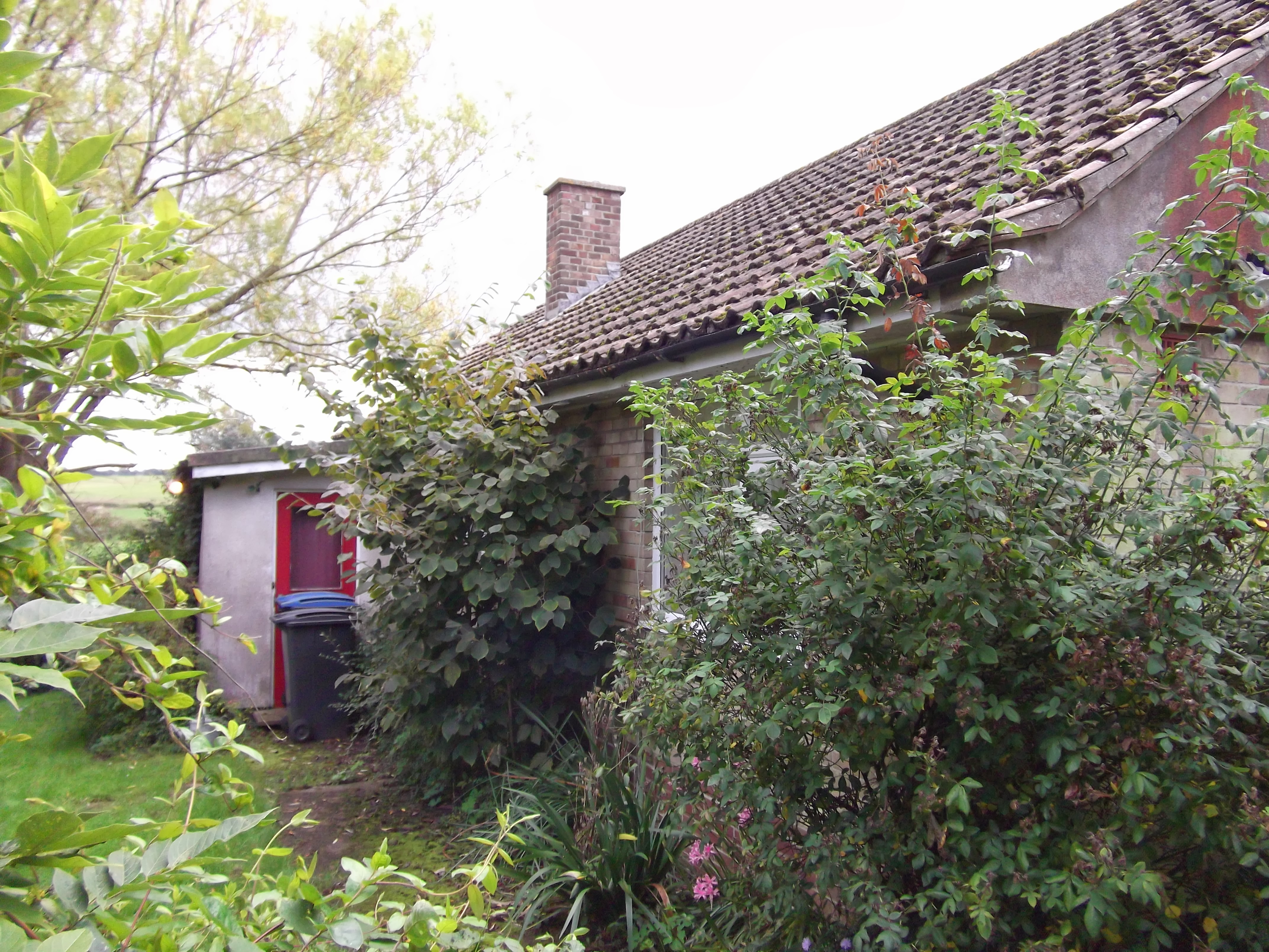

Lots of vegetation on the plot and lots of it too close and too big, right next to the building. Loose gutters, heavy concrete roof tiles.

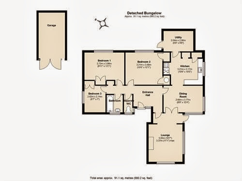

It had it's issues being dated, oil central heating and a bit cramped with only 2.5bedrooms. It was also badly laid out with only 2 bedrooms looking out to the rear 1/2 acre plot.
Things needed re-jigging, and in doing so, we would also extend the place.

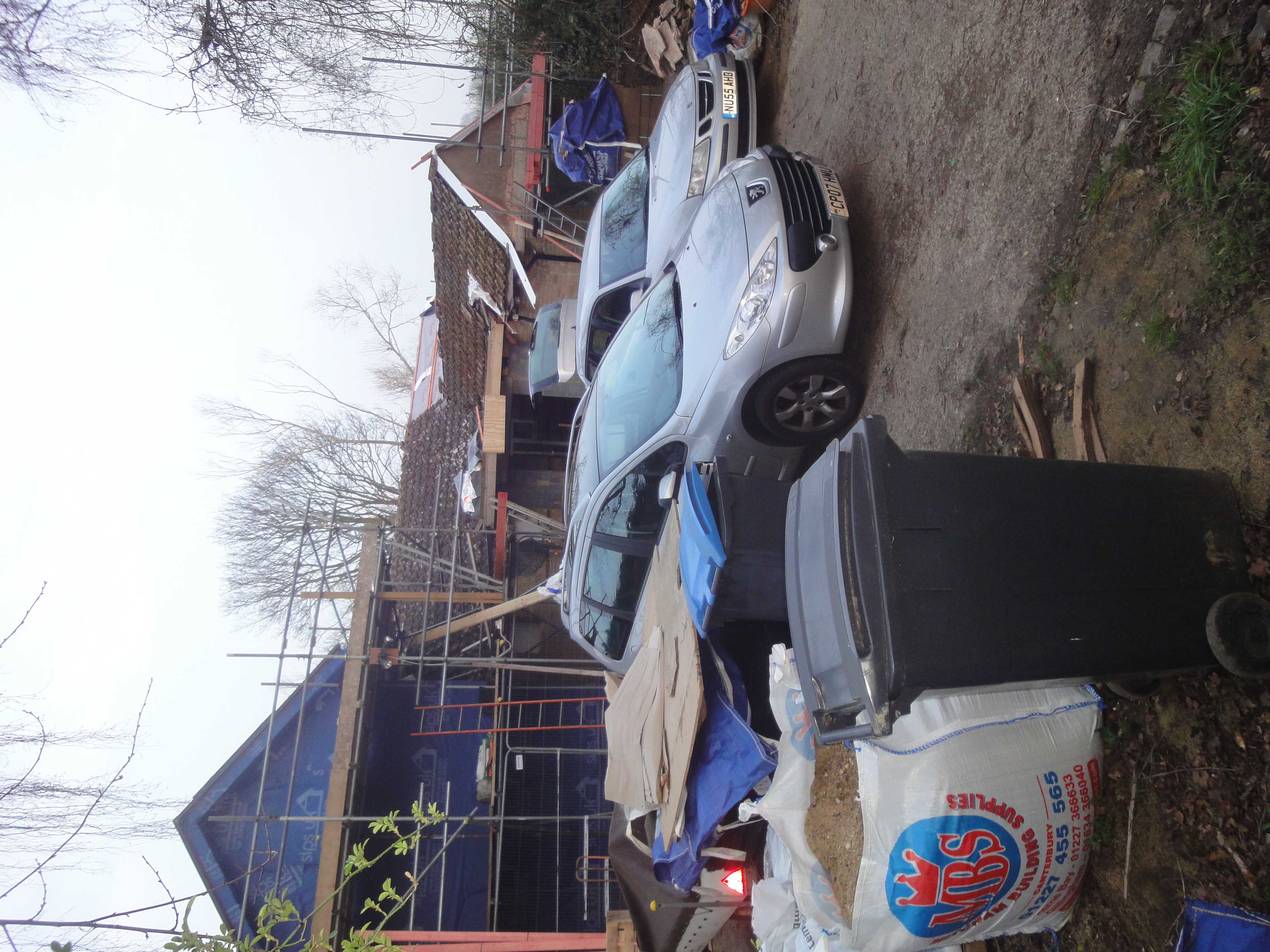

Sorry Joseph, 'just' came across your question. Two extensions are SIPs. No new 1st floor to bungalow. Bungalow has been gutted (slab, roof tiles, some ceilings, windows, wiring, plumbing, rads).
