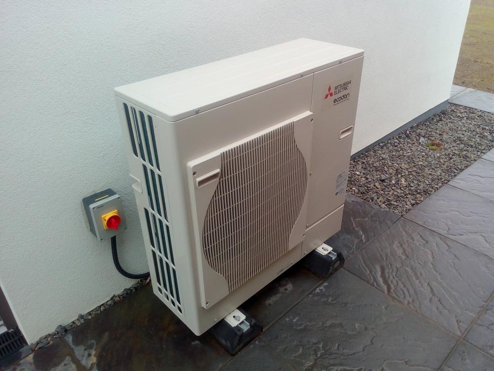

We opted for a package from Mitsubishi Ecodan, an 8.5kW heat pump and 300 litre pre-plumbed cylinder fitted with the Mitsubishi FTC5 control panel. Given our location, we opted for the coastal model, which is treated with acrylic resin for enhanced corrosion resistance.  Whilst a pre-plumbed cylinder is more expensive than a bare cylinder and associated parts, after taking labour (plumber and electrician) into account, I found there was very little difference in cost.
I sourced the package from a trade supplier, Secon Solar. I found their price list while searching online and having phoned the company, and perhaps fortuitously speaking to the managing director of the firm, found they were quite happy to sell me package at trade / installer price, the bonus being that delivery to my location was free.
The package is configured for the UK market, the only difference to the system as sold in the rest of Europe (AFAIK) being that the cooling function of the heat pump is disabled so that the product complies with MCS approval for claiming RHI.  It is however a simple task to activate the cooling function, by flipping a dip switch in the control module on the cylinder.  Cooling can then be controlled from the master controller.

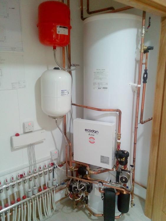

As stated in an earlier blog entry, the heat pump and cylinder were fitted very quickly with simple connections on the plumbing side – flow and return from the ASHP, cold water, hot water and flow and return to the underfloor heating manifold.  Electrical connections consisted of power to the ASHP, a cable from the ASHP to the control module and a plug-in controller.

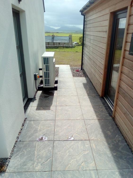

I had initially planned to have the cylinder in the utility room close to the ASHP Monobloc, but changed the location to a service cupboard in the middle of the house, to reduce internal DHW pipe runs.  This does mean a 15 metre pipe run for flow and return to the ASHP, but as virtually all is within the insulated envelope, it doesn’t represent much of an issue, and does not appear to be having an adverse effect on performance.
The ASHP Monobloc itself is located beside our back door, open to the elements.  It seems happy enough where it is, despite the wind that traverses the space between house and garage walls.  Locating the ASHP within the garage itself was an option but one I decided against simply on the grounds that I didn’t want to give up floor space within the garage.  A timber housing for the ASHP is something we may look at in the future.

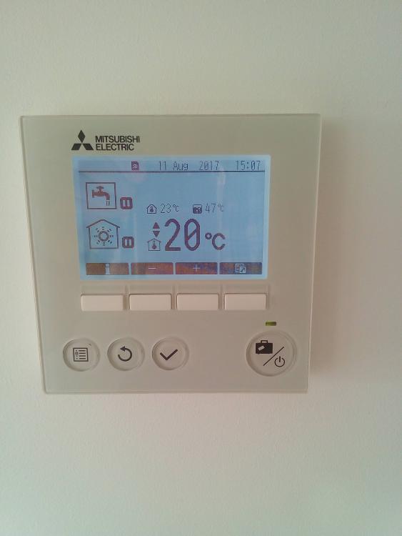

We opted to fit individual room thermostats to all 3 bedrooms, to give us the option of being able to reduce the bedroom temperatures if we so wished.  We have not used these and keep the whole house at one temperature 24/7, treating the underfloor heating as a single zone.
At present I only have limited data as to how the heat pump has performed since moving in.  On board energy metering (energy consumed and energy produced) shows the CoP for heating has ranged between 3.5 and 4. DHW is maintained at 47C-50C in the cylinder, boosted every fortnight to 60 degrees by the immersion on an anti-legionella cycle.  To date the CoP for DHW is 2.4
As members know, heat pumps are best suited to the production of low temperature heat as opposed to the higher temperatures required for domestic hot water.  Whilst the CoP for DHW is lower than that for heating, the cost per kWh of our DHW, based on a CoP of 2.4, is 5p, which is significantly better than an E7 electricity tariff.  We may be taking a hit on efficiency, but in reality all of the other options would have cost us more.
The 300 litre capacity of the cylinder means that we have plenty of hot water on tap and can comfortably run a full bath and still have sufficient left over for another person to shower.
The ASHP is currently operating on a 24/7 basis, providing heat input to the UFH and topping off the DHW as and when it determines it needs to, at whatever flow temperature it determines.  Whilst that does sound like a recipe for high bills and high flow temperatures, in practice, the heat pump delivers the lowest flow temp it can get away with to maintain our set temperature.
If I so choose, the controller lets me set various parameters such as heating curves or set flow temperatures, or indeed a timed schedule for heating and DHW. However,as the system is operating efficiently on its auto setting, and providing the level of comfort we want, I see very little reason to mess around and create my own settings.  If say electricity tariffs were to change from a single tariff to a dynamic tariff, then I would have the option of timing the heat pump operation to coincide with  lower rate tariffs.
After much thought, and indeed discussion on this forum, I opted for an 8.5 kWh ASHP over a 5 kWh ASHP, as I felt happier running a larger unit more gently than pushing a smaller capacity unit harder.  A 5 kWh unit would probably have sufficed, and in time, may be what the current unit is replaced with when it reaches the end of its life.
We haven’t yet had to activate the cooling function as any overheating (defined as internal temperatures over 23C) caused by solar gain, can, as modeled, be managed by natural cross ventilation.
Neither have we found it necessary to constantly circulate the UFH to even out the house temperature / redistribute solar gain from one part of the house to the other.  In the heating season, we found that there was sufficient circulation of the UFH during the heating cycle to maintain the house at an even temperature.  Outwith the heating season, when solar gain is at its peak, the house zones itself, the bedroom section remaining slightly cooler than the public areas, very useful on a warm summers day.
Overall I’m very happy and impressed with our system.  It has, so far, delivered everything we have asked of it in terms of comfort and convenience, and the running costs are low.  I have the capability to cool the house (via slab cooling) if I so wish, and the option to bolt on a second zone pack onto the pre-plumb cylinder if I ever found it necessary to install a second heating / cooling function – i.e. fan coil or duct heater / cooler.  The one criticism that I have is about the controller thermostat function and its hysteresis - 1C increments only. A finer degree of control would have been preferable.

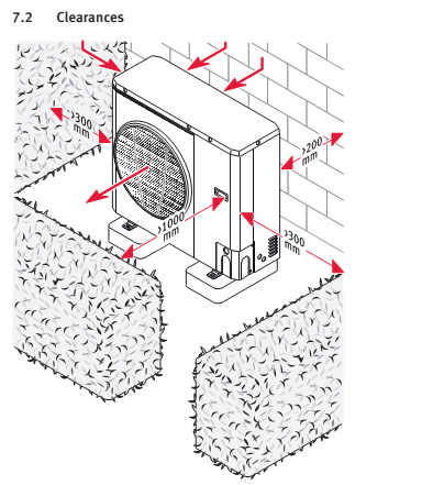

The heat pump looks to be much closer to the house than I have seen elsewhere. Do you think that in any way affects its performance?
Link to comment
It's 250mm off the wall.  Doesn't seem to be affecting its performance.  Airflow certainly isn't a problem.
Link to comment
250mm should be fine.  This is the diagram from the MI's for ours, showing that 200mm is the minimum spacing off the wall:

What sort of footprint is required for your setup in the cupboard?
I really like the pre-plumbed offering from Mitsubishi ECODAN and have decided to go this way.  However I'm a little unsure of cylinder size.

@swisscheese
Space wise, the cylinder and attached pre plumb gubbins takes up 850mm x 750mm, the expansion vessels and UFH manifold a little more. The cupboard is 1900mm x 750mm, so basically we have half left for storage space.
I went with a 300 litre cylinder to avoid the need for immersion top up. You could probably drop down to a 250 litre (IIRC that's what @jack has) or even a 200 litre but would need to boost the cylinder to get the same usable DHW volume as from the 300 litre.
Given you have to have PV this may well seem sensible, but given the pretty low additional cost of the larger cylinder, I think you would get more benefit going for a 300 litre, plus it means you wouldn't have to use immersion to top up when solar PV wasn't providing.
As I'd made the decision not to install PV I didn't look into the technicalities of using an immersun type device with the Mitsubishi pre-plumb cylinder / controller set up.
