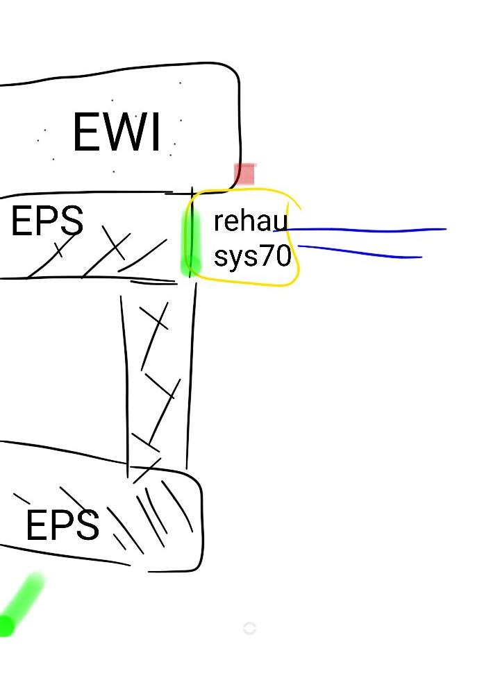

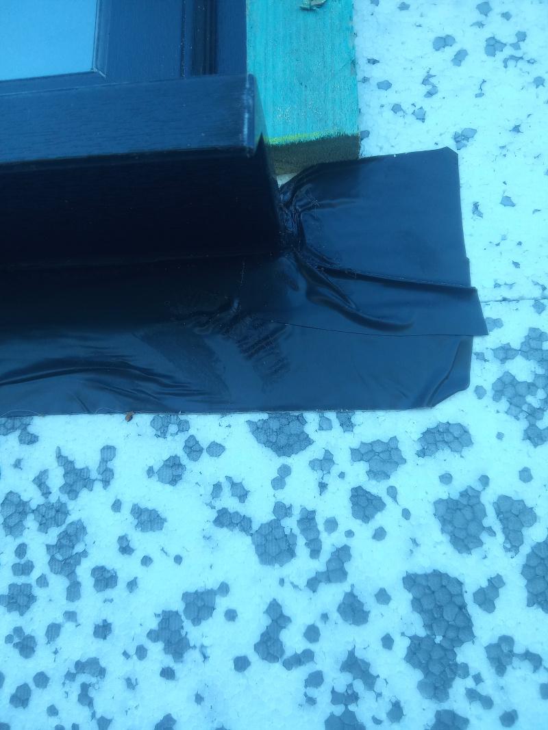

The external EPS was sealed at the cill with EPDM airtight tape, the tape has reinforcement in it and can be moulded, it does crease but creates a water tight junction and sticks like the proverbial to the EPS.

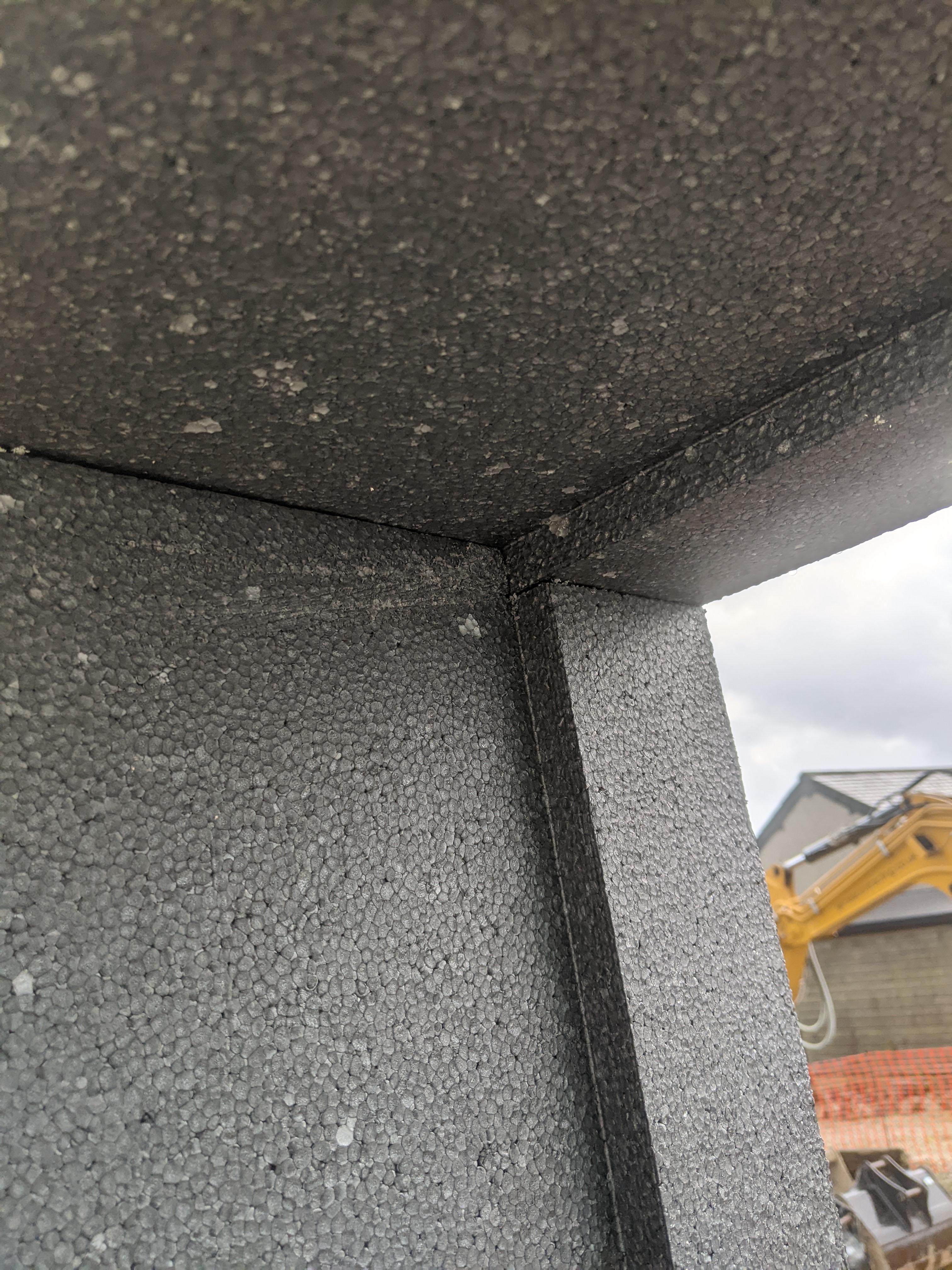

We created a cheek reveal with an additional layer of 50mm EPS  and sealed the upvc frames against this, I then ran a bead of sealant against the face and edge of the EPS giving two seals. Then when clad a third seal.
I used soudal air tight foam and I thinks it's LMA sealant, soudal's airtight solution.

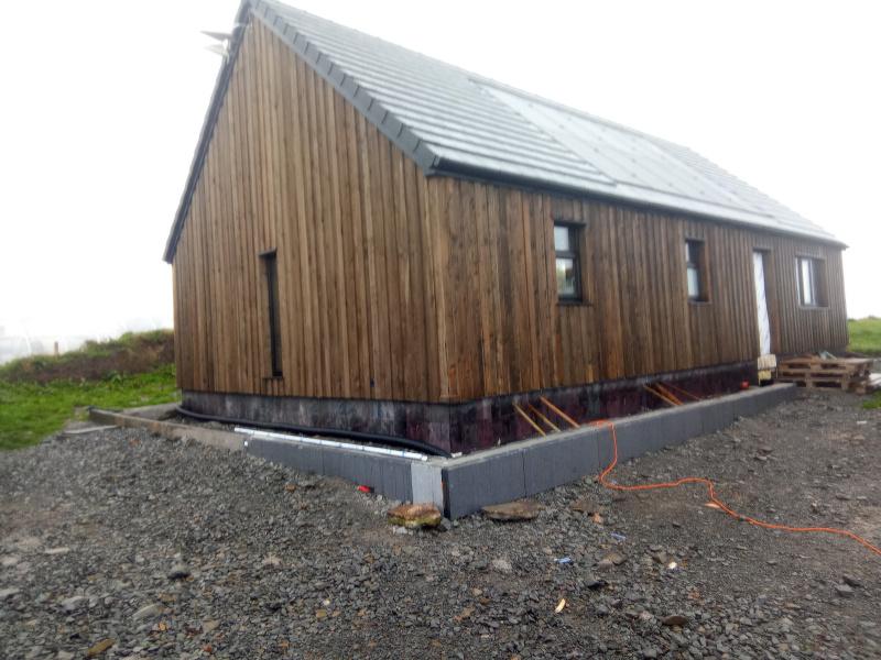

The cladding is larch boards in 2 widths 150mm for the bottom layer and 100mm for the top.
We finished the top of the windows with a custom palistol coated drip
The bottom of the EPS footing was finished with reclaimed slate.

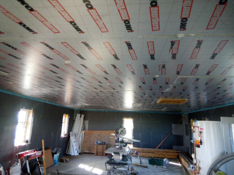

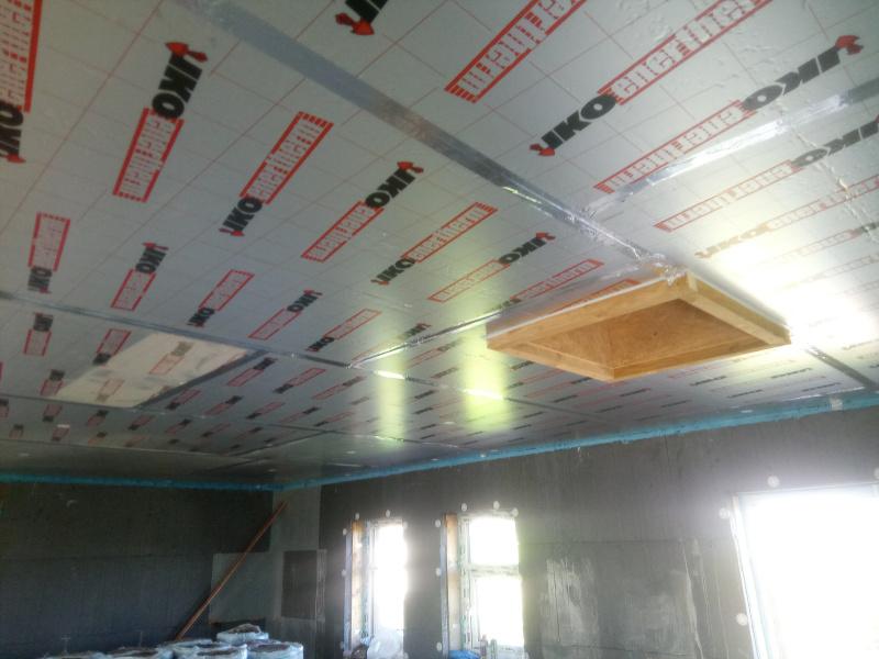

Inside we are having a cold roof. We needed to add 25mm pir under the truss cord to satisfy the tightened regulations in Scotland.
We tapped the foil boards with foil tape, and the perimeter boards were pushed to touch the wall plate. Then used airtight foam between the PIR and internal IFC wall creating a seal.
Under the PIR I used plastic membrane that I spray glued to the PIR, and this draped down the perimeter walls. The under ceiling was battened and counter battened, this created a service void for the cables and not penetrating the loft. The plastic was jointed with EPDM airtight tape on joins and walls.

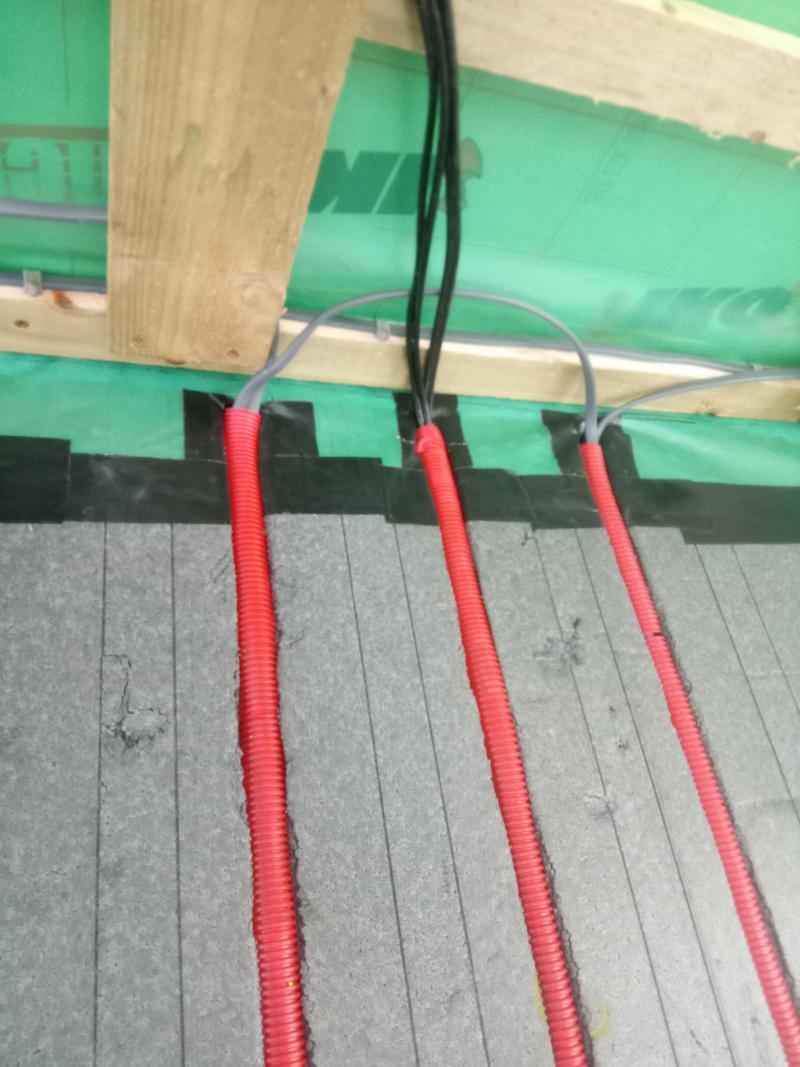

Cables were put inside Flexi conduit that was cut into grooves in the ICF. (All water pipes were run under the slab.)
This picture shows the detail for the airtightness and the service void.

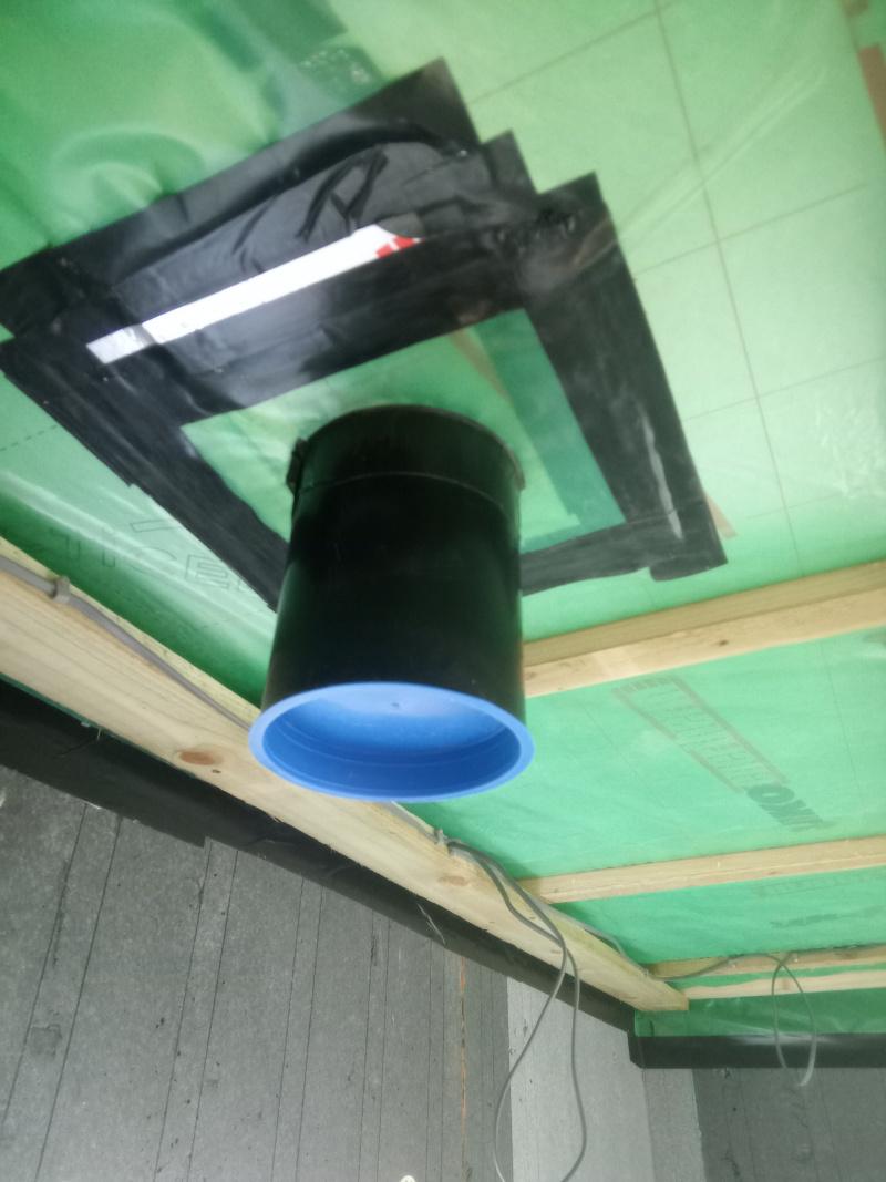

MVHR ducts (7 plenums ) were run in the loft, and under 400mm of loft roll. The manifolds are also under the loft insulation.  I made these airtight using the same EPDM tape.
I made gaskets out of the plastic with a circle cutter and stretched it over the plenums, then air tight tape to seal everything to the plastic/ PIR.

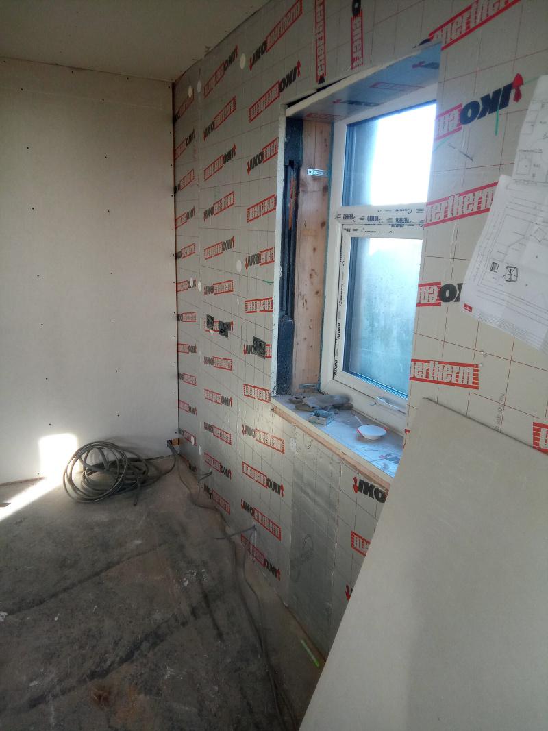

 The walls also needed some IWI to meet the tighter regs, so decided to go with  25mm PIR. This also added another seal for the plastic airtight layer and walls.
The  poly steel ICF has these metal plates at 150mm ctrs that allow the cladding battens  to be secured externally and the plasterboard internally, we used self tapping drywall screws and insulation discs to hold the PIR in place before installing the plasterboard.

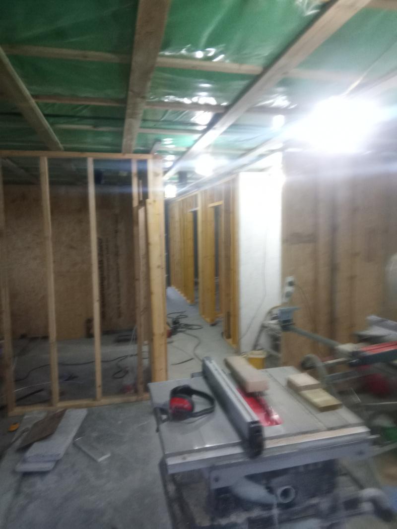

At this stage we've got a large airtight box. Now it's a case of installing the stud work. I lined the plant room with pre painted  12mm OSB, and the bathroom with 18mm OSB ( a Scottish building regs requirement needing the ability for future hand rails etc)
Electrics are simple, a few Ethernet points and sockets and spotlights. One pendant over the dining( and if I get my way, and budget allows  pool table).
The only penetrations from the loft are a light, PV cables, TV aerial, and 4g antenna cables. These are in conduit and sealed both ends.
All other cables run in the ceiling void or stud work.

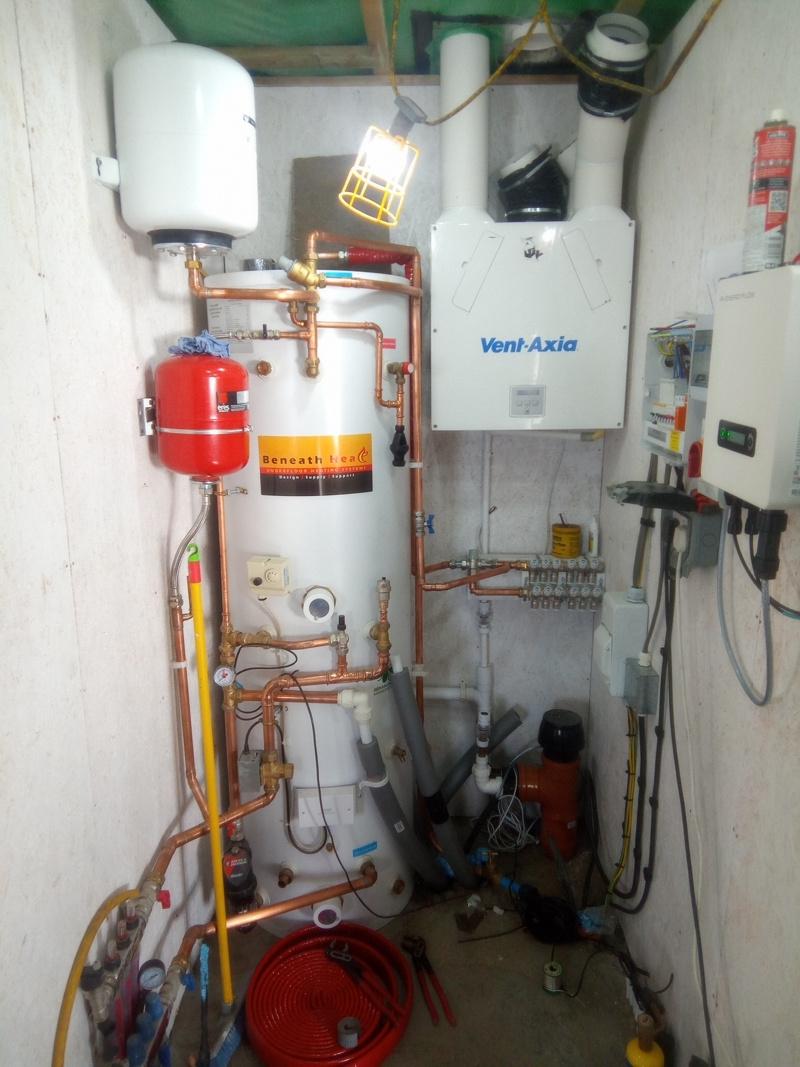

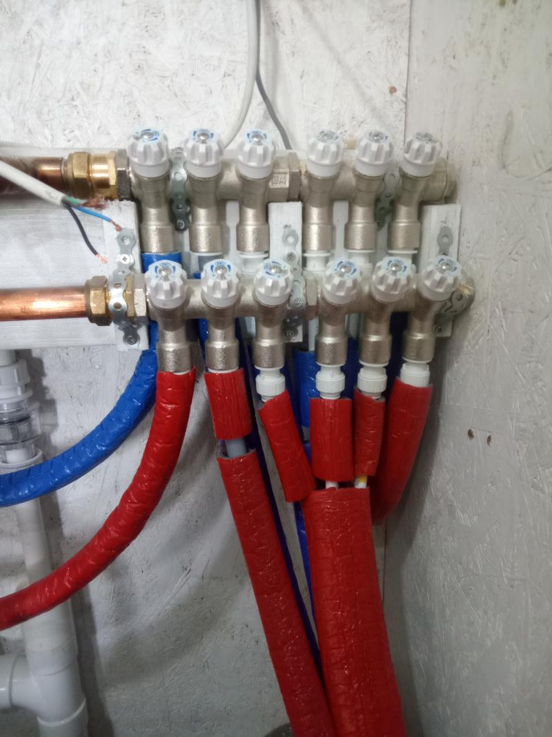

The plant room is compact, and work in progress.IMG_20231112_092441.thumb.jpg.033f704bc9f184bb71a67d1c1096f922.jpg

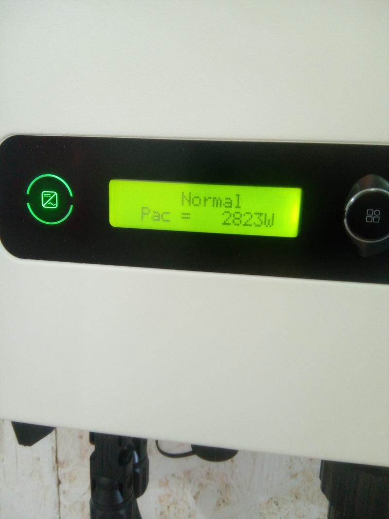

 The PV is up and running and to date produced just shy of 300KwH in 5 winter weeks

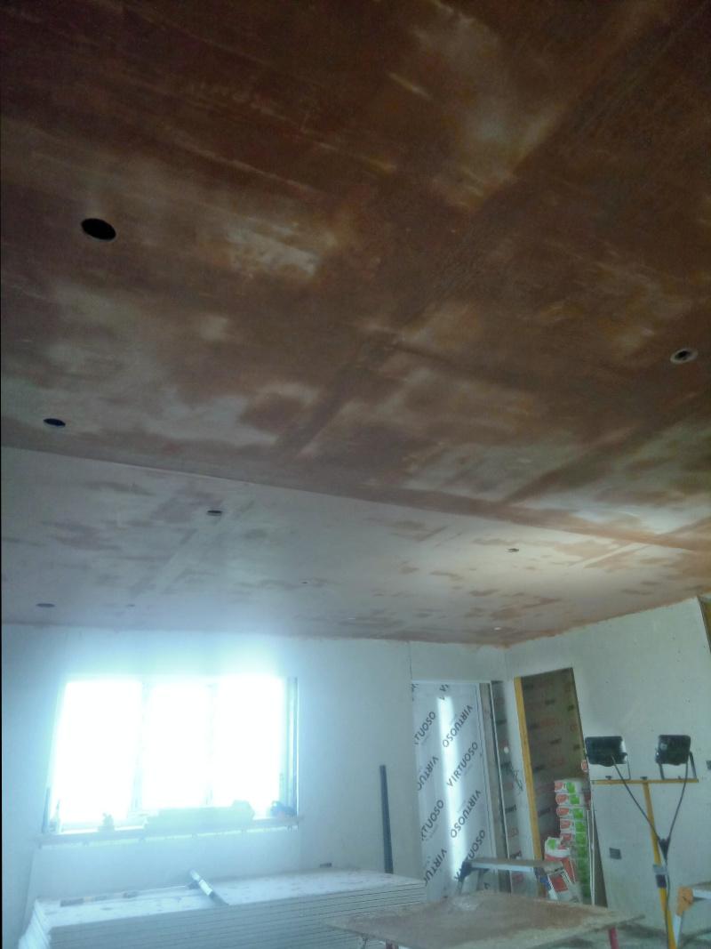

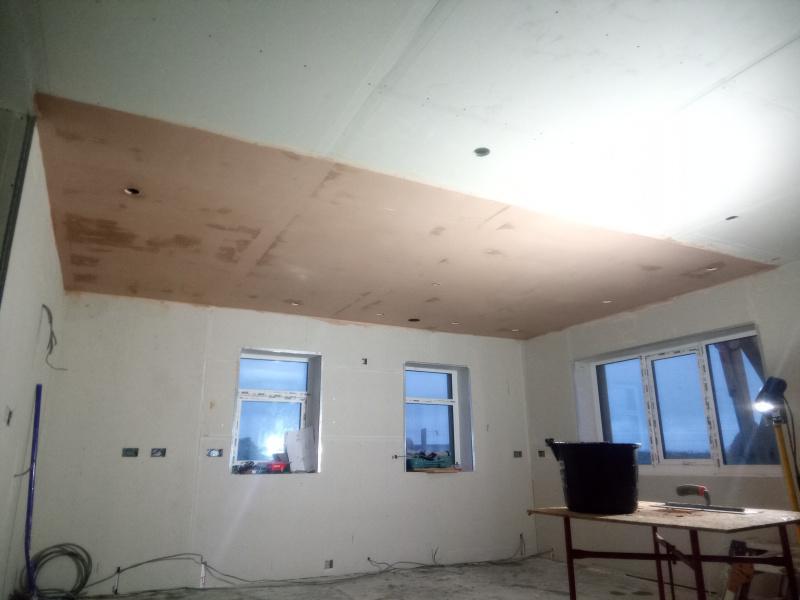

With the first fix complete it was time to plasterboard, we got 80 boards delivered Wednesday midday, just as storm Babet hit, it was too windy to bring them in, I tried, I failed so it had to stay outside 😭, covered in plastic, tarpaulins, scaffold boards and the obligatory ratchet straps.
3 days of constant 35mph gusting 50mph gave opportunities to check for airtightness.
I managed to install the flush shower tray during this downtime.
Once the storm blew though we got the boards inside and cracked on, the open plan lounge, diner, kitchen was boarded first and as soon as it was complete I skimmed the ceiling, 11 boards was too big for me and my tennis elbow, that coupled with not plastering anything for several years.
I split the room in two and used several layers of scrim tape to plaster up to, then remove the scrim tape and skim the 2nd part. It worked well, and it's painted and the join is seamless.
The next few days we mixed it up skimming in the morning and boarding in the afternoon for the next day.

Could you do a sketch of the Check reveals with EPS. I'm intrigued as the UPVC frames of our building are the weakest spots. Speaking of windows, what did you choose?

Well done you.  Must say I'm super impressed with how you've made your compact plant room work.
I've just zoomed in on your cylinder and see it's just like the one I've got, but with a different sticker on it, right down to the buffer underneath.
@Iceverge Under slinging the PIR helped with the airtightness ( I hope) I increased the wall height to give me room for the PIR and service cavity, still leaving me with 2400 ceiling.
Poor sketch ...>>>>
I went for triple glazed rehau Sys 70 UPVC. I've not drawn the cladding. The EPS is the ICF, to close the cavity I used 6x2 timber, the frames we're strapped to the timber.
I couldn't put horns on the cill, and I wish I could have found a solution, but I had to screws the cill to the frame from the bottom. So could not post the frame from inside with the horns on the cill. This is, I fear a weak point. I did have some driven rain (50mph winds), on 2 windows, come in prior to the cladding, but this is resolved, but came from this area.

Nice.
I'm an advocate of proper uPVC windows. Often overlooked because of poor imitations but those should be excellent. The insulation detail will perform well too. I'd be interested to see some thermal images.
I'm not sure I'm following on your weak spot, sorry.

When reading about ICF, I think @FM2015?described check reveals and window cills extending beyond the frame all help with keeping water out.
 As I fitted the frame from the inside ( to push up against the EWI on the sides and top) my cills finish flush with the side of the frames, so there is a gap which needs sealing. I used airtight foam, and silicon, but on the two windows I had issues with, I must have left a small gap, which the rain and with the assistance of 50mph winds pushed the water in.
(I think the problem area was where the frame sits on the cill and has a small gap for face draining)
I'm thinking If I'd fitted the cill first with horns, I could have sealed this first with better access, then the frame after. But that would then have meant screwing through the frame into the cill, and I judged this would not be a secure a fixing.
I was concerned that the only seal between the frame and cill is silicon and a small upstand of UPVC on the back of the cill.
It seems ok now. So I've stopped worrying about that and on to the next concerns🤣
