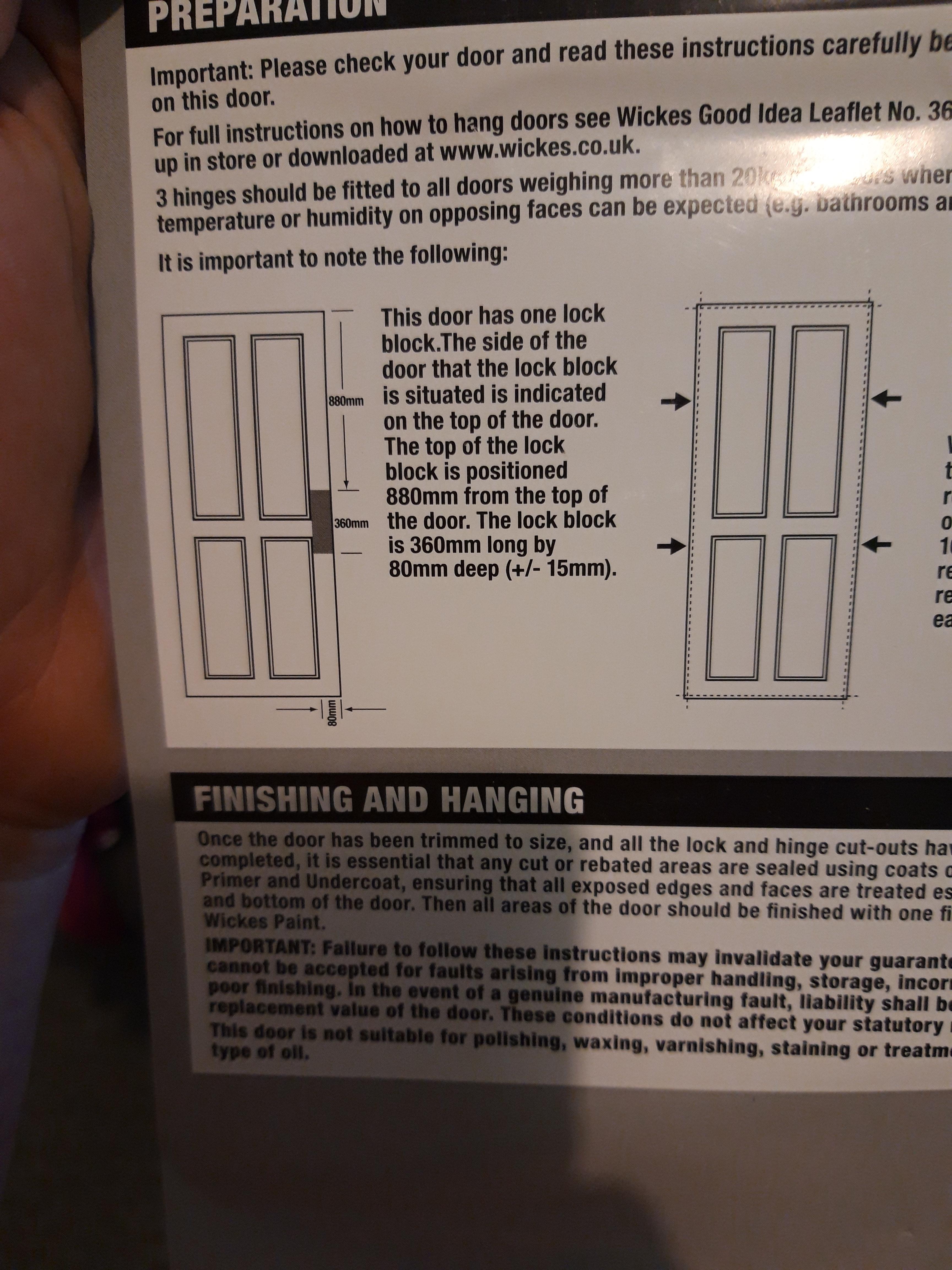

Onoff Posted June 3, 2019 Author Share Posted June 3, 2019 Further constricted by the el cheapo door construction that only gives a 360mm length of anything solid to fit the lock set. I guess though that's ample for whatever height they need to go. Link to comment Share on other sites More sharing options...

Onoff Posted June 3, 2019 Author Share Posted June 3, 2019 I don't get this...is it 54 or 60mm backset??? Link to comment Share on other sites More sharing options...
Oz07 Posted June 3, 2019 Share Posted June 3, 2019 2 1/2" latch 45 mm backset 3" latch 56 mm backset Link to comment Share on other sites More sharing options...

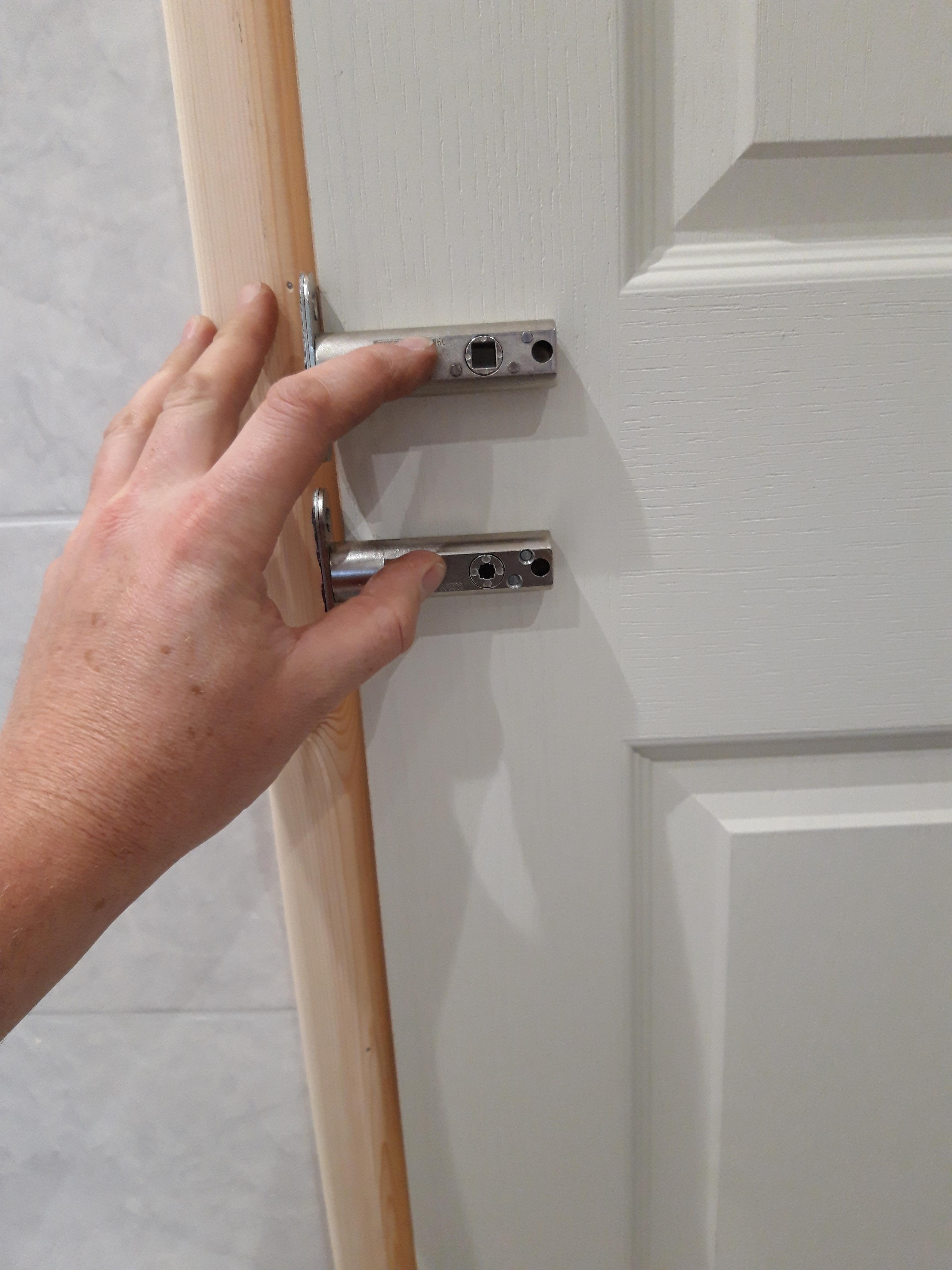

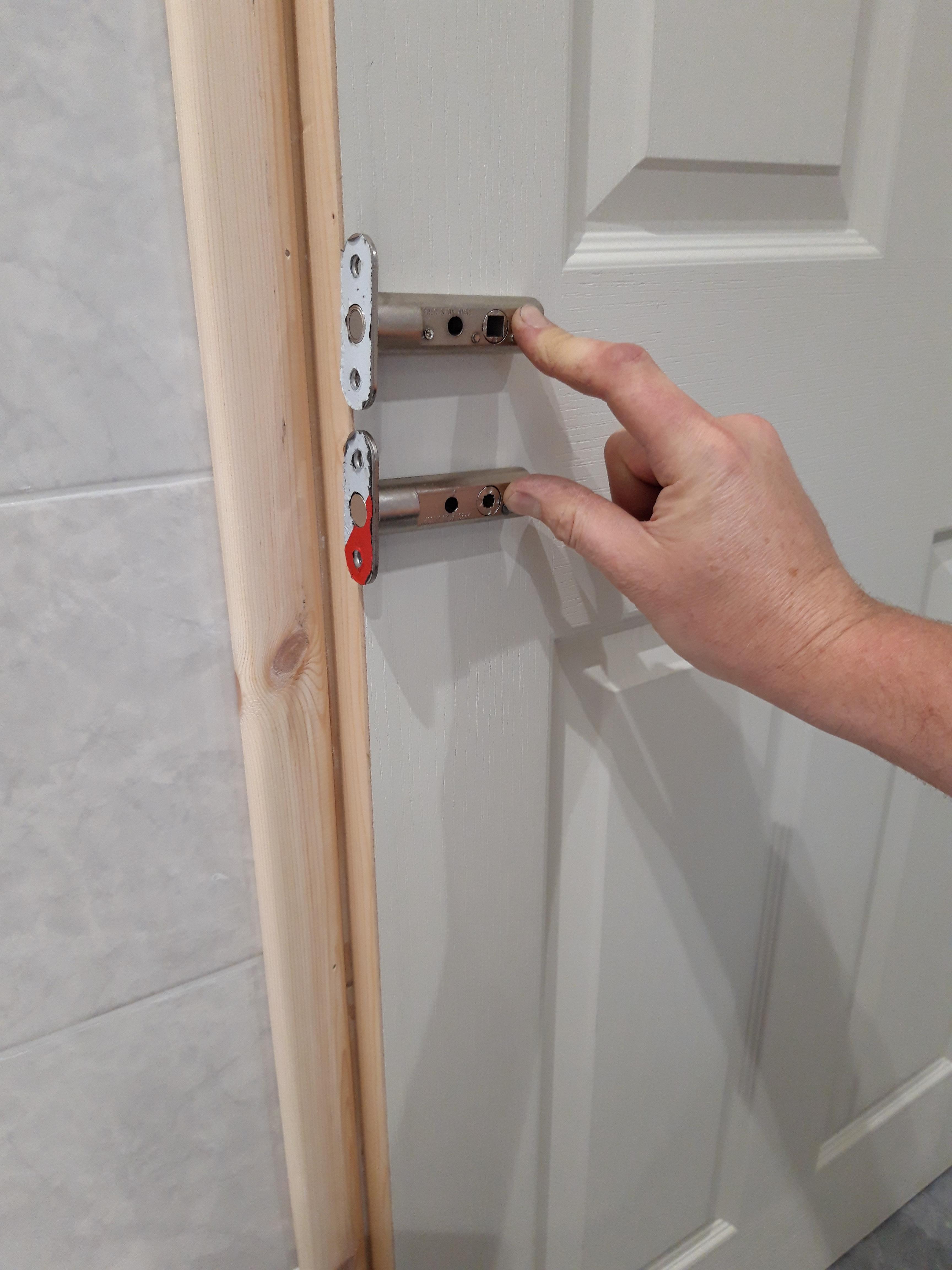

Onoff Posted June 3, 2019 Author Share Posted June 3, 2019 So @ProDave reckons his handle to privacy lock centres are 55mm as dictated by the lockset. As my handle and privacy catch are separate it's up to me. He's got proper doors whereas mine are cheap crap. Thinking I should space the two elements out more? Handle at 940mm, privacy at 825 gives me 115mm centres 45mm between escutcheons: Too wide apart still? Link to comment Share on other sites More sharing options...

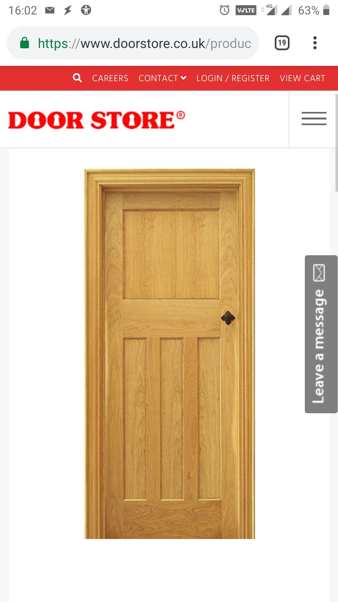

Onoff Posted June 4, 2019 Author Share Posted June 4, 2019 1 hour ago, Ferdinand said: it does seem like quite a lot of oneoff work to save about £50-60 Especially when SWMBO here will happily spend that on takeaways per week Let's not forget I've to paint the effing things yet. I wanted this style: Link to comment Share on other sites More sharing options...
Ferdinand Posted June 4, 2019 Share Posted June 4, 2019 (edited) 15 minutes ago, Onoff said: Especially when SWMBO here will happily spend that on takeaways per week Let's not forget I've to paint the effing things yet. I wanted this style: Bout £75 for doors like that -Geneva, Cottage Oak or whatever, perhaps plus VAT, from Todd or TP or wherever? Plus doodah give-you-a-blinding-headache-if-you-do-not-ventilate oil? They also seem to infest ebay. But it may be past that now. I have the egg-crate-in-primer ones upstairs 'cos he ran out of getting-his-money-back, and they still aren't painted. If I paint them they may never get replaced. F Edited June 4, 2019 by Ferdinand Link to comment Share on other sites More sharing options...

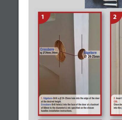

Onoff Posted June 4, 2019 Author Share Posted June 4, 2019 (edited) I'd use a 24mm flat bit rather than 25mm next time: The Screwfix handle came with a couple of through fixings that I fitted top and bottom and cleared the magnetic latch. The other two fixings to the L & R are just nasty little wood screws into the paper mache that is this cheapo door. For the, again Screwfix, privacy latch though there's no through bolts just 4 naff wood screws either side. Edited June 4, 2019 by Onoff Link to comment Share on other sites More sharing options...

geoffdg Posted June 5, 2019 Share Posted June 5, 2019 9 hours ago, Onoff said: I'd use a 24mm flat bit rather than 25mm next time: The Screwfix handle came with a couple of through fixings that I fitted top and bottom and cleared the magnetic latch. The other two fixings to the L & R are just nasty little wood screws into the paper mache that is this cheapo door. For the, again Screwfix, privacy latch though there's no through bolts just 4 naff wood screws either side. Like the top picture, with the screw head alignment detail Link to comment Share on other sites More sharing options...
Onoff Posted June 5, 2019 Author Share Posted June 5, 2019 22 minutes ago, geoffdg said: Like the top picture, with the screw head alignment detail Ta. They are v.slightly off, laterally to one another. With hindsight etc! Drilling with the flat wood bit for the top one and there was a 30mm st/st pin fixing the architrave on in the way. I had to use the 25mm Morse holesaw then carry on with the flat bit. Link to comment Share on other sites More sharing options...
