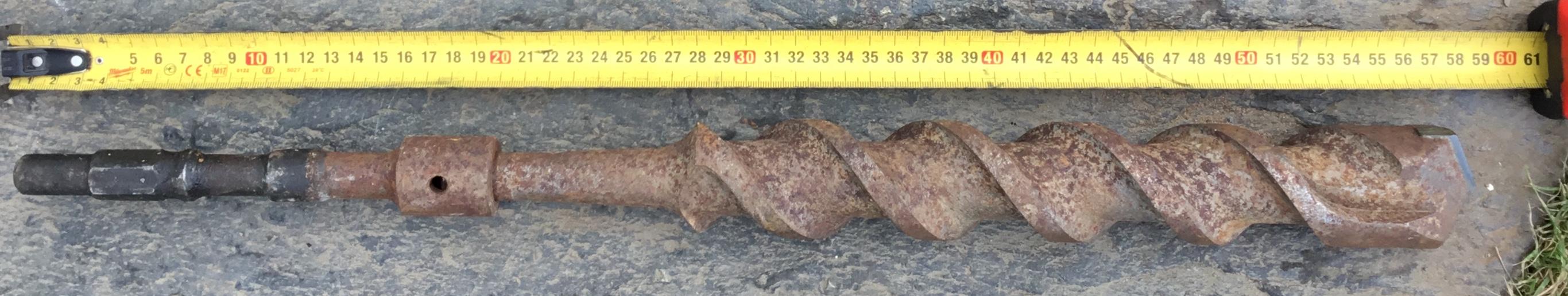

Cpd Posted May 21, 2019 Posted May 21, 2019 I have a 55mm masonry bit and it’s 600mmm long ! One of my jackhammers has a drilling function..... it’s a beast and one of the more dangerous pieces of kit I own....... used it before I purchased a core drill for drilling holes in bedrock to secure metal fence posts. 1

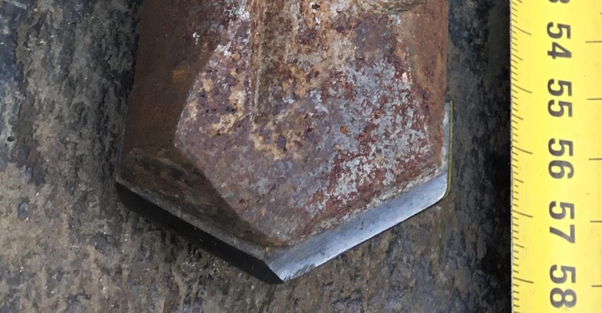

Cpd Posted May 22, 2019 Posted May 22, 2019 Show and tell. 10 hours ago, Alexphd1 said: 55mm on sds plus, or sds max (common size on max)? Think our biggest is 28mm on plus then 48mm on max. John, I have never seen a wet rig set up for a sds hammer function but plenty on core drill although we only have a dry core set up but that is useless for aberdeen granite. As mentioned this one goes into a jack hammer which has a drill function so NOT sds but large hex, not suitable for anything but drilling into bedrock or other solid stone and it’s a beast and would more than likely take down your wall before drilling a nice hole.....
