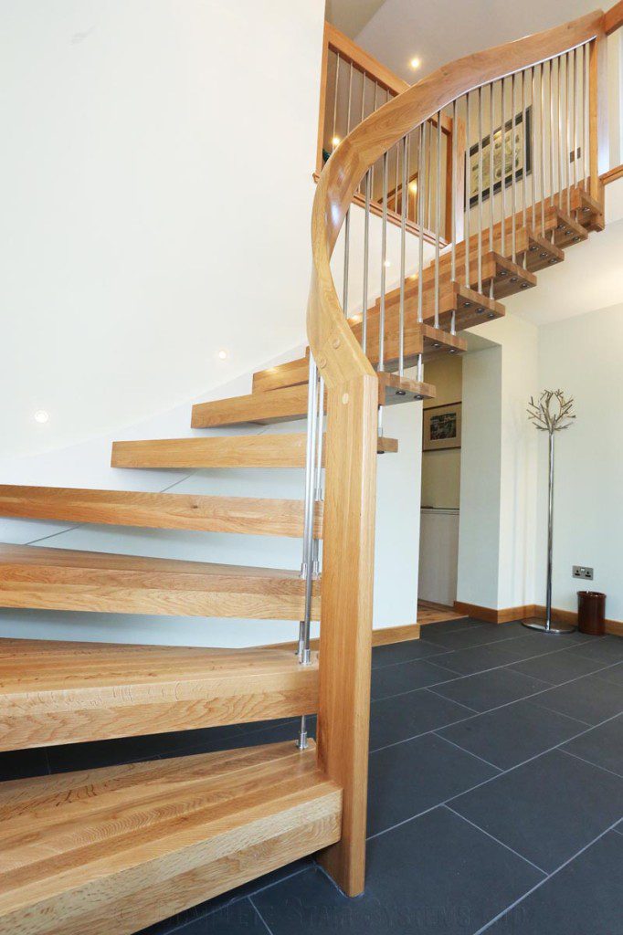

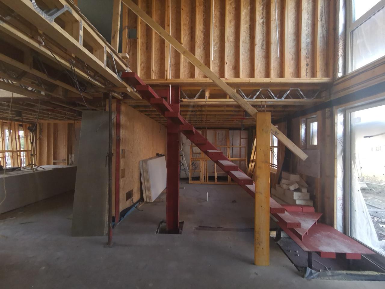

ultramods Posted May 17, 2019 Posted May 17, 2019 (edited) I paid £4000 for the metal work for our cantilevered stair to be supplied and installed (this included the vertical column in the middle). This was the cheapest quote from a one man band, the other quotes were £5400 and nearly £8000!!! The metal worker said that the structural engineer had severely over specc'd the steel, which meant that it could have been £500 - £1000 cheaper is lighter steel was used. I also paid around £400 for the SE to design the stair. If I did it again I would speak to some metal workers first and try and see if they would design the stair (as they will use a SE that uses steel efficiently) A cantilevered stair is far more expensive compared to a steel stair that has a stringer on either side of the treads, such as this: Edited May 17, 2019 by ultramods

Ralph Posted May 17, 2019 Author Posted May 17, 2019 On 17/05/2019 at 10:02, ultramods said: I paid £4000 for the metal work for our cantilevered stair to be supplied and installed (this included the vertical column in the middle). This was the cheapest quote from a one man band, the other quotes were £5400 and nearly £8000!!! The metal worker said that the structural engineer had severely over specc'd the steel, which meant that it could have been £500 - £1000 cheaper is lighter steel was used. I also paid around £400 for the SE to design the stair. If I did it again I would speak to some metal workers first and try and see if they would design the stair (as they will use a SE that uses steel efficiently) Expand That is nice looking and £4000 is not bad at all, I see you're in Aberdeen, who did you use for metal work? I'm down by Brechin.
ultramods Posted May 17, 2019 Posted May 17, 2019 On 17/05/2019 at 10:18, Ralph said: That is nice looking and £4000 is not bad at all, I see you're in Aberdeen, who did you use for metal work? I'm down by Brechin. Expand i'll DM you as the guy has some health issues now. £4000 wouldn't be too bad if that was the stair complete. We will be another £6400 to have Oak treads and glass balustrades supplied and installed by one company. This includes 5 linear metres of glass balustrades for the landing. However £9-10k is still a lot less than if you went to one company and asked them to do all the work.

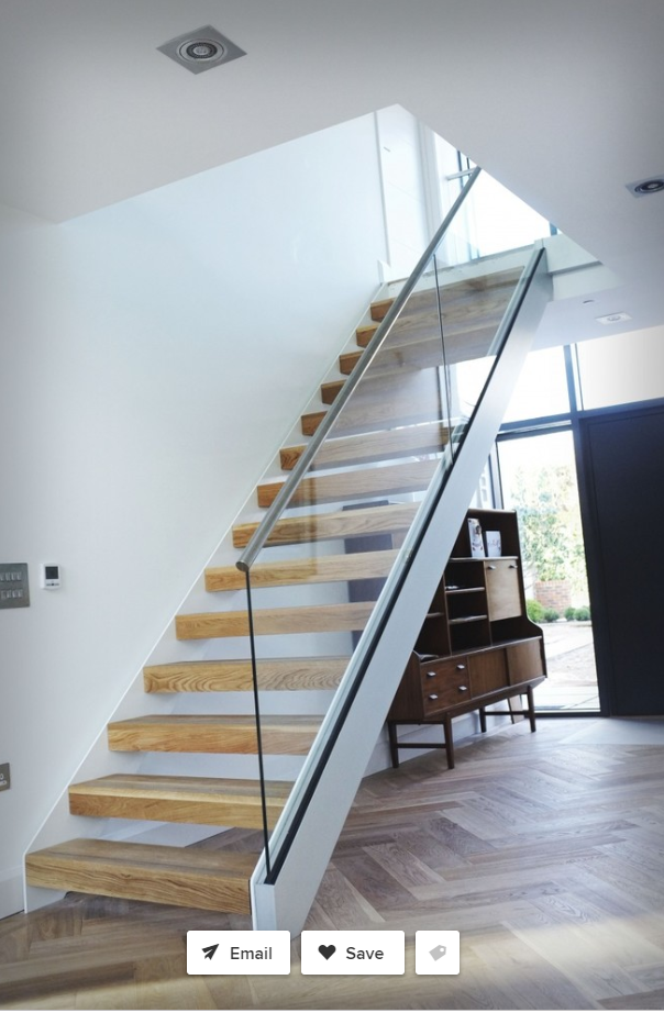

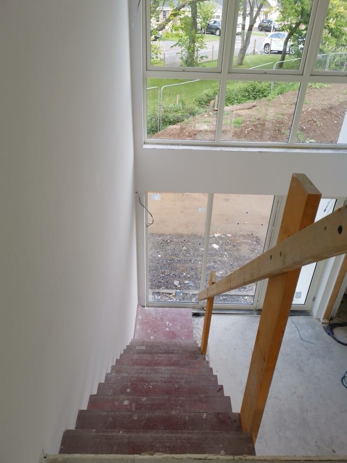

Simplysimon Posted May 20, 2019 Posted May 20, 2019 On 17/05/2019 at 10:02, ultramods said: Expand what is the detail for across the window/door at the bottom? On 17/05/2019 at 11:02, ultramods said: Expand
ultramods Posted May 20, 2019 Posted May 20, 2019 On 20/05/2019 at 17:52, Simplysimon said: what is the detail for across the window/door at the bottom? Expand Building control said no balustrade is required across the window as the window glass is safety glass. There will only be one glass balustrade that follows the path of the current temporary timber handrail.
Onoff Posted May 21, 2019 Posted May 21, 2019 On 17/05/2019 at 10:02, ultramods said: Expand As you descend the stairs is there a full height window directly in front? Doesn't that allow the building's "energy" to flow out of the house according to the principles of Feng shui? (As in a curved path to the front of a house is better than a straight one).
Simplysimon Posted May 21, 2019 Posted May 21, 2019 On 20/05/2019 at 21:52, ultramods said: Building control said no balustrade is required across the window as the window glass is safety glass. There will only be one glass balustrade that follows the path of the current temporary timber handrail. Expand no handrail on the other side? or is there a wall still to be erected? surprised at bc decision
ultramods Posted May 21, 2019 Posted May 21, 2019 On 21/05/2019 at 17:23, Simplysimon said: no handrail on the other side? or is there a wall still to be erected? surprised at bc decision Expand That photo was taken a few months ago, there is a wall on the other side. 1
Simplysimon Posted May 21, 2019 Posted May 21, 2019 On 21/05/2019 at 17:28, ultramods said: That photo was taken a few months ago, there is a wall on the other side. Expand looking good, next question, how are you minimising the gap between treads?

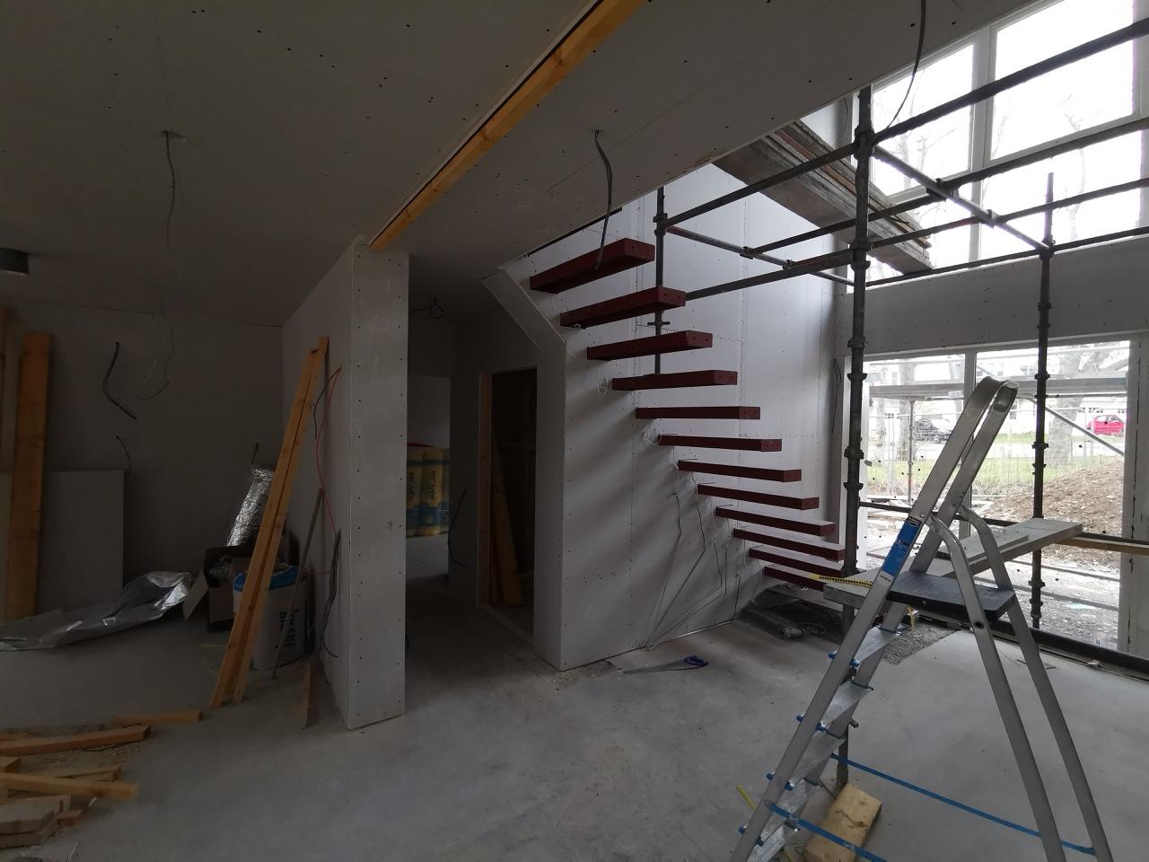

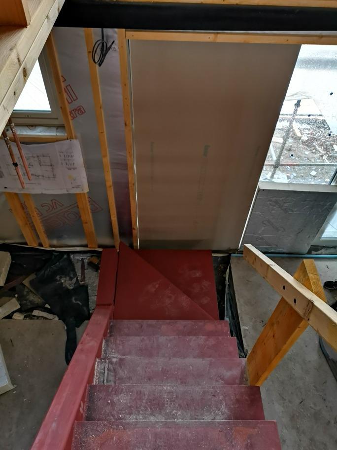

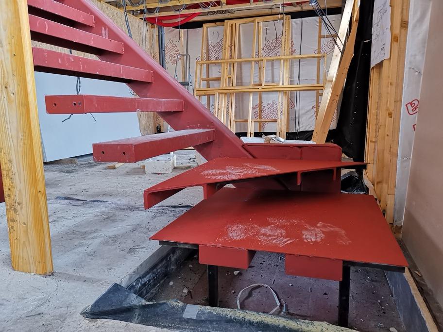

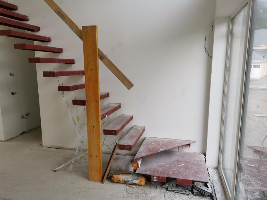

ultramods Posted May 21, 2019 Posted May 21, 2019 The treads will be clad in 20mm thick oak, which will reduce the gap by 40mm. Here are a couple of photos from today. 2
