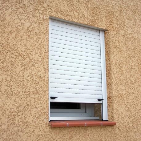

Gow Posted May 3, 2019 Share Posted May 3, 2019 Has anyone installed continental-style external roller blinds inside the casing of a new window frame? If so, do you have any tips about the depth of the window and door casing to house the blind cassette? I've found a French firm that supplies roller blinds in the UK. Link to comment Share on other sites More sharing options...

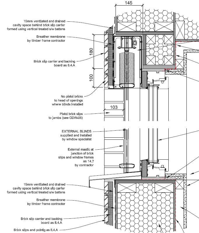

jack Posted May 3, 2019 Share Posted May 3, 2019 I'll be interested in the answer to this, as I have two windows that I'd like to retrofit something like these to. Doesn't the French supplier have tech drawings they can give you? Link to comment Share on other sites More sharing options...

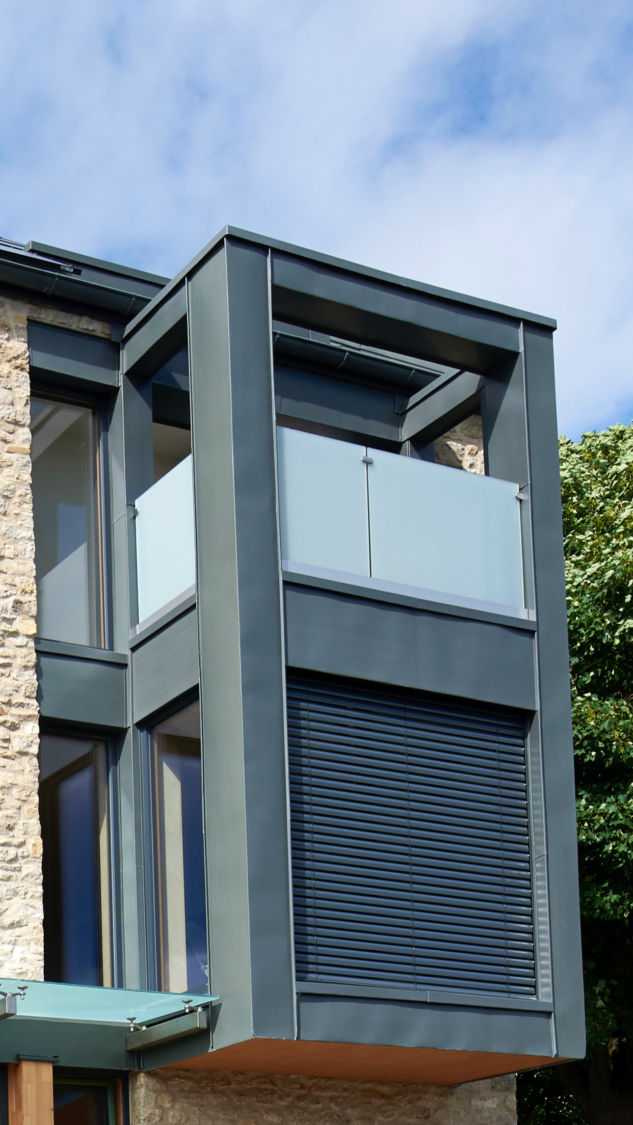

craig Posted May 4, 2019 Share Posted May 4, 2019 (edited) It's easier to have them planned in from the offset. The boxes generally come in two options that the motor and the venetian blinds/shutters sit in and varying heights dependant on the window height. If retro fitting, you only really have one option, which is front facing of the box. This is simply due to the fact you cannot conceal the box. If planned in from the offset, you can detail the box to be completely hidden. With some models you can retro fit them but you need to have the relevant depth from the window to the external wall to house it. Your likely going to lose 150mm/200mm + at the top of the window/glazing, due to the box. Edited May 4, 2019 by craig Link to comment Share on other sites More sharing options...
Bitpipe Posted May 4, 2019 Share Posted May 4, 2019 We specced external blinds (Roma) with our Gaulhofer windows and had MBC leave a pocket in the frame for the cassette. They came factory-fitted to the windows and sat flush to the external wall when fitted - just as Craig says. We have them on every east window and they are very effective at reducing solar gain, there's one adjacent ground floor south facing window that I wish we had covered also - I still ponder on how we could do that Link to comment Share on other sites More sharing options...

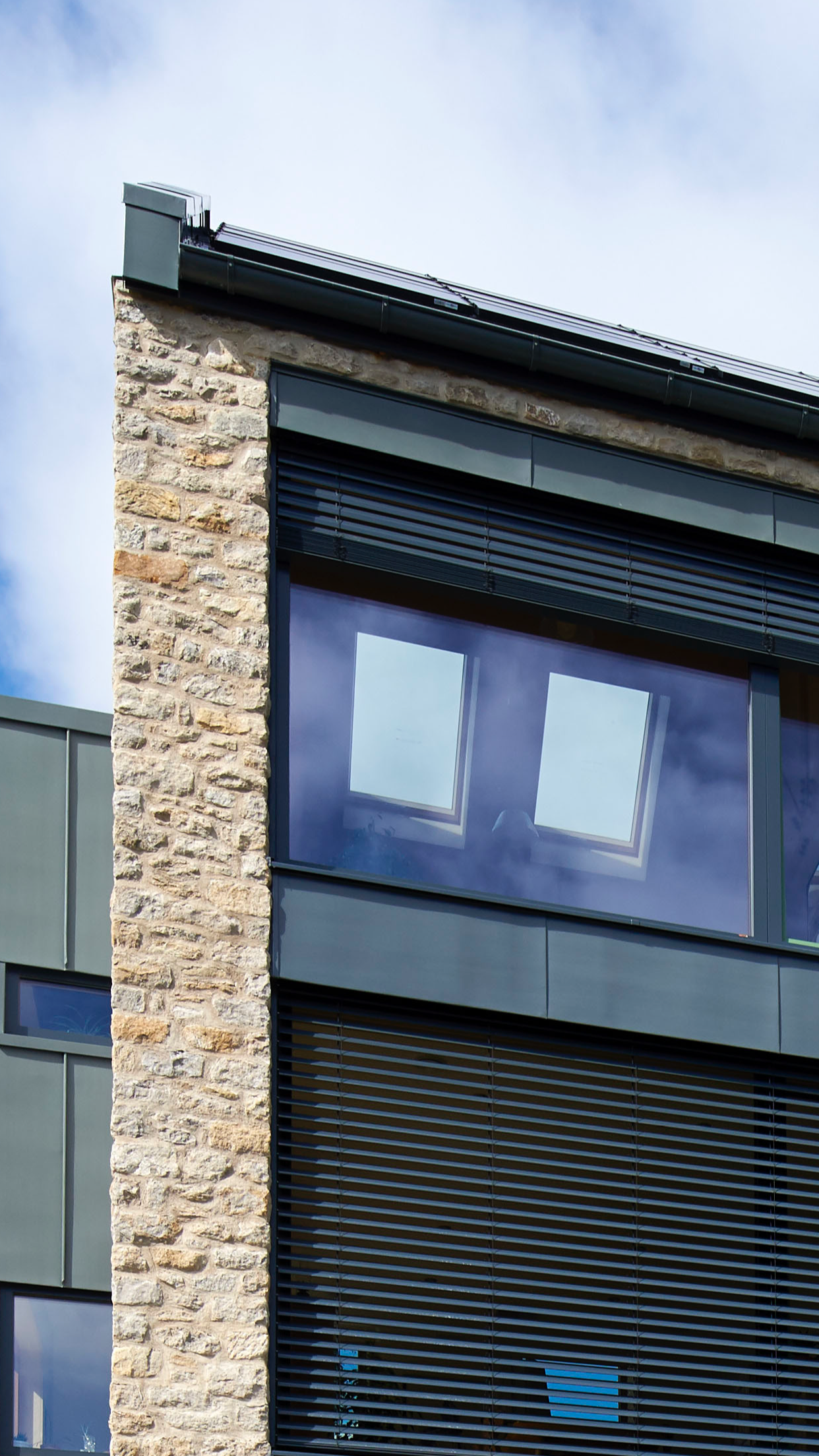

craig Posted May 4, 2019 Share Posted May 4, 2019 This is external venetians (roller shutter exactly the same) on a project we did, completely hidden box and in a conservation area. Planning was rejected on several occasions. Options exist for them from a few suppliers. Link to comment Share on other sites More sharing options...

lizzie Posted May 4, 2019 Share Posted May 4, 2019 1 hour ago, craig said: This is external venetians (roller shutter exactly the same) on a project we did, completely hidden box and in a conservation area. Planning was rejected on several occasions. Options exist for them from a few suppliers. Are those electric or manual? Link to comment Share on other sites More sharing options...
craig Posted May 4, 2019 Share Posted May 4, 2019 Electric, one cable coming out requiring a 3 gang switch. Link to comment Share on other sites More sharing options...

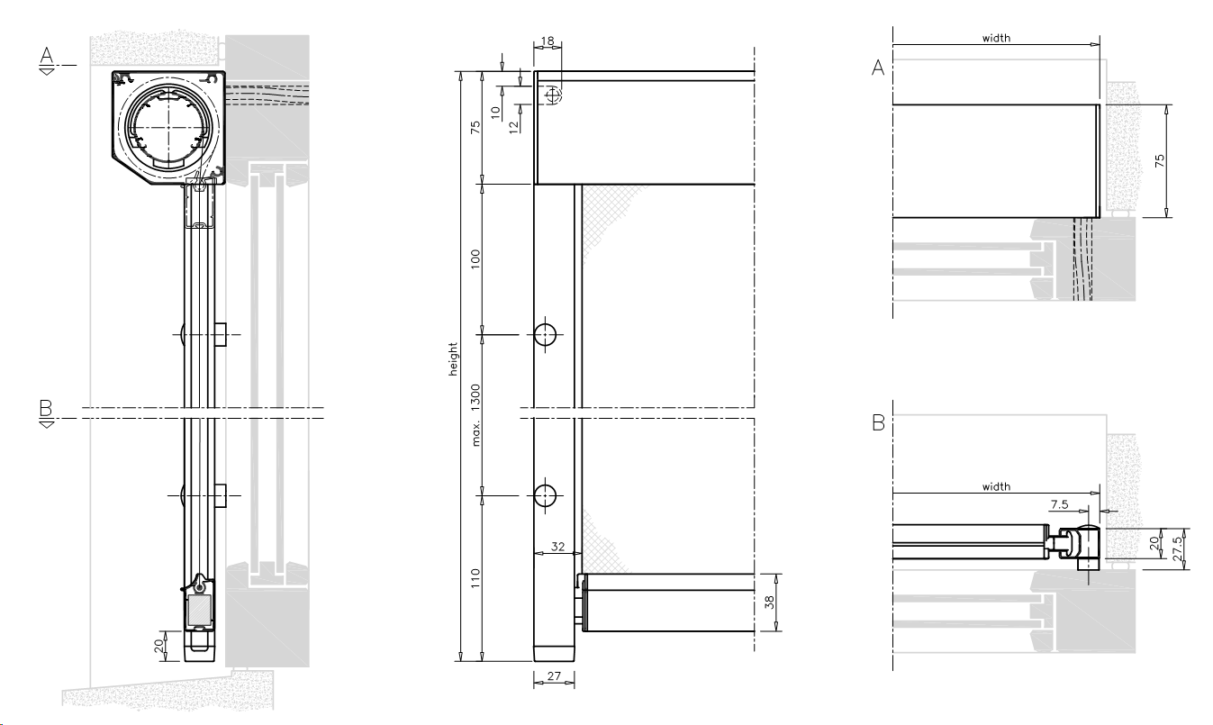

Jeremy Harris Posted May 4, 2019 Share Posted May 4, 2019 I've been looking around this afternoon to see how big/small some of the external blinds can be (we don't have much depth to play with). This cross section of the thinnest roller type external blind I could find seems pretty typical (not been able to find any sections of Venetian type external blinds yet, though): Link to comment Share on other sites More sharing options...

jack Posted May 4, 2019 Share Posted May 4, 2019 8 minutes ago, joth said: Do you have cross section drawings (similar to JSHarris posted above) for how the blind recess is detailed into the wall/window opening of the Roma/Gaulhofer venetian blinds? Ours aren't Gaulhofer, but the detail is probably similar. This is what we have where the house has brick slips on render board over a timber frame with cellulose insulation, and external venetian blinds: 1 1 Link to comment Share on other sites More sharing options...
Gow Posted May 4, 2019 Author Share Posted May 4, 2019 23 hours ago, jack said: I'll be interested in the answer to this, as I have two windows that I'd like to retrofit something like these to. Doesn't the French supplier have tech drawings they can give you? 23 hours ago, jack said: I'll be interested in the answer to this, as I have two windows that I'd like to retrofit something like these to. There are two types of fittings, one is built in and one which can be retrofitted but I am not sure if these would be suitable for most UK windows as continental windows have larger inside and outside sill We had the ancient wooden version built-in. They were very heavy and had a manual pulley cord. The cord outlasted the house, which was demolished a couple of years ago. The electric version of the blinds are more problematic as the blind can get stuck inside the cassette. A big tug on the manual blind solves the problem. See https://avosdim.com/uk/roller-shutters.html 1 Link to comment Share on other sites More sharing options...
