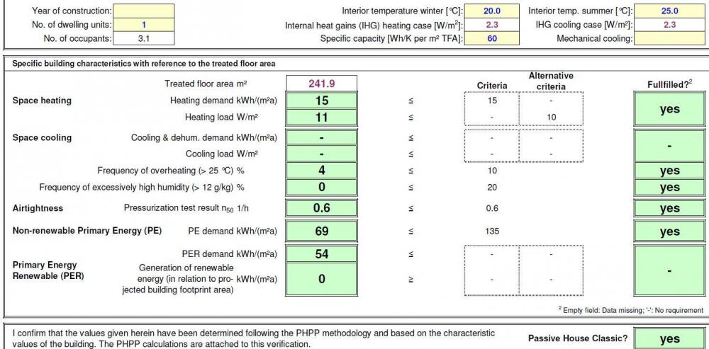

Hi. Firstly, not sure this is the correct place to post... never seen so many sub-forums in my life....
We're building a 245m2 passive(ish) house this year. South facing, plenty of solar gain when need (bris soleil and external blinds to minimise when not wanted).
https://forum.buildhub.org.uk/topic/9228-hi-icf-project-in-holywood/
We're in a town and on mains gas, so it seems by far the most logical source of energy for heating and hot water. As much as I want to de-carbonise, a heat pump doesn't make sense in our case. So, that part is sorted.
As we'll have triple glazing, ICF walls, large thermal mass, high air tightness, our energy demand will be low. I don't see the point in spending thousands installing a central heating system. Plus we'll have a wood burner - will be rarely used, so not fussed if there's a back boiler on it.
Our initial PHPP assessment attached.
I'm thinking plumbed towel rads in wet rooms and maybe 2kw post heaters (3x 150mm - one for each level - each with own control e.g. central warm water heater)
Any issues with the above? Would also consider electric under tile heating mats for the master en-suite for my other half's chronically cold feet...
My main query is hot water.... there's just the two of us and we both travel a lot for work so we've no regular routine. We have a combi boiler in our house which is great.... but hate the long delay for hot water to come out of the tap and the massive pressure and flow drops when somebody else flushes a toilet or turns on a tap. So I'm ruling that out. I'm also planning on a 3-4KW PV system with solar diverter to provide hot water in the summer... so that means some sort of storage.
What are my options? In summary, we need instant DHW on demand, high flow rates, low running cost, heatable by gas and PV.
Thernal store, unvented HW cylinder or sunamp type storage? Really unsure!!!
Thanks

Either Thermal Store or Unvented cylinder would provide what you want. Both would let you divert excess solar PV to hot water.
Sun  Amp may be an option but someone else will have to advise which type would be best as I am not up to speed on all the different variants.  The main advantage of the SunAmp over any form of tank, is lower standing heat losses.
I have an unvented cylinder. I chose that because the stored temperature is the temperature that it delivers to the tap, in my case set to 48 degrees so it is within range of an ASHP to heat it.  A thermal store generally needs to store water at a higher temperature than the delivery temperature.
Also a lot of thermal stores seem to be not so well insulated. There is no reason for this, but it just seems from those I see that the insulation could be better.
But the key to getting good flow rates even when someone flushes the loo, is a good mains water supply pressure AND flow.  If the flow rate of that drops when more than 1 tap is on, then you will need to consider an accumulator to maintain a decent flow.

Thanks Dave. Yeah, I think the losses  due to our irregular water use from a thermal store would wipe out any savings we'd make from PV heating. And I'm already worried about over heating.
I've been reading a lot on here about sunamp... doesn't seem like the product is there yet - the controls at least. I'm 6 months away from installing a system so lets see what happens in that time.
Re flows and pressures.... my day job is an engineer in the water sector, so I've at least got this part covered! The reason why our current combi drops flow when other water is used in the house is old pipe configuration and the boiler has limited capacity. I'll be running a 32mm supply to the house, and the area has decent enough mains pressure.
