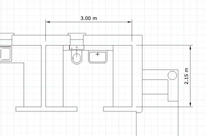

Large Downstairs WC or Separate Plant Room??
Hi All
I'd really appreciate the collective views of the forum on this one......

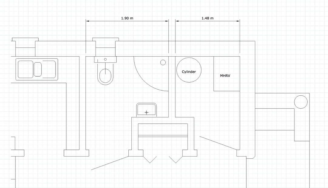

This is the current design of our ground floor WC, its fairly large to incorporate storage (left of door) and plant (right of door):
BUT....I'm starting to think that it might be better to create a separate small plant room. I can steal a small amount of space from the adjacent utility and create a space something like the below. (Ignore the window position which needs centralising).
Which would work better? I like the idea of the plant being in a separate room. Realistically it will house:
1. MVHR Unit.
2. Thermal Store /Cylinder (TBC exactly what)
3. Electric Consumer Unit.
I cant make the WC much smaller as the boss doesn't want to loose the coat/shoe storage.
TIA.

Realistically the MVHR should go on the outside wall, meaning you'll have to squeeze past the TS/UVC to get to it.  I suppose you won't need to get past it very often, but what happens in the worst case scenario of the MVHR failing and you having to get it out past the TS/UVC?
I don't know what the realistic minimum footprint is for installing a TS/UVC.  Perhaps start with that and see how much room there really is?
If it does work, and TS/UVC + MVHR is all that's in there, then you can always use the space just inside the door for storage and clothes drying (assuming there's ventilation in the plant room).

For some reason my wife spent a lot of time on our WC as she wanted it to be spacious.
Our current one is roughly 1.8x 1.4m which feels quite nice but we have gone up to 1.9 x 1.6m in the new place.
I have seen houses with quite large rooms as WCs and the fittings looked embarrassingly lost in the rooms.
It's not clear, but I assume in your original 3m wide WC, the side areas are actually boxed in cupboards.
I far prefer the separate plant room. I have worried about Jack's issues, that everything should be able to get out if it needs replaced, but I would have thought you have plenty of room there unless the TS is enormous.They are normally around 700-800mm wide.
I don't like the WC design though. Perhaps it's just me, but it's a room visitors see when coming into your house. You are leaving it quite cramped as it seems to be maybe less than 1m wide after allowing for the storage. Also I would always try to have room separate as there will be times when you are frustrate you can't get into the cupboard due to someone being in the WC. Imagine having visitors and them hanging around waiting for you to come out of the WC to get their coats for instance.
I think I would move the cupboard to incorporate it into the plant room and not the WC. I would want a standalone WC 1.2m wide and then make the plant room wider. The exact space for the storage would depend on the plant room equipment layout.
The other alternative is to move the storage space into the utility room. I can't see how big it is, but rather than pay for lots of kitchen units in the utility room, you could move that cupboard to the other side of the wall and save on kitchen units.  Make the WC 1.2m wide and add the width to the utility room.

Our WC is bang on 900mm wide and just meets the regs - had to hunt for an appropriately narrow sink - and is about 2.5 (ish) m long. Now that its got a door, lighting and sanitary ware installed it looks fine.
We have a plant room in the basement (directly under the utility) and its been extremely useful - gas boiler, MVHR and UVC are there plus all the electrical distribution - it's 3.6m x 1.2m so plenty of space for everything and plenty of working room also.
I'd perhaps question having so much storage in a WC, is there somewhere else you could locate it? Not sure I'd want to store coats & shoes in a WC, aside from potential dampness, could lead to some awkward situations :)

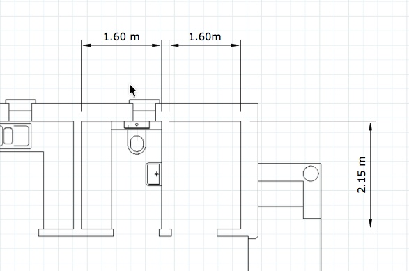

OK, so further to the input above and talking to SWMBO I've had a rethink. It seems the idea of a downstairs shower is a big vote winner so how about this?
I really don't understand this "the door must open outwards" rule in Part M. In our layout I actually think its more restrictive!
I'm really trying to avoid putting a window in the plant room as that will be a planning change, but is it essential?

I would put the WHB on the LH wall, and fill the whole dogleg with a decent sized shower. It will be used for cleaning muddy / work clothes and potentially dogs so it wants space.
You could also have one of those LCD windows which clear at the touch of a switch for the shoe/handbag exhibition unit so the proud owner can go "ta-da" to show up competitors :-).
I think inward swinging doors in small rooms can inhibit wheelchair manoeuvrability.
Possibly you can't consider the swept area to be part of your internal room area. I have seen this highlighted as designers adding unusable space to rooms to meet space standards. It was discussed as a loophole when they were defining the London Space Standards.

Looks good. +1 on shifting the sink and going for a nice big shower.
Either way you go, I'd avoid a quadrant cubicle like the plague as unless your spending out on a very good make they're usually falling apart after a few years and the seal where the two doors meet is right opposite the spray so a nightmare if you accidentally bump into the doors and open them slightly ( more so when you haven't realised ).
Go for a square or rectangle and either an infold ( bifold ) or a slider. Pivot doors and quadrants are the ones to stay away from in my experience.

+1 to the rectangular shower - just make it the size of the alcove and it's easier !
I would also make the plant room door open outwards as it will match the rest and also give you somewhere easily accessible to dump the Hoover etc ..!

The outward opening is silly. We don't have that here. We need to provide a set amount of "activity space" in front of a WC and in front of a bath or shower, and the door swing is not allowed to encroach on that activity space. Yours would easily achieve that with an inward opening door.  If this were me forced to comply with that silly rule, the door stop would be fixed with just a few panel pins, and the day after the completion certificate was issued I would reverse the door swing.
I think the cupboard you have created between the two rooms is the issue. I would make is smaller to give room in the shower room for the basin.

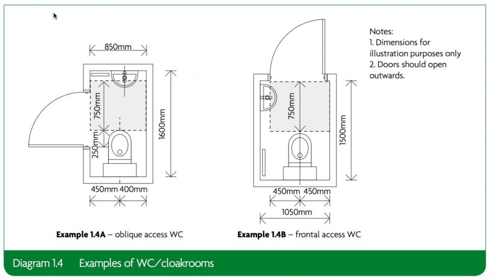

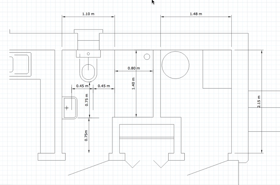

Right more good advise guys. So, Rev.3.
The question is does the above meet (with the incredibly vague!) Part M regs as shown here.
I've currently drawn internal walls at 150mm thickness so I guess there is a little wriggle room there.
