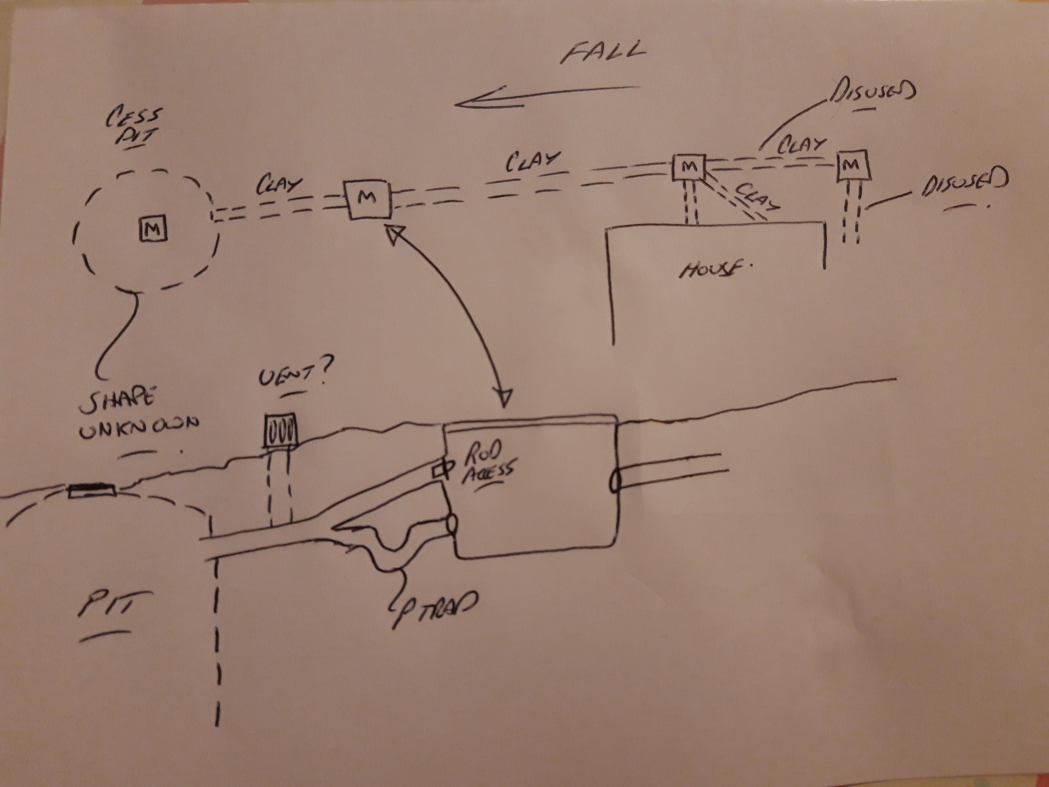

Onoff Posted November 25, 2019 Author Posted November 25, 2019 (edited) On 25/11/2019 at 19:43, Russell griffiths said: Have you found all the inspection covers? have a real good go to find them all, this way you can see flow from one chamber to another as he sucks it out. Then as he drops the level you can flush the bog to see where the pipe enters the first chamber. Expand You reckon its chambered? Pretty sure it's just a big, circular brick "beehive". Only one cover at the apex. Open that and it's big enough to fall through. No grate etc. Hand dug in the 50s by a local father and son team who did everything local. I think the "roof" is arched bricks covered in concrete. Rough plan is this. From right, at the top of the slope is a disused branch that came from an outside loo. Then a manhole where everything goes into at the moment. Way down the garden another manhole with like a P trap and rodding eye in, then the pit. I'd guess the inlet pipe is about 3' down from the apex. All a bit precarious. I have to span with a ladder and walk out on that. Edited November 25, 2019 by Onoff

Gone West Posted November 26, 2019 Posted November 26, 2019 On 25/11/2019 at 20:11, Onoff said: Pretty sure it's just a big, circular brick "beehive". Expand In our last Victorian house we had a fifties upgrade which was a small, 8' deep by 4' round solids tank into which everything went. The liquid drained into a much larger square tank about 3000 gallons. When we moved in there was only a manhole cover on the small tank. I later added a cover to the larger tank and a soakaway.

Onoff Posted November 26, 2019 Author Posted November 26, 2019 I think I'll do a plan of the plot, where the cess pool, road, boundaries are etc along with an elevation and put to the collective with a view to what's possible treatment plant wise. Fed up with this 3rd world set up.
Russell griffiths Posted November 26, 2019 Posted November 26, 2019 If it been working for 19 years why not clean it out have a good look do a few repairs and jobs a good un. New treatment plant will be north of £2500 time you get it all in.
Onoff Posted November 26, 2019 Author Posted November 26, 2019 (edited) On 26/11/2019 at 18:25, Russell griffiths said: If it been working for 19 years why not clean it out have a good look do a few repairs and jobs a good un. New treatment plant will be north of £2500 time you get it all in. Expand Be nice to see in it fully I must admit. They've said £120 but might be I just say "Keep going until we hit £200!" ? I intend volunteering to haul the vacuum hose and drop it in etc. Bit of a route around bushes etc. Access is worrying me but I told them I've 3.6m between the new pillars and space I reckon to pull up on the drive in front of them. The condition of the "lid" is the most worrying thing for me. Did think to empty it then cave the roof in and take out the rubble, then cast a new, "safe" lid. It's a sh!tty job but someone's got to... Edited November 26, 2019 by Onoff
