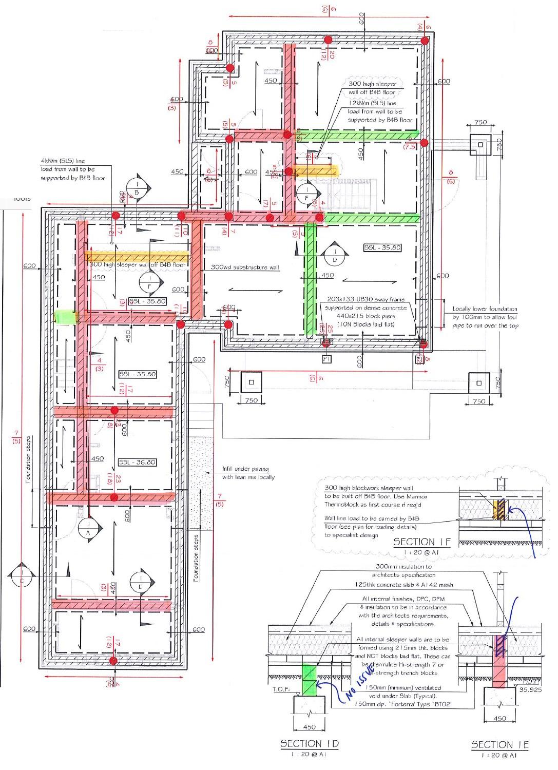

andy Posted April 18, 2019 Posted April 18, 2019 Hi all We're slowing getting there with our design (slow being the operative word here!) but I've had the final construction drawings from our structural engineer now for our foundations that I am concerned by (we are about to get a firm quote from our groundworker who wants to actually start soon!). The house is mostly single story with a mezzanine area on the top right corner of the image. It's timber frame with walls filled with warmcell (including internal walls) yet our SE wants dwarf walls either coming through or built on the beam and block floor (and then the 300mm EPS100 and 125mm slab) which the internal walls are supported by. I am at a loss to understand why this is a requirement as the house is circa 5.5m wide on the left section and 8m on the right section (as you look at the picture). I'm concerned that the thermal efficiency is compromised as a result. Does what the SE designed seem appropriate? P.S. I have no idea what the red dots are signifying!
Declan52 Posted April 18, 2019 Posted April 18, 2019 Why beam and block, is it poor ground conditions??? Can you not fill the founds with hardcore then put in your concrete floor with mesh and have it polished up. Then you have a smooth platform to set your timber frame on. Can you put up the first floor plan so we can see what the purpose of the walls that are in red and yellow are carrying above.
ProDave Posted April 18, 2019 Posted April 18, 2019 I set my designers the brief "to simplify the foundations" by that I meant remove unecessary sleeper walls. I got the impression designers do that as an easy way to reduce beam sizes. My reasoning was the upstairs joists are going to span that gap, so the downstairs ones are damned well going to span the same gap without the aid of sleeper walls.
andy Posted April 18, 2019 Author Posted April 18, 2019 At pub, will respond with floor plan details tomorrow! We're on chalk but some disturbed ground but nowt too crazy (trees right next to previous house and general disturbed ground over past 100 years!). The whole left section is ground floor only apart from some loft space in half of it.
Simplysimon Posted April 18, 2019 Posted April 18, 2019 just done my b&b floor, wouldn't do it again. expensive and quite a bit of deflection, live and learn. section IE has thermaliteblocks and IF has marmox. TBH i wouldn't bother with either as @ProDave says, make it simple - lay a slab. 1
Declan52 Posted April 18, 2019 Posted April 18, 2019 1 hour ago, andy said: At pub, will respond with floor plan details tomorrow! We're on chalk but some disturbed ground but nowt too crazy (trees right next to previous house and general disturbed ground over past 100 years!). The whole left section is ground floor only apart from some loft space in half of it. So if the left side is only ground floor why is he making you build walls beneath what I presume are going to be internal timber walls. The beam and block can easily carry that small weight never mind 125mm of reinforced concrete.

Temp Posted April 19, 2019 Posted April 19, 2019 I haven't really looked at the drawing (it's 2am) but has he added walls to reduce the span of the beams?

andy Posted April 19, 2019 Author Posted April 19, 2019 10 hours ago, Declan52 said: So if the left side is only ground floor why is he making you build walls beneath what I presume are going to be internal timber walls. The beam and block can easily carry that small weight never mind 125mm of reinforced concrete. That's what I don't get - it seems seriously over-engineered.

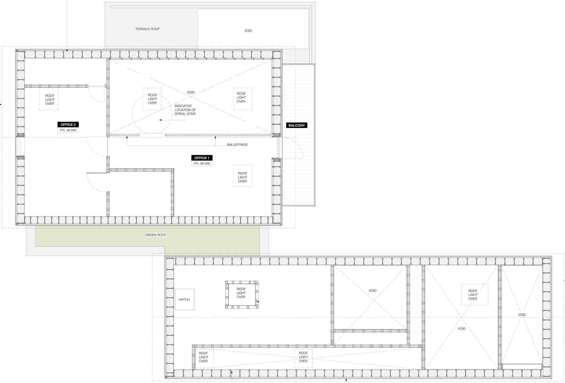

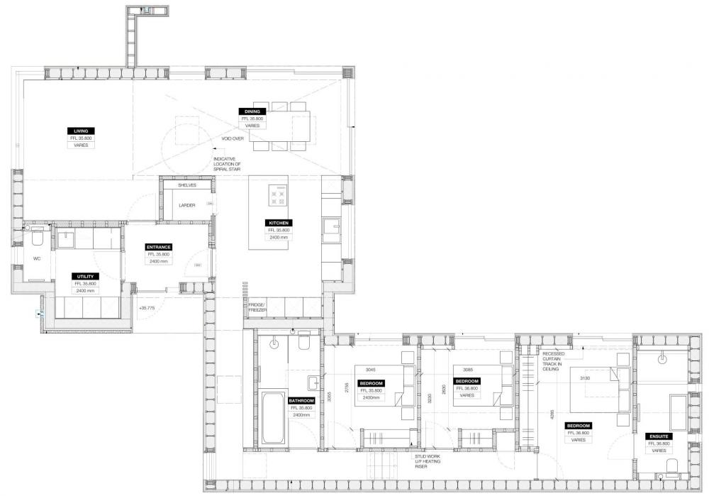

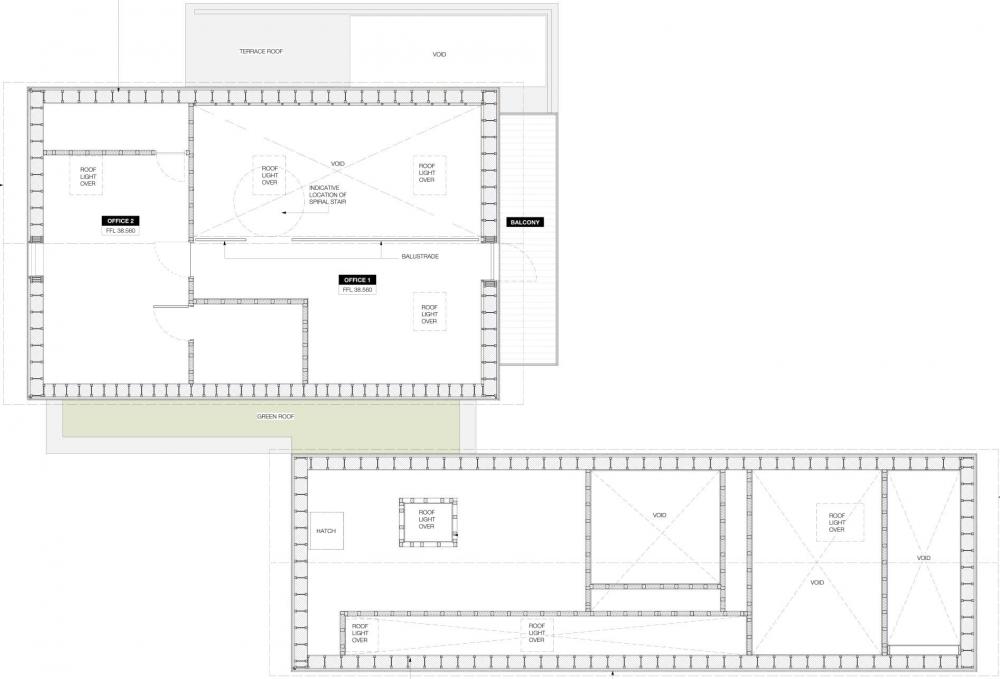

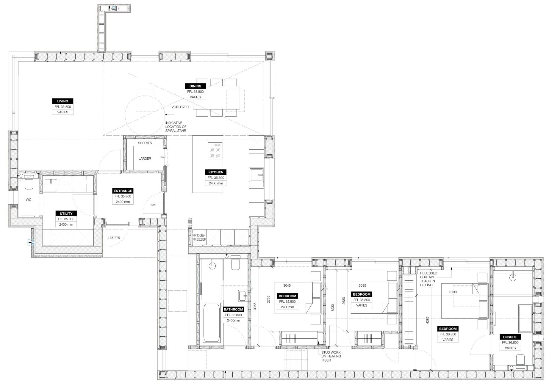

andy Posted April 19, 2019 Author Posted April 19, 2019 So here's the layouts - I've cleaned them up to remove a lot of "noise" on the pics but hopefully this gives you an idea. Main house section is 8.5m x 11.2m (at widest, measured top to bottom x left to right), bedrooms is 5.1m x 16.3m. There's a step up in level of 1m just to the right of the steps in the bedroom area due to slope of site. I can understand the need for dwarf walls across some of the beam spans but not for any walls that penetrate the 300mm EPS100.
