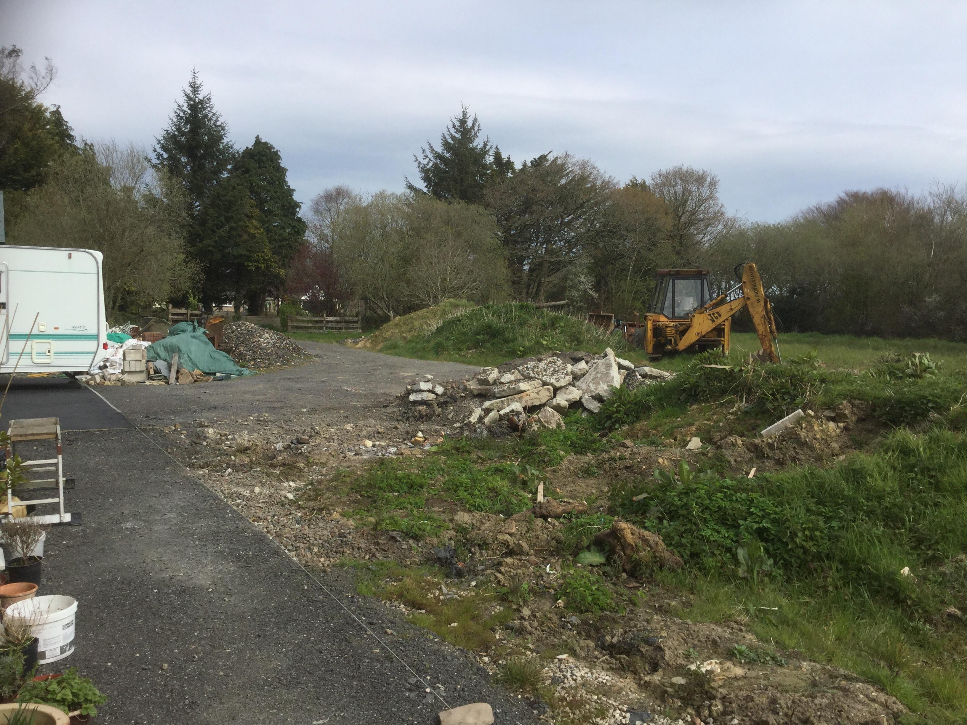

lizzie Posted April 15, 2019 Share Posted April 15, 2019 Guys I think we have hijacked OP topic here. My observation that the construction type of build a lot of us have (not cheap as we have now established) may or may not be cost effective/heat efficient relative to to OP question of different type of slab/ufh install. My comments were as to style of build not a particular company.....there are others! Cost of build is a personal matter and we all build to our own pockets/parameters that influences the choices we make on which type of construction method to go for, in quoting my cost per sqm I am not complaining at price (I agreed it!) but commenting that it is not a cheap way to build. I think the cost benefits are longer term with this type of build and that was what I thought when we decided on it.....hope it works out that way:-) The self build calculator for June 2018 shows TF timber clad to be the most costly way to build......their averages are just that but it comes out more than insulated cavity brick and block which is at the lower end. I think everyone on this forum knows that my frame and slab were a c**k up and I still live with the consequences of a lop sided frame (no rectification possible) however I have put it to bed, the whole thing made me very ill and I have no wish to go back there. We have done what we can to mitigate the issues and thats it now. Time to move on. With the help I have had from all you lovely people I am slowly resolving the issues I still have with various things and now I have finally found someone to sort MVHR and UFH I hope we will be able to get the house functioning as it should. I am learning to love my house after a few years of sheer hell - and I know I am not alone there - I am looking forward to getting my garden sorted this year. Always a coffee available for anyone passing who would like to drop in. 2 Link to comment Share on other sites More sharing options...
joe90 Posted April 15, 2019 Share Posted April 15, 2019 14 minutes ago, lizzie said: I am looking forward to getting my garden sorted this year. Ha, so am I ? Link to comment Share on other sites More sharing options...
lizzie Posted April 15, 2019 Share Posted April 15, 2019 @joe90 I may just come and visit for ideas ?? Link to comment Share on other sites More sharing options...

joe90 Posted April 15, 2019 Share Posted April 15, 2019 Anyone is more than welcome, just remember to bring your wellies ? (and can you drive a JCB ?) Link to comment Share on other sites More sharing options...
lizzie Posted April 15, 2019 Share Posted April 15, 2019 7 minutes ago, joe90 said: Anyone is more than welcome, just remember to bring your wellies ? (and can you drive a JCB ?) Never driven one but always up for a challenge!! 1 Link to comment Share on other sites More sharing options...
