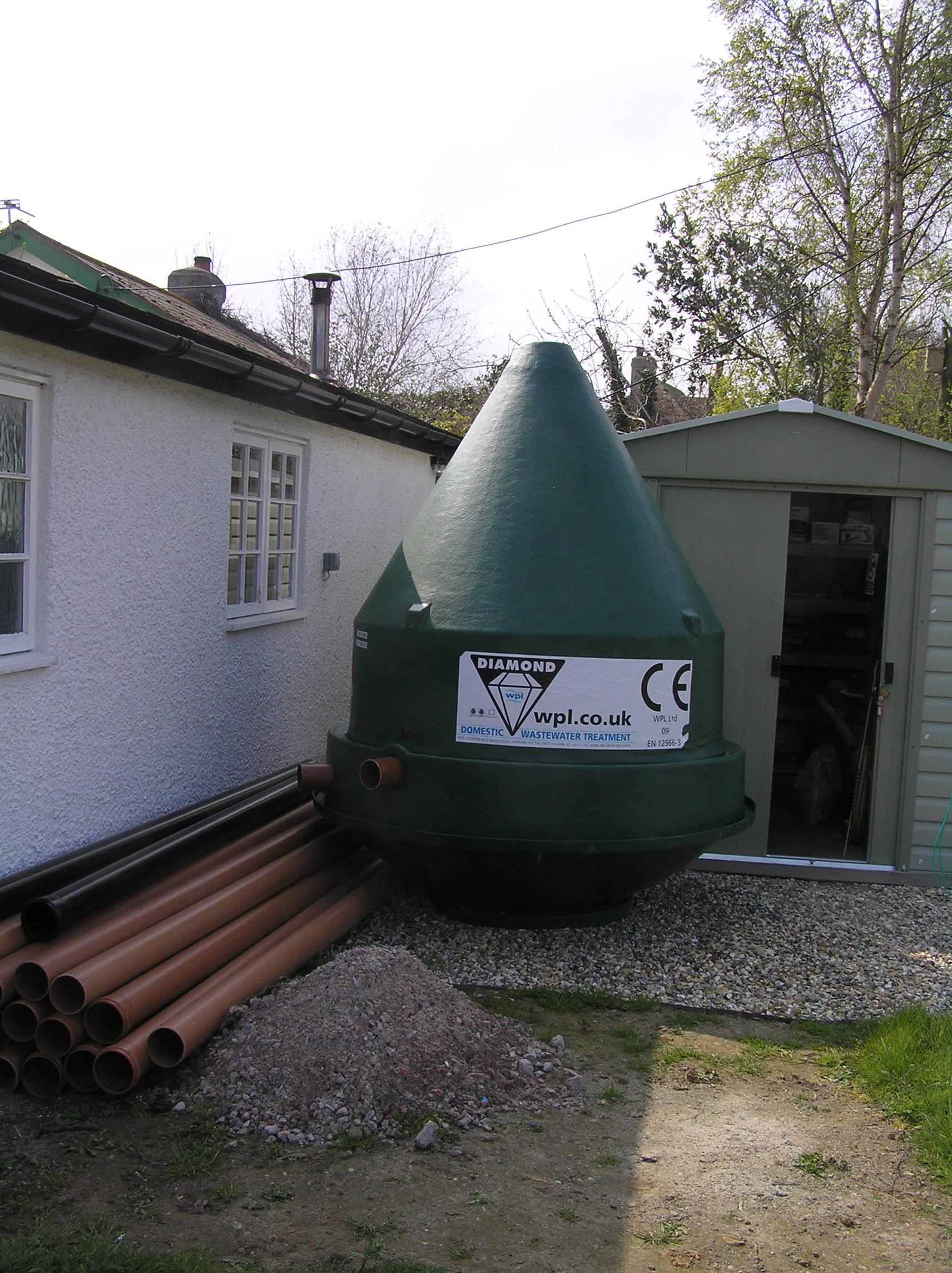

Onoff Posted April 13, 2019 Posted April 13, 2019 @canalsiderenovation , mind me hijacking your thread with my own "cess pool" questions? Got a big issue here with a never emptied one. Needs emptying like now. Trying to find it yesterday evening and the only way I can describe the ground area where it is is a "lasagne of sh!t". Ostensibly unkempt garden I managed (by prodding with a spade) to find what I think is a rectangular manhole cover under about 3" of this stuff. Disturb it and it really chucks up! Trouble is I don't know where the pit is exactly. That man hole might have been before or even on top and I'm a bit worried about the top collapsing in with me on it. It was dug about 1950 I think and the elderly previous owner said something about the "roof" being an arched brick structure. The whole area is covered in thorn and slow bushes so that needs clearing just to access the area and find the edges / access hatch. New neighbours down the road have just bought and renovated one of the last remaining older properties and a few months ago I saw a treatment plant being craned into a hole. I might pop down and introduce myself and ask what they went for. (It was green and beehive shaped). Similar position from the road to where I think I'd put one so guessing it'd satisfy whatever requirements.
ProDave Posted April 13, 2019 Posted April 13, 2019 Green and beehive shaped is almost certainly the BioPure. Same as @JSHarris has. Sounds seriously dangerous prodding about in your "slurry pit" I wonder how deep it is if you did fall in? Could be fatal. take great care. 1

Gone West Posted April 13, 2019 Posted April 13, 2019 54 minutes ago, Onoff said: That man hole might have been before or even on top and I'm a bit worried about the top collapsing in with me on it. I would be very careful and have someone else around in case the worst happens. This is what we fitted, it's upside down by the way . 1
