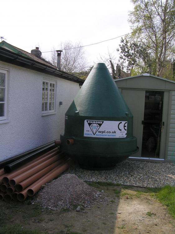

Had a call from from my new neighbour earlier. Turns out it wasn't a treatment plant I saw being lowered into his front garden that I saw driving by.
It was in fact a giant LPG tank! ?
He's still got a big "hole in the ground" like us but the vendors had it emptied before he bought it. Has said he may be considering a treatment plant at some time in the future.
Back to square one.

    Around here they knock holes in the base so they don't need emptying so often.
  • Without a doubt I would fit a small treatment plant, and without a doubt I would choose one that works on the air blower principle like Graff, Vortex, Biopure or Conder (I chose the Conder)
  • I agree with Dave  Little bit more exspensive But cleaner and go can go years without being emtiedb   We had to replace the vendors tank  as part of the build We I staled a treatme
