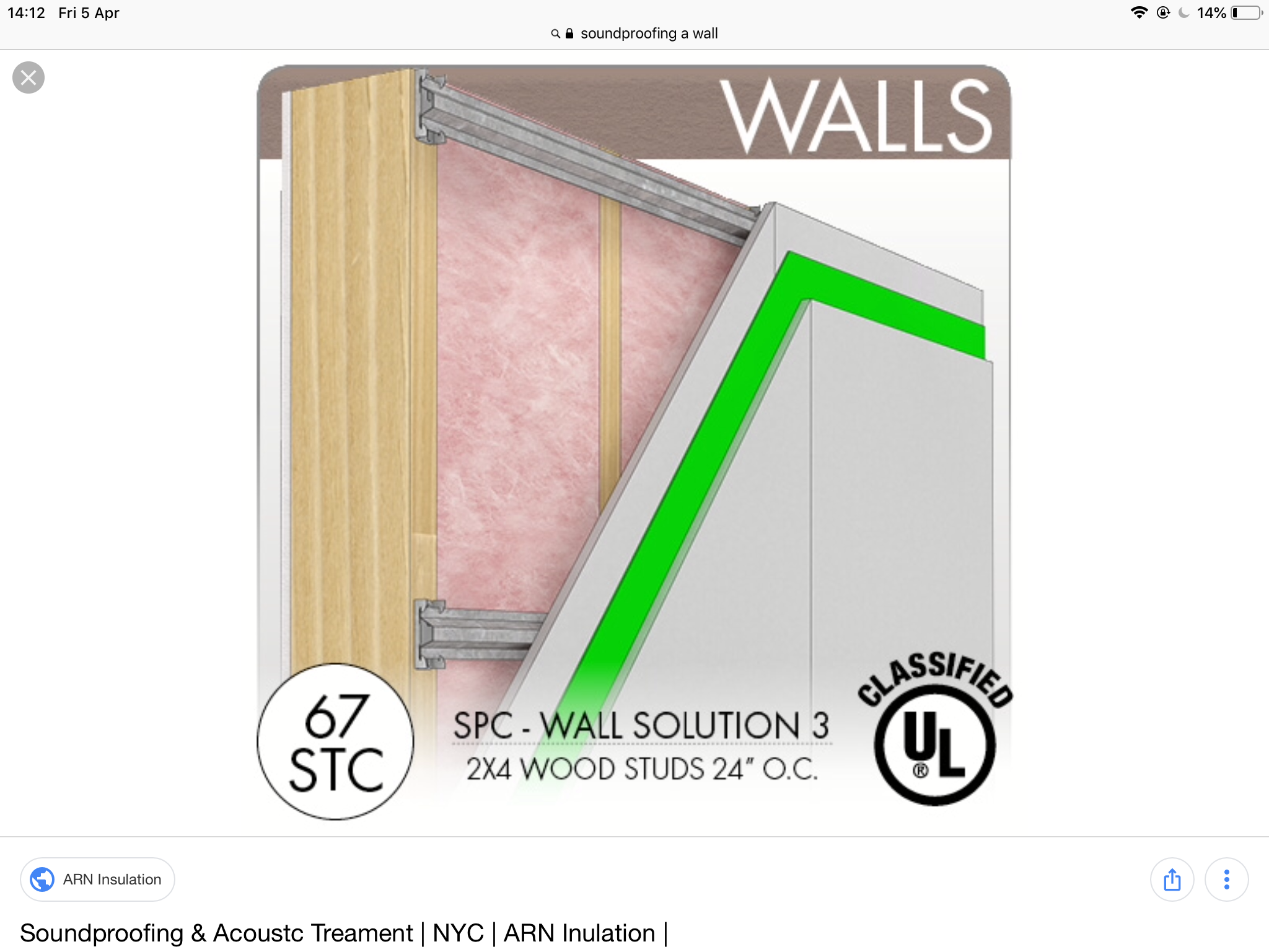

ragg987 Posted April 5, 2019 Share Posted April 5, 2019 All good stuff above, but do remember there are three modes of sound transmission and you need to tackle them all equally. AIR-TO-AIR TRANSMISSION - e.g. through holes and other apertures. This is usually the floor or ceiling junctions - seal these carefully. Also, think about the doors (usually the weakest point) and if you have MVHR and were counting on gaps under the doors you will have to think again. This one is a lot more effort to solve, requiring baffles in the air-flow. VIBRATION - e.g. vibrating drywall. As you mention "daughter singing" this may be less of an issue, vibration becomes more of a problem at lower frequencies. Staggered stud and resilient bar solves this problem. TRANSMISSION THROUGH SOLID MATERIALS - which you can solve with the techniques mentioned above - mass (double plasterboard) and rockwool - no more than 65% of the void. If you decide to go with double-plasterboard, suggest you consider a flexible "glue" (I used Green Glue - probably have some left lying around if interested) between the sandwich and pay attention to sealing all the way round on both layers, plus stagger and seal all joints. Done right this technique will tackle all three modes, above, to some degree. 2 Link to comment Share on other sites More sharing options...
