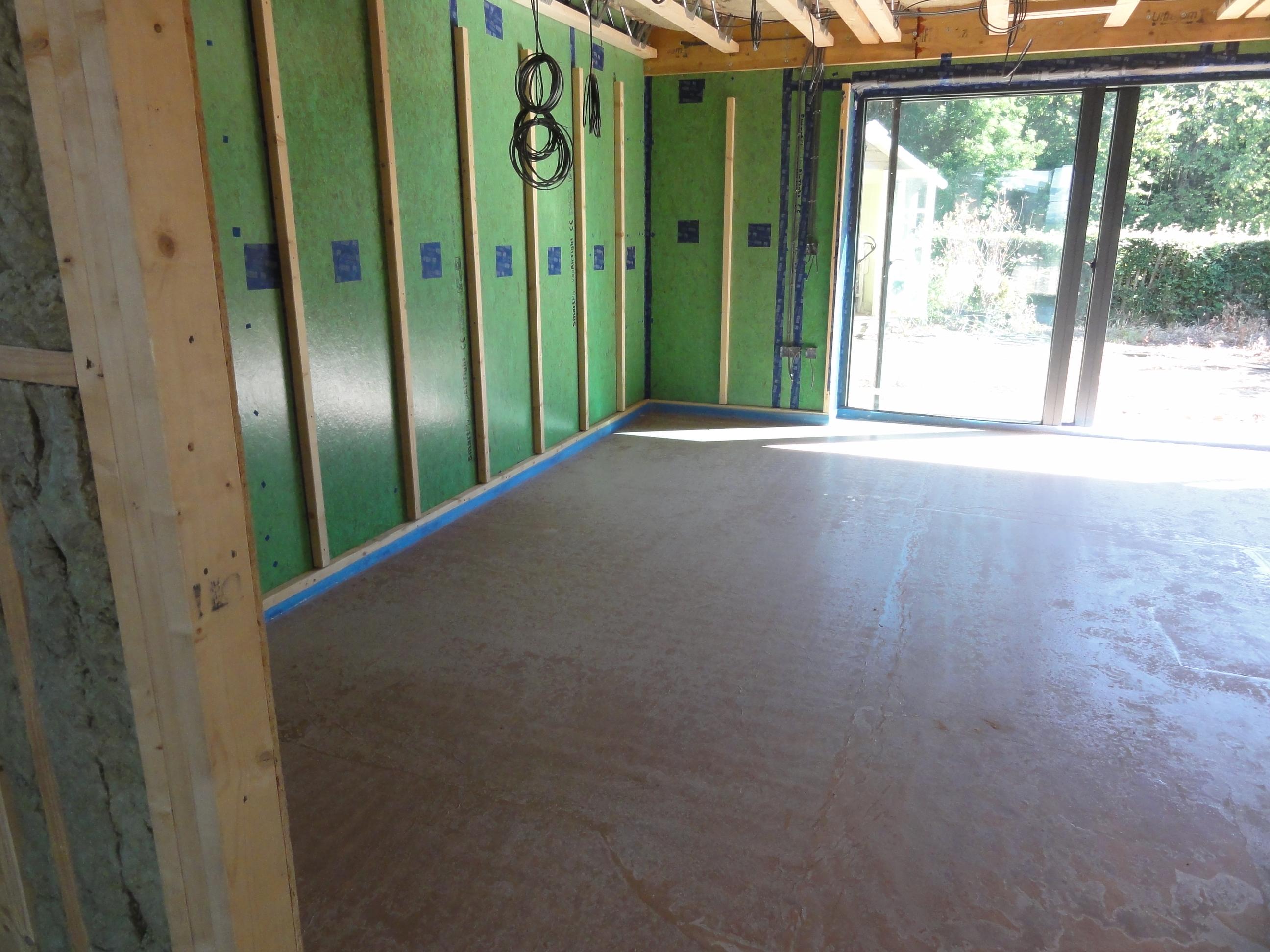

Onoff Posted April 10, 2019 Posted April 10, 2019 Take this passive build for example. 300mm of Peripor polystyrene straight onto the compacted sub base - no membrane underneath:

Jeremy Harris Posted April 10, 2019 Posted April 10, 2019 EPS has a long track record of being used in wet ground without any problems. Before being used for passive slab insulation it was used for lots of basement builds in Germany and Austria, for around 50 years now, with no problems from moisture ingress. I believe they've even used EPS raft foundations to build railway lines across deep bogs, too.

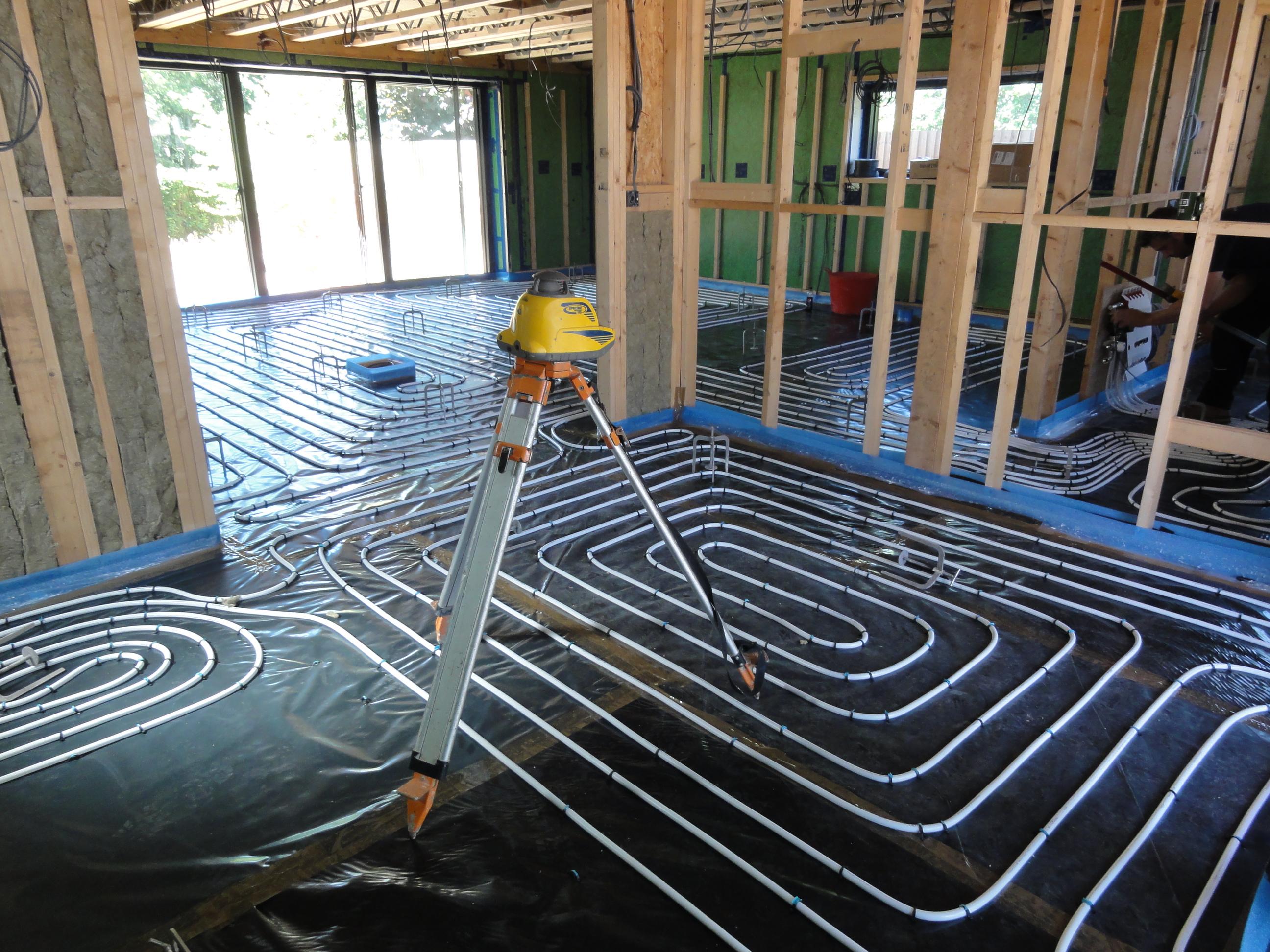

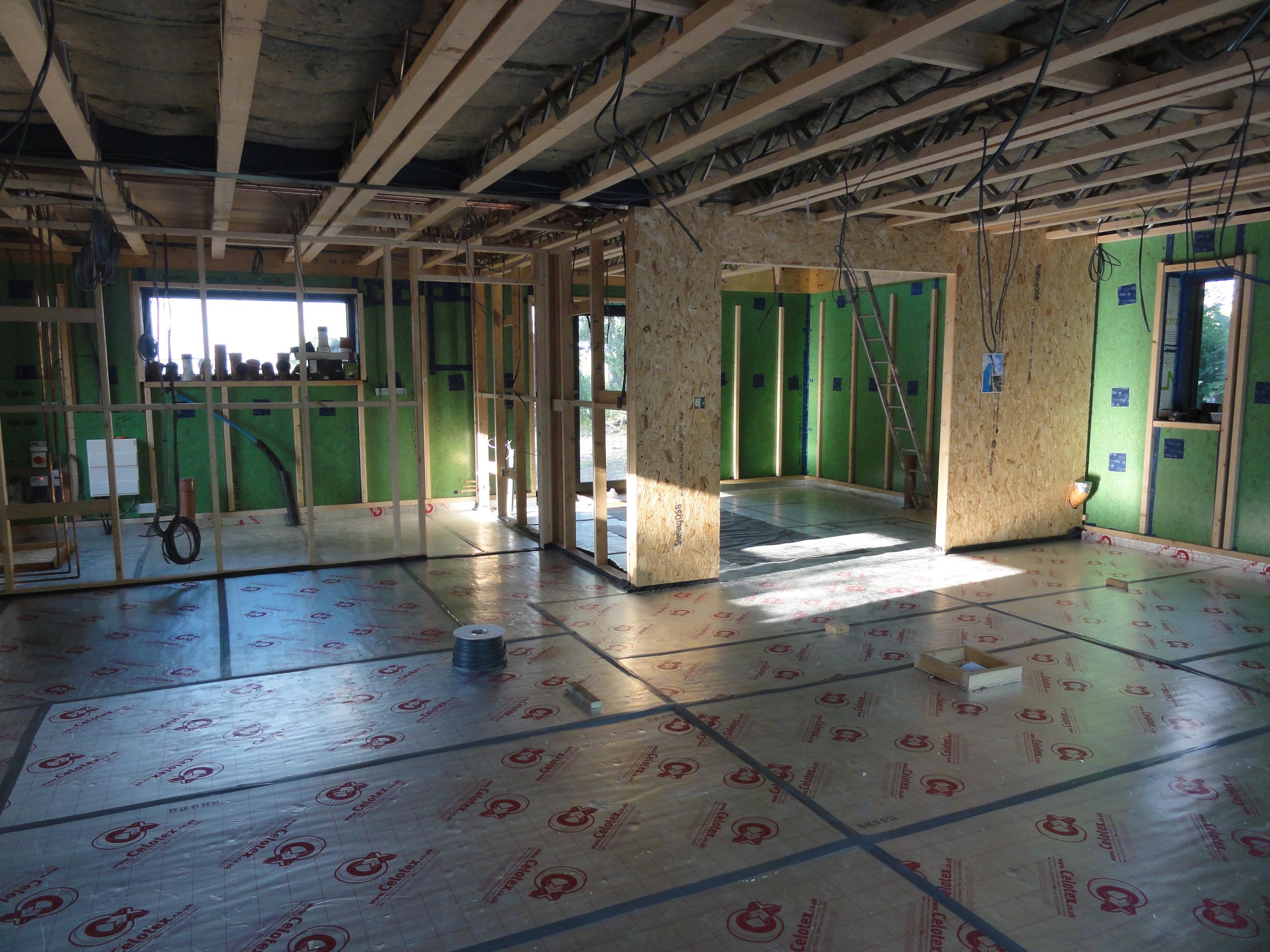

Moira Niedzwiecka Posted April 10, 2019 Posted April 10, 2019 I have suspended beam & block grouted with sand & cement. 1200 dpm lapped up the walls & sealed to the DPM with bitumen tape. I also put butyl grommits over drainage pipes etc coming through the floor & taped them around the edges & the upstands to the pipe 75mm celotex with joints taped. I used duct tape from Lidl. 150mm celotex laid opposite way so joints staggered & then taped. 100mm perimeter celotex 500 gauge dpm foam perimeter expansion strip 50mm calcium sulphate screed. Good idea to take photos & measurements of where UFH pipes run in relation to walls & windows etc. . 3 1
