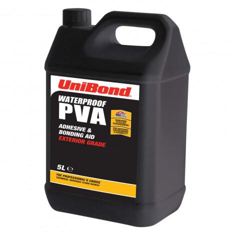

nod Posted March 29, 2019 Share Posted March 29, 2019 To make life a bit easer Clean the brick faces off with a wire brush add a bonding agent SBR or Unibond to 5 parts water and a few handfuls of dry cement and paint it on the area to patch Leave it for a couple of hours Then apply your first coat You will find that it sticks much better and doesn’t dry as Quik Second coat can go on after a couple of hours Link to comment Share on other sites More sharing options...

zoothorn Posted March 30, 2019 Author Share Posted March 30, 2019 9 hours ago, nod said: To make life a bit easer Clean the brick faces off with a wire brush add a bonding agent SBR or Unibond to 5 parts water and a few handfuls of dry cement and paint it on the area to patch Leave it for a couple of hours Then apply your first coat You will find that it sticks much better and doesn’t dry as Quik Second coat can go on after a couple of hours Nod hi there, Do you mean a builder's pva? (isn't wood glue the same stuff.. I have this to hand for a small 0.5 area mix). Ive then got to establish what this 'coat' consists of. What render is. Link to comment Share on other sites More sharing options...

nod Posted March 30, 2019 Share Posted March 30, 2019 21 minutes ago, zoothorn said: Nod hi there, Do you mean a builder's pva? (isn't wood glue the same stuff.. I have this to hand for a small 0.5 area mix). Ive then got to establish what this 'coat' consists of. What render is. Wood glue is the same as PVA Link to comment Share on other sites More sharing options...
Onoff Posted March 30, 2019 Share Posted March 30, 2019 With my first house, not knowing otherwise I added PVA to EVERYTHING, render for walls, mortar for bricklaying, concrete, EVEN plaster. Put it this way none of it's come off! I would religiously add 5 of water to 1 of PVA and used that to mix whatever in place of plain water. I'd size walls with the 5:1 mix also. Not all PVAs are created equal! I used to use Wickes waterproof one. Now it's about £25 for 5L. Sometimes I'd use Unibond's offering. Link to comment Share on other sites More sharing options...
