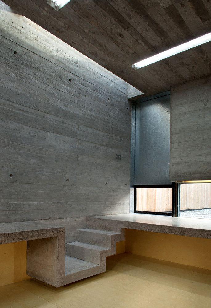

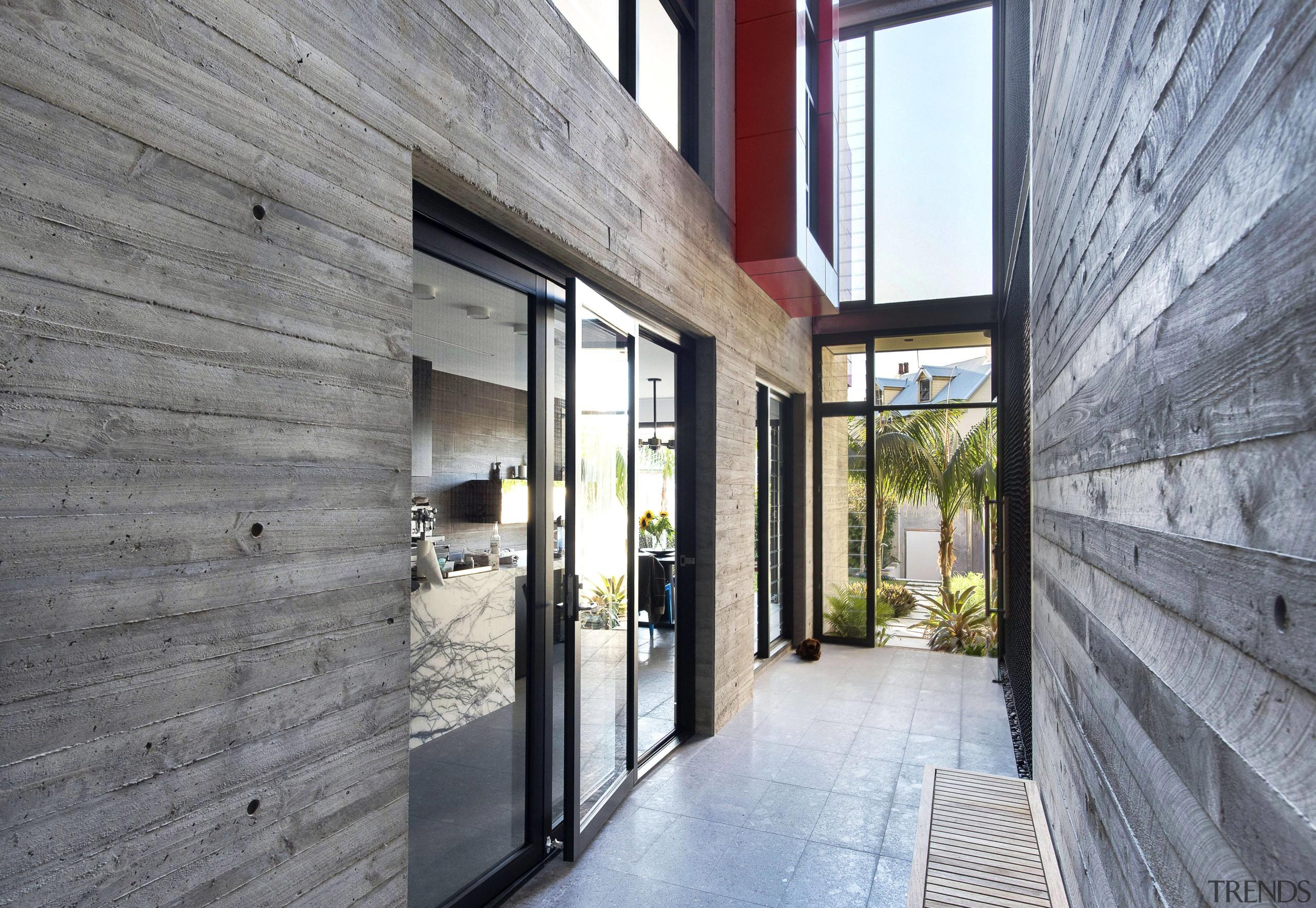

K78 Posted March 29, 2019 Posted March 29, 2019 I’m trying to do as much of my build as possible to keep costs to a minimum. (Isolohr foundation, Durisol blocks or similar, Siberian larch exterior cladding) I’ve been thinking about my interior walls. I’ve wanted concrete from the outset. The concrete effect plasters are ridiculously expensive, as are the wall panels. I’m also not a plasterer. I have 2 joiners helping with my build. I was thinking of getting them to make floor to ceiling “moulds” out of 2” boards, that interlock together with 1cm wood block “spacers” on the front. I would cover the walls with Portland cement then drill the moulds to the walls while the cement is wet. The “spacers” would keep the cement depth consistent. Hopefully it would achieve a look similar to the attached pics? Is this a terrible idea? Thoughts would be appreciated.
Triassic Posted March 29, 2019 Posted March 29, 2019 (edited) Why not do a trial panel, if it look rubbish you could remove it. Maybe fix an 8 x 4 sheet to the wall as a temporary backer and pour concrete against that as your trial peice. Edited March 29, 2019 by Triassic 1
Mr Punter Posted March 29, 2019 Posted March 29, 2019 It is an interesting idea. The pictures look fantastic. I think it will be expensive and time consuming and if the finish is not spot on you will need to take it off and start again (or make the room 1" smaller!). If you get anywhere near a decent result I take my hat off to you. 1
Sue B Posted March 29, 2019 Posted March 29, 2019 I think these pictures are stunning but I think a DIY version could be awful unless you (and your team) are real craftsmen, able to spend a lot of time creating the look. I saw the Grand Design house a few months ago that had a concrete interior finish and I though it looked bloody awful and I fear a DIY version could easily head that way. 1
K78 Posted March 29, 2019 Author Posted March 29, 2019 (edited) Thanks for the replies. I think it would be time consuming but not so expensive compared to alternatives. Polished concrete walls look great but cost a fortune. Definitely not diy. A very skilled job I would make 3 “moulds” that interlock together so that the pattern isn’t too uniform. As the wood grain in the boards forms the texture, I am thinking it would be relatively straight forward. Like vertical moulded drive. The finish doesnt have to be perfect. I love the texture of board formed retaining walls. Edited March 29, 2019 by K78

Mr Punter Posted March 29, 2019 Posted March 29, 2019 Does anyone have a link to see how this is done in practice? I would be really interested to see how they make up the shutters, anchor them, construction joints, grout checks, concrete spec, how to pour and striking. I know how it is for casting a concrete wall, but facing an existing wall would be quite different.
K78 Posted March 29, 2019 Author Posted March 29, 2019 1 hour ago, Mr Punter said: Does anyone have a link to see how this is done in practice? I would be really interested to see how they make up the shutters, anchor them, construction joints, grout checks, concrete spec, how to pour and striking. I know how it is for casting a concrete wall, but facing an existing wall would be quite different. I think I maybe the first. I can’t see why it wouldn’t work. The shutters are simple to construct and fix. I was planning to use Portland cement like plaster. Apply it thick, then fix the shuttering whilst it is wet. Can’t find anything on YouTube or a google search. Lots of examples of using rubber moulds for a brick/stone effect though. Similar to moulded concrete drives.
