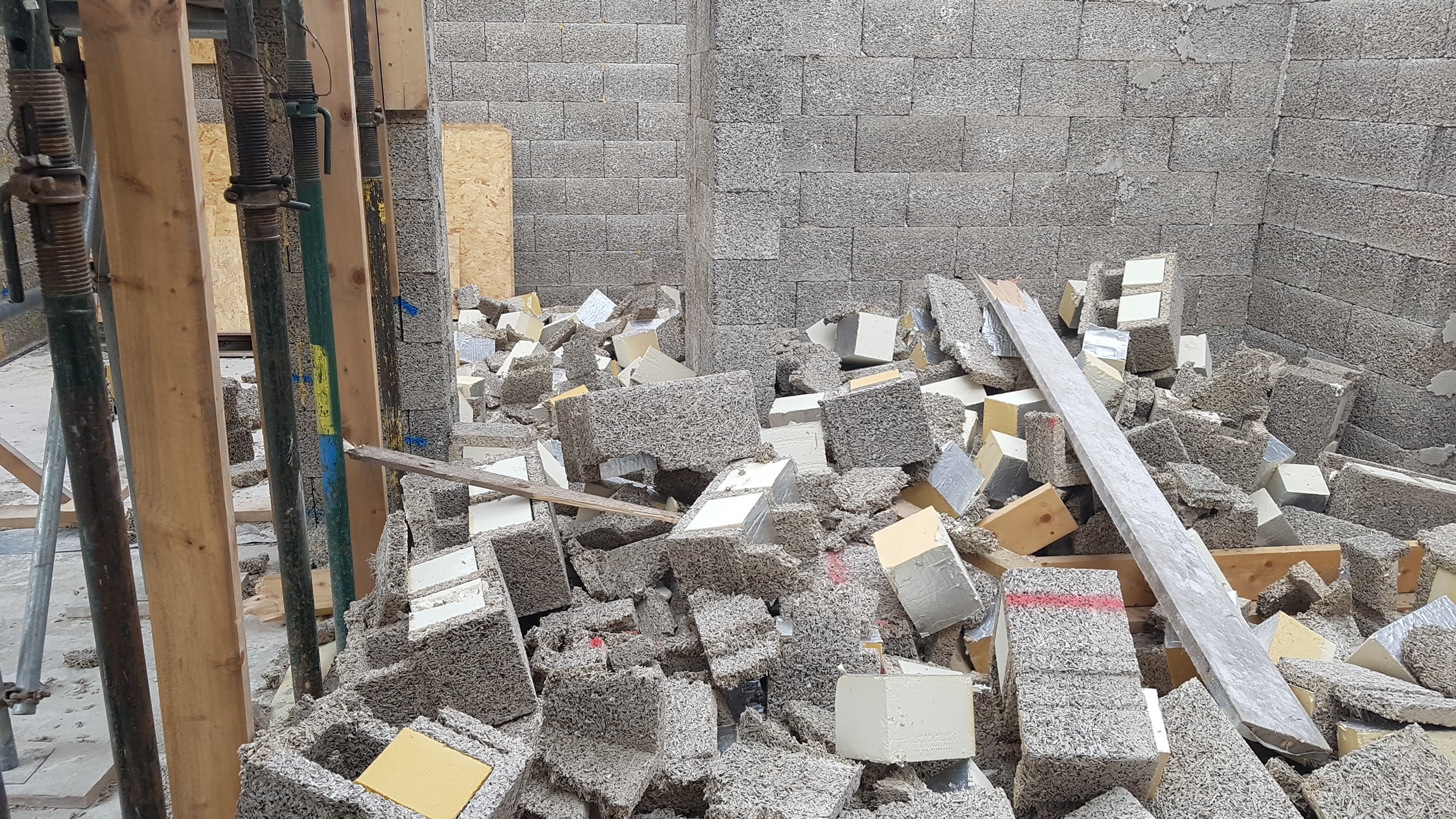

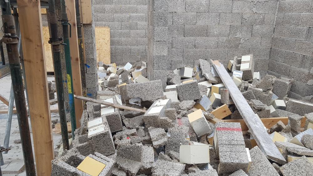

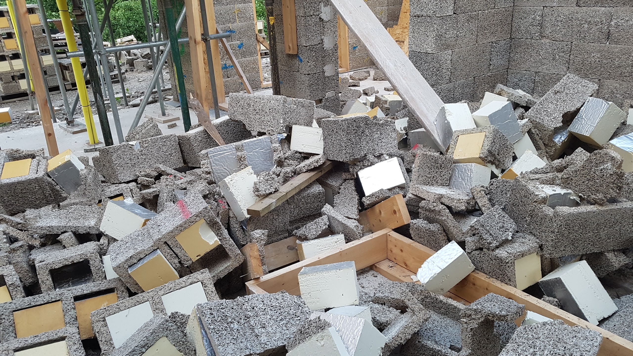

ToughButterCup Posted April 24, 2019 Posted April 24, 2019 On 24/04/2019 at 14:53, K78 said: [...] I’m guessing a few people have had disasters at 2.5m? [...] Expand PMSL... wet the sofa, tea up my nose, cake stuck in my craw, coughing fit to cause a hernia. Seen this? or this? or read this? For a calmer take on things, read this ... The height at which the wall collapsed was 4 meters plus. You can (but dont ever try it) pour a complete house. I have seen it done. Its a stupid (and should be ) an unnecessary risk. The pour height issue is one where willies are waved and sales spin weaved..... I have a feeling that a good rule of thumb should be - dont pour more concrete than you are prepared to lose at any single pour. For me, thats about £500 (concrete, plus pump, plus reinstatement). Not all of the concrete poured will come out of any single block burst. Multiple block bursts will almost certainly be the result of negligent or criminal mishandling of the blocks or substandard blocks which should have been identified before placement.. Multiple block bursts are rare, but in our case - a godsend. I kid you not Read on 1
K78 Posted April 24, 2019 Author Posted April 24, 2019 On 24/04/2019 at 15:17, jack said: I assume part of the problem is not only the much higher risk of a burst, but the more severe consequences at that height. 2.5m means an awful lot of concrete to find its way out of a burst. Expand It will have a big say in which route I take. My whole plan and costing was geared around 2 pours. Im glad one of the joiners I am using attended the durisol course with me. The additional concrete pump hire is costly and I would have people stood around on site doing nothing if we could only stack 3 blocks high. 1
K78 Posted April 24, 2019 Author Posted April 24, 2019 On 24/04/2019 at 15:29, AnonymousBosch said: PMSL... wet the sofa, tea up my nose, cake stuck in my craw, coughing fit to cause a hernia. Seen this? or this? or read this? For a calmer take on things, read this ... The height at which the wall collapsed was 4 meters plus. You can (but dont ever try it) pour a complete house. I have seen it done. Its a stupid (and should be ) an unnecessary risk. The pour height issue is one where willies are waved and sales spin weaved..... I have a feeling that a good rule of thumb should be - dont pour more concrete than you are prepared to lose at any single pour. For me, thats about £500 (concrete, plus pump, plus reinstatement). Not all of the concrete poured will come out of any single block burst. Multiple block bursts will almost certainly be the result of negligent or criminal mishandling of the blocks or substandard blocks which should have been identified before placement.. Multiple block bursts are rare, but in our case - a godsend. I kid you not Read on Expand I was aware of your issues mate. But I thought they were down to the contractor not taking care with the blocks? I was planning on going to 2.5m and pouring that day.
