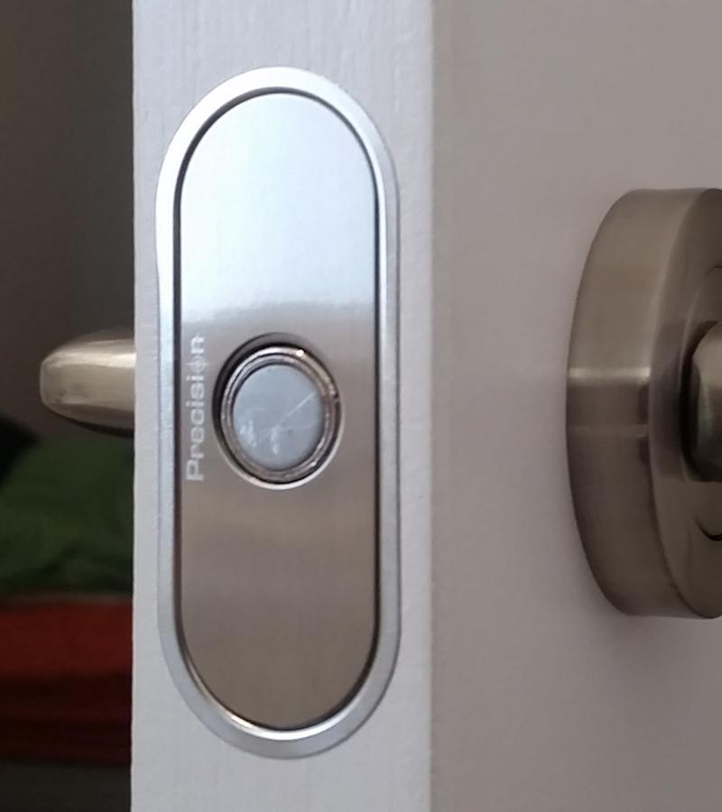

These are the magnetic latches that I have.
https://www.doorhandlecompany.co.uk/excel-hardware-precision-bolt-through-magnetic-tubular-latch-18364/

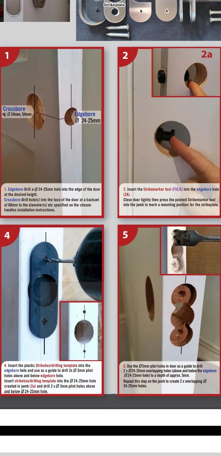

Would these magnetic latches fit into a cheap 34mm thick door?
Posted
The installation guide says you have to drill a 24mm hole in the edge of the door.
The latch is 29mm wide including the frame on the surface so it should just fit but will need to be well centred.

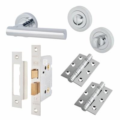

Where can I buy the handle and twiddly bits like this as a kit that go on the door faces:
Cheers
Posted
Www.ironmongerydirect.co.uk
I bought all my door handles and hinges from them, as well as screws when I have time to order. Good products, good value.

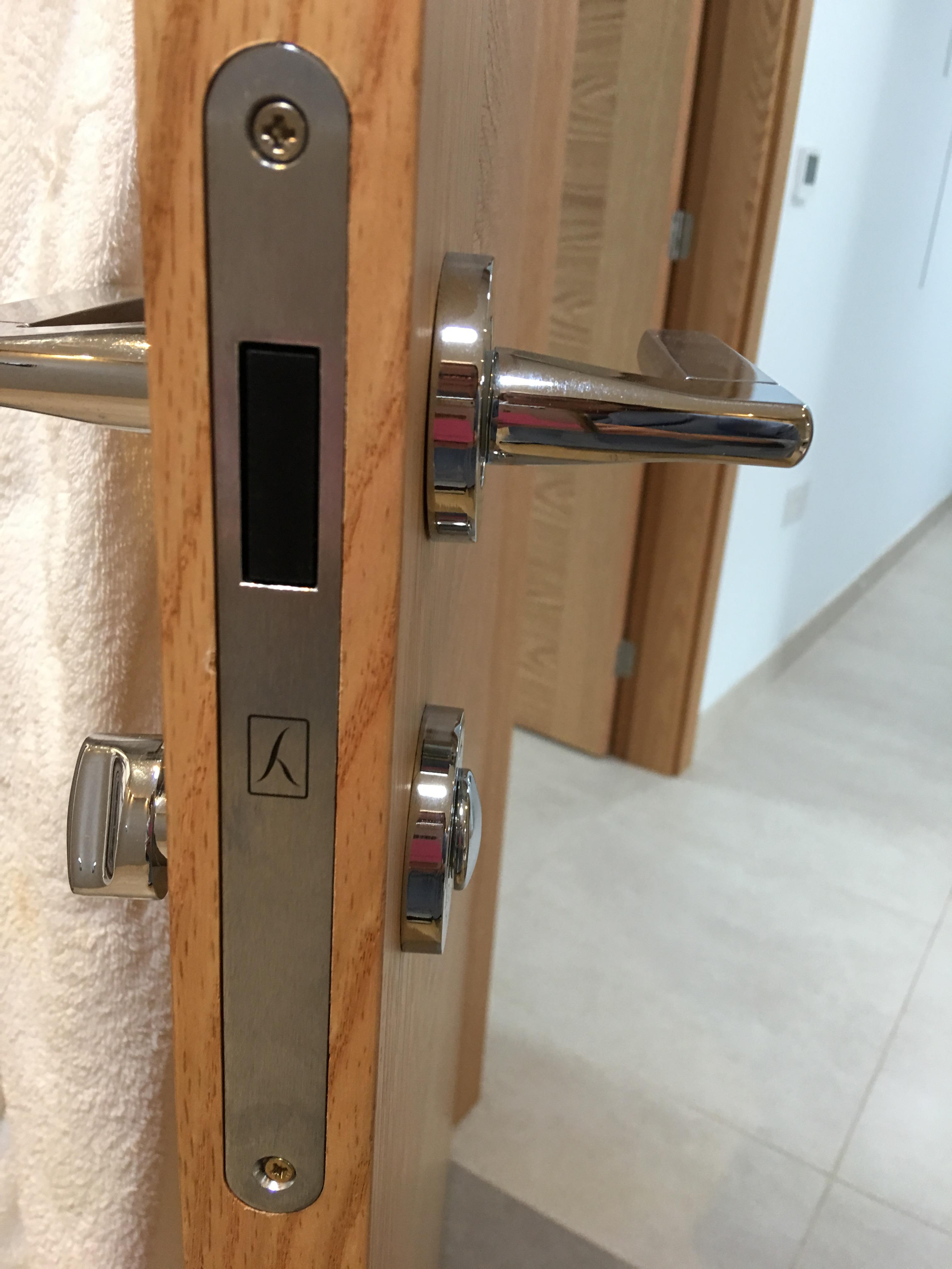

I'm a bit lost as to how this magnetic lock works:
I'm used to this sort. The handle operates the sprung top catch. The thumbscrew operates the lock with an emergency release thing the other side. Again with the pic why no second handle?
Off to YouTube!

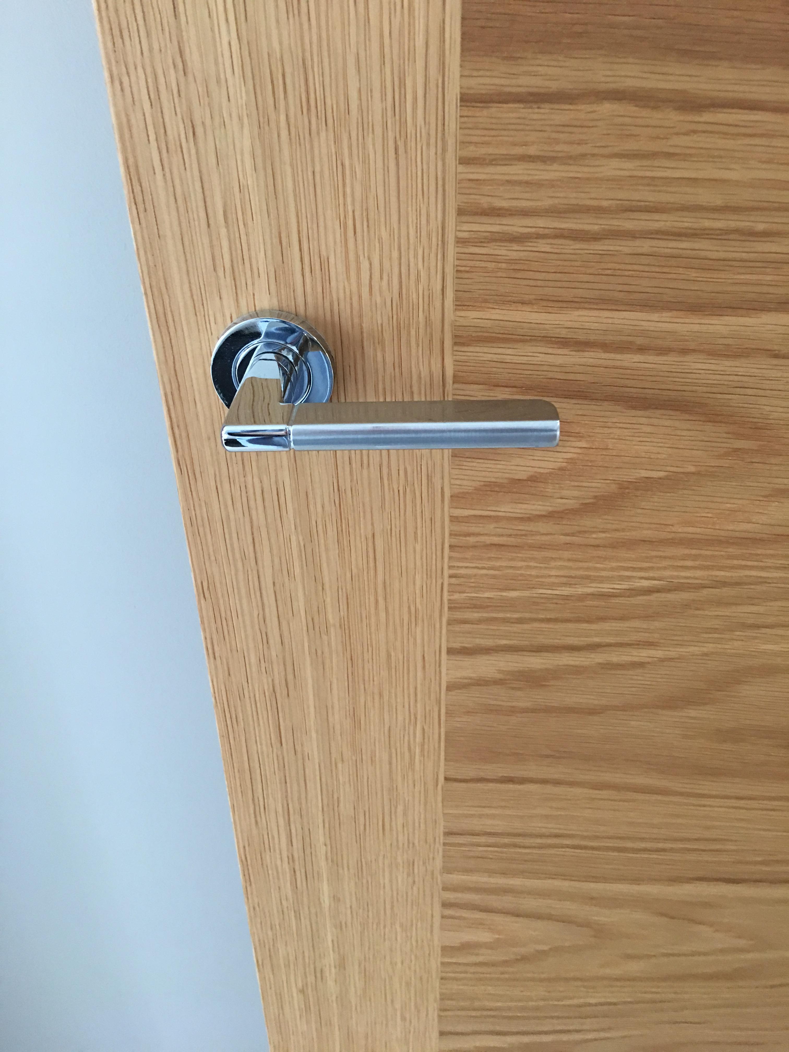

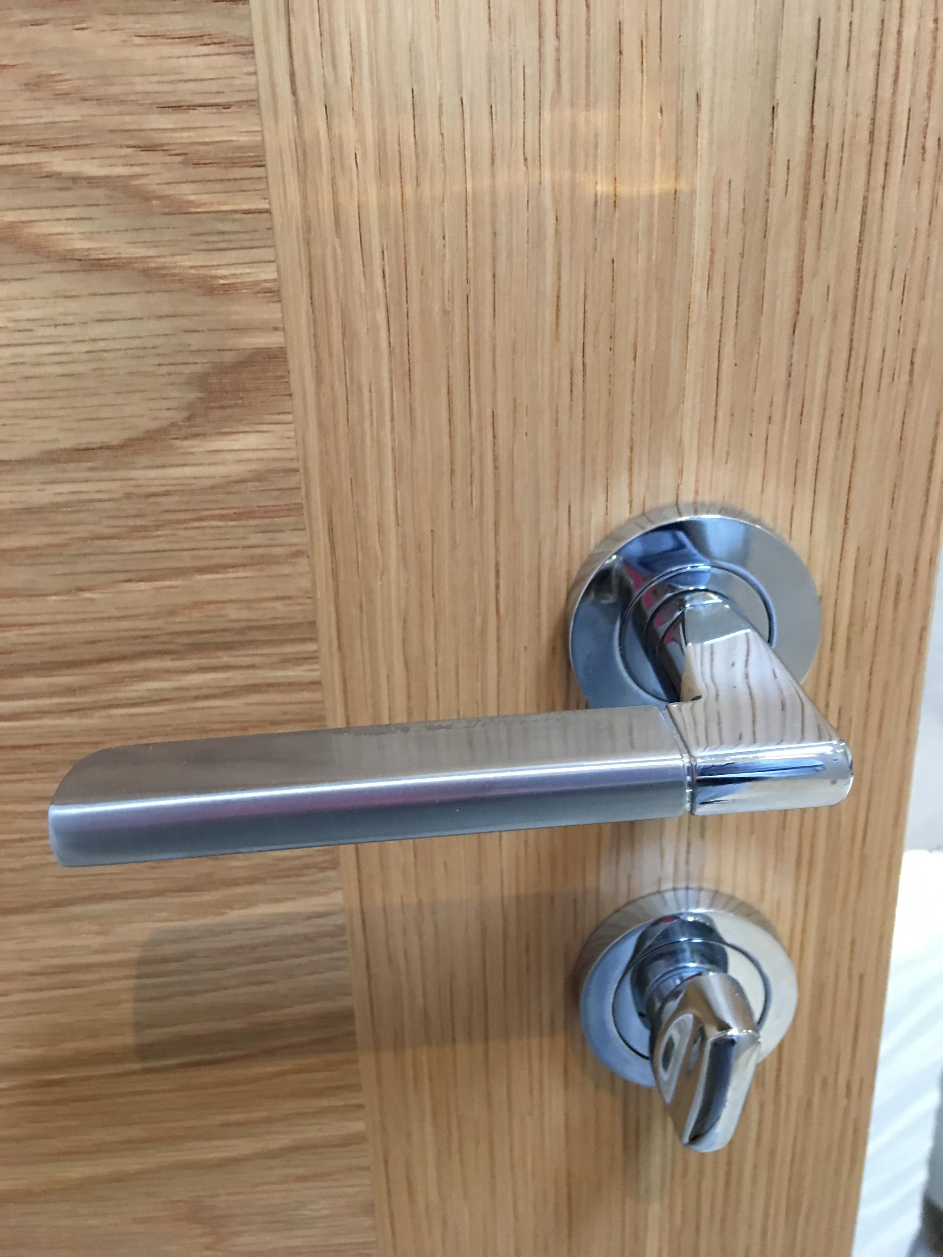

Posted

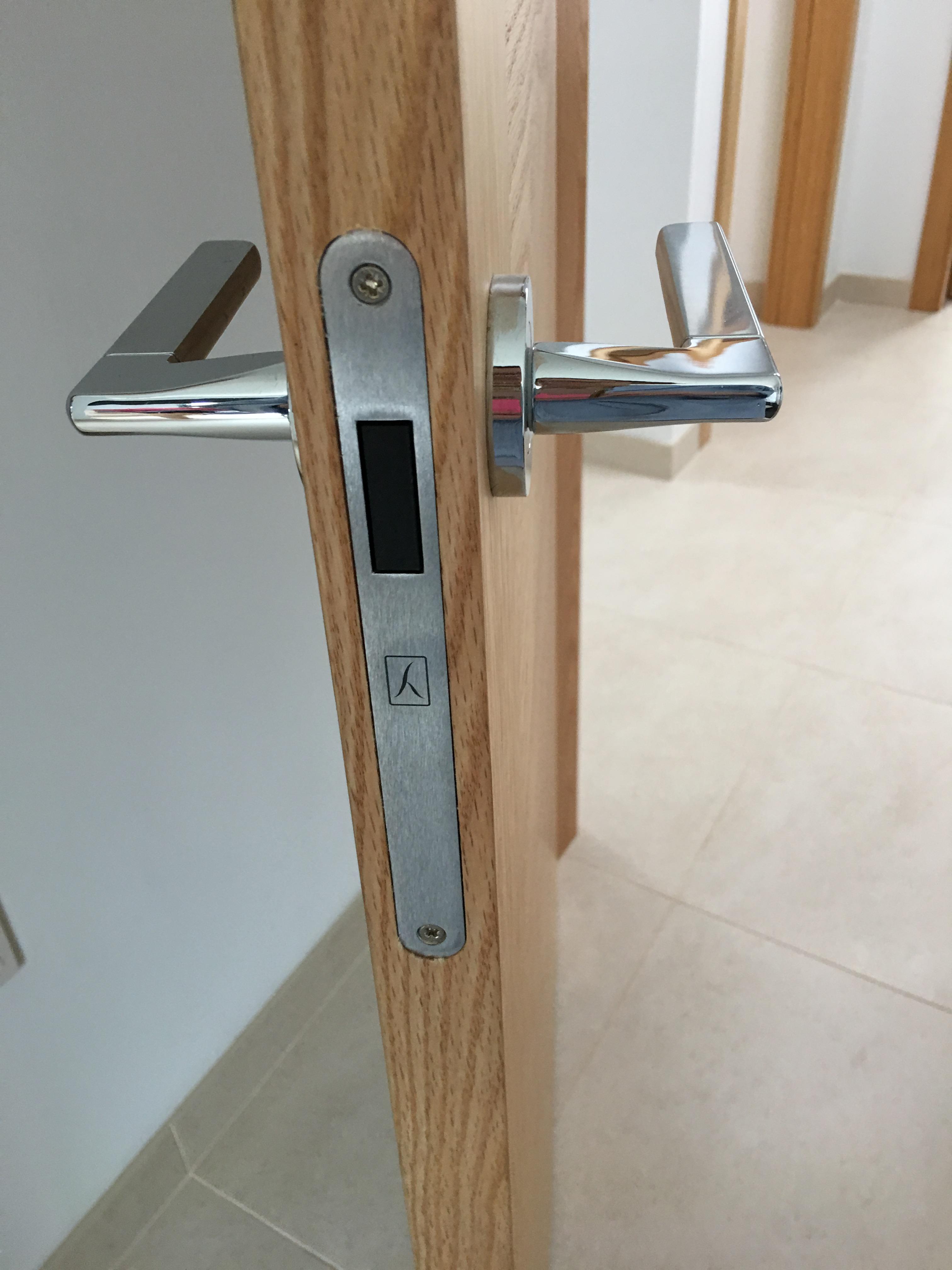

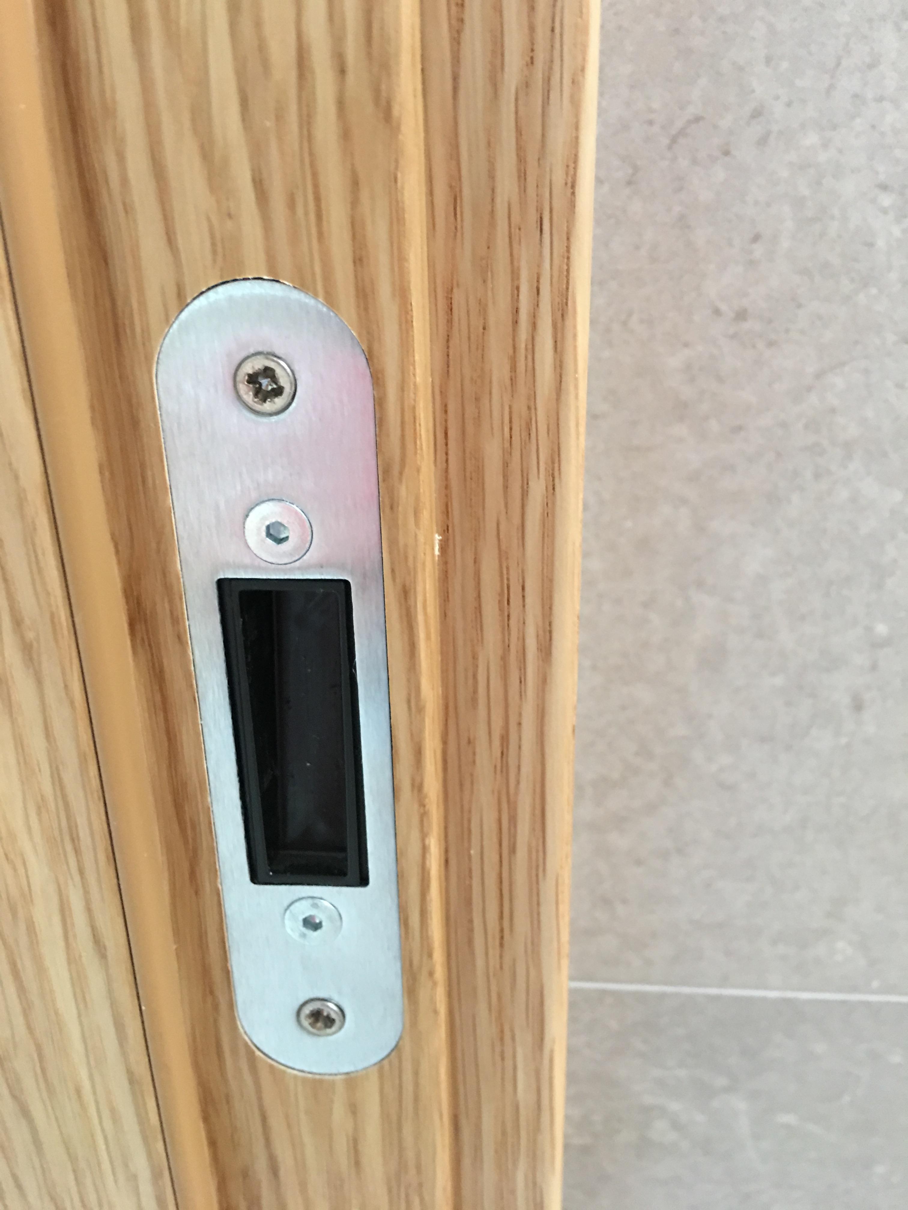

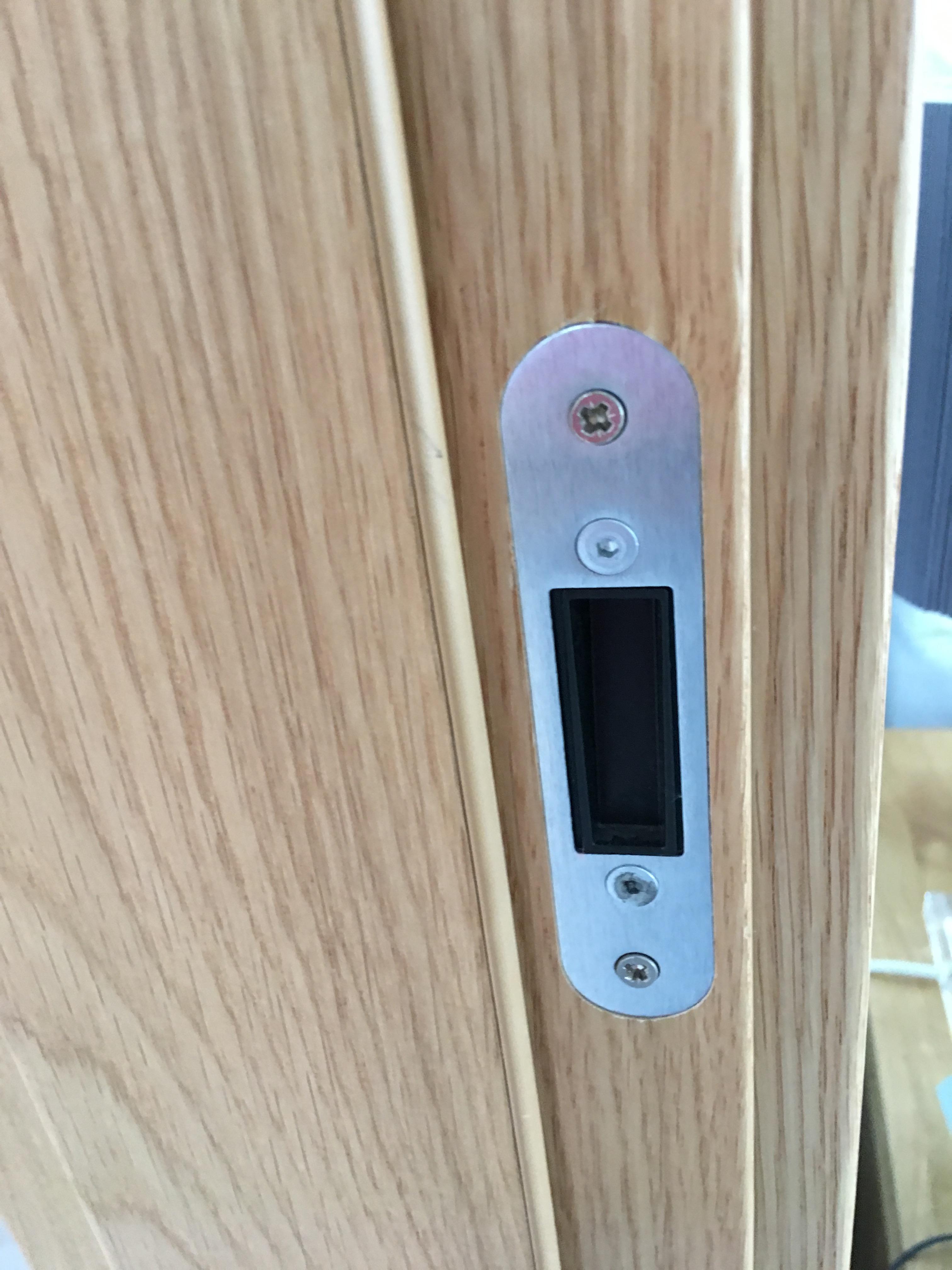

These are my magnetic latches......privacy bathroom door and ordinary door.  I’m not sure how the thumb turn privacy latch works as it looks exactly the same as the ordinary door bar the thumb turn.

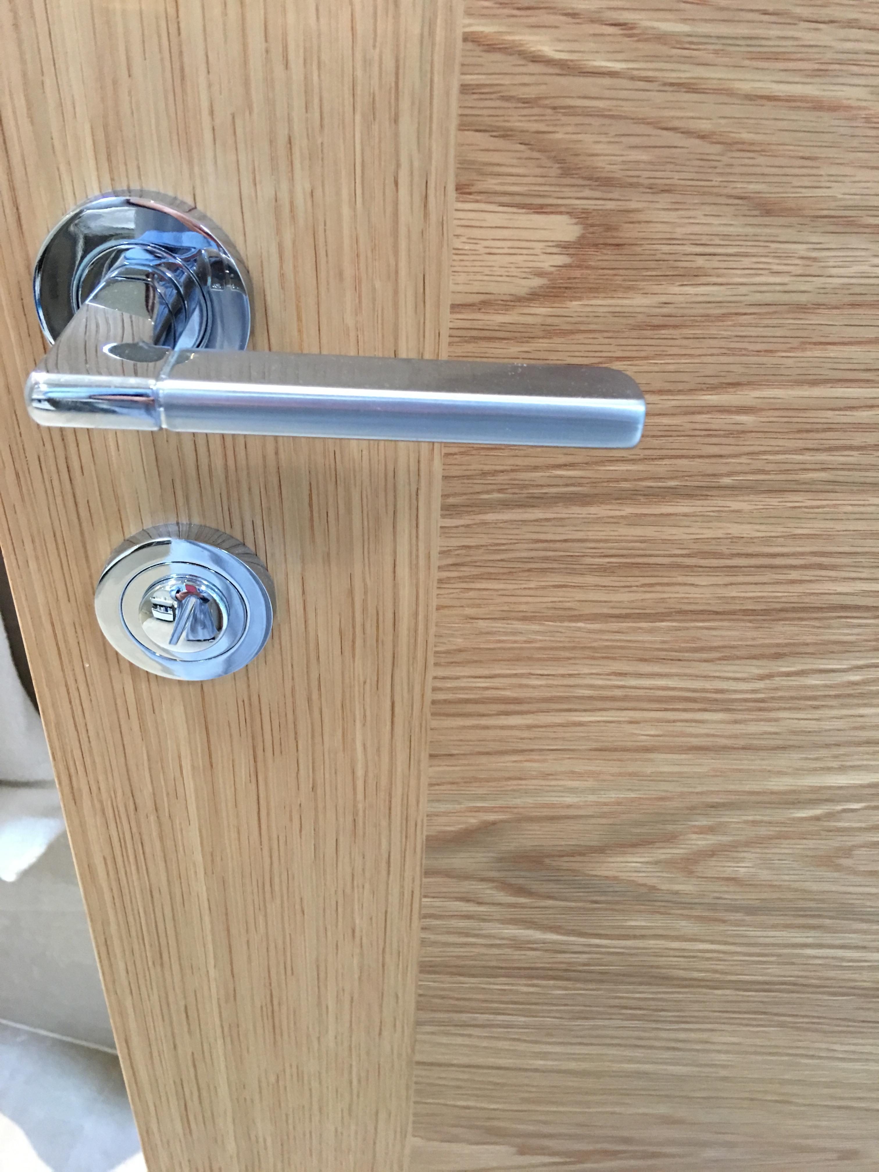

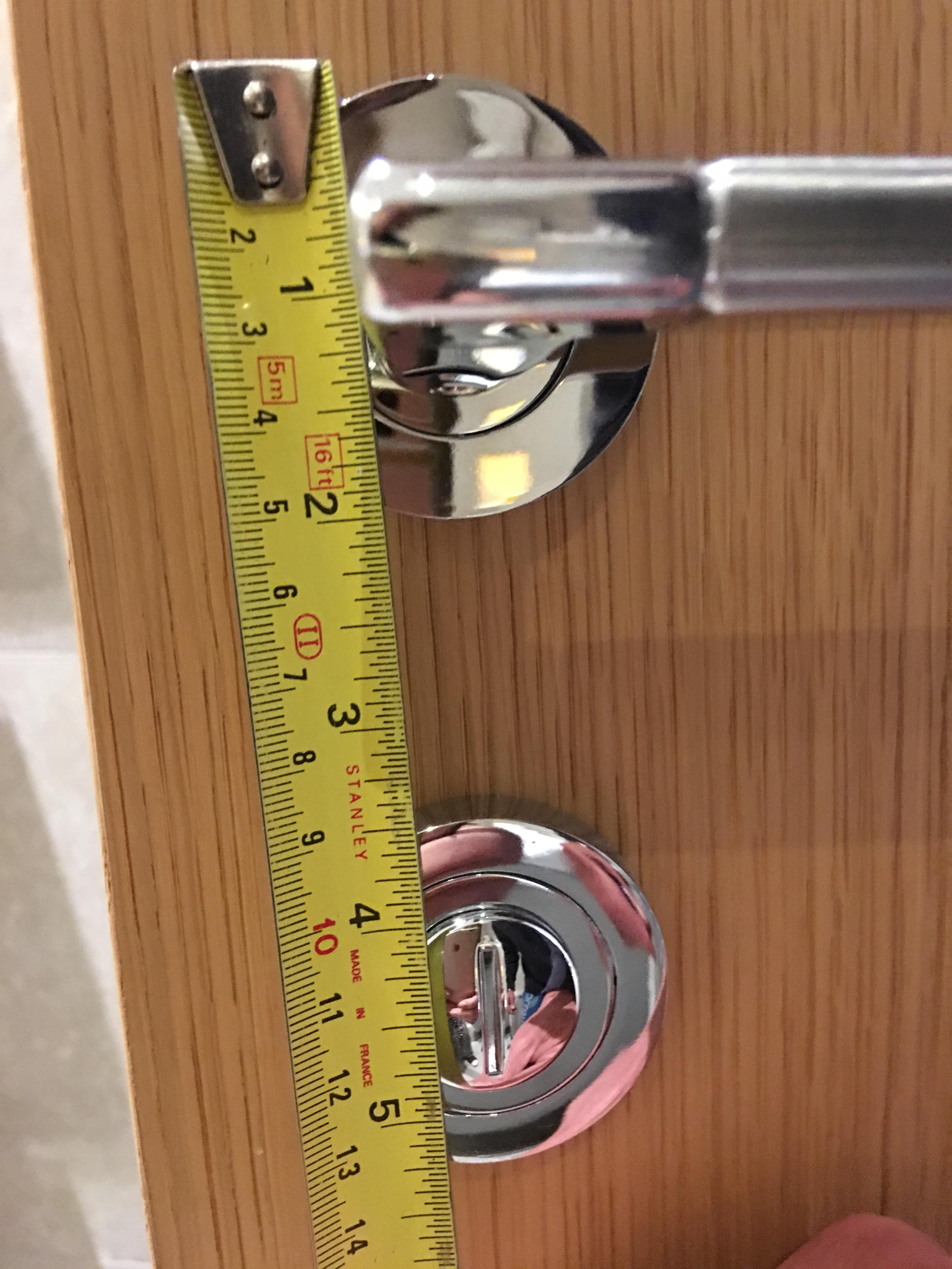

Would you mind please, measuring the centre of the handle to centre of the privacy latch.
Cheers

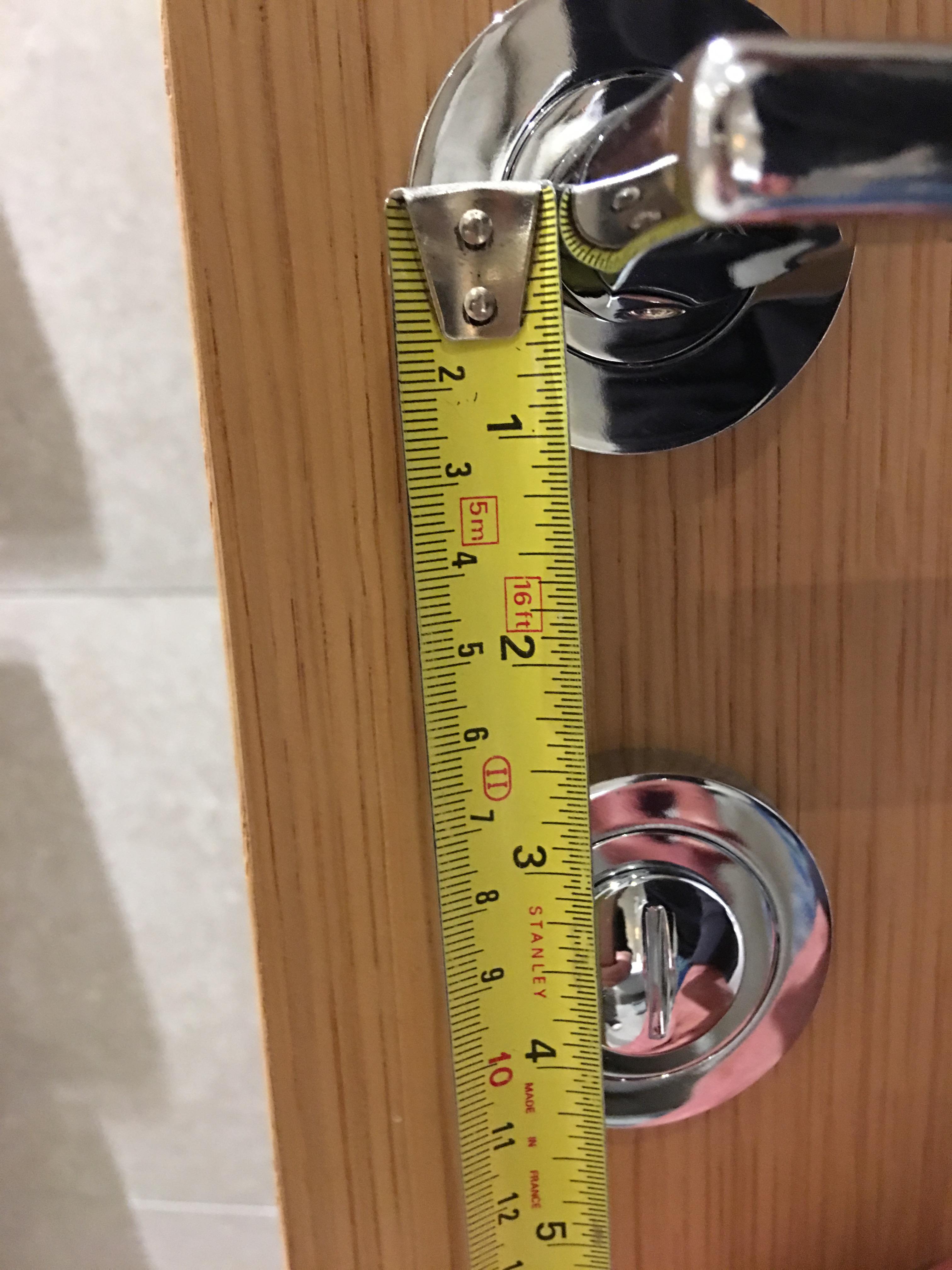

Posted
1 hour ago, lizzie said:
@Onoff is this the measurement?
Thanks. Your 2nd picture gives centre to centre at about 3.5".
Oddly enough mine will come out the same. Decided to move the handle centre to the top of the lock bar (970mm from floor) and the privacy to dead centre of the lock bar.
