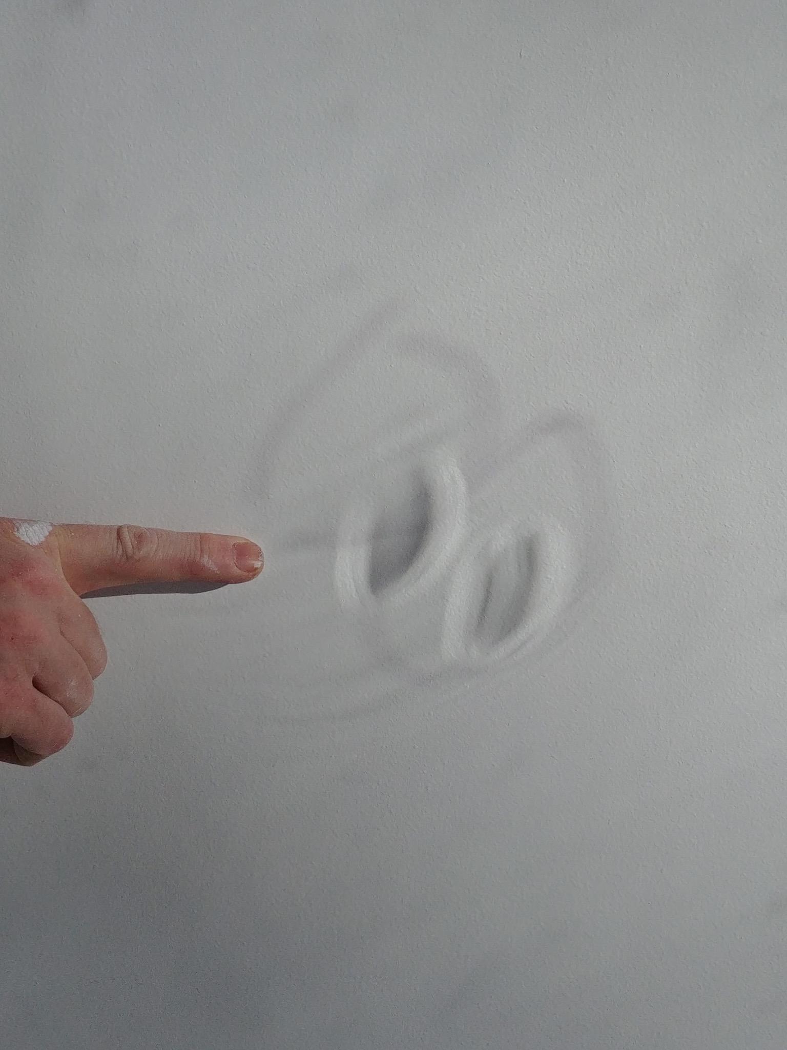

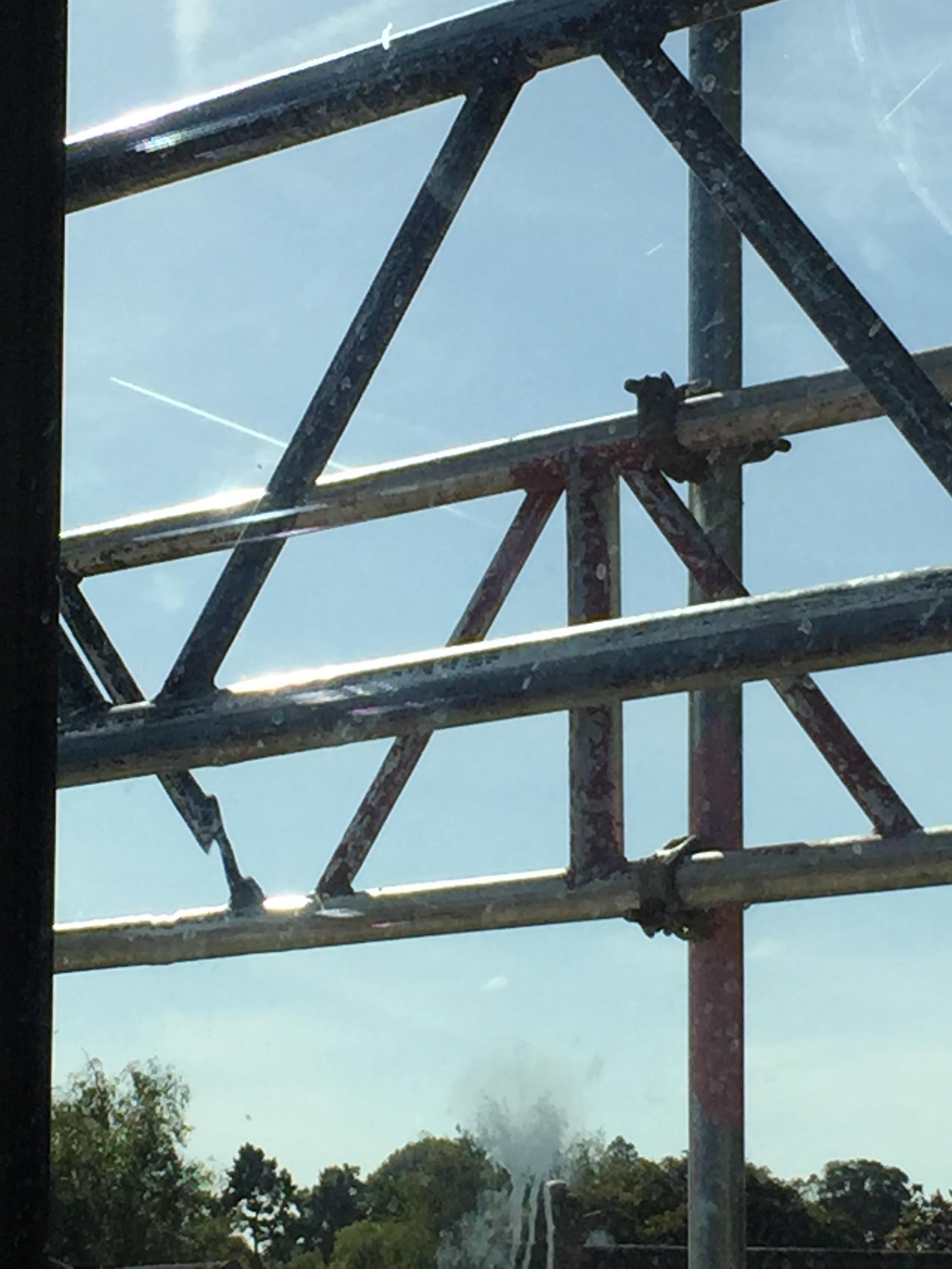

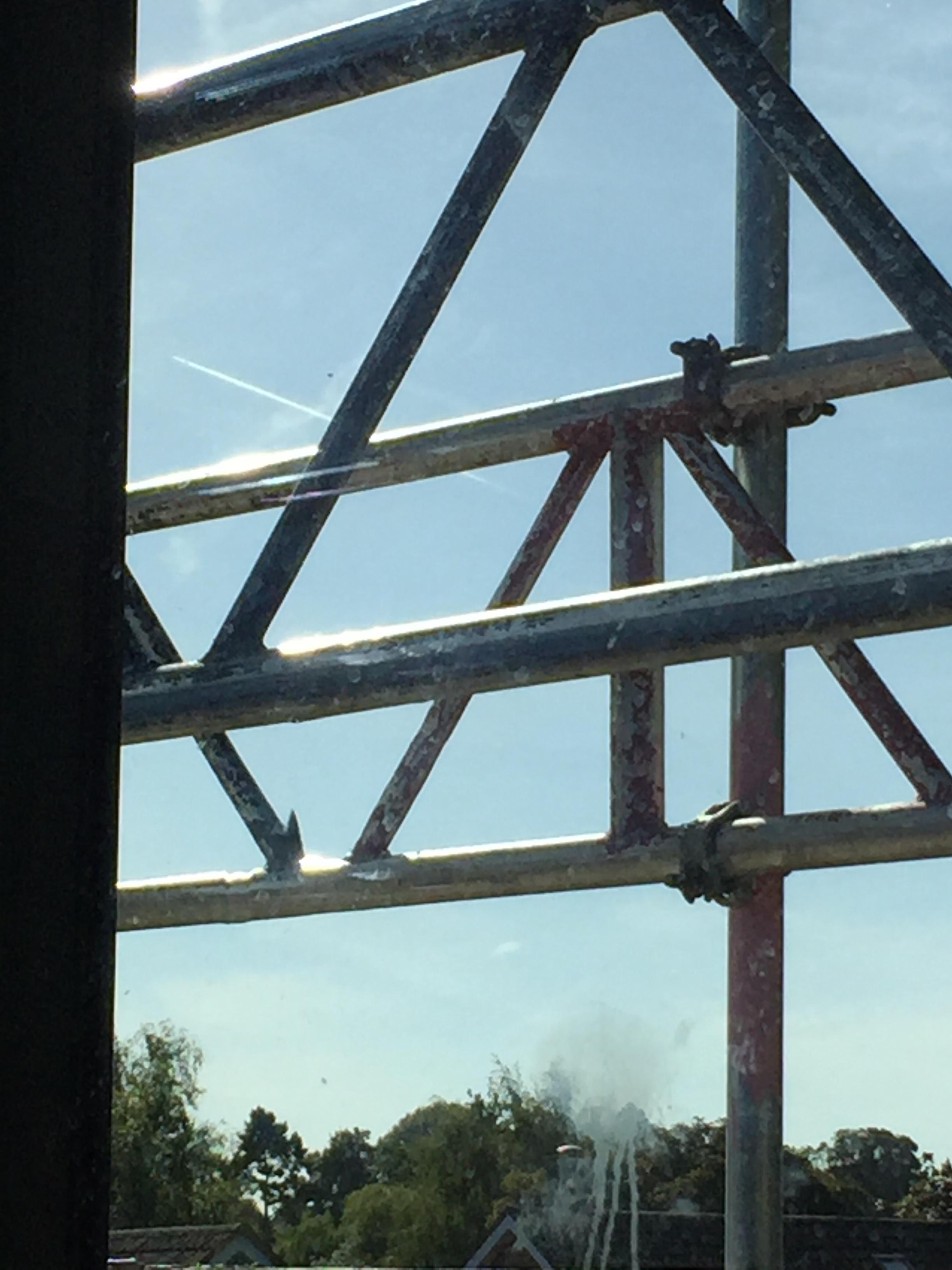

Weebles Posted March 26, 2019 Posted March 26, 2019 Soon after our windows were fitted last September we noticed two defects in one of the large panes. We were told this was part of the manufacturing process and one of the risks of getting a large pane of glass. The pane in question is about 3 m x 2 m. We have 12 such panes of glass in our house and none of the others have any defects. Other than this window, we are absolutely delighted. At the time we raised it with the UK distributor of the windows. They agreed it was unacceptable. They raised it with the European supplier who noted it was part of the acceptable defects that may appear in a pane of glass this size. Now that the walls of the room are plastered and painted, the sun reflects through the defect and puts a rather hideous shadow onto the wall. Does anyone else have any defects on large panes of glass? Are such defects normal? Windows are aluminium clad, triple glazed. Supplier and distributor shall remain nameless, currently, as I dearly want to get this resolved. The only resolution for me is a replacement pane of glass, fully paid for by the supplier, including transport and fitting. That would be honouring our original contract in my opinion. We have been offered a compensation sum of about a 10th of the cost of the entire window. The windows were very expensive. I don’t want to wake up to that shadow every morning. Photos show the shadow on the wall and also the view out of the window when the scaffolding was in place showing the distortion in the view. Any thoughts welcome please.

Weebles Posted March 26, 2019 Author Posted March 26, 2019 The defect itself is visible from well over 2m if there is something behind the window. Trees for example are distorted. The shadow in the wall, caused by the defect, is visible from the whole room. And nothing we can do to hide that. It will be on the wall opposite our bed so we’ll wake up to it! The quality guidelines are all in German so going to need to work on that. I really can’t believe this is acceptable to the manufacturer. Nobody would buy large windows from them if they thought they might get 2 inch high shadow marks on their walls due to defects. The marks in the glass itself are tear drop shaped on the middle pane. We’ll have to challenge on technical grounds. The manufacturer’s representative hasn’t even been out on site to see the issue. The distributor has and appears to be on our side.
Weebles Posted March 26, 2019 Author Posted March 26, 2019 I should add that way back in October the supplier agreed to replace the glass as some sort of goodwill gesture but wouldn’t cover the transport or install as the defect was “within quality guidelines”. Transport from Europe and install requiring a crane and glass lifter still amounts to a couple of thousand, on top of an already eye wateringly expensive glazing order. If it is outside quality guidelines it should be replaced free of charge. If this is “quality” then it’s one disappointing window. ☹️
