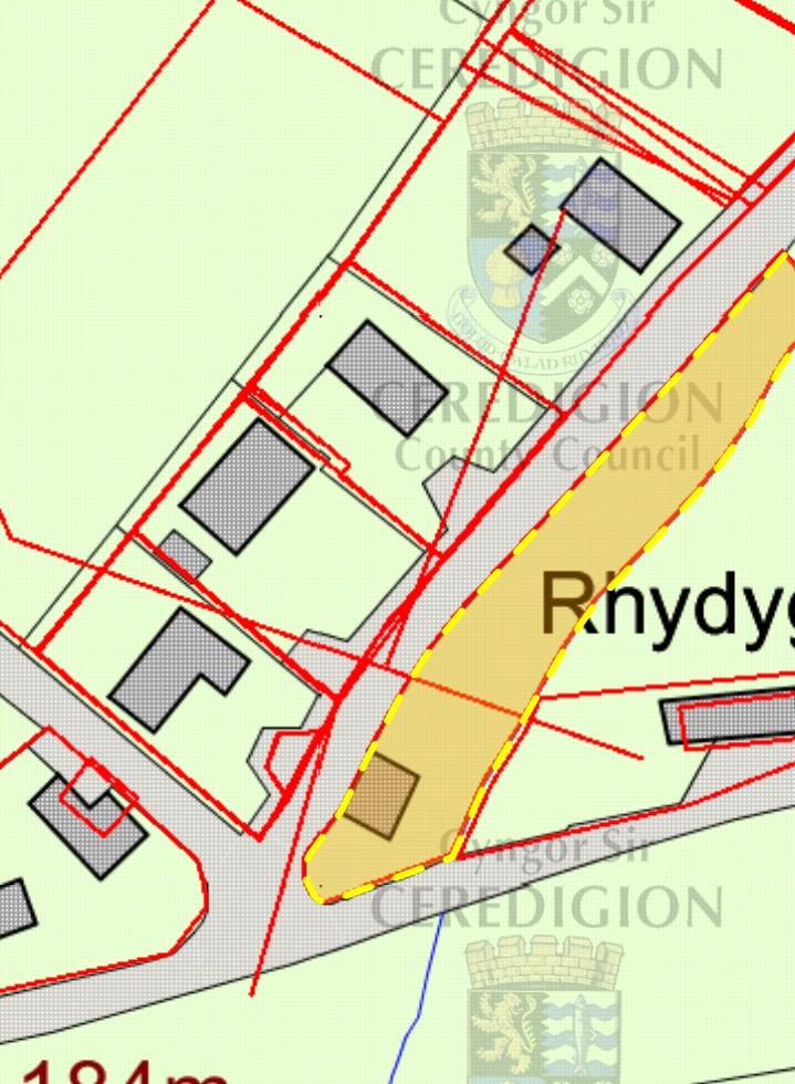

zoothorn Posted March 22, 2019 Author Posted March 22, 2019 Hi Newhome, I do have such a plan, but its looklike its from 1970's.. tiny pea-sized property on expanse of an A4 page: utterly hopeless. I have spoken to building control chap last year, who suggested I could conceivably go the non-PP route if "4M etc".. but not sure if he was being specific looking at my plans, or a vague general point. You see what I don't want to do is from the reams of info, seems like I can do it > build it.. then for someone to say "oh no you cant do that/ has to come down".. because of some tiny small print btm of page 436 in the mass of info I've overlooked, or not understood something fully.
newhome Posted March 22, 2019 Posted March 22, 2019 It’s to do with distance to boundaries generally too so you need to do a rough sketch of where your house is on the plot and then sketch where you want the building. It you look at the satellite view of your house on Google Maps it will give you something roughly to work off.
zoothorn Posted March 23, 2019 Author Posted March 23, 2019 Now that's a good idea newhome. So somehow to get the zoomed image captured/ stored, & added here.. I'm not sure your able to do this? I am adjacent to a tiny b-road (quietest/ a lane) on the side I propose to site it, & close to the 2m mark at one corner. I have a hedge of mine between. All I want to ascertain is; is this & the 4m height maximum, the only considerations: if my corner point I set at 2.25m away from road edge here.. can I just crack on & build it up to 4m high, or are there a multitude of other things I have to consider/ rules & regs too? Maybe I should I be asking this prior Q to the build, in another section of the forum.
zoothorn Posted March 23, 2019 Author Posted March 23, 2019 13 hours ago, newhome said: It’s to do with distance to boundaries generally too so you need to do a rough sketch of where your house is on the plot and then sketch where you want the building. It you look at the satellite view of your house on Google Maps it will give you something roughly to work off. I can't get close enough in to make use of google maps image, its the same "pea-sized on A4" scale as the poor land registry plan. If I zoom in one touch more it goes into 3D with a vague idea only of my property this side.
PeterW Posted March 23, 2019 Posted March 23, 2019 @zoothorn Ok the 4m is a Building Regs limit, not a planning one. Also a max of 30sqm for not requiring building regs either. PM me your post code and house name / number and I’ll try and pull the proper map for you to outline the property and areas you could put something in.
zoothorn Posted March 23, 2019 Author Posted March 23, 2019 13 hours ago, newhome said: It’s to do with distance to boundaries generally too so you need to do a rough sketch of where your house is on the plot and then sketch where you want the building. It you look at the satellite view of your house on Google Maps it will give you something roughly to work off. 6 minutes ago, PeterW said: @zoothorn Ok the 4m is a Building Regs limit, not a planning one. Also a max of 30sqm for not requiring building regs either. PM me your post code and house name / number and I’ll try and pull the proper map for you to outline the property and areas you could put something in. Hi PeterW, that's good of you- will PM now.. zoot
