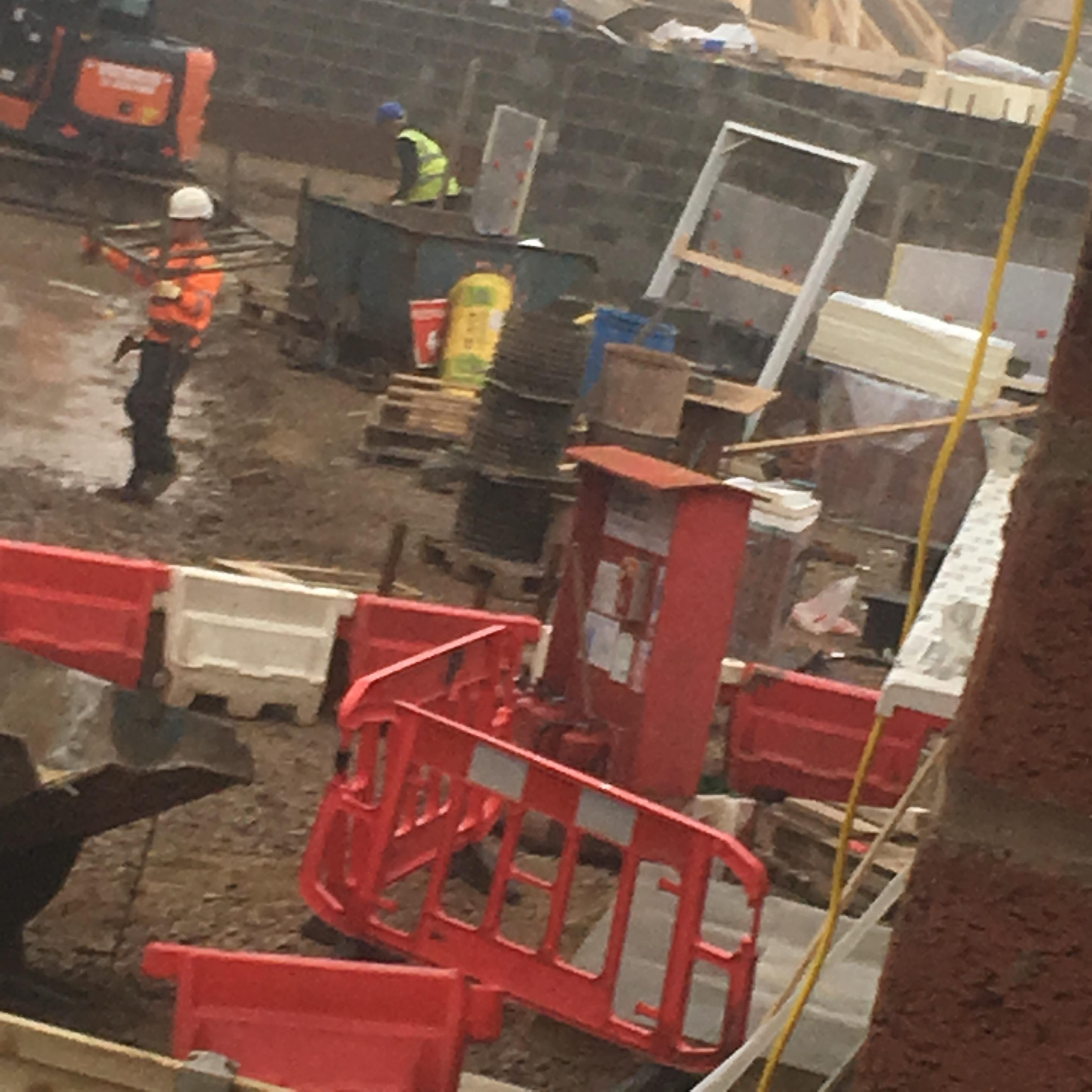

Hastings Posted March 20, 2019 Posted March 20, 2019 (edited) I have just seen an extension under construction where the celotex is being fitted with no taping of the joints. It is being installed against the inner one of two 4" concrete block walls, just like you would fit glass wool bats - each sheet resting on or against the next at the edges, allowing draughts through. Surely a mistake? Edited March 20, 2019 by Hastings
Declan52 Posted March 20, 2019 Posted March 20, 2019 They have a tongue and groove so if installed correctly then you don't need tape. But it all comes down to how they are put in. Put it in wrong and even tape won't solve the heat loss.
Miek Posted March 20, 2019 Posted March 20, 2019 More important (IMO) is to make sure there are no snots or imperfections between the PIR and the block work creating a void which would allow convective heat loss up through the wall to the roof. The boards need to be tight on to the blocks which is where mineral wool batts have an advantage as they have some give.

ADLIan Posted March 21, 2019 Posted March 21, 2019 Seen it done but it not in most MIs or BBA cert instructions. Plus a foil tape on the external face creates a localised VCL on the COLD side of the insulation which can lead to condensation.
MarkyP Posted March 21, 2019 Posted March 21, 2019 I saw a new build estate locally under construction with PIR cavity walls and stopped for a look, the insulation was ill fitted, gaps everywhere. I think its a case of out of sight, out of mind on such builds. But the thermal bypass must be tremendous. This insulation will be coupled with aerated block work to the inner leaf which will crack behind the dot and dabbed plasterboard = a nice steady breeze blowing through the plugs and under the skirting from the outside. Far, far better to go fully filled with a decent thickness of mineral wool. Makes it harder to leave gaps. We had some rubbish, really sloppy brickies on our blockwork extension but I'd gone for a wide fully filled cavity on the extension, even these were able to keep the insulation batts tightly fitted without too much mental strain, albeit with me checking it constantly.

MarkyP Posted March 21, 2019 Posted March 21, 2019 PIR boards have been shown in studies to lose their thermal properties due to loss of the pentane gas over time, becoming worse than the best mineral wool (lambda in the region of 0.032). Also the required void in a partially filled PIR cavity acts as chimney and /convection and air movement space, fully filled removes this problem and will make the wall far more wind tight. Also lots of discussion and reports over the years that foam boards are not brilliantly dimensionally stable, they can shrink and bow with ageing (a reason most system suppliers dropped foam boards as an option for EWI).
Temp Posted March 21, 2019 Posted March 21, 2019 45 minutes ago, MarkyP said: PIR boards have been shown in studies to lose their thermal properties due to loss of the pentane gas over time, becoming worse than the best mineral wool (lambda in the region of 0.032). My understanding is that the lambda quoted for CE marked PIR (eg that complies with Harmonised European Standard BS/EN 13165) is the average value predicted over 25 years. In addition the degradation mostly happens over the first 8 years and then slows. So for most of the 25 years it will be close to the quoted figure. 1

Hastings Posted March 21, 2019 Author Posted March 21, 2019 (edited) On 20/03/2019 at 21:04, Declan52 said: They have a tongue and groove so if installed correctly then you don't need tape. But it all comes down to how they are put in. Put it in wrong and even tape won't solve the heat loss. I just looked again at the site and the PIR sheets are not t&g edge, just standard edges. Would building control approve such a poor design? Edit: Just heard from the architect that it was specified because it's easier to install than the T&G version (due to the cavity ties) and BC approved it, therefore no problem. There is no hope for humanity. Edited March 22, 2019 by Hastings
