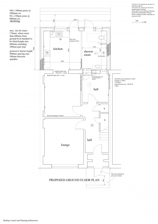

Re: Penultimate plan attached
(The final plan is not accessible at the moment but there were only two minor changes to the attached plan)

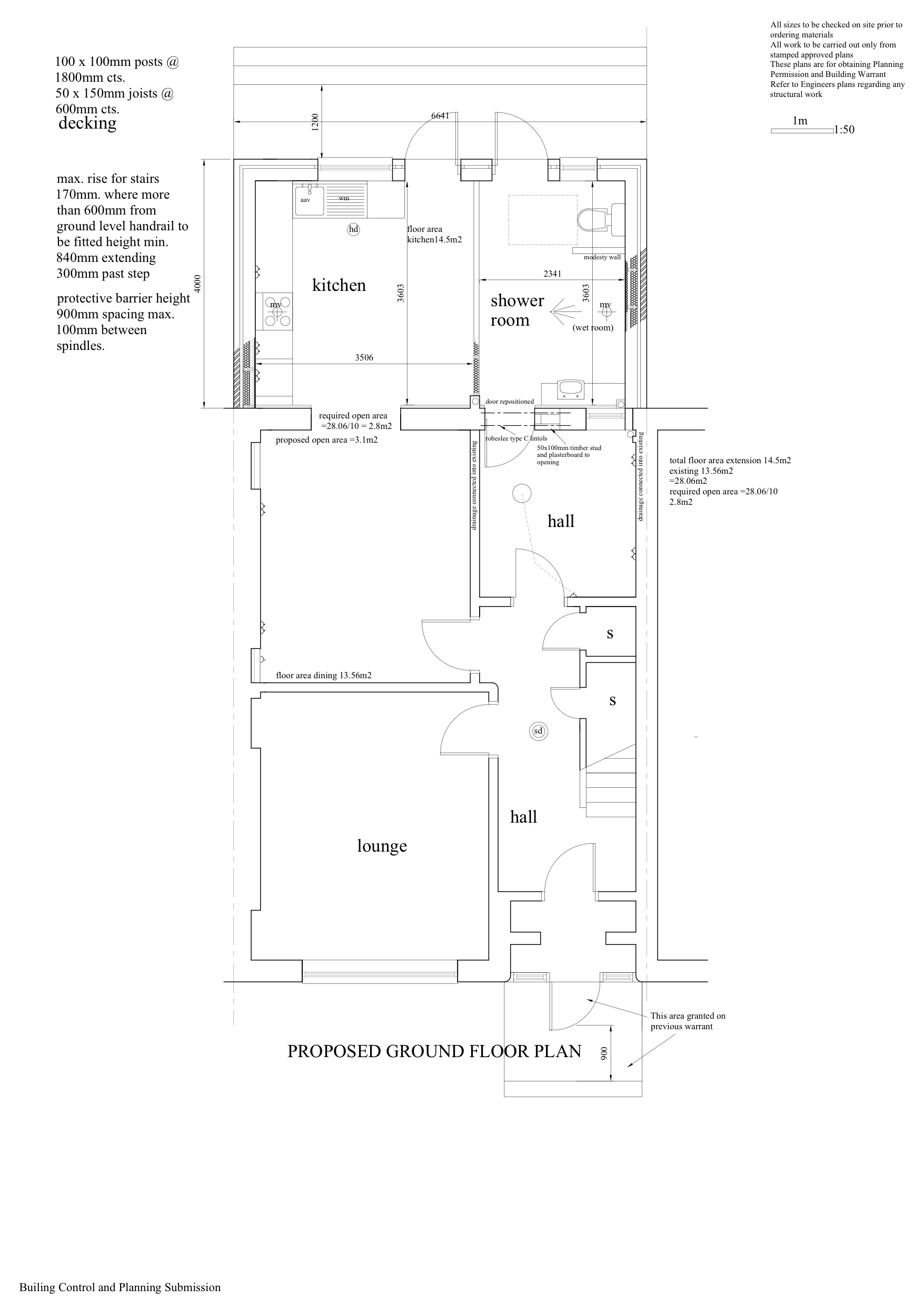

The budget is limited so the priority is making the house wheelchair user friendly by installing a ground floor WC and shower. The extra door provides a straight run through from the front door to the back of the house for the wheelchair.
Advocado = avocado a popular colour in the 70’s for bathroom and kitchen fittings
Plan_4hub.pdf
Back of house plan.pdf

Not sure how to add the plan correctly.  I uploaded it and it is now sitting on this website as a download
Save plan as any common picture format e.g. .jpg and go to 'choose files' at bottom of 'write post' window and it should be automatic.
This is the floor plan
