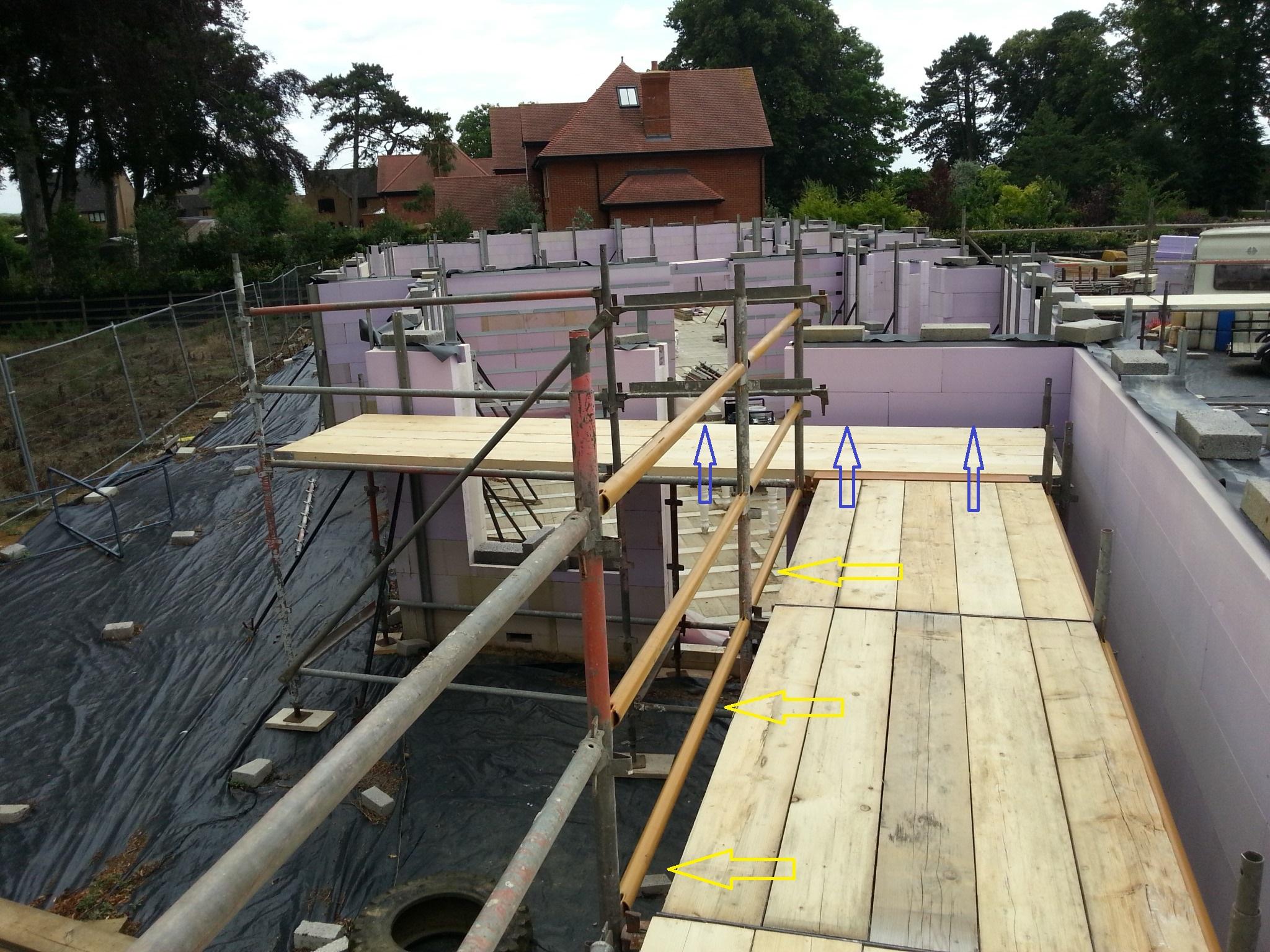

Vijay Posted July 12, 2019 Author Share Posted July 12, 2019 Got 18 bays up this week and just wondered about the 7cm gap left on the boards. Am I right in saying that's there for fitting a board as a toe board, or would the toe board normally sit on top of the floor? Link to comment Share on other sites More sharing options...
Russell griffiths Posted July 12, 2019 Share Posted July 12, 2019 Toe board sits on top. I think. I bet you don’t need to go to the gym tonight. Heavy isn’t it. Link to comment Share on other sites More sharing options...
Declan52 Posted July 12, 2019 Share Posted July 12, 2019 23 minutes ago, Vijay said: Got 18 bays up this week and just wondered about the 7cm gap left on the boards. Am I right in saying that's there for fitting a board as a toe board, or would the toe board normally sit on top of the floor? Not sure what you mean, can you put up a pic. Link to comment Share on other sites More sharing options...

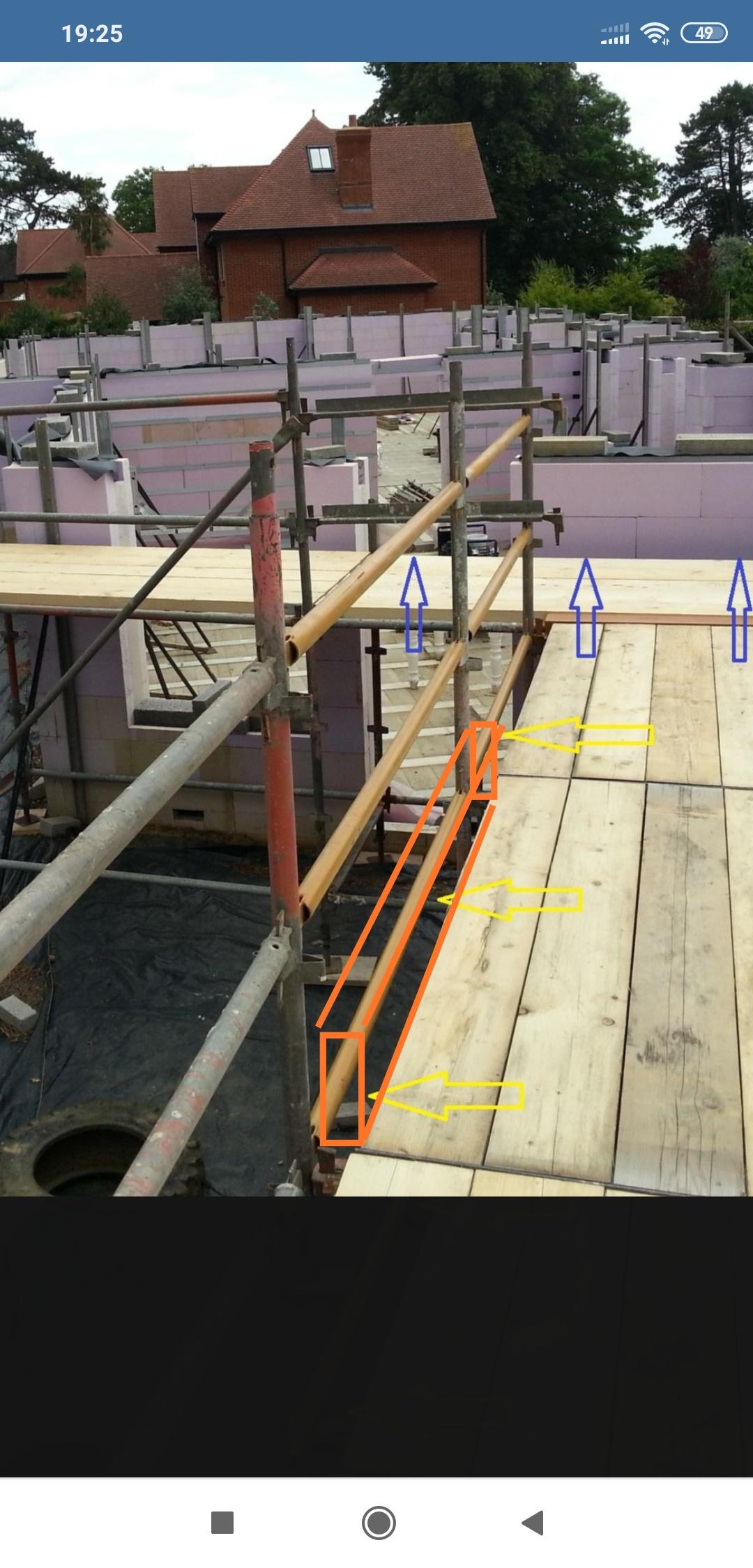

Vijay Posted July 12, 2019 Author Share Posted July 12, 2019 (edited) 1 hour ago, Russell griffiths said: Toe board sits on top. I think. I bet you don’t need to go to the gym tonight. Heavy isn’t it. lol ok ok, you were right Starts off ok but lifting boards up onto the transoms gets to you after a while lol I'm still happy I've decided to go with Kwikstage though 45 minutes ago, Declan52 said: Not sure what you mean, can you put up a pic. The gap with the yellow arrows. It shows it on the outside there but the problem is with the boards that run parallel with the return transom. The gap that is yellow arrowed, is where the blue arrows are. I wish I had a clearer pic Edited July 12, 2019 by Vijay Link to comment Share on other sites More sharing options...
Declan52 Posted July 12, 2019 Share Posted July 12, 2019 Put a plank on its edge. This will stop anything from dropping over the edge. Link to comment Share on other sites More sharing options...
Vijay Posted July 12, 2019 Author Share Posted July 12, 2019 so the gap is meant for a toe board/full plank? may have to get a few more boards then Link to comment Share on other sites More sharing options...
Declan52 Posted July 12, 2019 Share Posted July 12, 2019 Yep. The bars are to stop you going over the edge. The end plank for hammers and bricks falling on people's heads. Link to comment Share on other sites More sharing options...
Vijay Posted July 12, 2019 Author Share Posted July 12, 2019 expensive way of doing toe boards though isn't it, using full thickness boards Link to comment Share on other sites More sharing options...
PeterW Posted July 12, 2019 Share Posted July 12, 2019 4 minutes ago, Vijay said: expensive way of doing toe boards though isn't it, using full thickness boards No it’s the right way ..! Got the clips ..?? Link to comment Share on other sites More sharing options...
Vijay Posted July 12, 2019 Author Share Posted July 12, 2019 60mm boards for toe boards is surely overkill?? I'd have thought being able to use normal scaffold boards would have been perfectly adequate and cheaper? No I haven't got any clips as I don't have toe boards and I already blew the scaffold budget lol Link to comment Share on other sites More sharing options...
Declan52 Posted July 12, 2019 Share Posted July 12, 2019 28 minutes ago, Vijay said: 60mm boards for toe boards is surely overkill?? I'd have thought being able to use normal scaffold boards would have been perfectly adequate and cheaper? No I haven't got any clips as I don't have toe boards and I already blew the scaffold budget lol It's just how it's done. Link to comment Share on other sites More sharing options...

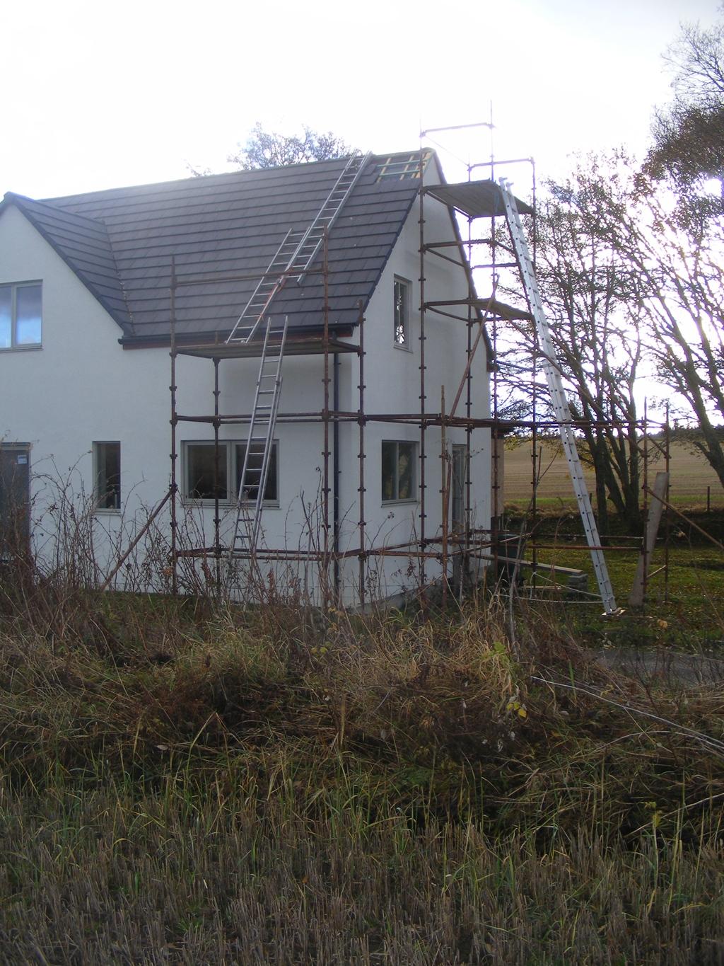

jfb Posted September 12, 2019 Share Posted September 12, 2019 This thread has been very useful for me to get my head round kwikstage scaffolding so thanks for the collective Buildhub knowledge! I have a few things I'm not clear on. I am planning on getting 2 x 32' bays for each side of the barn I am renovating and some normal scaffolding for one end that is a bit more complicated. The other end already has a flat roof I can use. It will all be used for other projects so I want to have a bit of flexibility. 1. ladder - if my main lift is 3.5m high would I be right in thinking I need a 5m ladder? 2. ladder access - would a typical way of setting up the ladder be something like this.?.....https://www.alamy.com/stock-photo-scaffolding-and-a-ladder-access-safety-gate-on-a-building-site-59693078.html I spoke to scaffolding direct and they were talking about a ladder access transom where the ladder comes from the inside and I guess a ladder hatch as well. While I guess that would be safer it seems to get in the way a bit. 3. if I was using a ladder access gate as in the above link what do you do with the ledgers that would normally span the whole bay? Do you fix the gate to the corner standard and then use round scaffolding to fill in? 4. if in the future I wanted to use the kwikstage for a 90 degree return how many return transoms would I need? 5. any kwikstage bits not included in a normal bay package that might prove very useful in the future? toe board bracket (not needed for the barn as virtually no soffit)? extra braces for the ends if it is hard to fix to the existing structure? thanks for any advice. Link to comment Share on other sites More sharing options...
ProDave Posted September 12, 2019 Share Posted September 12, 2019 Don't take this as a "how to" rather a "what I did" Here you see my longer ladder right up to the top platform . Re extra bracing. I used some spare diagonal braces to add extra bracing to the corners with the bottoms staked to the ground. Note also the "bracing tower" projecting to the right in the middle of this span. Link to comment Share on other sites More sharing options...
Vijay Posted September 12, 2019 Author Share Posted September 12, 2019 Firstly, if you need a brilliant supplier, I bought a load from these guys https://www.scaffoldingsupplies.co.uk/ and dealt with Rob, who was an absolute pleasure to deal with. I'm a complete newbie with Kwikstage but thanks to the guys on here, got the first floor of my scaffold up without too much issue. So here's my thoughts: 1. It would make sense to me to have a slightly longer ladder so you have rungs to hold while stepping on/off. 2. That's how I thought of doing it and how I've seen normal scaffold/ladders. I personally am going for stairs and and access transom when I go higher. 3. What I planned to do was to use normal scaffold to create the vertical that the gate would attach to, then use another scaffold pole to create the handrail that attaches to the vertical pole. 4. As per the advice I got on this post, I used a return transom on each level when turning 90 degrees. My build is Northampton if you ever want a visit. IIRC a couple of people gave the offer and great advice to see some in the flesh. I didn't go to anyones site but it would have been very useful to see exactly how it goes up. And for what it's worth, although it was work getting the scaffold up in the heat we had, I'm really happy I went down the Kwikstage route 1 Link to comment Share on other sites More sharing options...
Simplysimon Posted September 12, 2019 Share Posted September 12, 2019 4 hours ago, ProDave said: Don't take this as a "how to" rather a "what I did" Here you see my longer ladder right up to the top platform . Re extra bracing. I used some spare diagonal braces to add extra bracing to the corners with the bottoms staked to the ground. Note also the "bracing tower" projecting to the right in the middle of this span. ladder should be 1m above stepping off point and tied in. it's not the stepping off which is difficult with nothing to hold onto, it's the going back down. Link to comment Share on other sites More sharing options...
ProDave Posted September 12, 2019 Share Posted September 12, 2019 1 minute ago, Simplysimon said: ladder should be 1m above stepping off point and tied in. it's not the stepping off which is difficult with nothing to hold onto, it's the going back down. I did say that was not "how to do it" It WAS tied. Link to comment Share on other sites More sharing options...
