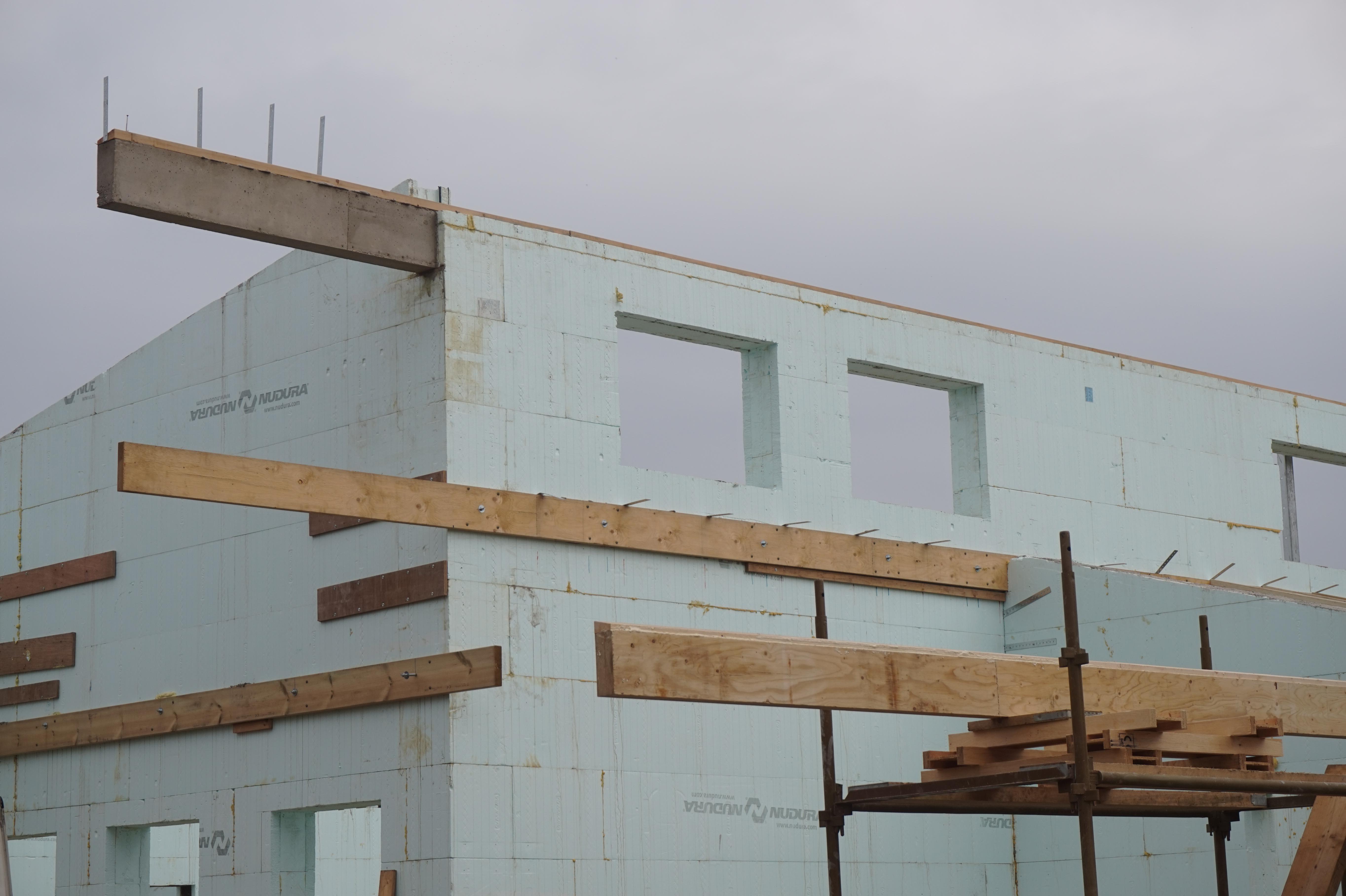

Russell griffiths Posted March 10, 2019 Share Posted March 10, 2019 would it be easier to face fit the pole plate, instead of replacing the actual icf the pic is for a roof but would be very similar except for more bolts and different spacing for a floor. If you remove the icf and replace with timber, do you not loose an insulation layer. @Vijay Link to comment Share on other sites More sharing options...

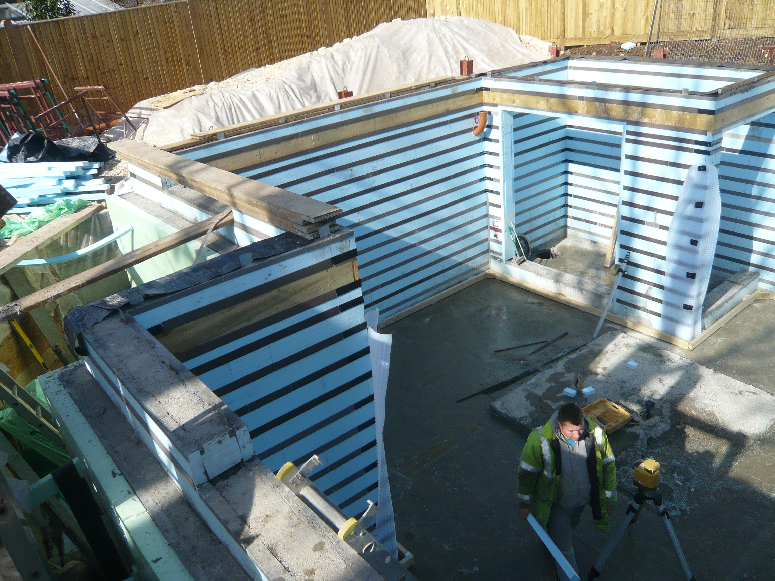

Vijay Posted March 10, 2019 Author Share Posted March 10, 2019 My inner leaf of ICF is 100mm, so I would need to get a good fixing through the timer plate, through the 100mm polystyrene and then into the concrete. My worry is the polystyrene could let the fixing bend downwards with weight. I did mention losing the insulation to polarwall, but I intend to fit insulation back into between the joists (against the timber plate), so I'll only really be losing insulation where the joists sit against the timber plate Link to comment Share on other sites More sharing options...
Mr Punter Posted March 10, 2019 Share Posted March 10, 2019 Ours was less than 100mm insulation - it may have been 50mm. Below ground we stuck an extra 100mm on the outside and we only did ICF for the basement with the rest in timber frame. Here it is with the timber plate. It worked well with this brand of ICF as it fitted into the profiles just like the polystyrene. Link to comment Share on other sites More sharing options...
Vijay Posted March 10, 2019 Author Share Posted March 10, 2019 A picture speaks a 1000 words That's exactly what I was trying to explain. Yes that's 50mm boards as it's the same as the rails I'm so jealous of basements Link to comment Share on other sites More sharing options...
Russell griffiths Posted March 10, 2019 Share Posted March 10, 2019 @Vijay all Icf are different obviously, but on a few of the makes I looked at that was not how it was done. I will try and find a vid after dinner to show you what I did. Worked a treat. Link to comment Share on other sites More sharing options...
Russell griffiths Posted March 10, 2019 Share Posted March 10, 2019 that polar wall method looks spot on with your system but if you fancy the rim board sitting on the face of the wall, look at the vid. This is what I did and it was straight forward. Link to comment Share on other sites More sharing options...
