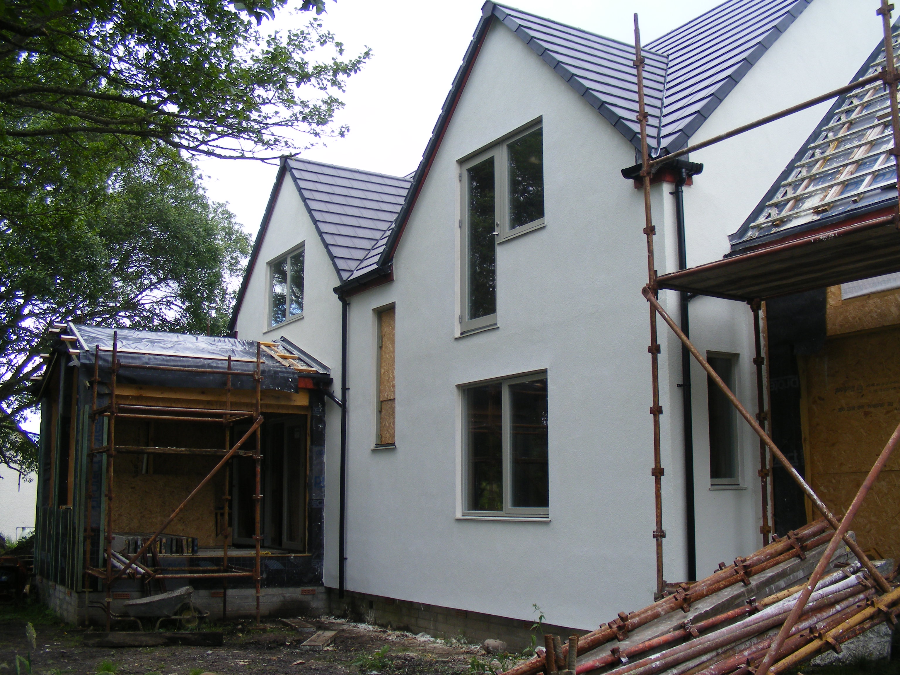

ProDave Posted March 1, 2019 Posted March 1, 2019 I think as mentioned it will be hard / impossible to satisfy building regs means of escape, it certainly would be in Scotland. Our house is 1 1/2 storey and I "enlarged" the upstairs space by adding "gable ends" A sort of variation on a dormer that is more common on the West Coast. Here are a couple of pictures It does not add anything to the overall height, but it gives a LOT more usable headroom and ensures all bedrooms have a proper window on an upright wall with only the en-suite having a roof window as it's only window. I have to ask though, as you are clearly working with a restricted ridge height, why waste height by having a 2.5M height downstairs when the standard 2.4 would be fine? 1

Moggaman Posted March 2, 2019 Author Posted March 2, 2019 On 01/03/2019 at 08:47, ProDave said: I think as mentioned it will be hard / impossible to satisfy building regs means of escape, it certainly would be in Scotland. Our house is 1 1/2 storey and I "enlarged" the upstairs space by adding "gable ends" A sort of variation on a dormer that is more common on the West Coast. Here are a couple of pictures It does not add anything to the overall height, but it gives a LOT more usable headroom and ensures all bedrooms have a proper window on an upright wall with only the en-suite having a roof window as it's only window. I have to ask though, as you are clearly working with a restricted ridge height, why waste height by having a 2.5M height downstairs when the standard 2.4 would be fine? I have changed downstairs to 2.4m ...good point
