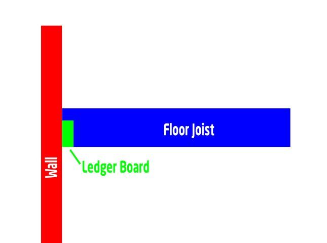

Pigsfoot Posted April 5, 2019 Author Share Posted April 5, 2019 Hi all, sorry to resurrect an old post. I seem to be having an issue with getting the ledger board size out of anyone. The floor designer keeps saying hes waiting for someone to get back to him and my architect won't commit so i guess I'm going to have to find a structural engineer to help. Just out of interest has anyone had a similar ledger plate put in, my joists are 254mm deep and 5.9 mtr long ( easy joists ). They will be supporting a std floor however there will be a en-suite which will have a bath in. One side to be supported by the ledger board, the other on a cavity wall. Any suggestions on wall fixings too, its been suggested to use 12mm threaded rod glued into place using resin at 400mm centers. Thanks Link to comment Share on other sites More sharing options...

Pigsfoot Posted April 5, 2019 Author Share Posted April 5, 2019 thanks @PeterW, much appreciated so a zig zag type of layout for the studs. Any suggestions on the size of the ledger board i read on another forum that someone used 200 x 75mm which to be fair sounds like a monster but i imagine woudl do the job ? Link to comment Share on other sites More sharing options...

Russell griffiths Posted April 5, 2019 Share Posted April 5, 2019 Your ledger board should be the same depth as your joists, your hangers and joists must have full surface contact, you can’t have a 200mm ledger and a 245 joist as the bottom will hang lower and not provide support as the joist deflects. Link to comment Share on other sites More sharing options...
Pigsfoot Posted April 5, 2019 Author Share Posted April 5, 2019 Thanks Russell, i believe the top chord is 54mm deep so I will have 200mm left to play with hence why i think is the ledger board should be 200mm long as it will then sit flush with the bottom of the joist and provide surface contact all the way down the joist as you have mentioned. I have put together a simple drawing to try and explain what i mean. If the top chord turns out not to be quite 54mm i will adjust the ledge board width to accommodate. Link to comment Share on other sites More sharing options...
Mr Punter Posted April 5, 2019 Share Posted April 5, 2019 You will need solid blocking at each end between the joists to stop them twisting. Get the floor designer to spec how these are fixed. Link to comment Share on other sites More sharing options...
PeterW Posted April 5, 2019 Share Posted April 5, 2019 @Pigsfoot the flooring designer will tell you the minimum end bearing which will in turn tell you the minimum thickness of ledger board. Link to comment Share on other sites More sharing options...
