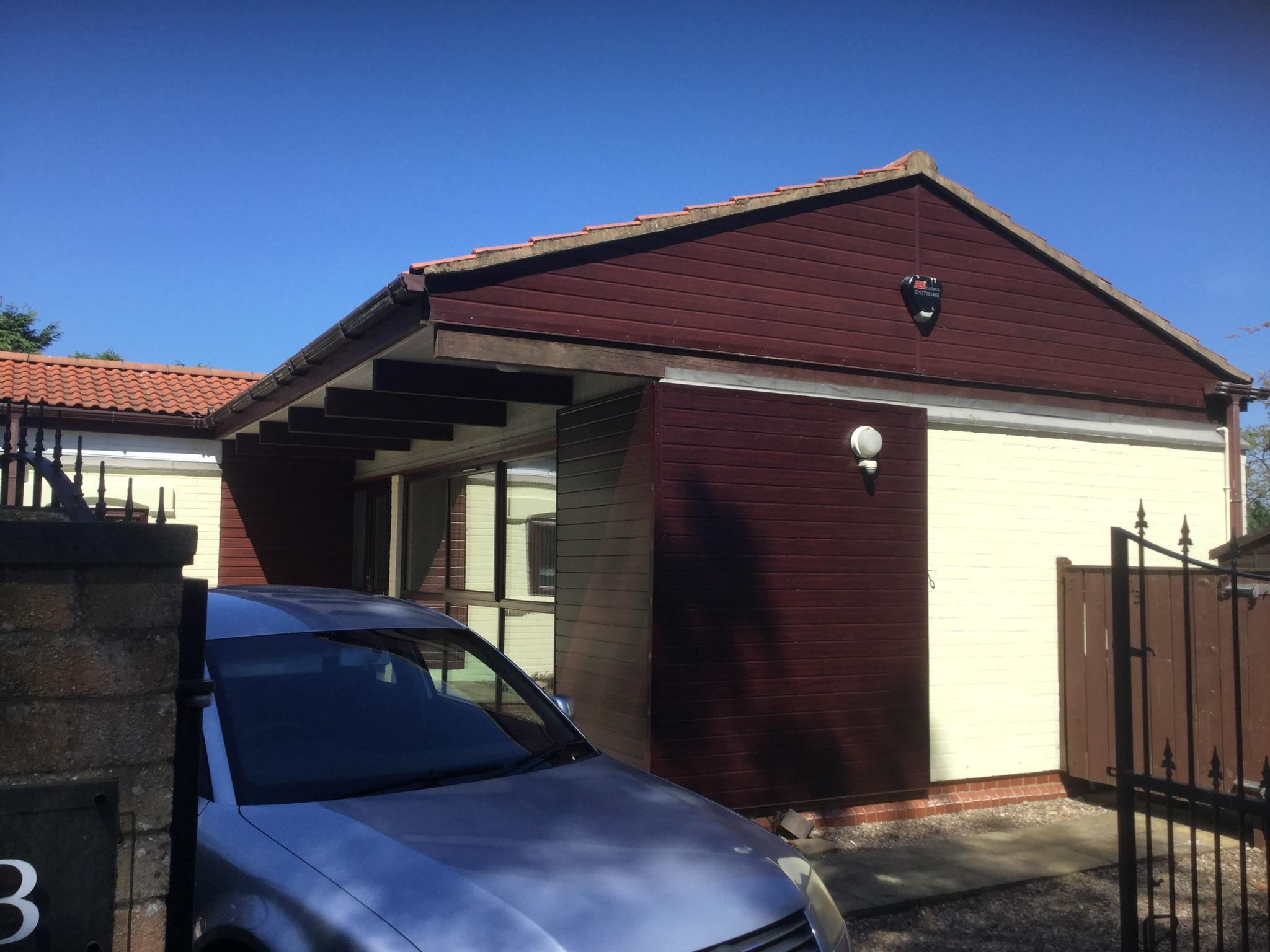

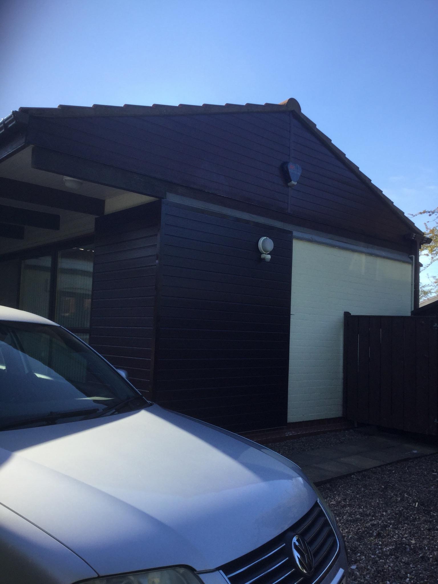

Ferdinand Posted February 25, 2020 Posted February 25, 2020 (edited) On 25/02/2019 at 15:57, eandg said: We are at the design stage and considering having our first floor cantilever out 0.5-1m beyond our ground floor (mostly due to the space/use we want but also to provide shading to downstairs living space). Is this possible with timber frame and will it be particularly expensive? You need to check how far it needs to project wrt the angle of the sun in your location at the time of year of interest. I have one with I think an approx 1m projection at a height of maybe 2.6-2.7m, and it is not quite enough for all occasions, but it was done in 1970 so I forgive them not doing it online in the sun simulator. This photo shows the sun angle at one point. The overhang faces due south. Check what you need, or at least what you will get for x mm cantilever at y height. 0.5m is unlikely to be enough, and I would be guestimating 1-1.5m may be necessary. Edited February 25, 2020 by Ferdinand
