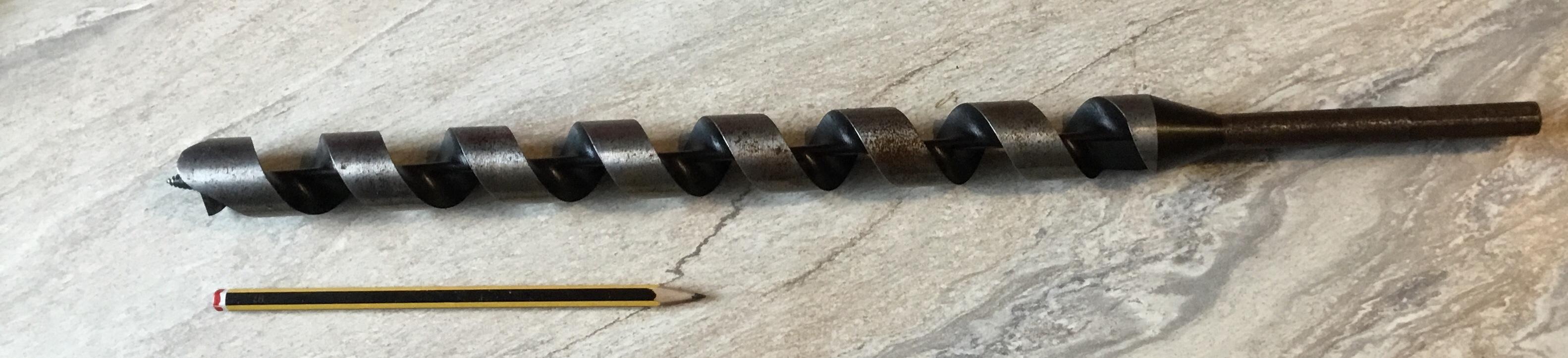

Triassic Posted February 20, 2019 Posted February 20, 2019 I’ve just started first fix plumbing, by drilling holes in the timber frame for the pipes, using my old but trusty spade bit. Three holes later and it’s blunt! I’m thinking I need something better, but what? Can anyone recommend a make of good quality wood drill bits?
dpmiller Posted February 20, 2019 Posted February 20, 2019 I got a Bosch Daredevil bit a few months back and it fair chews through wood on the impact driver. Nasty thing.
bassanclan Posted February 20, 2019 Posted February 20, 2019 This is what you want https://www.axminster.co.uk/armeg-wood-beaver-drill-bits-ax783344 (Not necessarily from Axminster, that just appeared at the top of the Google search)
scottishjohn Posted February 20, 2019 Posted February 20, 2019 (edited) 1 hour ago, Triassic said: I’ve just started first fix plumbing, by drilling holes in the timber frame for the pipes, using my . Three holes later and it’s blunt! I’m thinking I need something better, but what? Can anyone recommend a make of good quality wood drill bits? "old but trusty spade bit"--think thats says it alL have you sharpened it ever?--try that while waiting for new goodies# the type suggested are superior no question about it Edited February 20, 2019 by scottishjohn
PeterW Posted February 20, 2019 Posted February 20, 2019 Depending on the size of hole, I use either Armeg ones or a decent lip and spur drill bit. Make holes for 15mm pipe a 20mm minimum and you won't snag or score when pulling Hep2O through the joists.
Triassic Posted February 20, 2019 Author Posted February 20, 2019 1 hour ago, scottishjohn said: "old but trusty spade bit"--think thats says it alL have you sharpened it ever? Is probably been sharpened too many time, hence won’t hold an edge.
Cpd Posted February 20, 2019 Posted February 20, 2019 2 hours ago, bassanclan said: This is what you want  https://www.axminster.co.uk/armeg-wood-beaver-drill-bits-ax783344 (Not necessarily from Axminster, that just appeared at the top of the Google search) ‘I used something similar and it was great, if you hit a nail it’s not the end of the world.... whereas if you hit a nail with your big un then it’s devastating! It’s all about balance...... has this bad boy for years and years and when needed it’s just the best.
Pete Posted February 20, 2019 Posted February 20, 2019 2 hours ago, bassanclan said: This is what you want https://www.axminster.co.uk/armeg-wood-beaver-drill-bits-ax783344 (Not necessarily from Axminster, that just appeared at the top of the Google search) +1 to the above
Crofter Posted February 20, 2019 Posted February 20, 2019 Another happy Armeg Beaver customer here. I've got the one, a 12mm, but it has done a ridiculous amount of work for me. The ring beam that my house sits on is made of two layers of 75mm douglas fir, sistered up, and held together with literally hundreds of 150mm bolts. The Armeg in my impact driver drilled every one of those holes, no sweat, and continues to be my best and sharpest drill bit. In fact I think I may have just talked myself into getting a full set of them...
