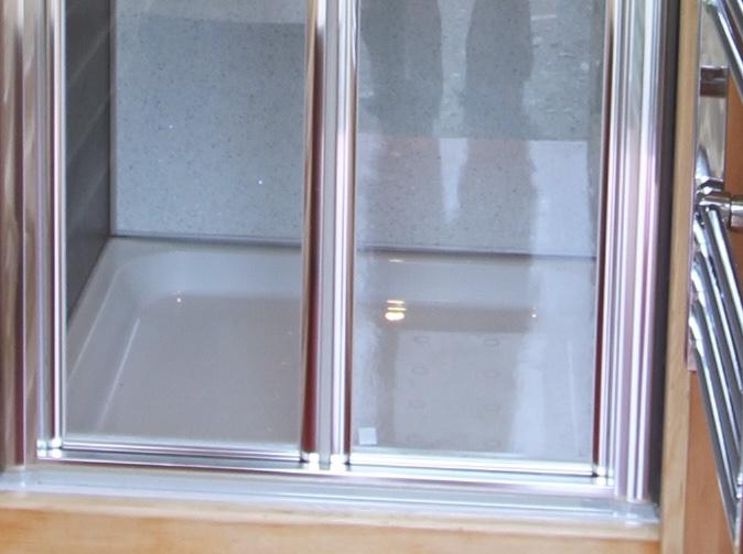

Jeremy Harris Posted February 6, 2019 Posted February 6, 2019 We've also used Multipanel boards. I first used them when refurbishing the bathroom/shower in our old house, well over 10 years ago now. We were so impressed with them that we've used them in both bathrooms in the new house. The bottom junction with the shower/bath is best done by ignoring the bloody awful trim/seal (which doesn't) that they recommend, as it works like a gutter to trap moisture at the bottom of the panel. Instead I packed the panels up above the shower with bits of 4mm to 5mm ply, then removed these packers once the panels were bonded tight to the wall. It was pretty easy to just run sealant in the gap to seal the lower edge properly. I chose to bond on (with sealant) a PVC trim at the bottom edge, just because I don't like cleaning sealant that goes mouldy. This covers up all the sealant and gives a wipe-clean surface, just like the panels themselves. 1

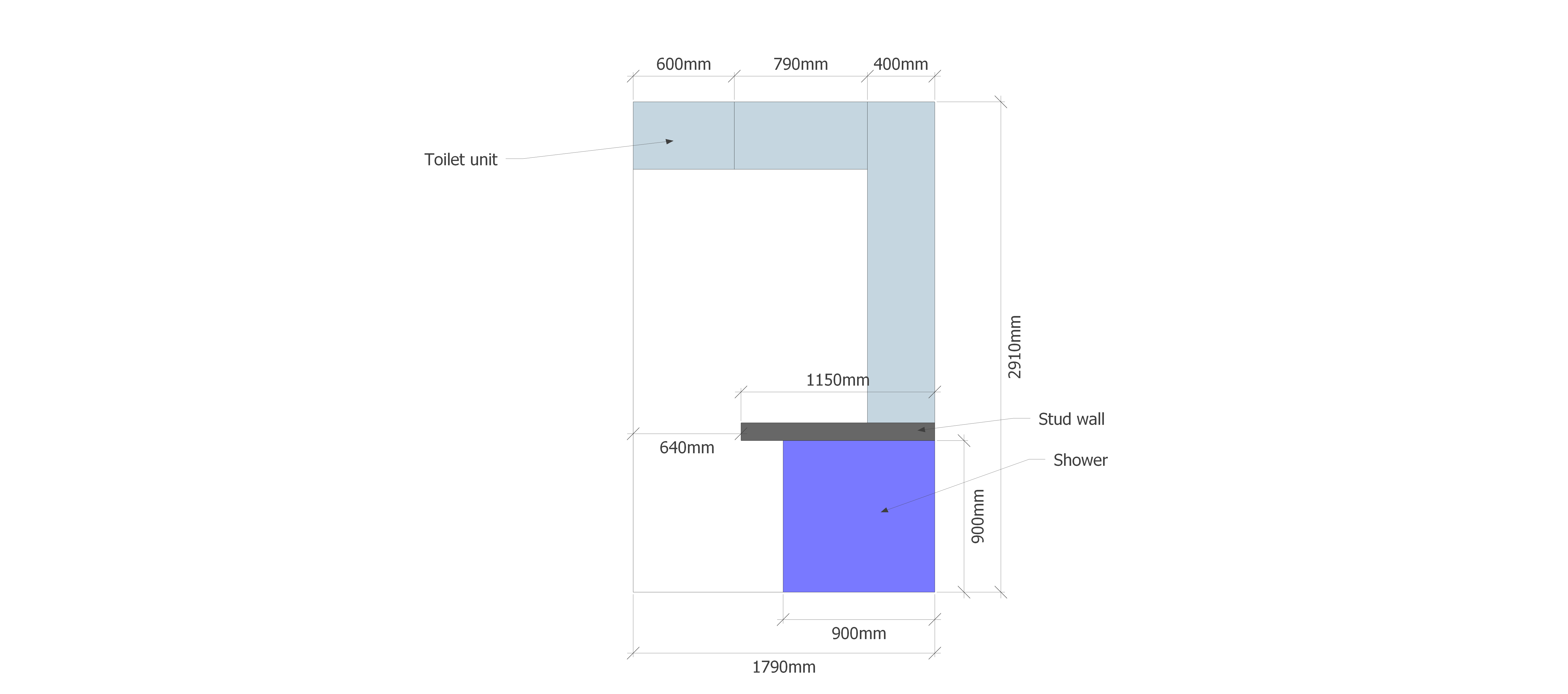

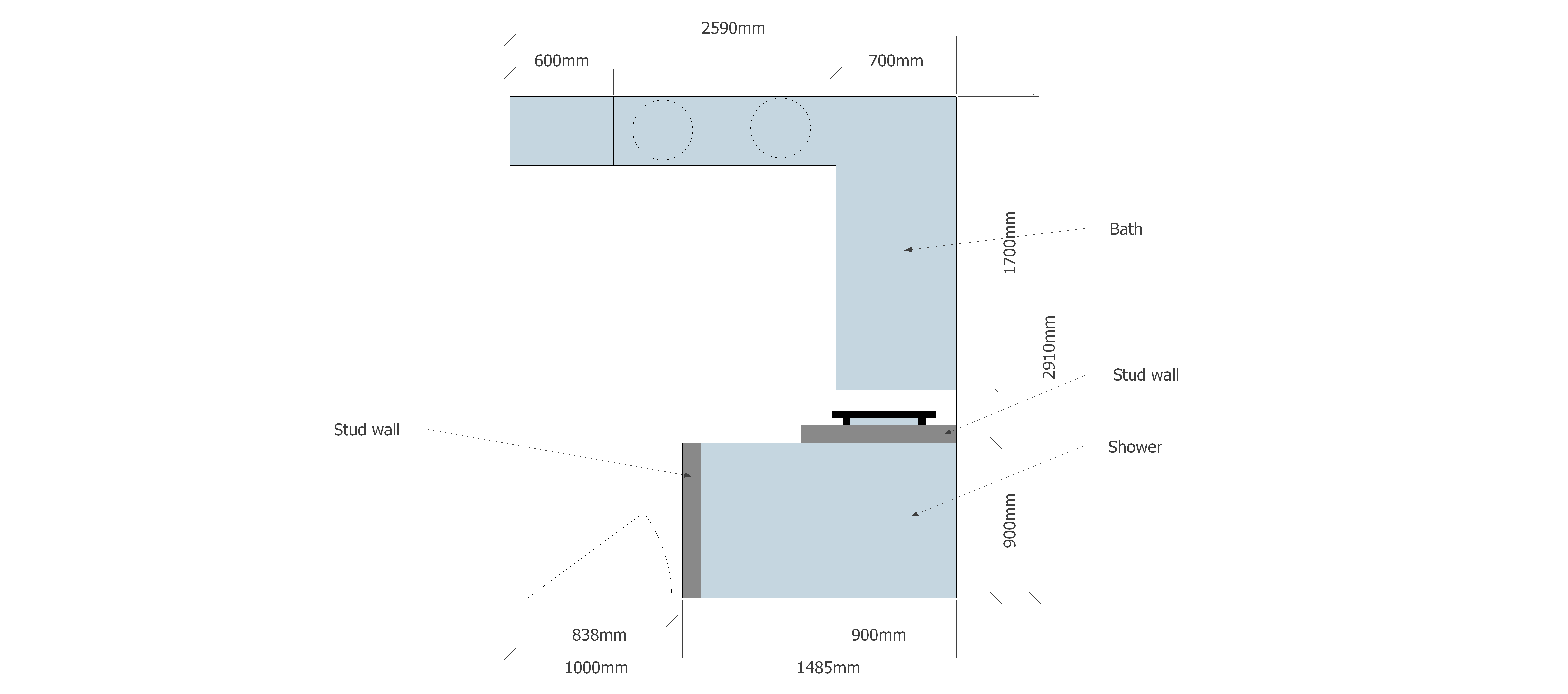

Nelliekins Posted February 6, 2019 Author Posted February 6, 2019 Thanks for all the tips so far. Time to dig a little deeper! Here are the room layouts... Main bathroom first: If I had the danglies for it, I'd have followed @Onoff's fantastic bathroom build... but time and money constraints mean this will be a "for now" job, rather than a "forever" job. The 600mm unit top-left is the toilet cistern cupboard, then 2 sinks (our girls fight over the single sink in the main bathroom here -this is my attempt to alleviate stress in the mornings!). I'm tempted to build out the wall between the bath and shower, and build in storage for shampoo etc, and also an access panel for the shower controls / mixer. That would push the towel rail up above the end of the bath, which isn't really a problem. The en-suite is similar, albeit no bath and it is serviced by a pocket door in the middle of the left-hand wall: (Kim and I don't fight over sinks, but we'll still probably put 2 in - they're going in/on the long cupboard run "above" the shower area.) I would like the shower area to span the full 1790mm (yes - it should have been 1800mm, but I put the pocket door wall in the wrong place because I hadn't allowed for the MR plasterboard - the perils of trying to do too many jobs at the same time!). But SWMBO is "suggesting" (read "demanding upon pain of death") that we have some special former that works well with microcement and only comes in a few sizes... ? The fact that we will be sunken in should allow us to not have to worry about any fall on the rest of the floor - it makes the shower area fully contained at floor level. It's just how best to make sure we don't get leaks, and we don't get mould. Oh, and on the mould front... I've been assuming that it is exacerbated by having the shower area closed off and getting standing water. The stud walls that close off the shower area are going to be stopped at 2m high, so that air will circulate above them (and hopefully the MVHR extract vents being above the shower areas will help). Anything else I can do (as part of the construction) to prevent the mould from appearing in the first place? 1
Mr Punter Posted February 6, 2019 Posted February 6, 2019 22 minutes ago, Nelliekins said: I would like the shower area to span the full 1790mm (yes - it should have been 1800mm Why not just cut out a bit of plasterboard at the bottom?
Mr Punter Posted February 6, 2019 Posted February 6, 2019 You may find the stud walls make the room seem a bit smaller. We have frameless glass shower screens which make the most of the space. Also a large mirror is good and useful. Where are the actual WCs? Did you look at wall hung WCs and vanity units? Again, because more floor is visible the room appears larger.

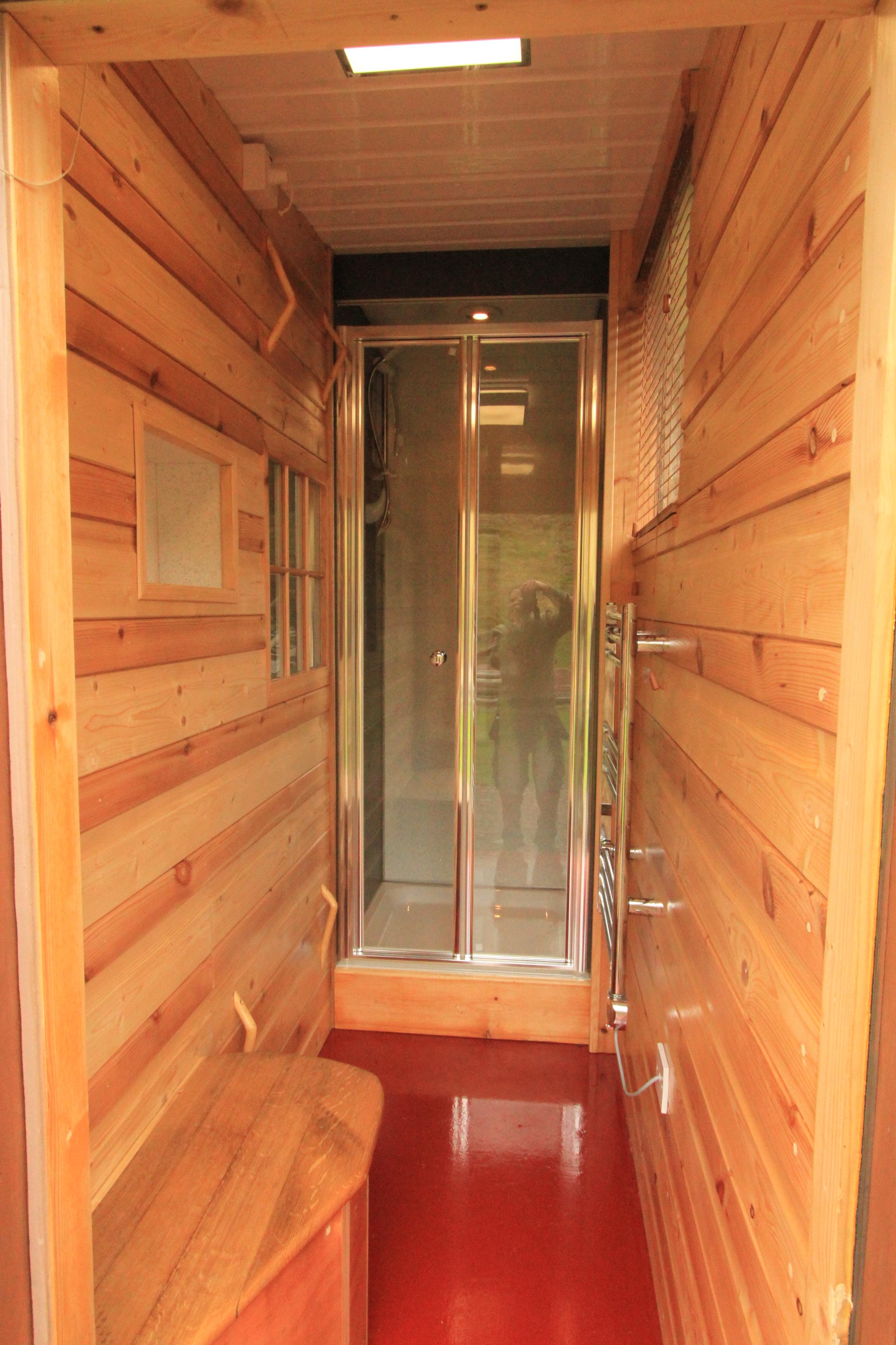

Cpd Posted February 6, 2019 Posted February 6, 2019 7 hours ago, JSHarris said: The bottom junction with the shower/bath is best done by ignoring the bloody awful trim/seal (which doesn't) that they recommend, as it works like a gutter to trap moisture at the bottom of the panel. I understand this concern but went around it a slightly different way as I wanted to avoid any silicone on show.. I used the trim but I covered every internal surface with clear CT1 and then compressed the board down into the trim, there is just no way water is getting in ! I then used a shower tray with upstands and the wall board came down over these upstands with a gap at the bottom. It was fully bonded to the wall behind including tanking the lower section like @ProDave did. It works very well and no problem so far (2 years) The only improvement I would make would be to have made the gap / drip line at the bottom very slightly bigger for ease of cleaning, say 10mm as I only left about 5mm and it’s a faff to clean. This is in my cabin and used by geusts who all like my quirky shower room! Not main stream but just another option on the use of trims. Not a great photo of the detail but just one I had to hand. 1

Nelliekins Posted February 7, 2019 Author Posted February 7, 2019 13 hours ago, Mr Punter said: Why not just cut out a bit of plasterboard at the bottom? Because then there's nothing to seal any tray against... That seems to be a bad idea, given everybody here appears to tank and then seal trays / formers against a tanked wall!
Jeremy Harris Posted February 7, 2019 Posted February 7, 2019 I had to cut a slot in the plasterboard to fit our shower tray, as I made a slight misjudgement when setting the finished room width at 2m, the same width as the tray. It wasn't a problem, as I just fitted a bit of thin ply in the slot and then tanked the floor and up over the ply, then up the rest of the wall behind the wall boards. Once fitted, the gap around the tray and the wall was filled with Sikaflex, then the wall boards were fitted, with more sealant along the join with the top of the tray.
Mr Punter Posted February 7, 2019 Posted February 7, 2019 I would just unscrew the bottom board and trim it.
