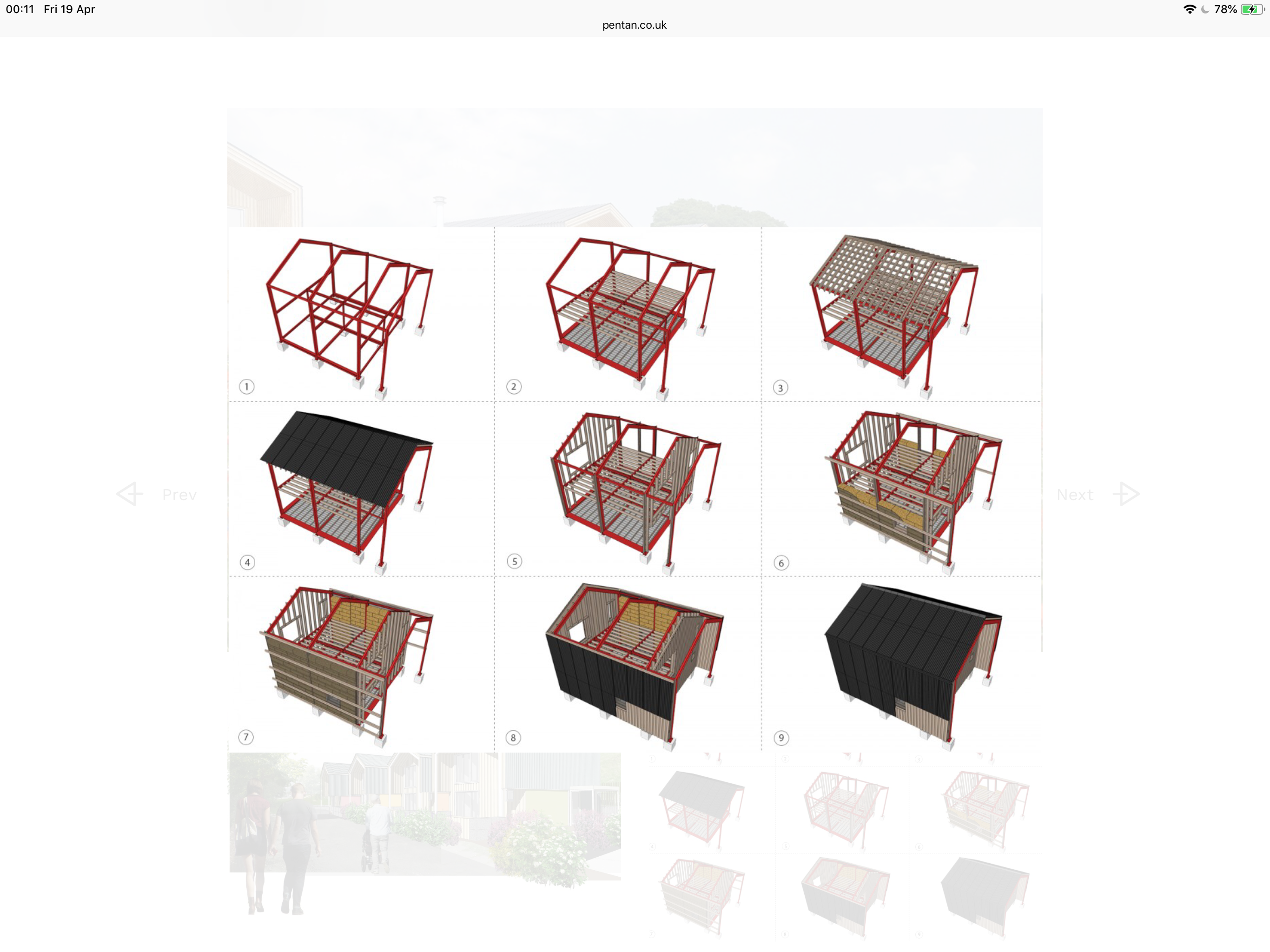

K78 Posted April 19, 2019 Posted April 19, 2019 The barnhaus concept uses a portal frame on pad foundations.
