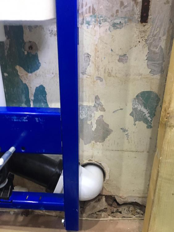

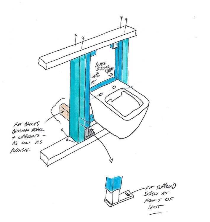

Onoff Posted February 6, 2019 Author Share Posted February 6, 2019 (edited) Pipe offcuts: Packed by 5mm: £s of CT1: All baby wiped and de taped: No.1s: & No.2s: It fills up so fast and quiet! The 19mm ratchet didn't really work. Couldn't get enough throw to well...ratchet. Once the CT1 has gone off I'll try with a normal socket or box spanner and nip a tad more. Edited February 7, 2019 by Onoff Link to comment Share on other sites More sharing options...

Oz07 Posted February 7, 2019 Share Posted February 7, 2019 I had one of these wall hung once. They're a lot of effort for that clear floor look aren't they. Well done anyway Link to comment Share on other sites More sharing options...
Onoff Posted February 7, 2019 Author Share Posted February 7, 2019 53 minutes ago, Oz07 said: I had one of these wall hung once. They're a lot of effort for that clear floor look aren't they. Well done anyway Anything to make SWMBO's life easier... Found the vintage, short reach 19mm that I wanted last night but couldn't find in the plumbing bag. As aforementioned the 19mm ratchet spanner that came with the pan (really nice touch I thought) didn't work. Couldn't get enough throw to click the ratchet. Think it was hitting the pan connector. This one should just get things a bit more nipped. Just hope I don't upset the CT1! Not looking forward to putting my not inconsiderable weight on it for the first time. Tbh I'll probably be sh!tting myself... Link to comment Share on other sites More sharing options...
Nickfromwales Posted February 7, 2019 Share Posted February 7, 2019 35 minutes ago, Onoff said: Not looking forward to putting my not inconsiderable weight on it for the first time. Tbh I'll probably be sh!tting myself... When done you can stand on the front lip and it'll not move a jot. You'll need to allow the CT1 to have fully cured, so 72 hours is wise before doing any ass-robics 1 1 Link to comment Share on other sites More sharing options...
Onoff Posted February 7, 2019 Author Share Posted February 7, 2019 4 hours ago, Nickfromwales said: When done you can stand on the front lip and it'll not move a jot. You'll need to allow the CT1 to have fully cured, so 72 hours is wise before doing any ass-robics 72 hours, that's so good to know, I was thinking 24! Would it be detrimental to have go now at nutting up these fixings a tad more ? Link to comment Share on other sites More sharing options...
PeterW Posted February 7, 2019 Share Posted February 7, 2019 Leave them alone .... they are tight enough, do not torque them up or you could crack the porcelain ..! Link to comment Share on other sites More sharing options...
Onoff Posted February 10, 2019 Author Share Posted February 10, 2019 Well I've SAT on it! After +72 hrs. All 17 stone of me. Must admit I didn't take my feet off the floor... No creaking, no movement, nada. Not yet used in anger but when that happens I promise to spare everyone the Christening photos! Link to comment Share on other sites More sharing options...

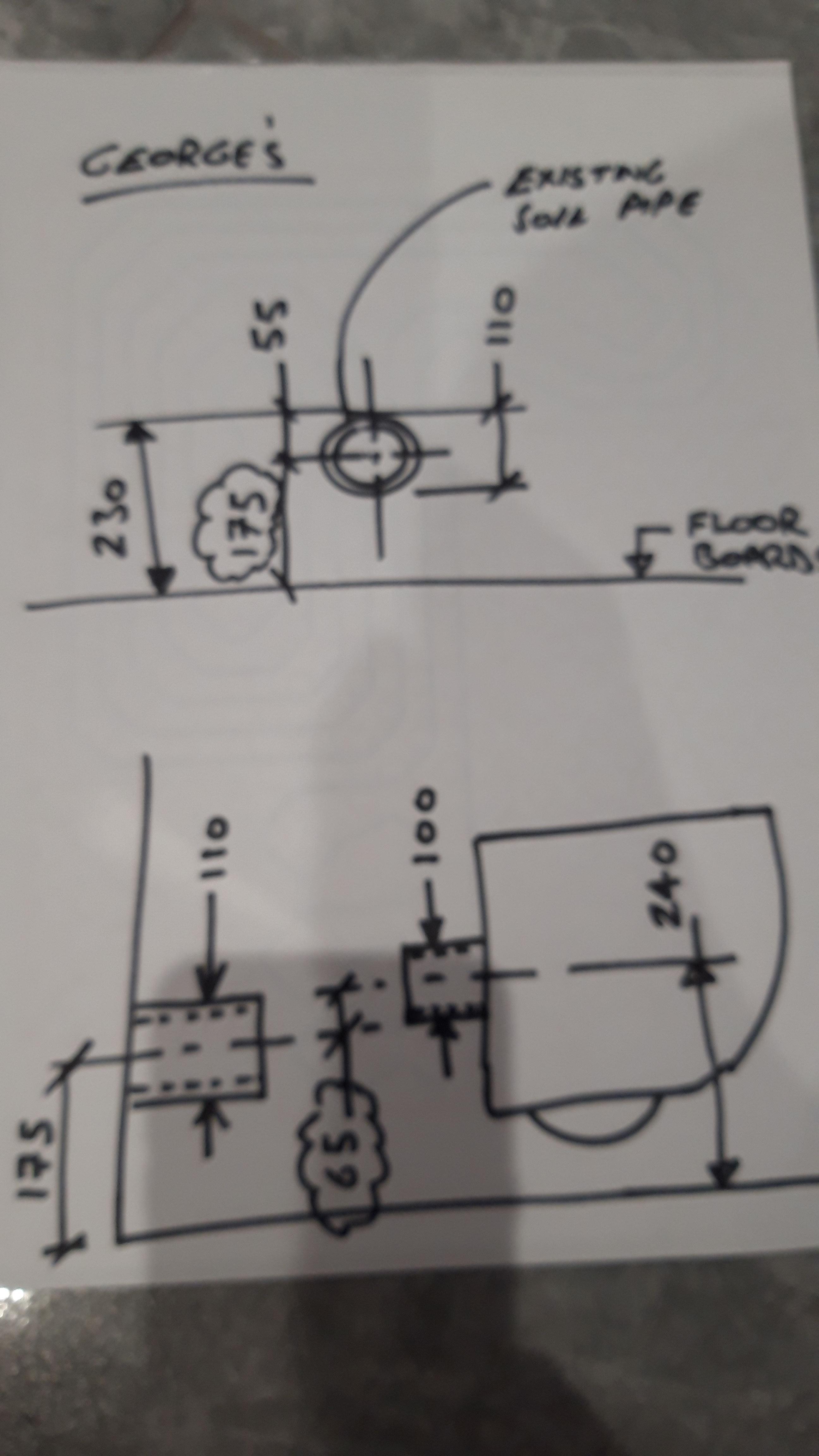

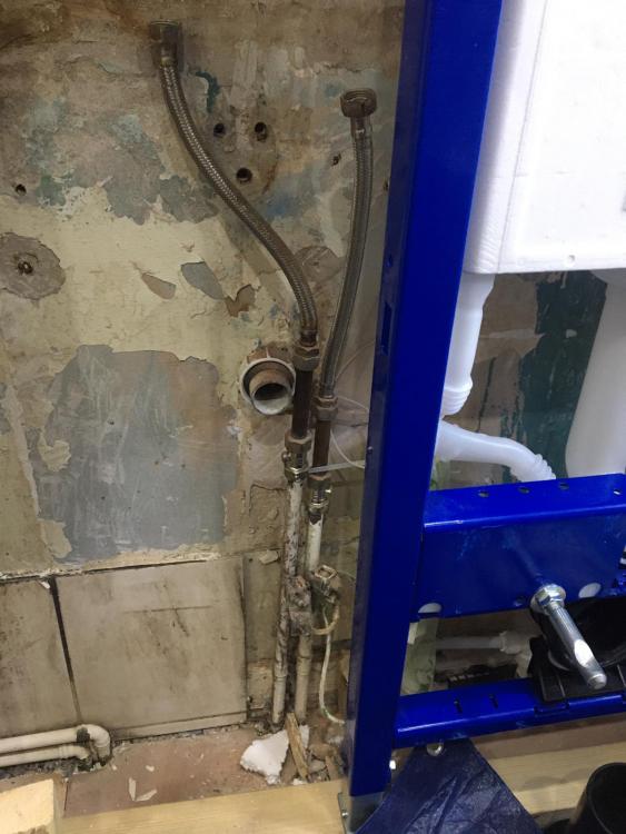

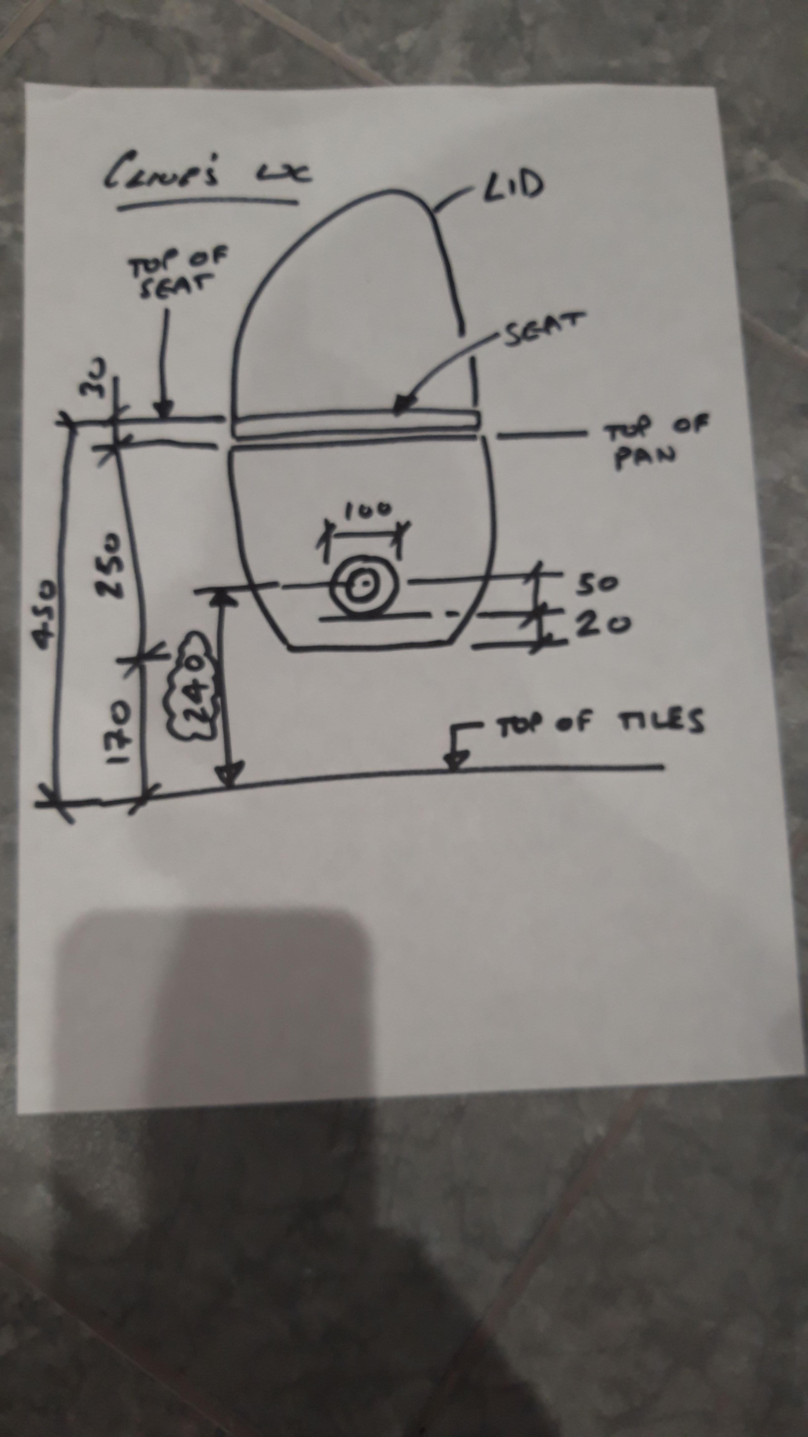

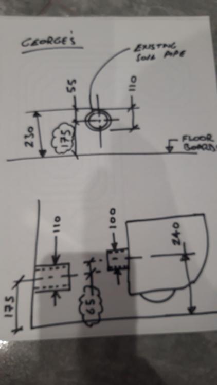

Onoff Posted May 28, 2019 Author Share Posted May 28, 2019 My mate (well his SWMBO) wants a wall hung WC like mine. Just measured mine up: He's hampered by the existing through the wall, 110mm soil. Centre is 175mm above the floorboards: We need then a nom. 65mm "offset" fitting to go from the 100mm dia poo pipe stub on the wc to the 110mm soil coming through the wall. Is there a Geberit fitting that'll do this does anyone know? And clip into the Geberit frame. Cheers Link to comment Share on other sites More sharing options...
PeterW Posted May 28, 2019 Share Posted May 28, 2019 21 minutes ago, Onoff said: Is there a Geberit fitting that'll do this does anyone know? And clip into the Geberit frame. Yep - Geberit Monolith 7cm offset fitting Part Number 131108111 1 1 Link to comment Share on other sites More sharing options...
Onoff Posted May 28, 2019 Author Share Posted May 28, 2019 5 minutes ago, PeterW said: Yep - Geberit Monolith 7cm offset fitting Part Number 131108111 Thanks. Not cheap though! Link to comment Share on other sites More sharing options...
