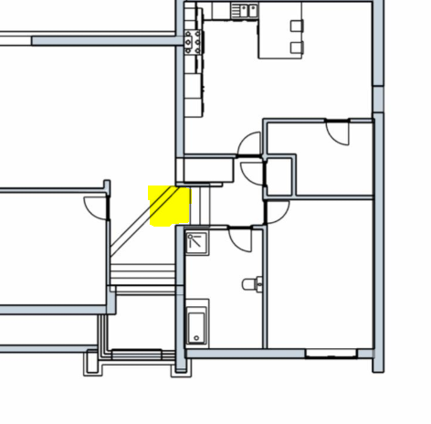

Lift span Posted July 2, 2019 Author Share Posted July 2, 2019 That’s a fair point. I’ve modified the stairs. Is the lower left step what you’re talking about? Link to comment Share on other sites More sharing options...
Mr Punter Posted July 3, 2019 Share Posted July 3, 2019 The bit I have highlighted needs to be part of the landing. Link to comment Share on other sites More sharing options...
Lift span Posted July 3, 2019 Author Share Posted July 3, 2019 Ah... now I get you: 1. Landings must be provided at the top and bottom of every staircase. 2. The landing distance in front of the top and bottom step must be at least the width of the staircase. Thanks. Will need to change that then. Link to comment Share on other sites More sharing options...

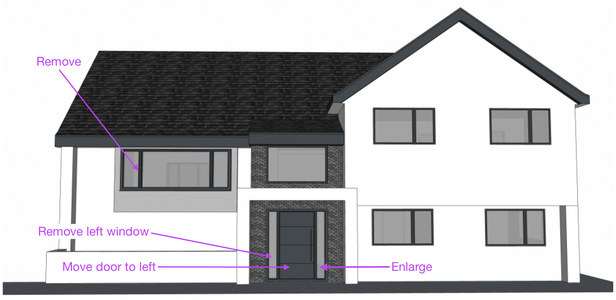

Lift span Posted October 6, 2019 Author Share Posted October 6, 2019 (edited) Well, things have moved on and the front extension is almost built but I need to finalise the windows. What do people prefer? Option A: Or Option B: Edited October 6, 2019 by Lift span Link to comment Share on other sites More sharing options...
Bitpipe Posted October 6, 2019 Share Posted October 6, 2019 I prefer A - B is more symmetrical but has a wiff of prison bars 1 Link to comment Share on other sites More sharing options...
Ferdinand Posted October 6, 2019 Share Posted October 6, 2019 (edited) I prefer B. A is less symmetrical but has a whiff (northern whiff with an h) of Private Walker giving a guilty glance left watching for the coppers, whilst handing over pilfered silk stockings made from Douglas Bader’s stolen parachute. So ... choose A and you advertising to the world your views on the theft of silk stockings. ? Edited October 6, 2019 by Ferdinand Link to comment Share on other sites More sharing options...
Lift span Posted October 6, 2019 Author Share Posted October 6, 2019 Ferdinand...that’s weird ... I was having exactly the same thoughts! ? Just for you, how is this: 1 Link to comment Share on other sites More sharing options...
Bitpipe Posted October 6, 2019 Share Posted October 6, 2019 One other suggestion - our house is also white render but rather than Anthracite Grey (RAL 7016) which is practically black, we chose Basalt Grey (7012) for windows, rainwater and soffit / fascia. It is a bit softer and more bluey grey than black grey, looks less harsh and blends well with slate etc. Link to comment Share on other sites More sharing options...
Dreadnaught Posted October 6, 2019 Share Posted October 6, 2019 How about the full shifty … 1 Link to comment Share on other sites More sharing options...
Ferdinand Posted October 6, 2019 Share Posted October 6, 2019 (edited) 53 minutes ago, Lift span said: Ferdinand...that’s weird ... I was having exactly the same thoughts! ? Just for you, how is this: I think you want either symmetry with each half of the facade, or both asymmetrical so as to balance each other. Needs to look Ok overall, and you are best placed to judge that. I would go for both symmetrical within themselves, which says either the Wormwood Scrubs option or something balanced in a different way. Doing what @Dreadnaught says to the door could actually help, but that also depends on alignment inside. Do what we did at the start of the thread .. grab a screenshot, monochrome and edge detect, and draw some pictures to get a view. Edited October 6, 2019 by Ferdinand Link to comment Share on other sites More sharing options...
Adrian Walker Posted October 6, 2019 Share Posted October 6, 2019 At a quick glance, the front elevation looks like to two designs in one. Symmetry for the sake of it is not always good in house design IMHO. Link to comment Share on other sites More sharing options...
Lift span Posted October 6, 2019 Author Share Posted October 6, 2019 (edited) Thanks for the replies. It all helps! I like the basalt grey Bitpipe. However, I’d like a subtle silver/grey render (probably paint actually!) rather than a pure white so that might offset the anthracite a bit. Dreadnaught, the internal config probably wouldn’t work with the shifted door. But, see below for the window. Ferdinand, you made me use up half an hour of my life looking at kids toys from my childhood! Time well spent actually! How about this though: Edited October 6, 2019 by Lift span Link to comment Share on other sites More sharing options...
