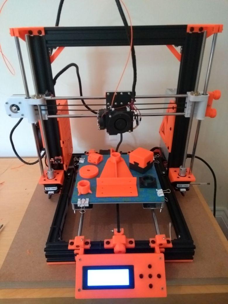

Sorry about the picture quality but my phone isn't great. Here is a photo of my A8 after the upgrade to a metal frame, together with some parts printed on it since upgrading. Everything in orange on the printer was printed on the stock printer before tearing it down to upgrade. Took a lot of print time! The impossible dovetail was printed on the stock printer with a 0.3mm clearance between the two parts. It slides apart a bit too easily so perhaps I could have allowed less, say 0.2mm? The large part in the middle took 3.5 hours to print at 0.3mm layer height. It's part of a spool holder I'm making.

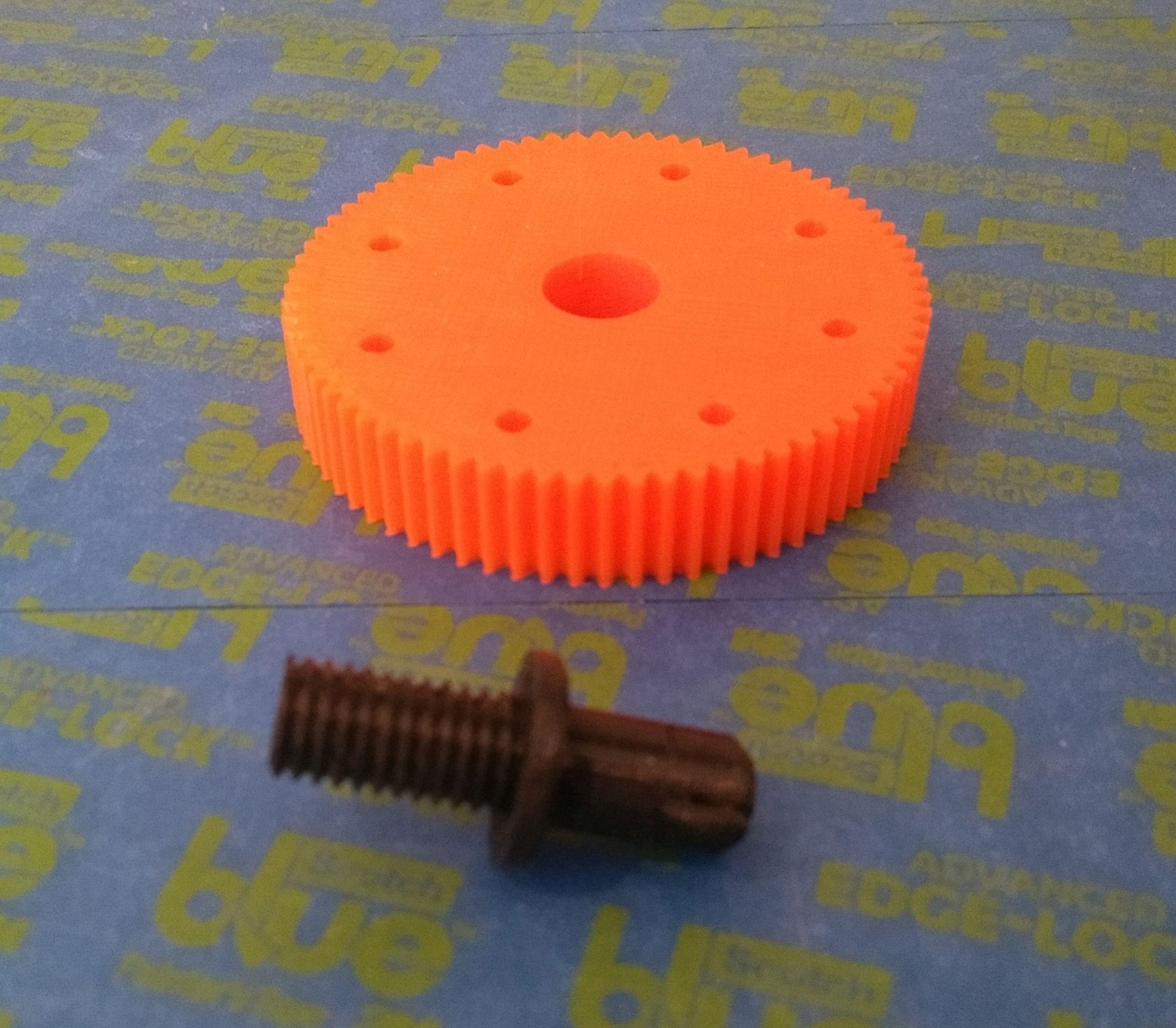

Here is a gear and a part with a thread. The tooth pitch on the gear is only about 2mm. It mates nicely with it's partner but I've not tried running them together at speed or testing for wear. Would be OK for a hand cranked toy but I think it would needed to have a much coarser pitch to have any life in a motorised device. The threaded part has an M8 thread. Wasn't very clean when printed but I managed to screw an M8 metal nut onto it easily by hand. It will hold up for what I wanted it for but it's not going to be as strong as an injection moulded nylon bolt would be. It was printed with the part vertical so the threads are made of lots of incomplete circles that overhang and relies on layer adhesion for strength. Again larger thread diameters would probably work a lot better. Fusion 360 has tools that make gears and threads really simple.

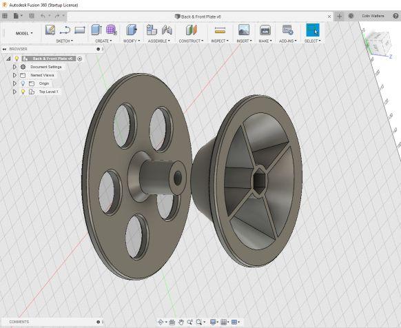

Here is the rest of the spool holder mentioned. These two parts took about 30mins in total to draw up in total using Fusion 360. They are 100-120mm in diameter. The left hand one took 2 hours to print. The right hand will probably take about 2.5 hours. The axle will be some 8mm threaded rod and I plan on fitting an M8 Nut into the hexagonal recess on the right.
I'm finding fusion 360 and Cura incredible given both are free for home users. Fusion 360 has impressive tools that make some things really easy. I'm thinking of trying something complicated like a glider wing with elliptical dihedral, elliptical sweep and wash out (eg twist). The lofting tools should make it all reasonably straightforward. Others have used vase mode to 3D print similar small chuck gliders.

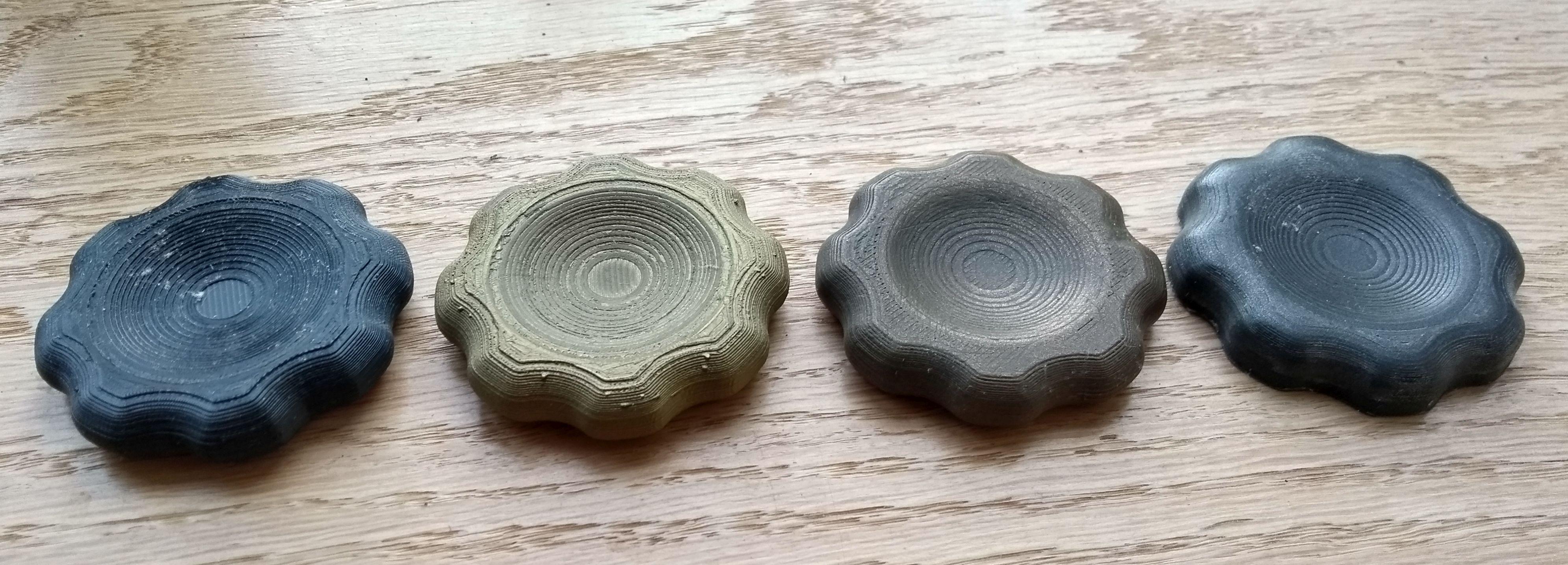

Last picture for the day.. Comparison of different filaments. Left to right..
Black PLA+ (As printed but I see it has some white fluff on it or something)
Bronze coloured PLA (no actual bronze in it. As printed)
Bronze filled PLA (80% real bronze, sanded and "polished")
Iron filled PLA (80% real iron, sanded and "polished")
Polished in quotes because it's not really hard enough to take polish. I tried T-Cut and Brasso.
All were printed with 0.3 layer height and are about 45mm across.
I'd like to try copper or brass filled PLA and may have found a source for cheap samples to play with.

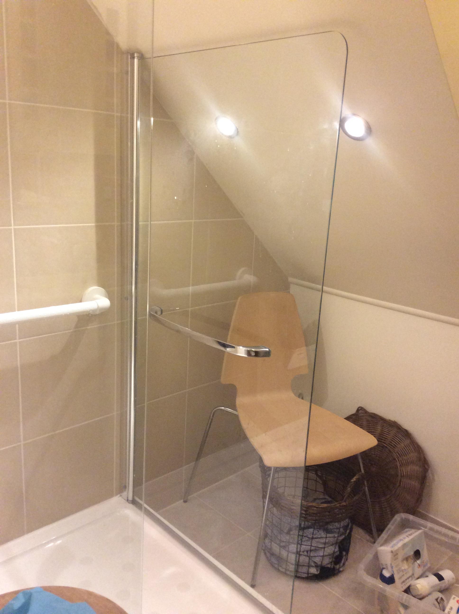

Not entirely sure that this is the right thread, however ... I need a custom part for my shower, and it strikes me as probably a 3D printable thing.
I have repurposed the former hinged bath shower screen as the end screen of my walk in shower, as it is under the stairs. A side benefit was to be that the narrow 450mm entrance gap would you be opened a little wider for horizontally more extensive people, or putting a shower seat inside more comfortably etc.
Due to a need to reposition the shower closer to the stairs, there is now such a minimal gap that I need to fix the screen in place, rather than let it move. So I need a part with a 42 degree upper surface and a slot to fit over the top of the 6mm hinged screen, which I can then glue or silicone in place.
Pics and a diagram are below. Any comments on the material needed, the design, or offers if anyone actually has a 3D printer would be most welcome. happy to either pay or donate to BH.

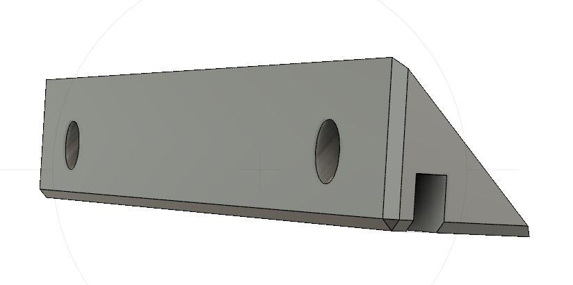

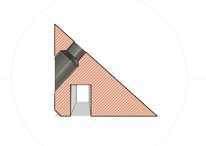

Just had a quick 15min play around with Fusion 360 over a cup of tea. At 150mm long and 25% infill Cura says it needs about 12m of filament which isn't much but more than a 10m sample.  Holes might be better going up from underneath. Anyway have a think. I'm painting the church hall next door most of tomorrow.
Image01.jpg.01b1f16d56e2a9c753504efbd478b8a8.jpgImage02.jpg.72813b21b89864321b7b09327c2af723.jpgImage03.jpg.ecc3a3379044b206dbc9a5f53bb228c0.jpg

Ok. Reflections.
@dpmiller - I quite like that idea, but I would like to glue as well as screw (it is into plasterboard). There might be issues screwing through both sides if a clamp hinge for the wall attachment?
Are there any pros or cons when attaching solid material to the shower screen that might cause it to shatter - eg if the angle turns out to be 41.5 degrees not 42 degrees? I have allowed .5mm over the 6mm thckness of the glass to give a slight "movement buffer" which will be filled with clear silicone used to bed the screen on the slot. Plus the screws will not need to be that tight.
I imagine ally as a less forgiving material in this situation.
(And TBH, having a 3d printed item is more fun.)
@Temp
The screws need to be where you have put them, as it will need to be on the screen first, and screws below will be left going at 45 degrees into the plasterboard due to the screen itself.
To my eye the mechanical weak point is the close proximity of the slot for the screen to the screw hole, even though there is continuous material covering the gap for 90% or so of the length. If your judgement is that that will be strong enough, can we go with the design we have with the 150mm length reduced sufficiently to have it done with a single 10m pack.
Do I get to choose a colour? ? White or cream ideally. Or  "Jasmine" to match the grout ?.
Also - shoutout to @ElliotS for kindly making a similar offer.
Cheers
Ferdinand
White PTEG would be my recommendation as pretty sure I can get a 10m sample easily. There are few other colours are available but most are vivid colours you wouldn't want in a bathroom like lime green, translucent blue or black.  Have a look on Amazon.
I can print PETG or PLA.
PLA is easiest to print and there are probably more colours but it's claimed to be biodegradable so not sure how long it lasts.
PETG is a bit more fussy about the printer settings but should be stronger than PLA. Some black I printed recently came out OK.
Edited by Temp
Link to comment
Share on other sites
Both PLA and PETG are pretty rigid but I think 0.5mm should be plenty of wiggle room.
My shower has a chrome plated stay to the top of the glass. There is a allen key bolt that clamps the glass. Bolt has some sort of nylon pad on the end.

I like it!

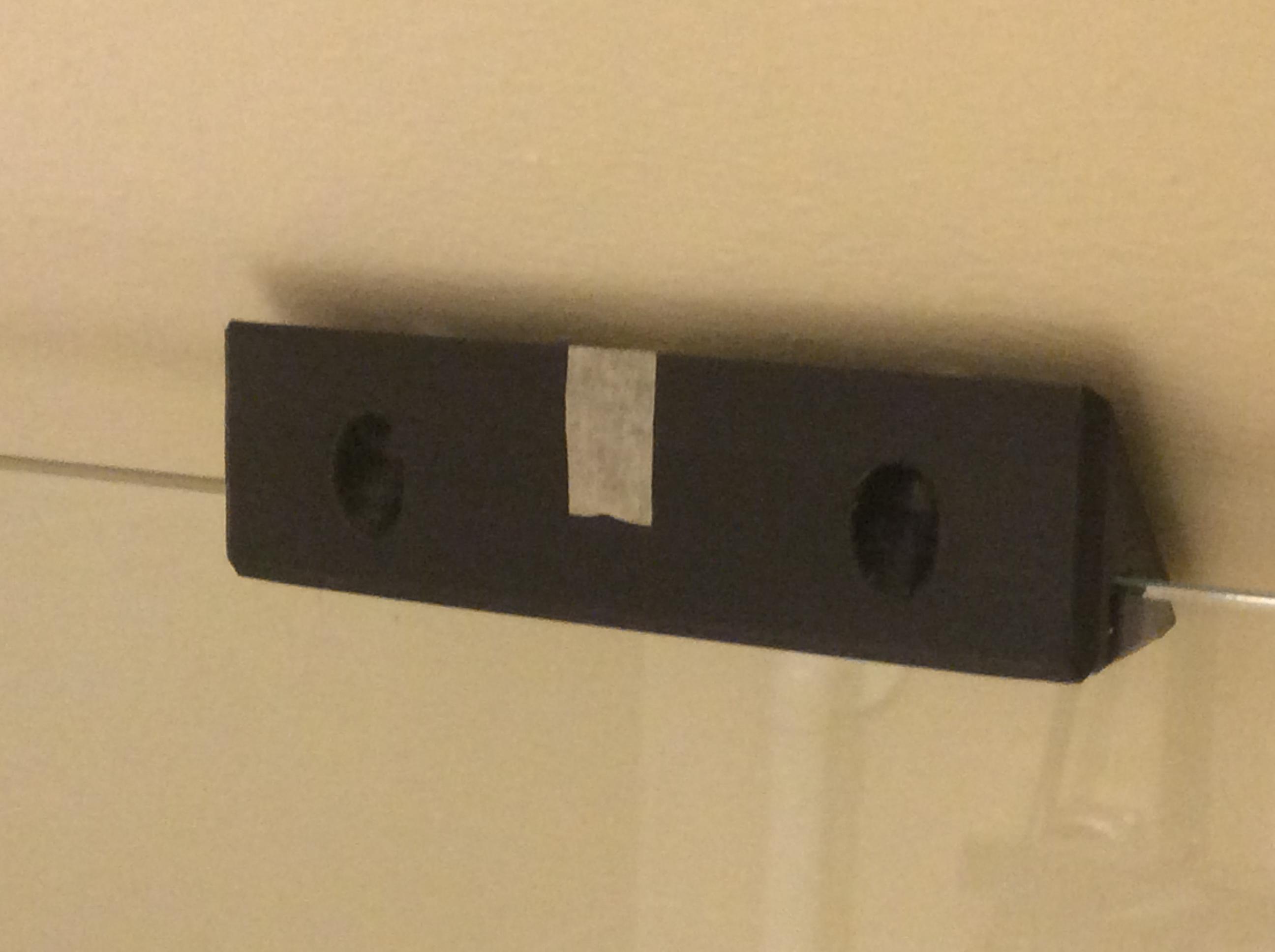

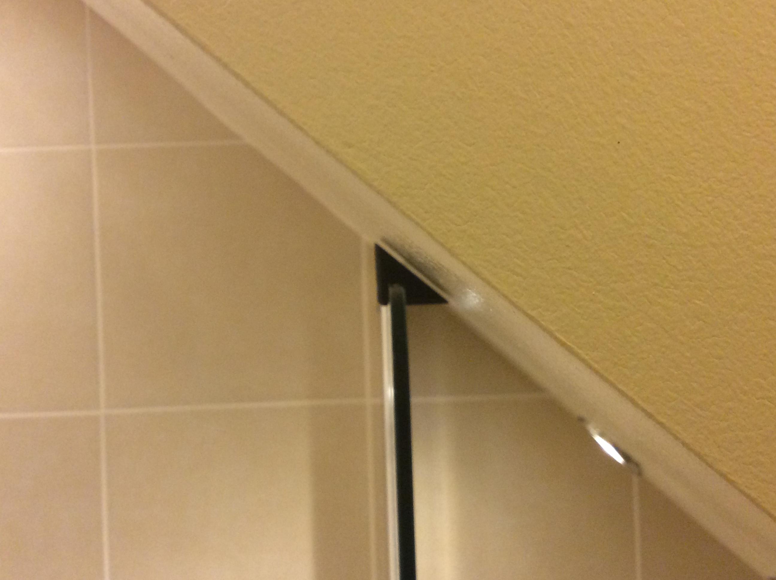

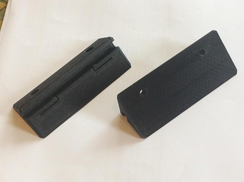

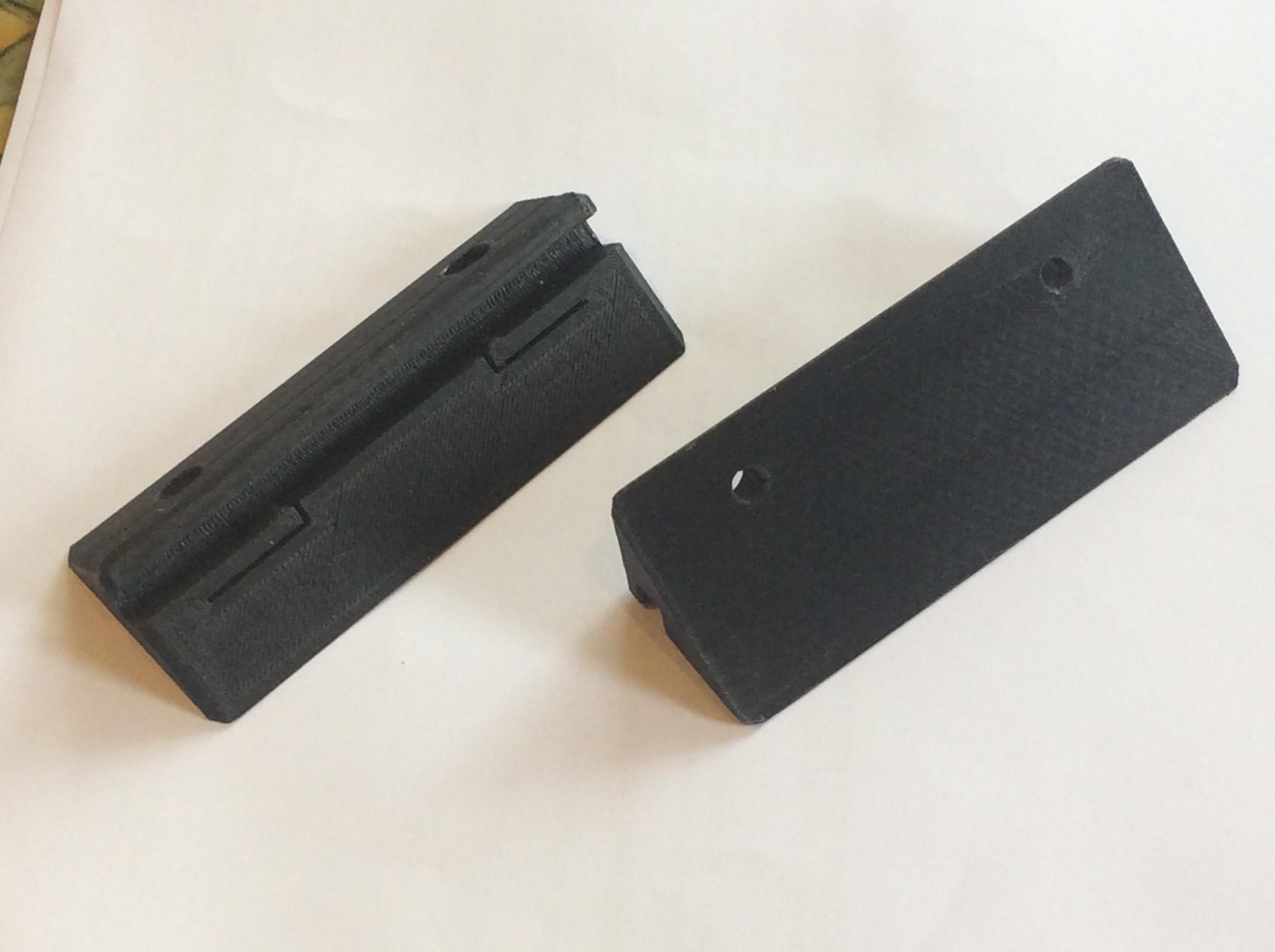

These arrived this morning from @Temp.
The one one of the left has a couple of springs built in to help it grip on the shower screen. An extra 0.5mm seems about right to give a little play and space for glue in the slot.
The springs work really well to hold it whilst glue and screw happens. In the next pic the tape is to give the iPad an edge for focus.
But I think I am 2-3 mm out on the screen to slope dimension for the screen to be exactly right, so I will re-measure carefully before pushing the button on the stronger version made with the other filament. That points up the value of a prototype.
As it happens, my bathroom fitter brought his invoice 2 hours after the parcel arrived; he was impressed.
